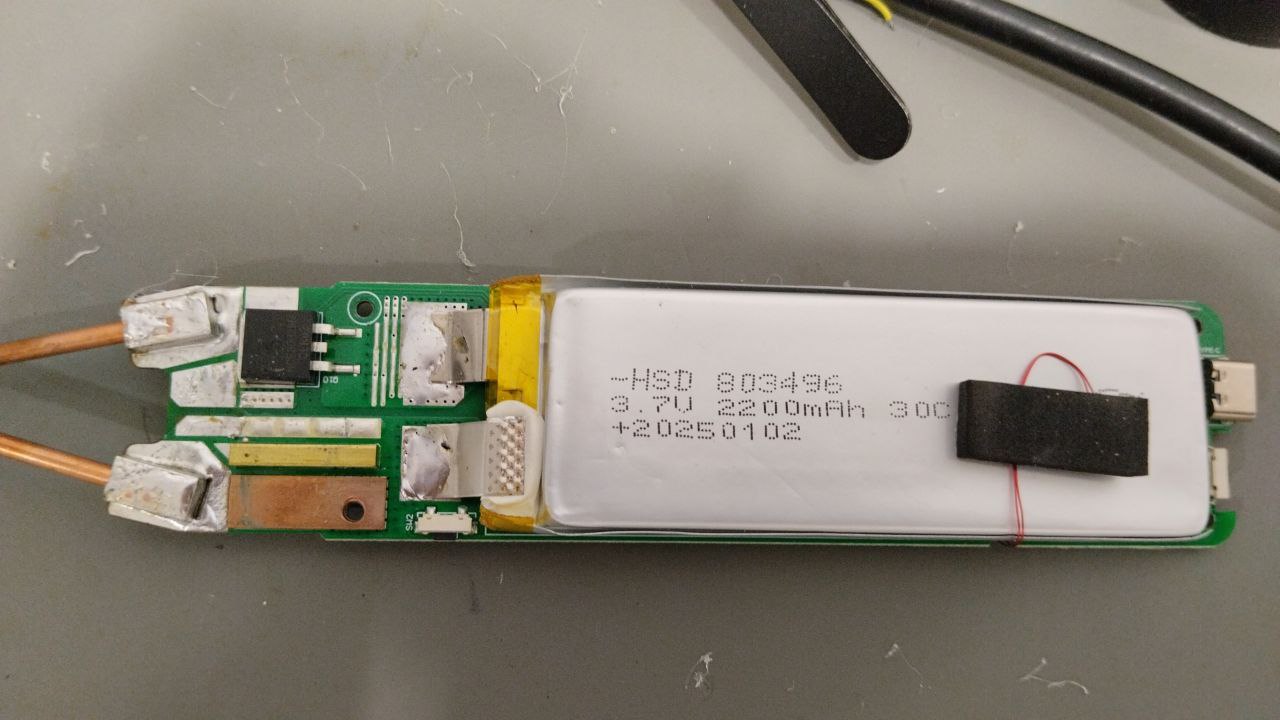

You can open up the battery pack, verify the low voltage condition of the battery (note, if there's multiple cells this gets more complicated), and then with a constant current power supply apply a charge directly to the battery cell. The charge current should be low, no more than 10-25% of the rating of the cell (a 1000mA cell would be charged at 100-250mA). The power supply voltage should have been set to the correct multiple of about 3.5V per cell.
MONITOR THE VOLTAGE, it shouldn't take long for the cell voltage to climb up close to 3. Disconnect the power supply and connect the regular charger. If all goes well, the charger will take over and bring the battery back to life.

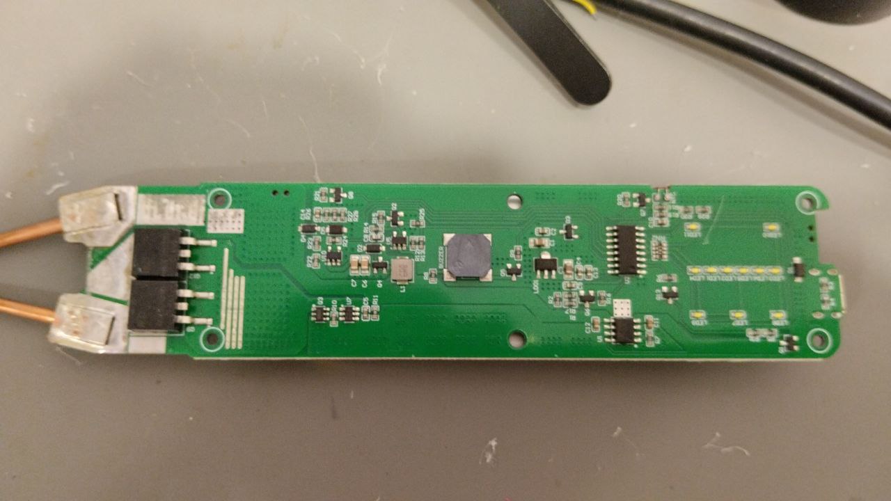

I just had to do this with a battery pack spot welder. Can't make a battery pack if the battery in the welder is dead!
