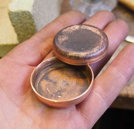

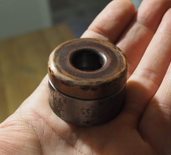

Hi, have been learning how to form the endplates for a boiler, used a hammer to round the edges:
Attachment 32431

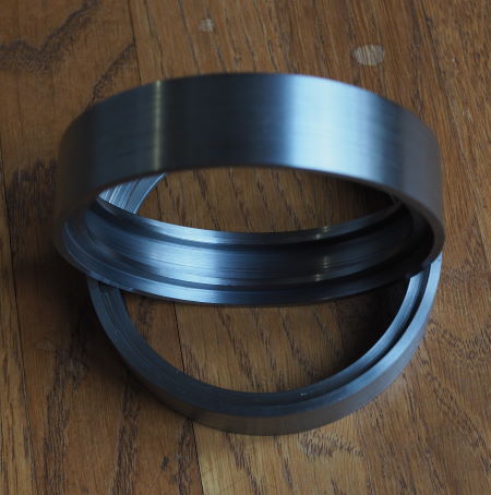

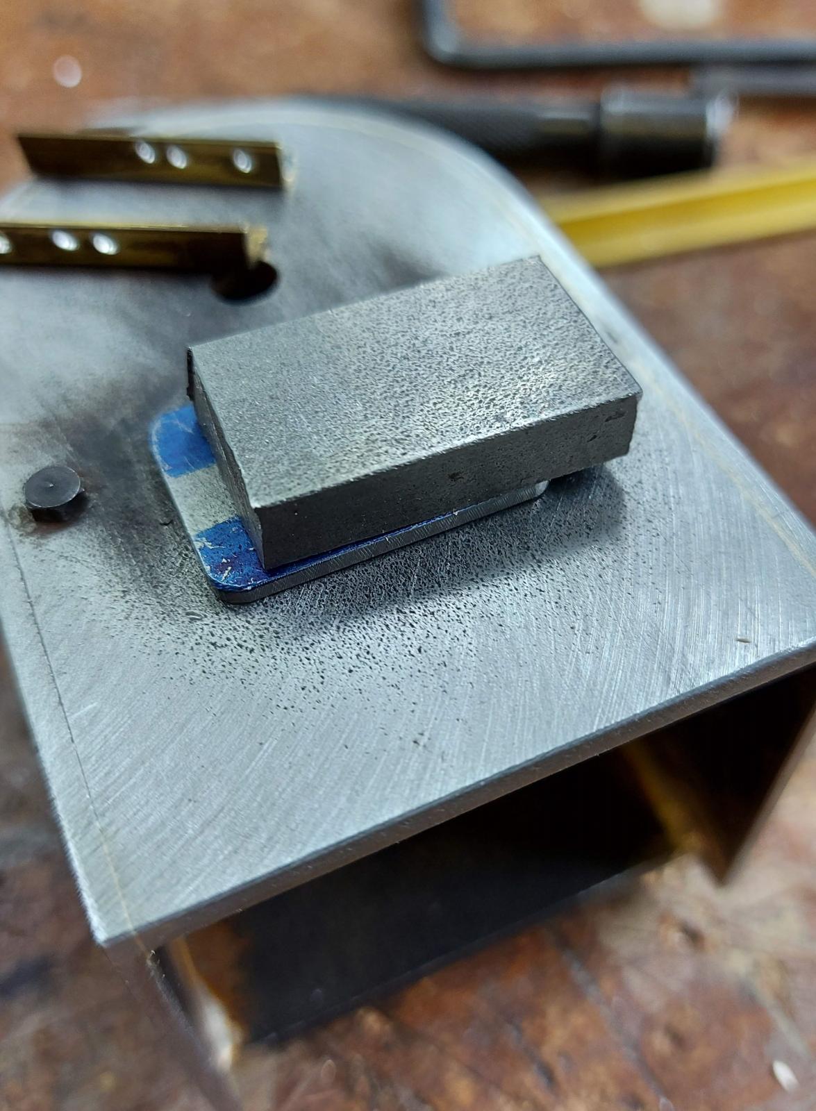

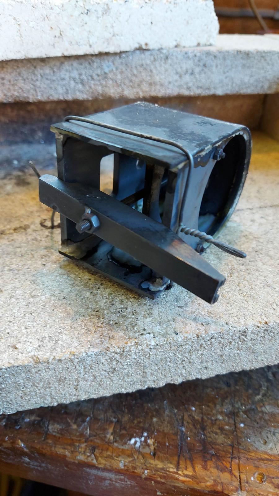

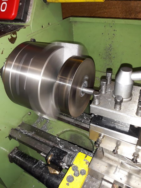

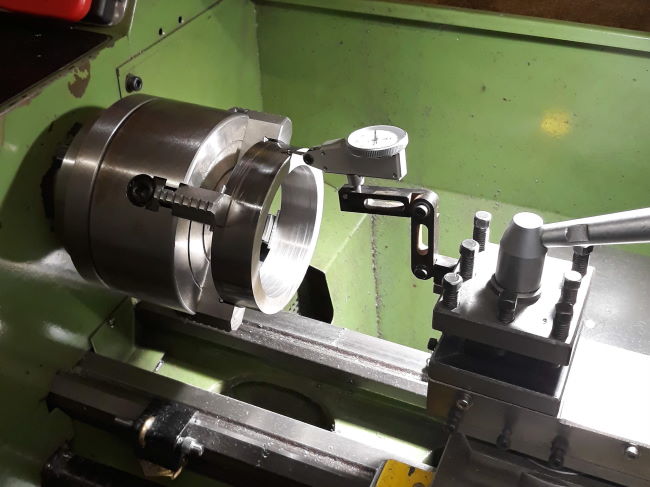

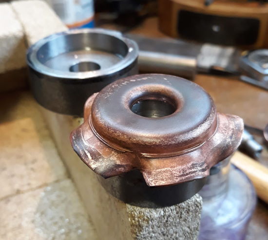

But then decided to make a forming tool
Attachment 32432

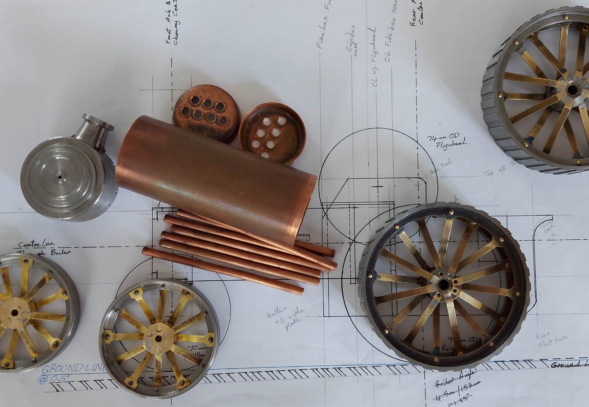

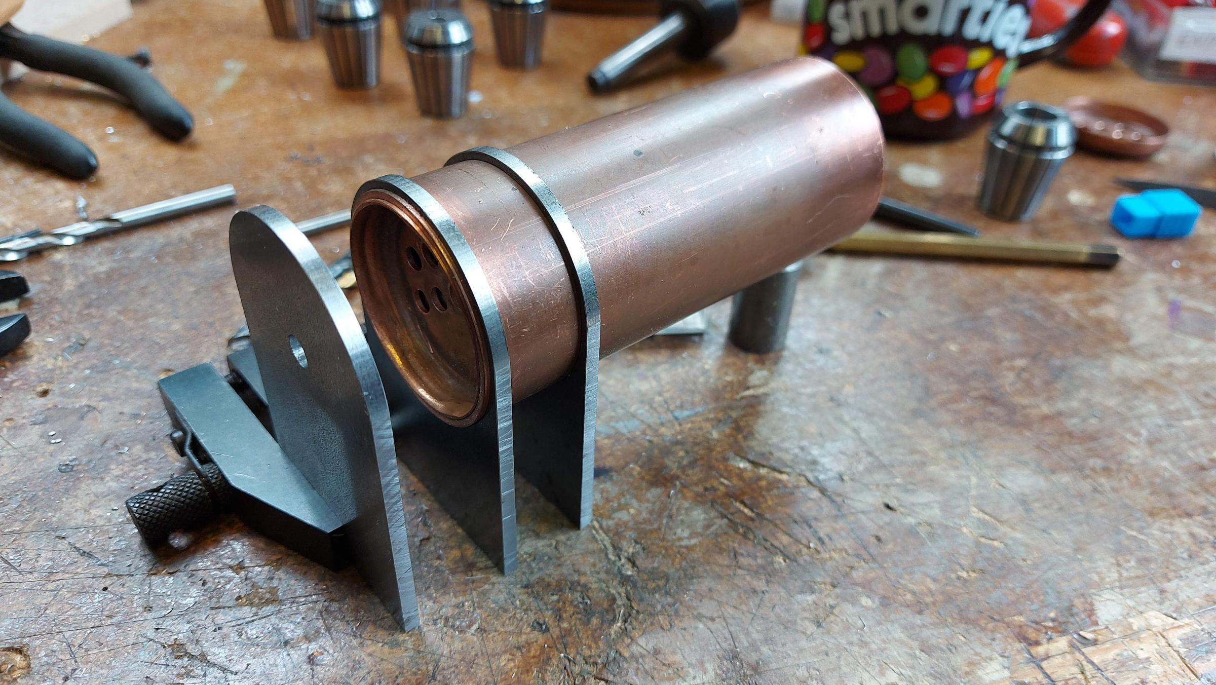

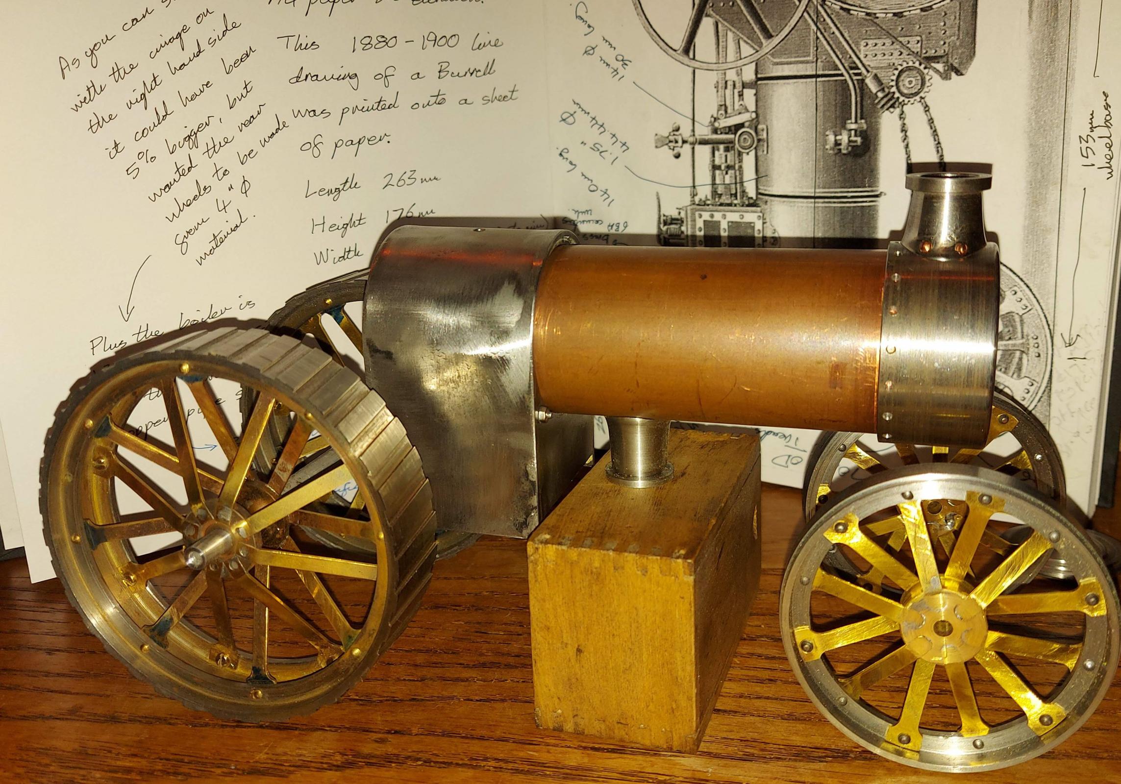

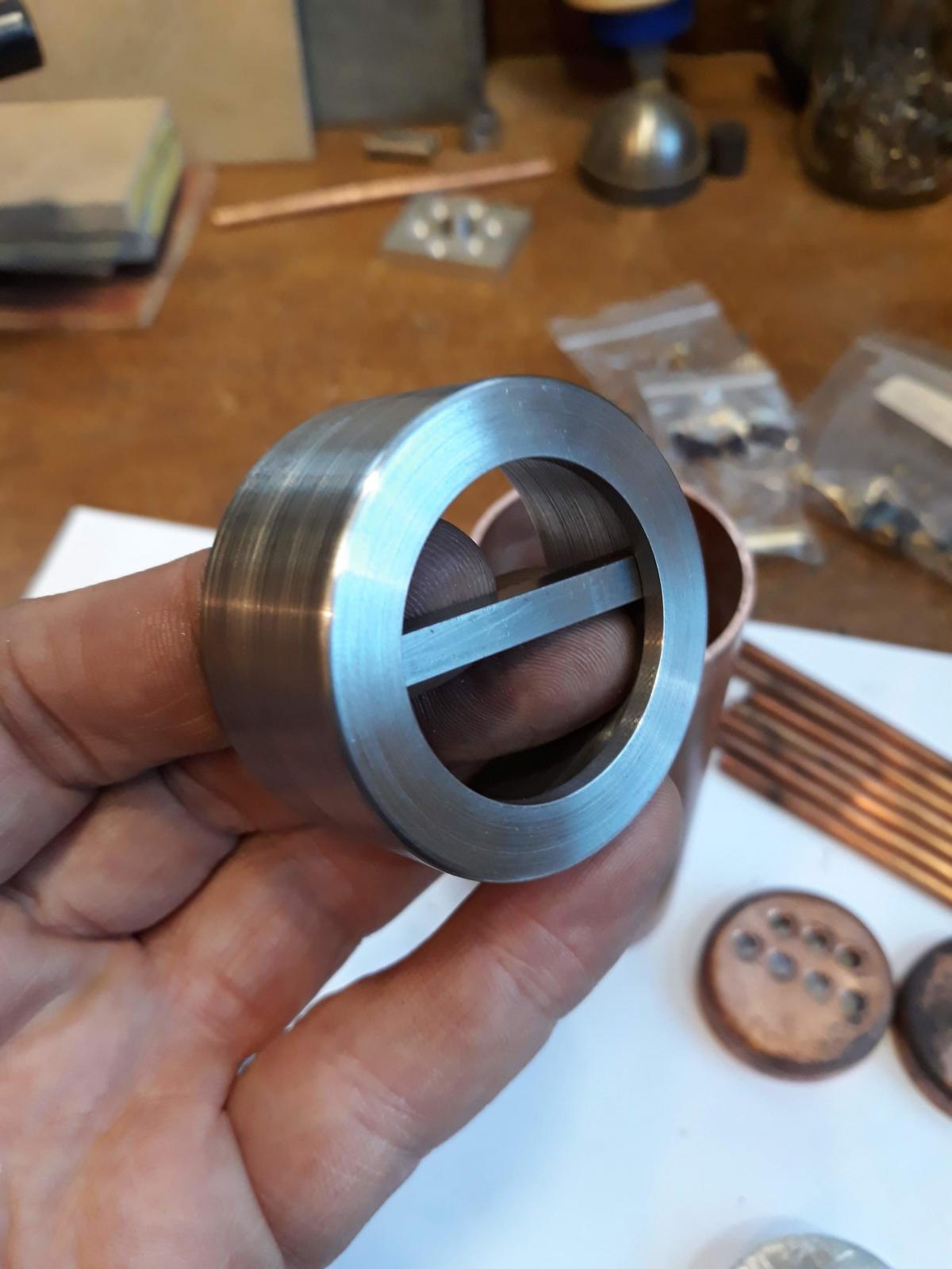

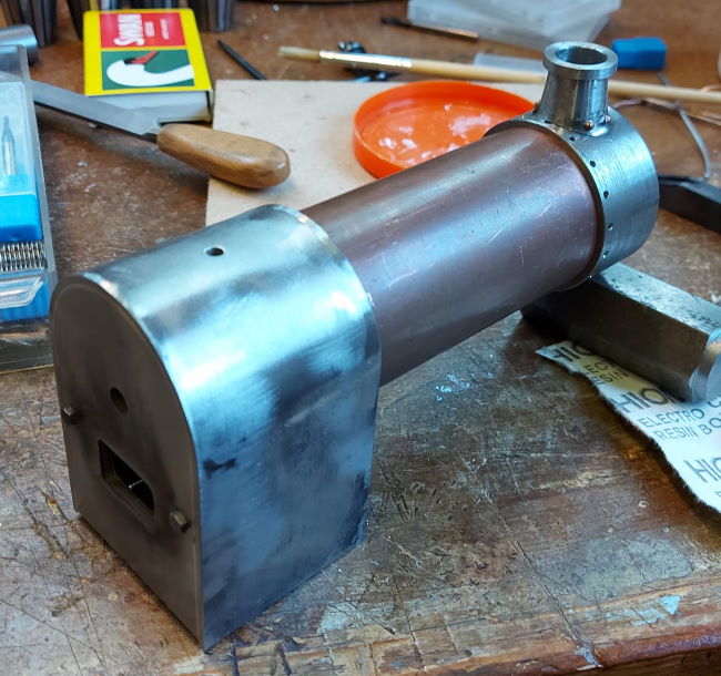

Made two endplates for the traction engine boiler
Attachment 32433

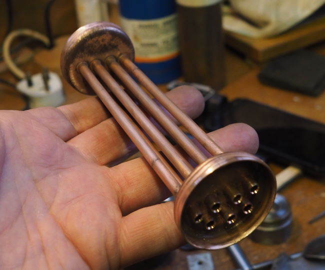

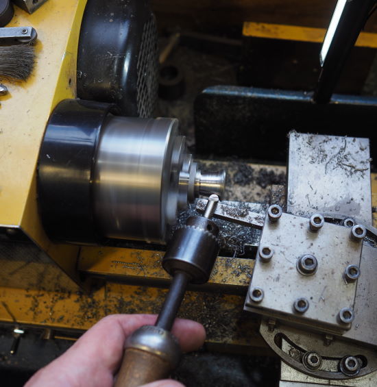

then drilled holes and made up 7 off 3/16" pipes using brake tubing
Attachment 32434

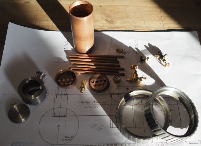

The next stage is to make up the other fittings and silver solder it all together, Best regards, Nigel
