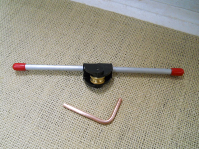

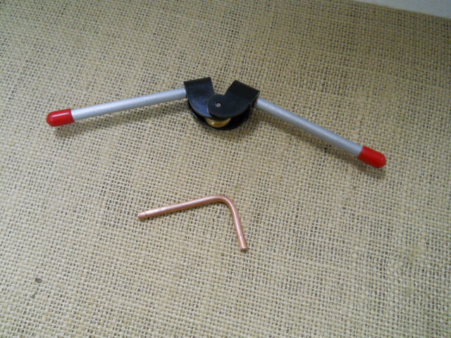

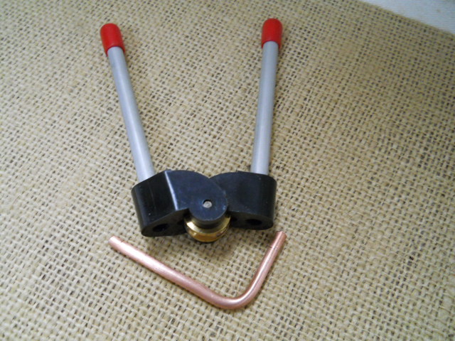

    Tube benders.-dscn0043.jpg Tube benders.-dscn0044.jpg Tube benders.-dscn0045.jpg
    This bender is made by Dubro ,I used it to bend 5/32"A/C tube to replace plastic vacuum lines on
    a Ford F150.It's a simple design, makes a 3/8 inside bend on copper or annealed brass.It looks
    flimsy [plastic] sleeves, but bends tubing easily. "Hobby Zone" carries it.
