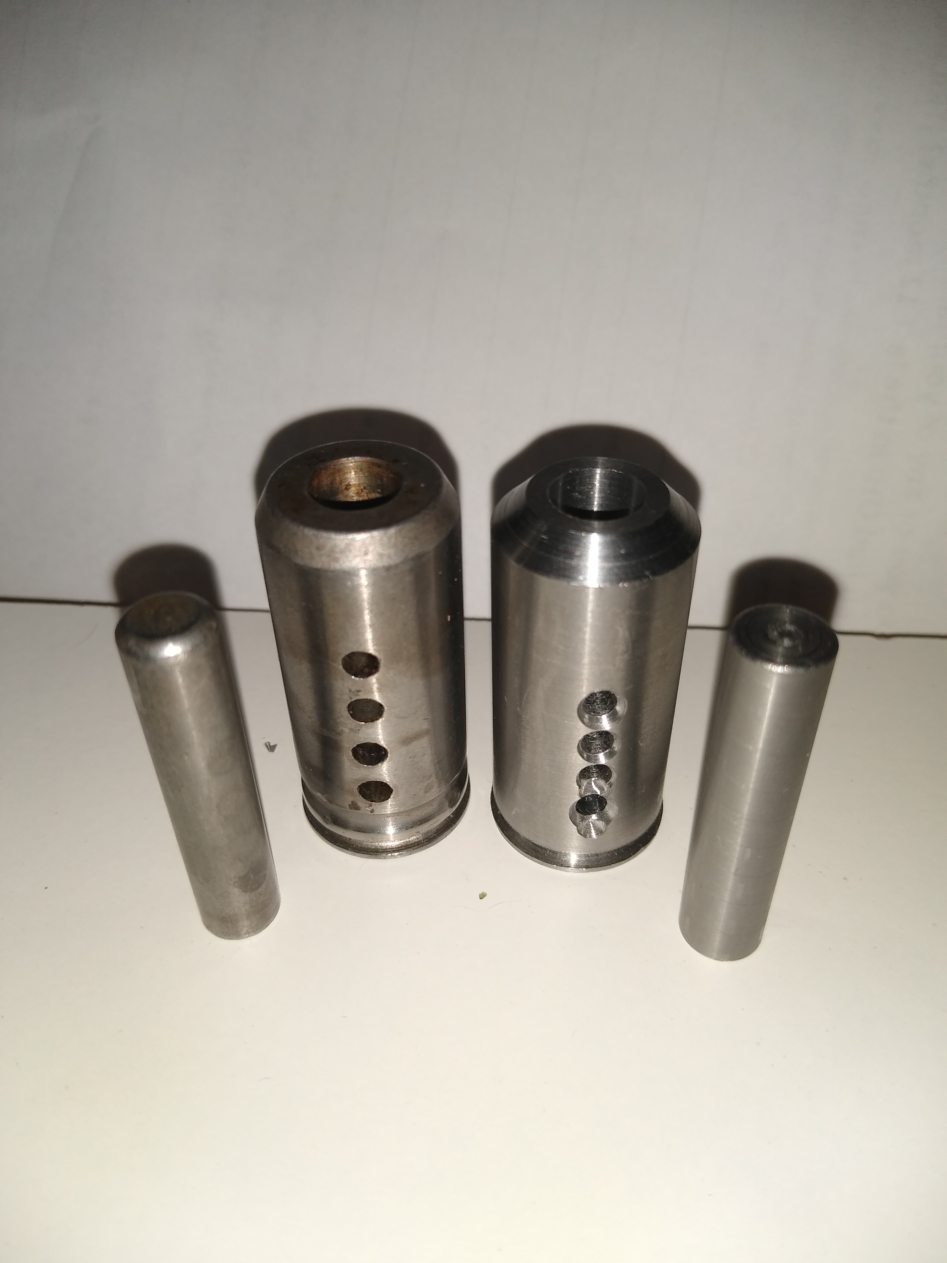

    I hope to do similar work, as well! I have made a sizing die for a Lyman 450 lube and sizing press, as well. Unimat Lathe Faceplate and Faceplate Clamps-img_20200908_222629506.jpg
    The die and punch on the left side is a factory original, while those on the right side are the ones I made. I have still not gotten to test it to see if I have gotten the size correct. It is supposed to be 0.3160", and is for sizing cast lead bullets for a Mosin-Nagant 91/30 model 7.62x54R rifle with an oversized bore. This was not done on a Unimat, however! Though I believe it would be possible. I did not have the Unimats when I made these parts.
