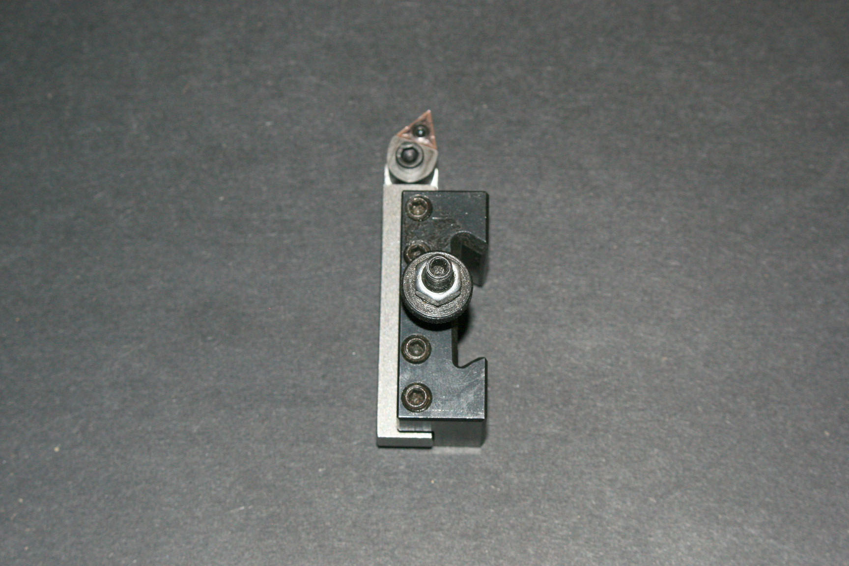

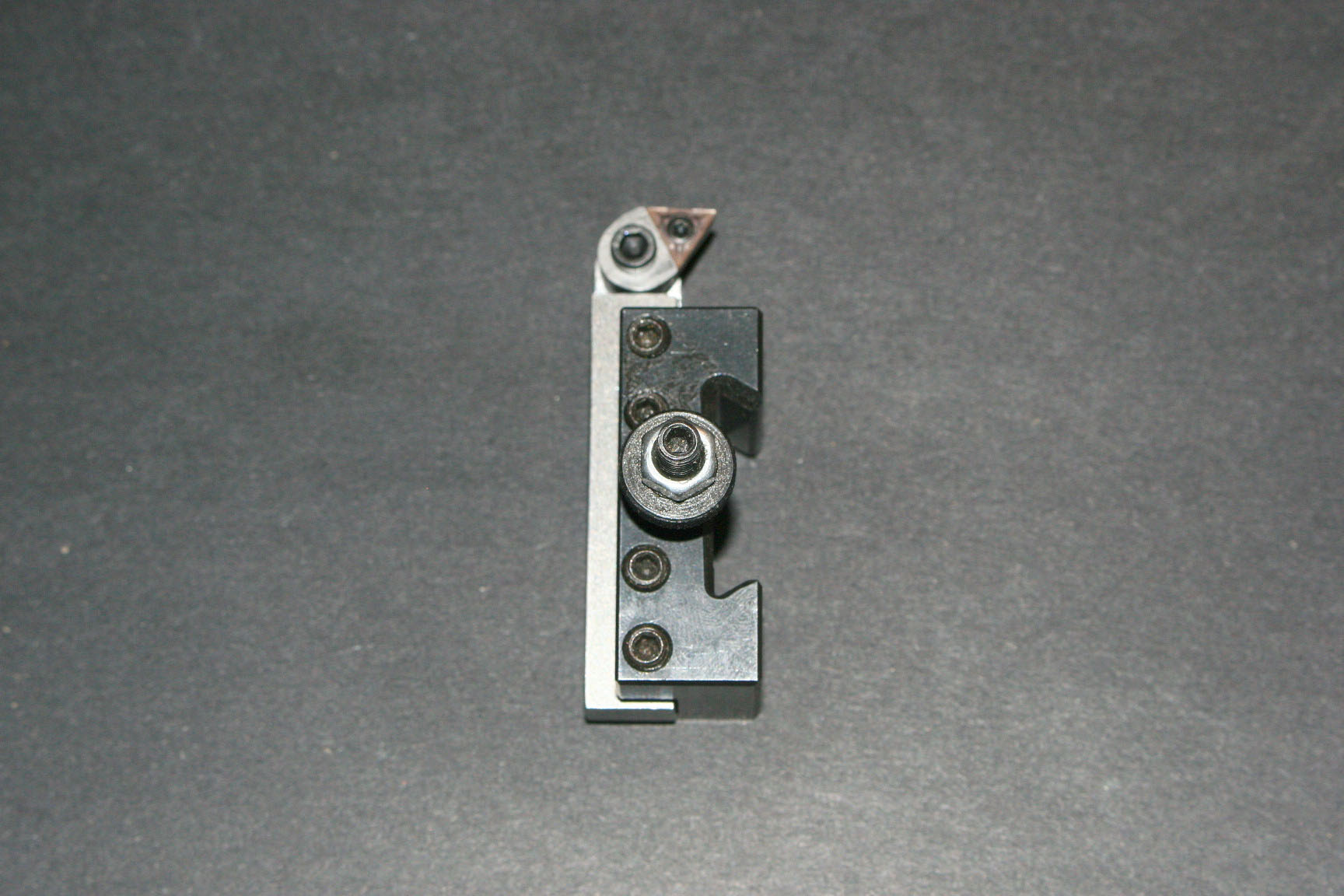

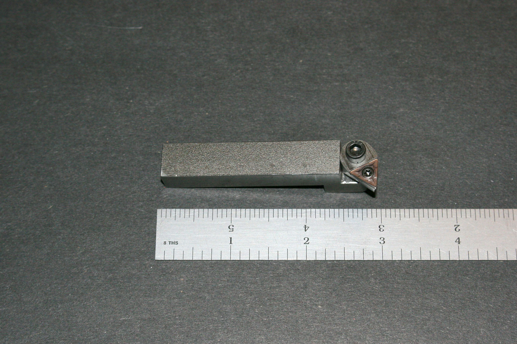

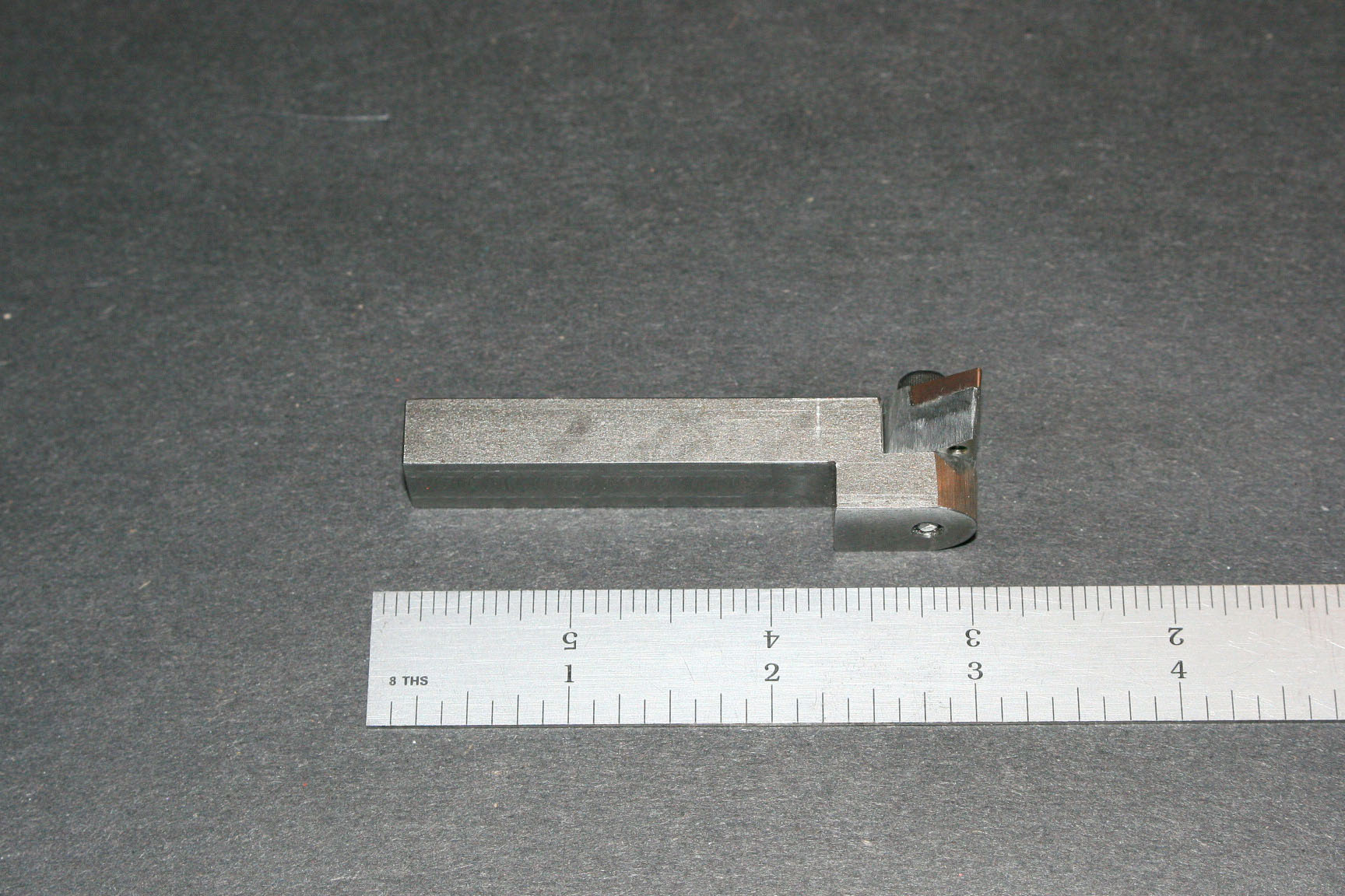

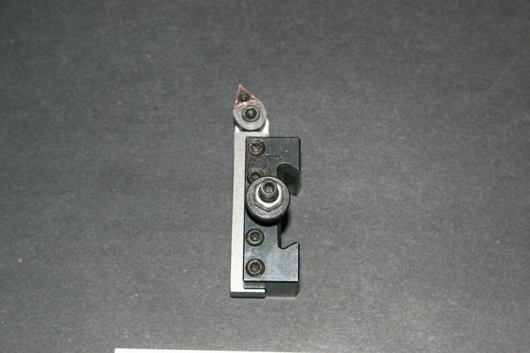

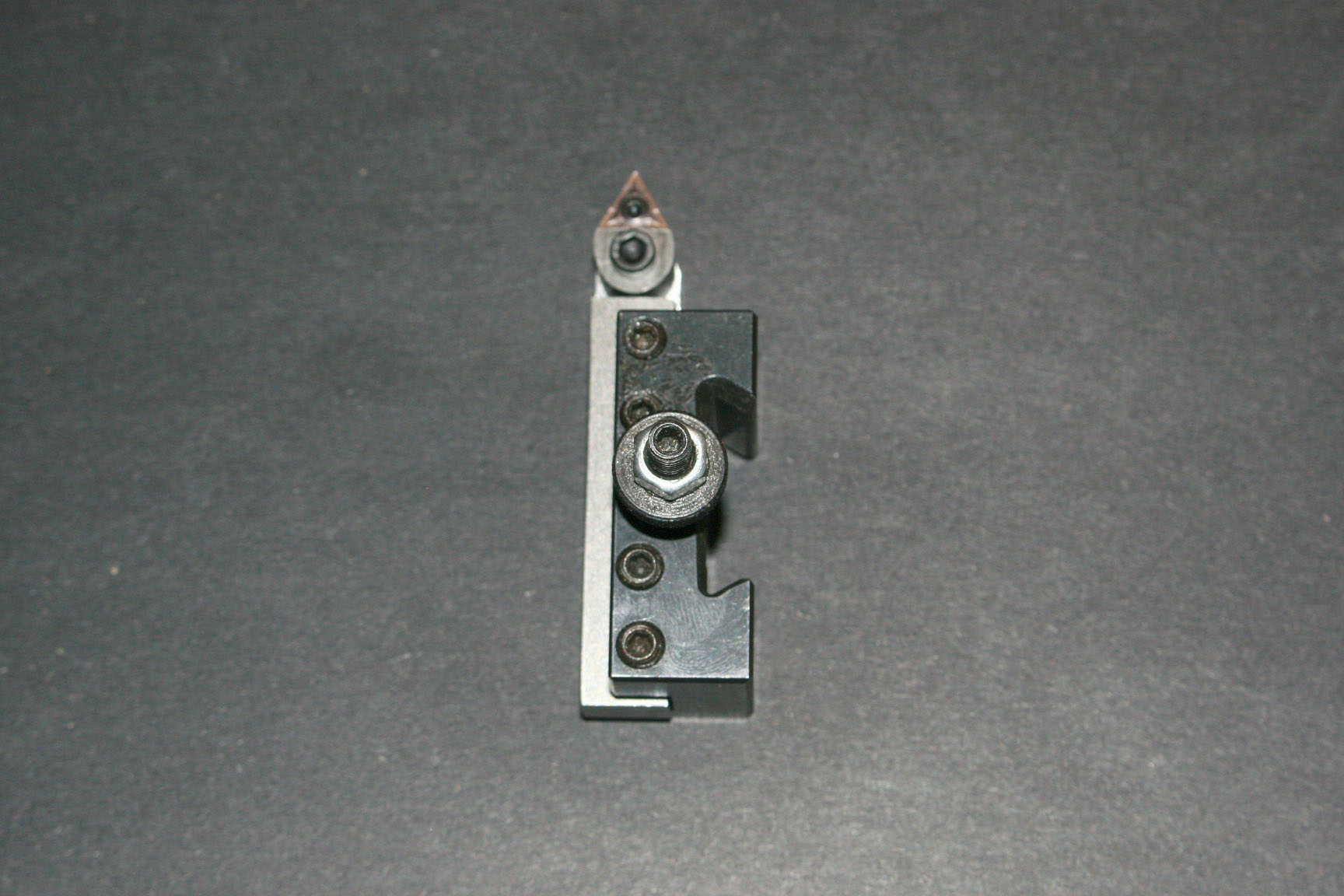

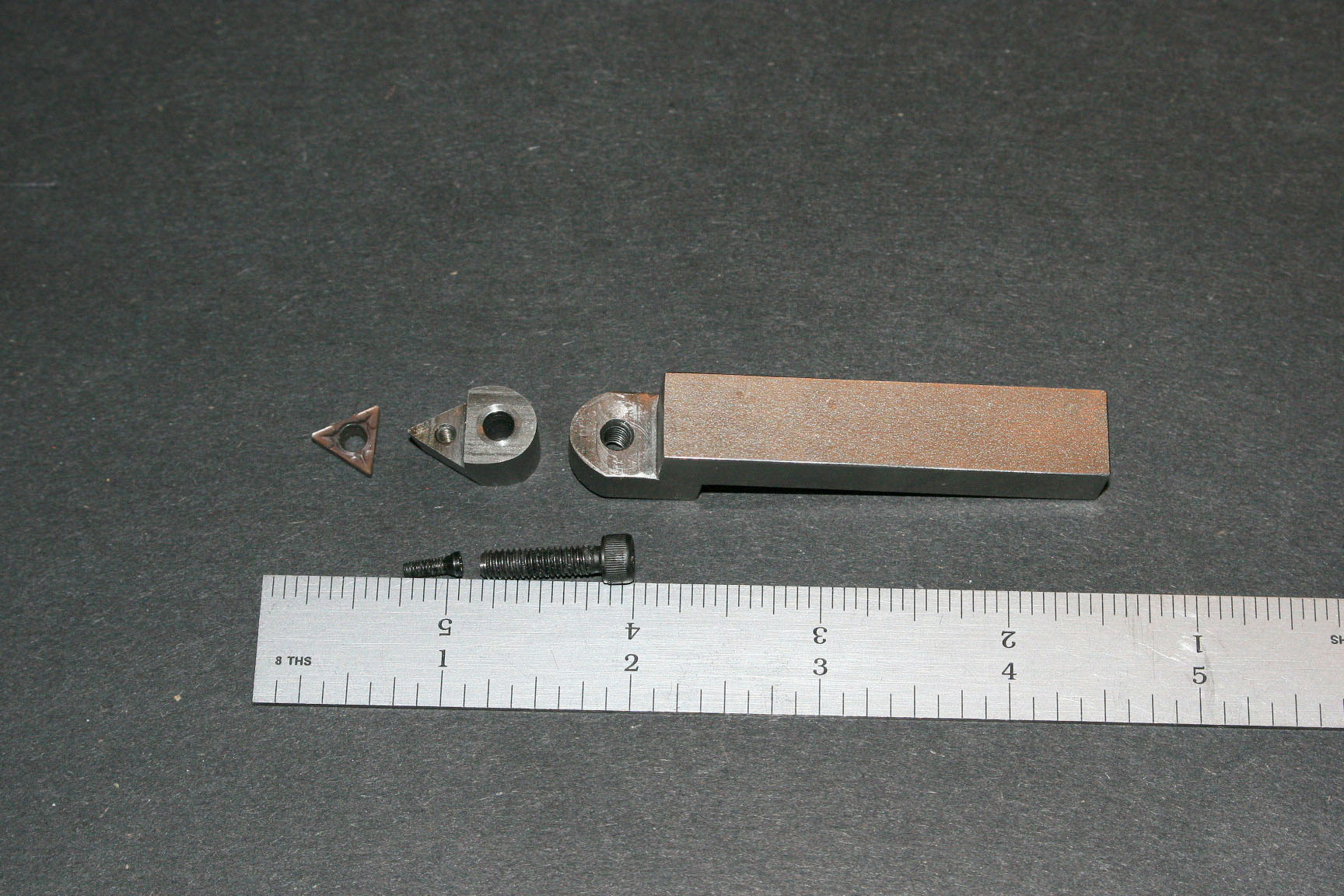

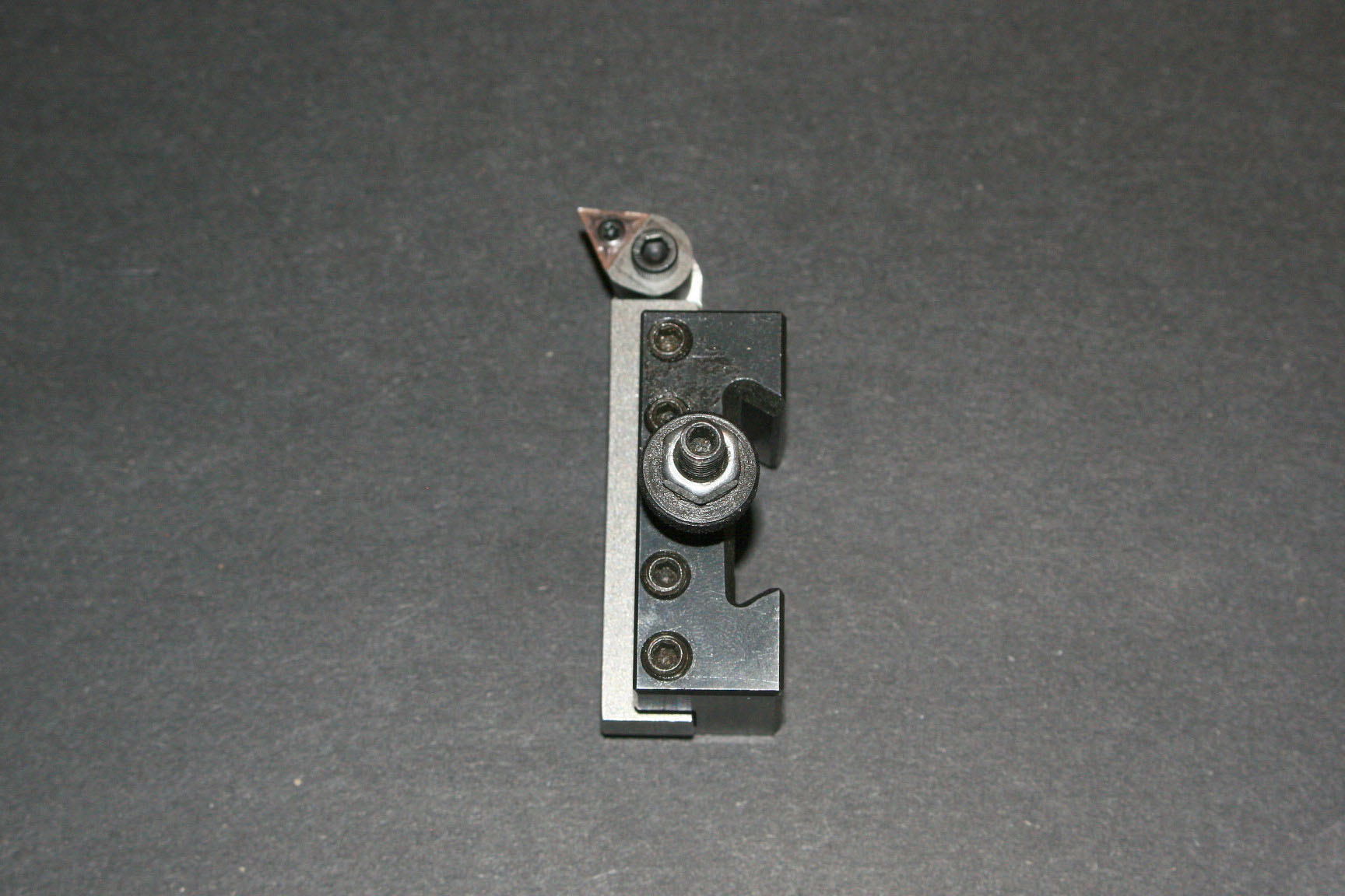

    I saw this on line while watching a video and it looked so good I had to make one.
    The demo that I was watching was using an Aloris cartridge insert tool bit.
    This unit could be set to various angles in multiples of 15 degrees.
    I wanted mine to be any angle! So I left out the cogs and just made a smooth cartridge.
    I am using TCMT carbide bits but HSS bits are available and I am waiting for mine to arrive.
    I cut a steel rod in the lathe. Faced it, turned a shoulder, made a chamfer, and turned a cylinder without
    changing the tool bit. On my mini lathe I made cuts of .020 infeed or .040 material removal per pass and
    the operation went smooth without the insert moving and without chatter. What more do I need?
    TCMT insert use an M2.5x.45 tapered screw..(get mine from LMS)
    The cartridge is retained with an 8-32 allen cap screw.
    So here a couple of pics and my simple drawing of this versatile tool bit.
    Make one, you will love it.
    Cheers, JR

    Thanks Jon. The tool is turning out to be very useful. I have used it along with a cutoff tool and threading tool
    on my latest project and the three tools mentioned are the only ones I have needed. The tool post stays square and
    it makes the quick change tool post "Quick". Much quicker than when I used bits and kept changing the tool post angle.
    Thanks for the gift cert. It will be converted to Inserts!

    Indeed. For about $300.00 you can buy the commercial one. It is bigger but my lathe is smaller.
    Mine cost about $2.00 and maybe half a day to make..
    Fast becoming my "go to" lathe tool bit.
