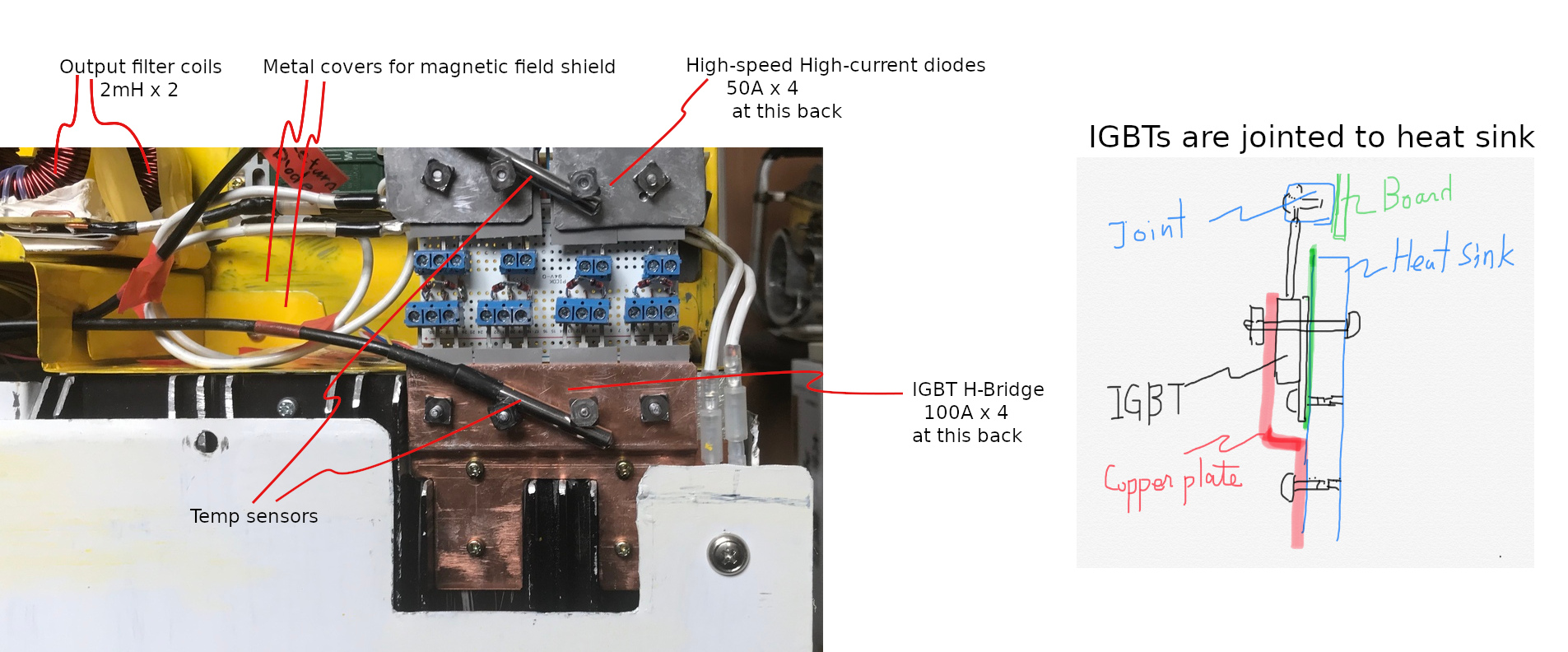

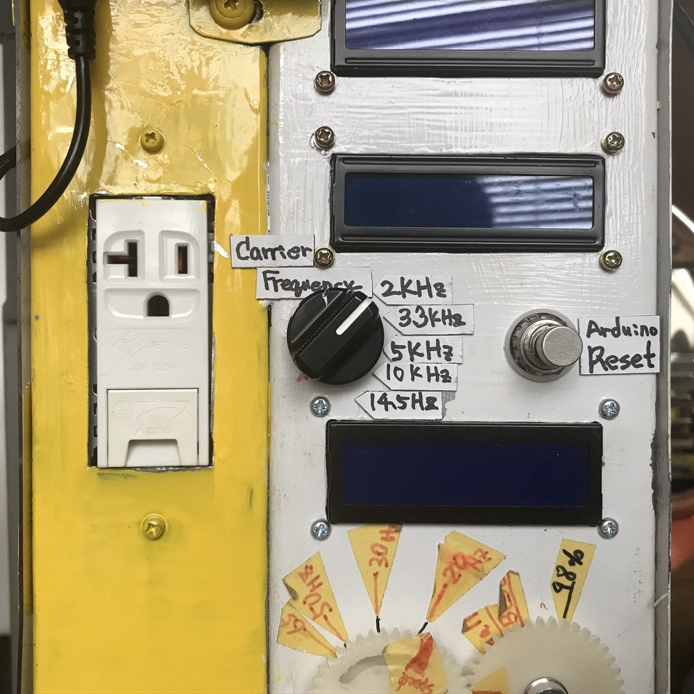

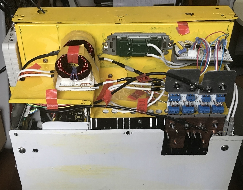

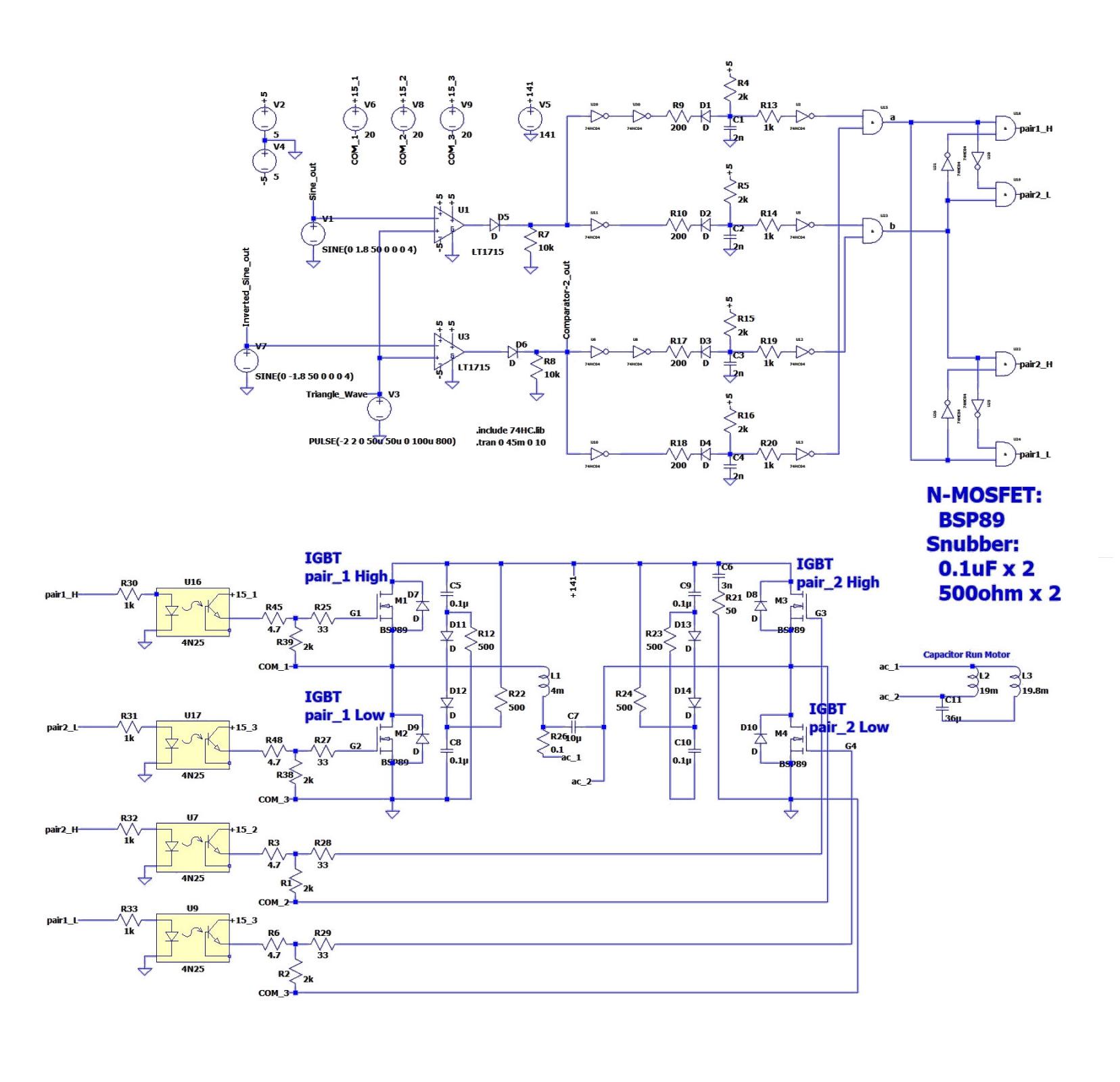

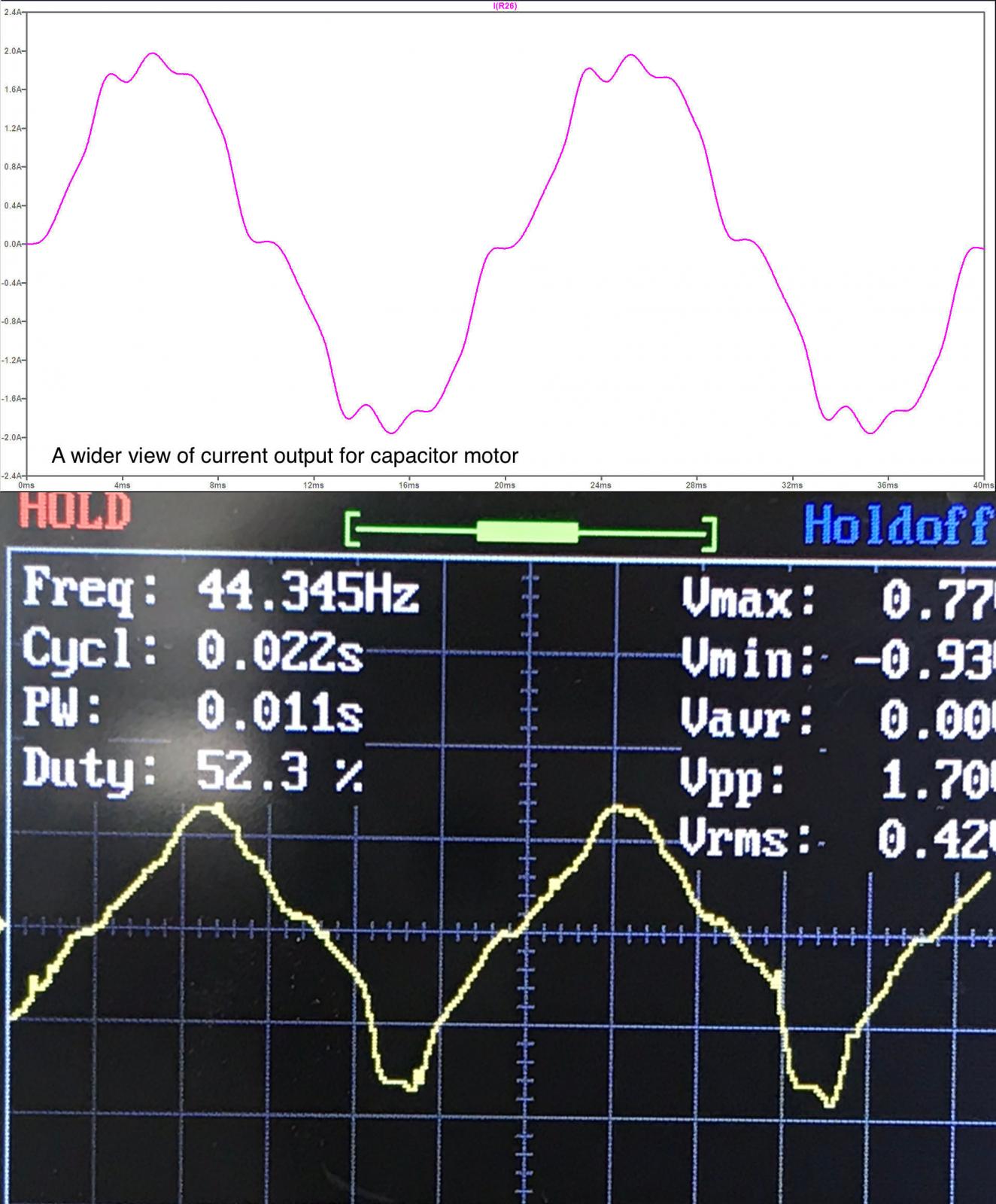

    Last year we had a very hot Summer and Autumn so had a presumption that we should need a very big fan in our shed to get our job easier this year.
    This motivation gave me a way to build a single phase Variable Frequency Drive for a bigger fan motor!
    Fortunately or unfortunately we have cool Summer now, so not yet get a new big fan yet, nor have a chance to run this VFD...
