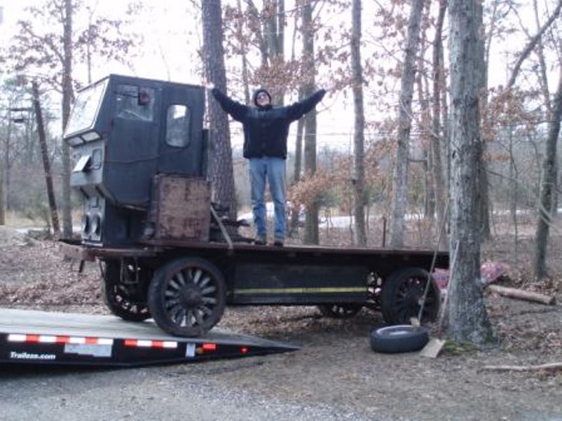

    That truck appears to be a CT electric probably a 1 ton or maybe a 1 1/2 ton
    A friend of mine owns one and it will be brought to me in the upcoming months to either store or hopefully we will go ahead and restore it
    here is his take on the history of the CT electric trucks ha has dome some extensive research on the matter
    20 CT Electric's were used during the night time hours from 1916 up into 1962 to haul 10 ton loads of paper and two hauled coal. Mine was number 14 and was used to haul coal. At least I believe so based on the piles of small coal chips found everywhere in the cab. This truck sat outside for too many years.
    The truck is powered by four 60V 200 AMP GE electric motors. One on each wheel. Each motor should produce 16 hp for a total of 64 hp. The truck is geared out to 12 MPH.
    It was purchased from the 3'rd (4th) owner, depending on how you want to count them. The first owner was the Curtis Publishing Company. The second was an individual who completed a two truck purchase from Curtis, numbers 14 and number 16. It was then sold to a gentleman who intended to restore it but passed away before any thing was done to it. One of his relatives inherited it and I purchased it from them. Or so I think. I also received the very first title the state of PA. issued to it.
    This is the truck when I picked it up. Everybody tells me its so ugly only a mother could love it so I guess I'm a SAP I think it looks neat. It's been called the vending machine!
    I found this interesting link to an engineering handbook from 1921 and it has a lot of information on electric vehicles prior to 1921. I purchased the book and I'm waiting on the mailman.
    I've decided, at least for now, that I'll preserve it rather than restore it. Its a unique piece of American history and I'd like to preserve that as it existed. My plans are to replace the wood bed around the edges. Red Oak 2" thick, that'll be needed to refasten the steel band that goes around the edge of the bed. Theres a 1/4 inch steel plate on top of it. Next I'm going to see what I can do to rejuvenate, rebuild or what ever is necessary to get the batteries back into working condition. The batteries have always been rebuilt vs replaced. Huge wooden battery boxes. Nine in all.
    I've removed the cab and I intend to set it up as a display on the back of the truck. It'll help show the changes the truck went through during it's life. Charlie Wacker designed the cab he was a long time ATHS member and has passed on. There is quite a bit in print about him and his family's truck body building business and I'll post what I can as I find it. Heres a little teaser,,

    Thanks for that write up Frank. What type of batteries are in your truck?
    Cheers Phil
  6. #1654
    12,610
    2,677
    Quote Originally Posted by 12bolts View Post
    Cheers Phil
    Its not my truck it belongs to my friend who owns the Prevost RV
    The batteries are the original Edison batteries and are over 100 years old out of the 9 batteries I think he said that at least 6 of them were still in rebuildable condition.
    they are nickel iron or Ni-FE the same type that were used in submarines for a long time.
    he had decided that after he sells his house in CT. he and his wife are thinking about picking out a spot in the North woods where I have a meadow like clearing pour a pad there and he and I will build a pole shed for them to park the Rv under for when they are not traveling playing merry campers
    I have done some preliminary research on the Edison batteries and believe that I can duplicate them if he decides to restore the CT rather than just preserve it This part of Texas is a whole lot better place to preserve than the salt humid air of Connecticut where it is currently located
