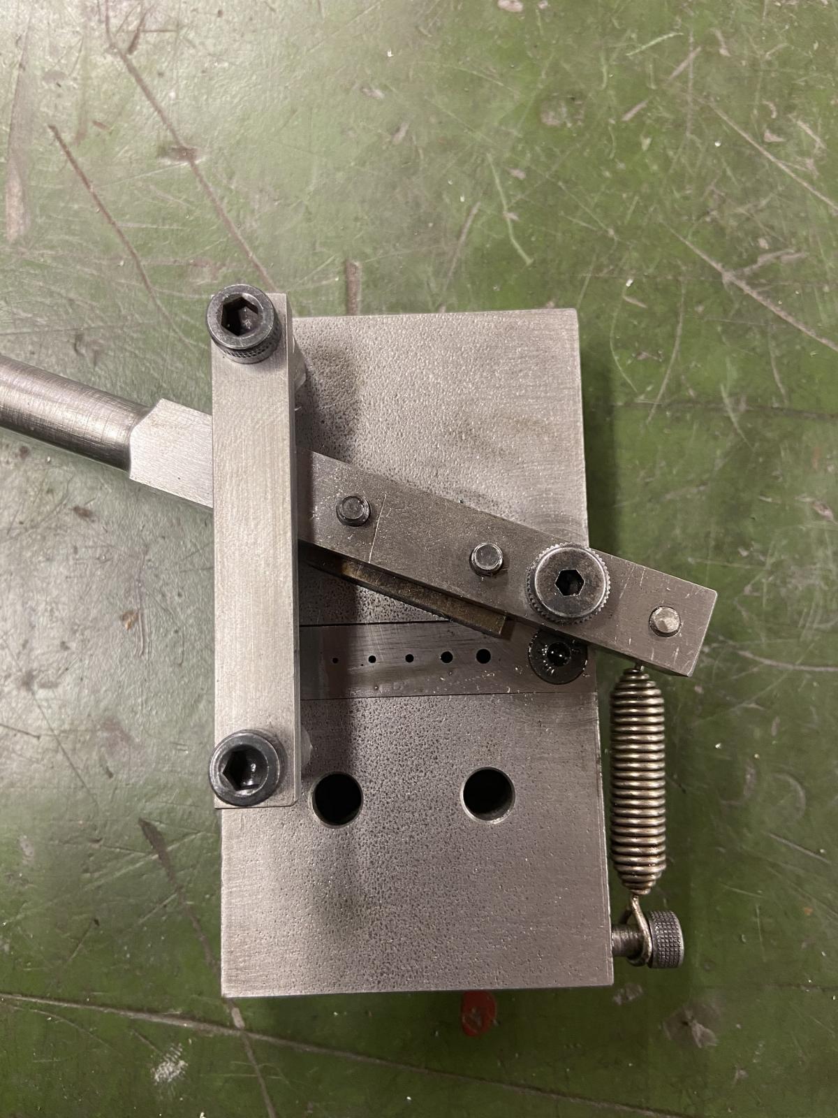

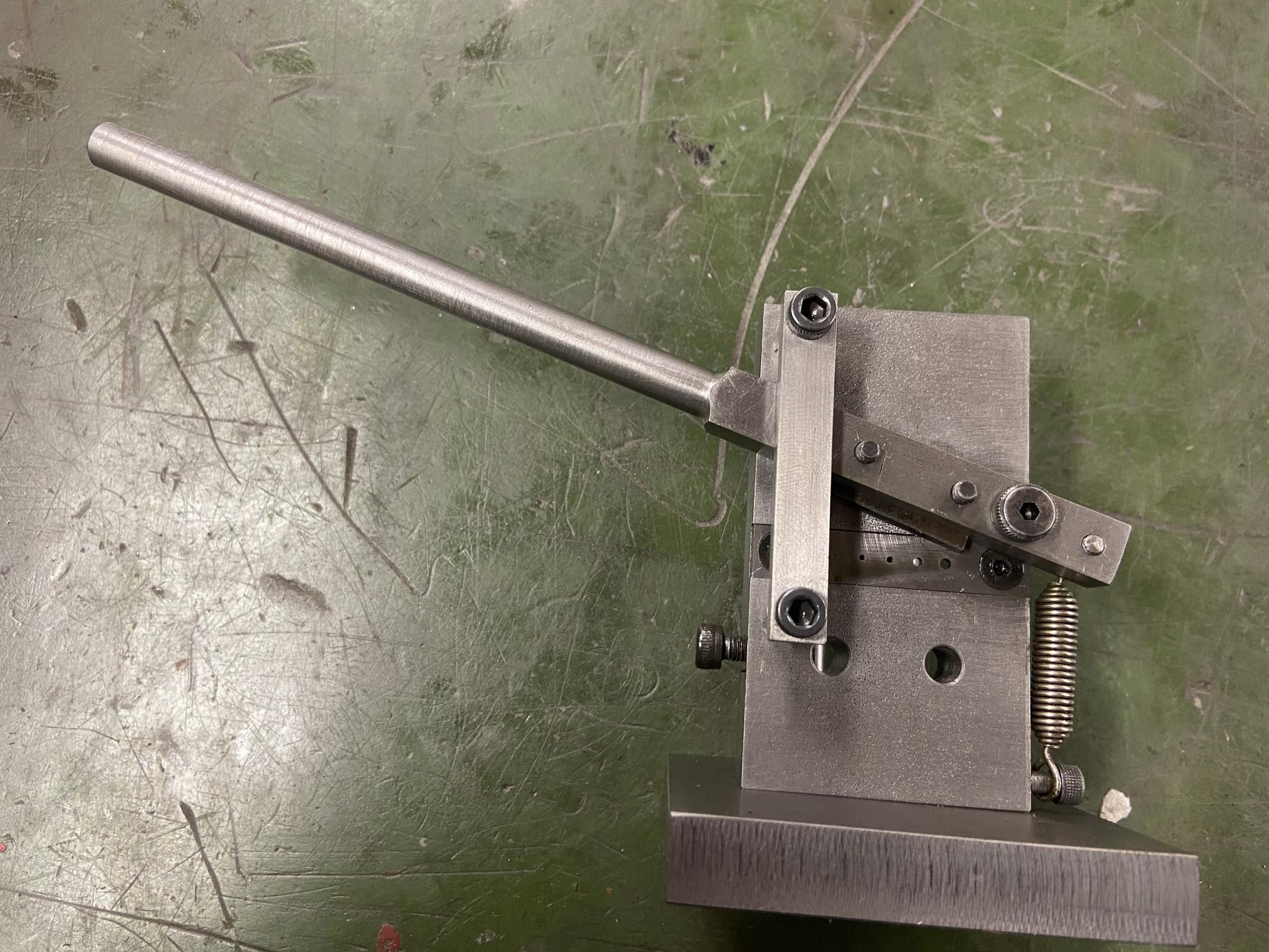

    Hi All
    Following on from the chains I made for my 1" traction engine Re-think on wire bender for making chain links I thought I would share the wire cutting guillotine I made to support the manufacture of the chain links.
    There are commercially made wire cutting guillotines mainly used in the jewellery trade that can be purchased from the normal websites, but reading the reviews I decided to make one that would be a little more industrial for my purpose.
    The criteria for the tool was to be simple to use and a stop that could be accurately set. The cutting blades to be made interchangeable so if worn or damaged can be replaced. Commercially made cutters don't offer this so once worn the whole tool will need to be replaced.
    The stop on my guillotine is set by using slip gauges.

    The stock material is a combination of mild steel and gauge plate. Stock metric screws and spring also used in build.

    Main body and base. The base allows for the tool to be held in bench vice.

    Completed tool
    Wire cut to length.
    I hope this is of interest and thank you for viewing.
