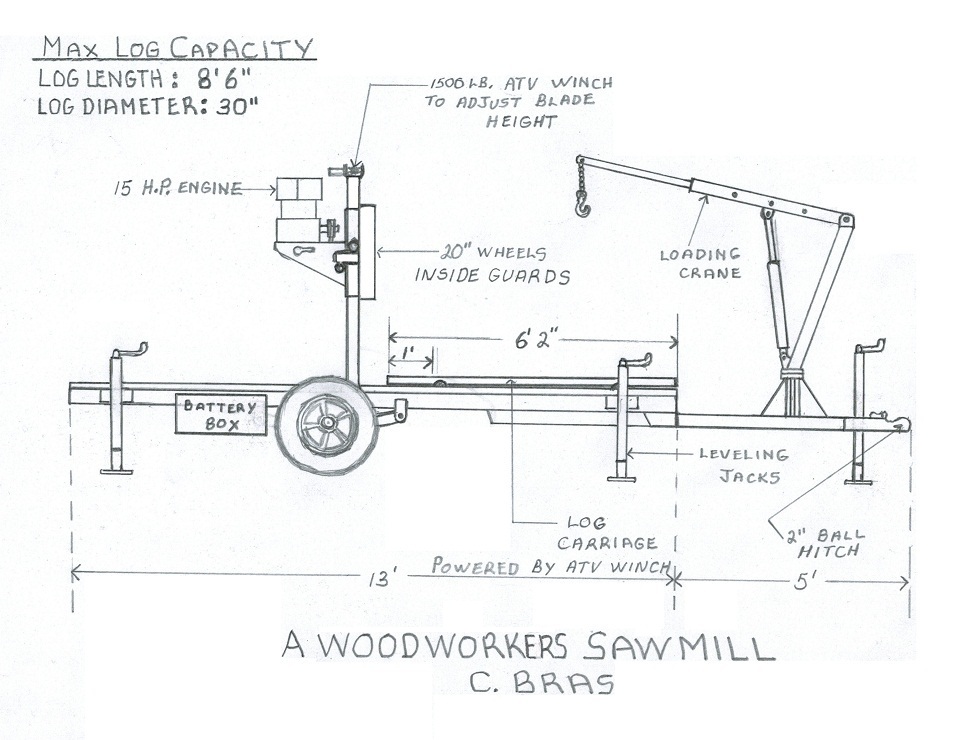

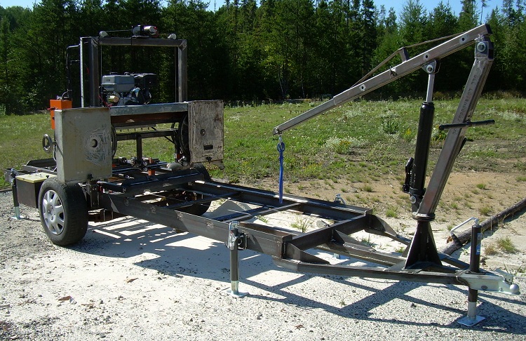

I have wanted to build my own design of a home built band sawmill for as long as I can remember. Last summer I finally got to it. I have little need for construction length lumber. My desire is for shop project wood. For the occasional need for stud length lumber I set my maximum length to 8’6”. This will allow me to use a traveling carriage rather than a traveling arch and still limit the trailer to 18’ including the towing A frame. Here was the initial concept drawing, I like to build by the seat of my pants, according to the many salvaged parts I have collected over the years, so there is not a lot of detail, but the main features are listed.

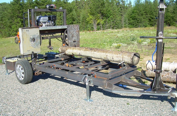

Here the mill is finished except for the paint. Took it outside for a test run. First log is loaded on, with the built in hoist for log handling, a 12" Poplar log.

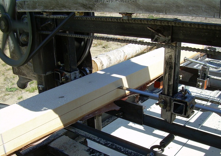

Cutting a board off of a 10" squared up Birch log.

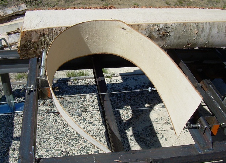

How accurate is the carriage method? This is a 1/16" slice of Birch veneer. Could have gone thinner, still lots of strength.

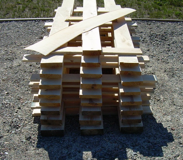

The afternoon went without an incident. The result a little less than 200 board feet. Bottom thicker boards are Poplar and Spruce more than half are clear Birch.

All done ready for paint. The intention was to get it painted before the snow set in, but winter came early, and it will be one of the first "to do's" when the warm weather sets in.

Wow! That 1/16 piece of Birch is beyond impressive! I have a large metal cutting band saw with transmission that I have been saving for just such a project so my interest/respect comes from the heart. Thanks for sharing!

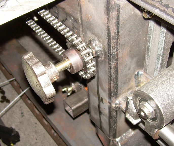

I see some roller chain in one pic, Is it for adjusting the distance between blade guides? Great build should look real good with a coat of paint, not to say it looks at all shabby minus paint, just the cherry on top. Thanks for posting.

Hi suther51, The roller chain connects two sprockets which lock the head to both columns after setting the cutting height. There is a handle welded to one of the sprockets so the head can be locked from the operating position. Heres a picture:

Thank you stilldoinit, good luck with your mill, if you don't require construction length lumber you might want to consider the carriage system I talk about. It's easier to build, the cutting head is stationary for more accurate cuts and the carriage has a larger stance on the track also for less track defects transmitted to the cut. Like most things there is always a trade off though, for 16' + construction length lumber the trailer frame would be very long. With modern technology, sawmill machinery has changed, but older mills still run carriage systems running on heavy gauge RR tracks and powered by 20' long steam cylinders to feed the carriage past the giant 60" bandsaw heads.
