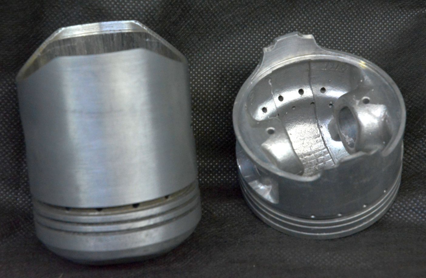

One method of holding a piston for "after manufacture" machining is to make some soft jaws to hold the piston by the ring grooves, but there is an easier way applicable to some pistons. These are ones which have an internal register left from the original manufacturing. The MTC piston was in that category.
Here are a couple of examples of the internal register. The Suzuki one on the right has a full circle register. Click thumbnails for full size pix.
Attachment 42506

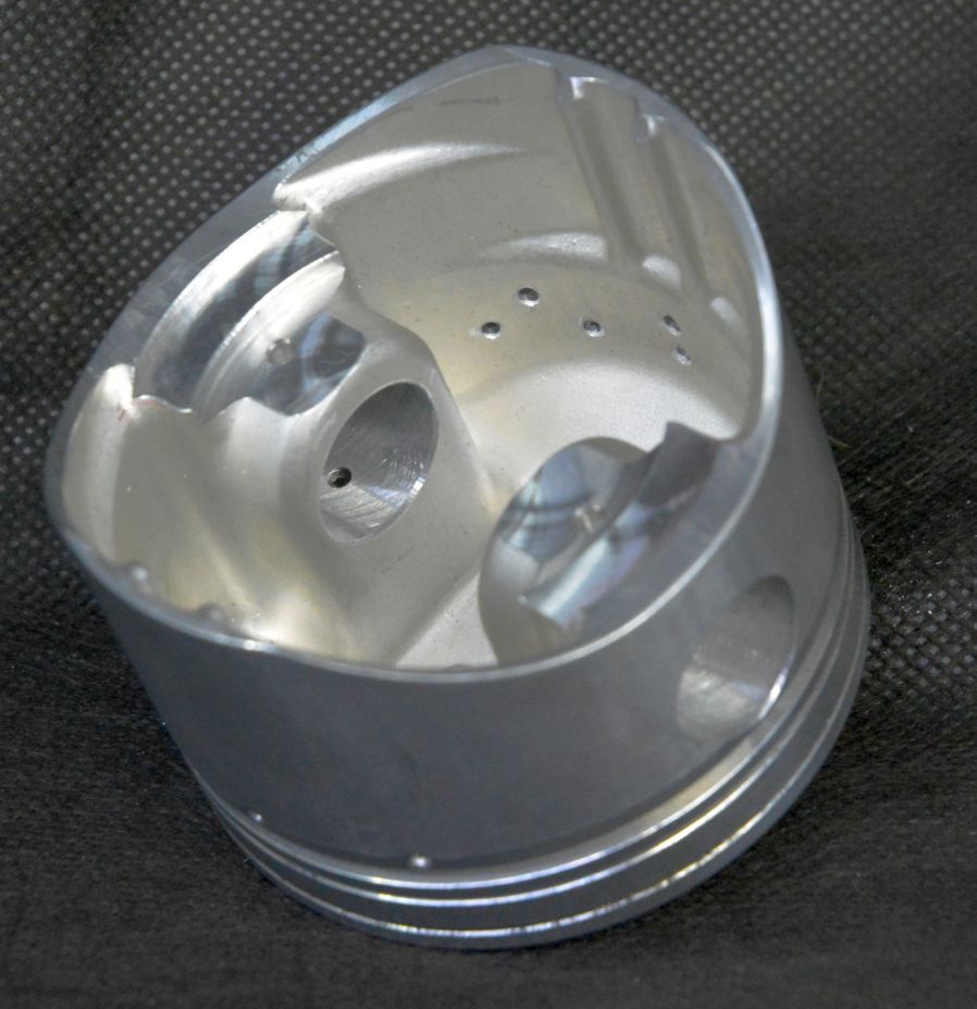

Here we can see the register in the MTC piston which I needed to attack.
Attachment 42507

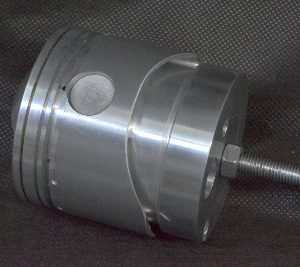

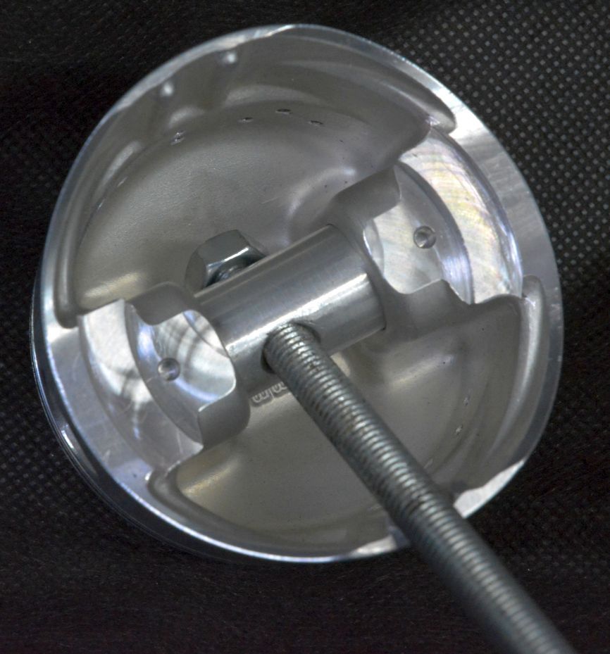

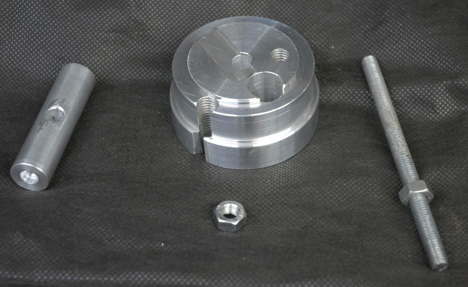

To hold this piston securely I turned a mating spigot on a piece from the scrap box to fit the piston, which had enough length to hold in a chuck. The extra holes in the piece were there already but have no ill effect. I also turned up a dummy gudgeon pin with a hole in the centre to pull the piston onto the block. Here we can see the parts for this simple tool or fixture.
Attachment 42508 Attachment 42509
Shown here is the piston mounted on the block ready to be chucked in a lathe or held by a myriad of ways in a milling machine.
Attachment 42510

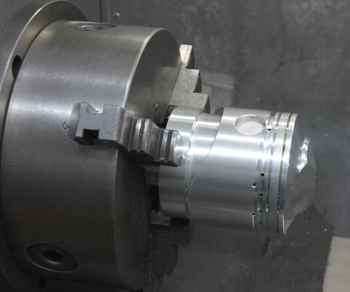

Although it restricted me to an axi-symmetric shape I went for machining in a lathe because of its simplicity, shown here is the assembly chucked ready to machine.
Attachment 42511

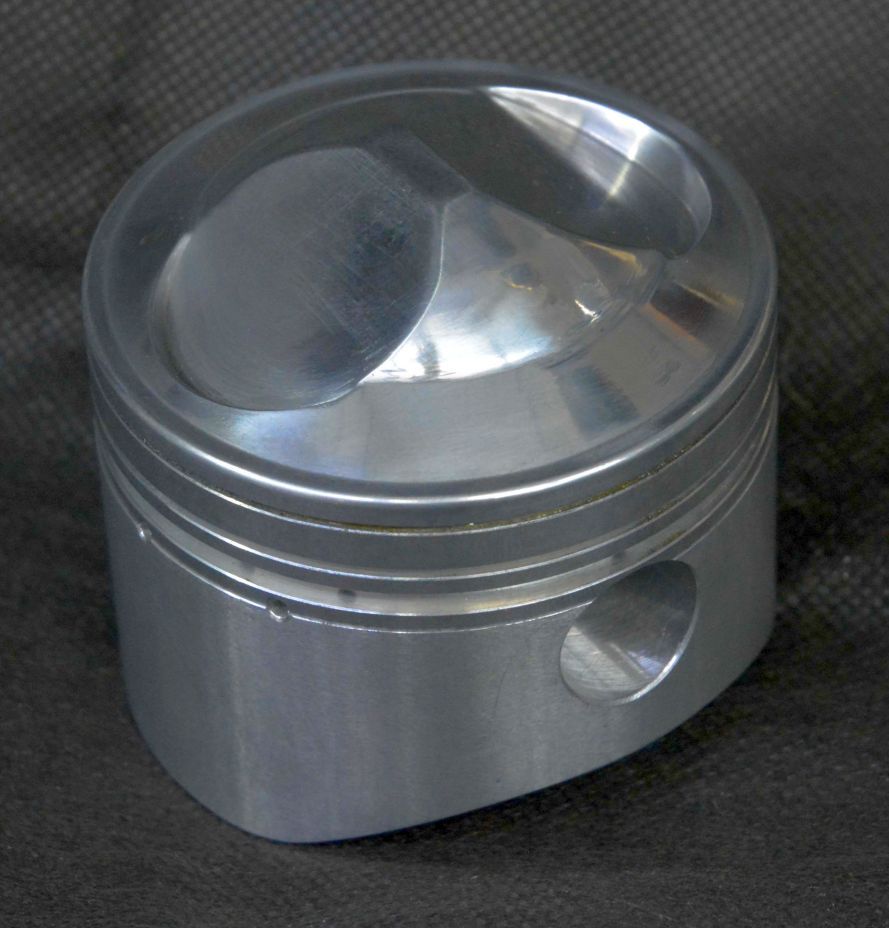

This is the final result.
Attachment 42512

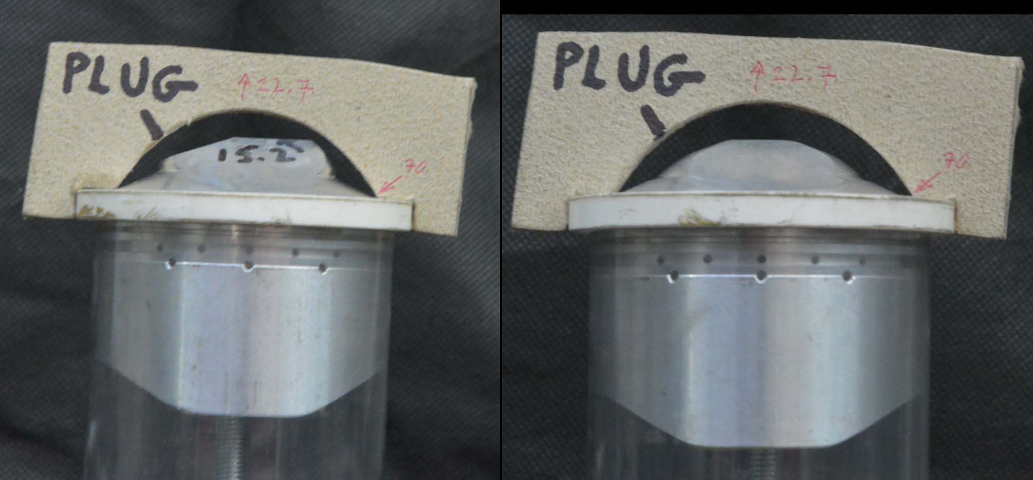

Here is a before and after profile of the crown relative to the head shape.
Attachment 42513
You can see that there is more space around the plug and less restriction for the flame front to reach the other side, thus reducing the likelihood of detonation.
