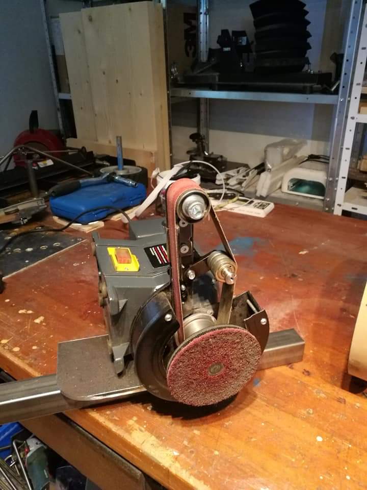

    Simple improvements. Bigger pulley for higher speed and belt tensioner. Still without welds or lathe. More info coming later.

    Very nice conversion. I think an angle grinder with a cutoff wheel is one of the most useful tools ever created.
    Though it's a non-standard practice I wonder if the belt grinder might be better with the tension arm and roller on the bottom side so that the backing platen isn't lost on the grinding side. It seems like a rigid enough design that the tensioner could work on the power side of the belt.
  7. #5
    Jun 2016
    Jyväskylä Finland
    832
    558
    Thanked 1,839 Times in 507 Posts
    Tuomas's Tools
    Quote Originally Posted by Crusty View Post
    Tensioner is symmetrical, so it can be placed to bottom side too.
    This is still "wip". Backing plate will be mounted later. Stay tuned, to see where i planned it.
    Your toughts would work nicely too.

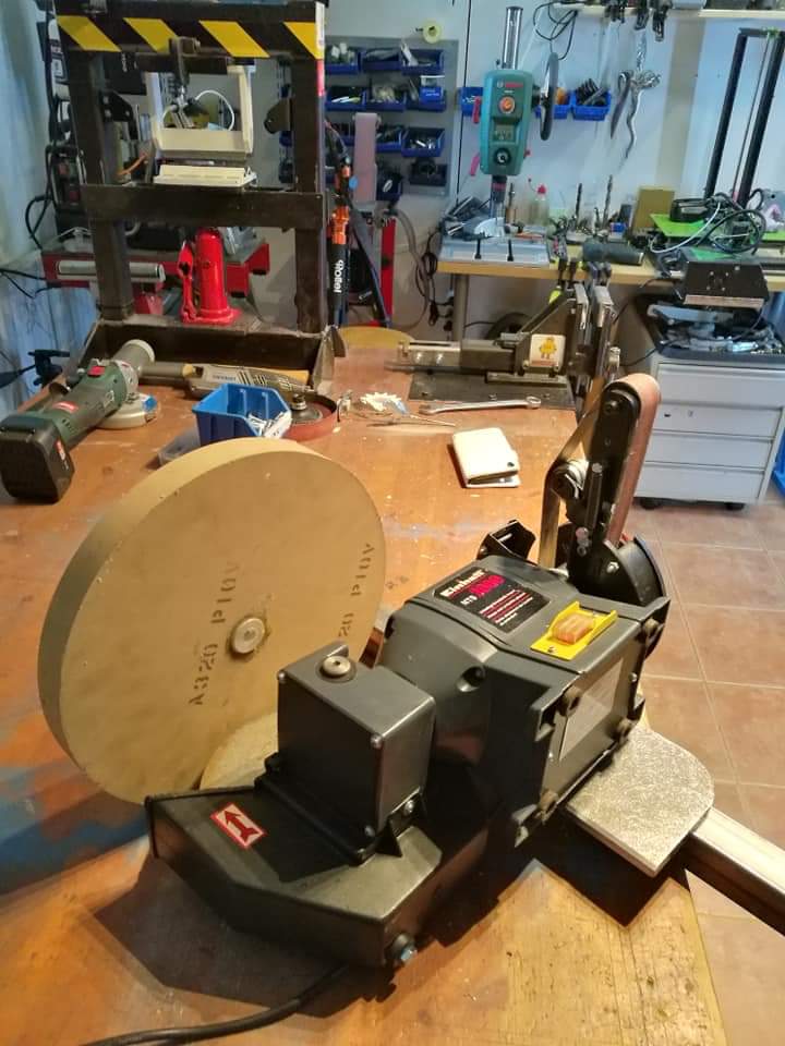

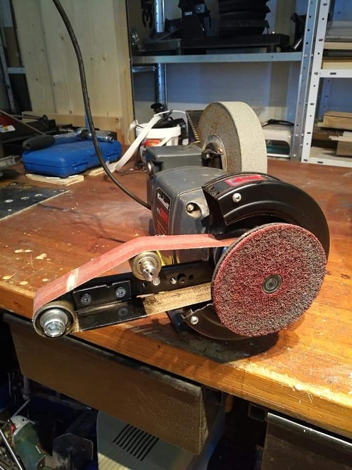

    Here is what i planned..
    Easy "bench grinder to belt sander" no welds, or lathe..-fb_img_1560429172565.jpg
    Back plate is placed to bottom side..
    Easy "bench grinder to belt sander" no welds, or lathe..-fb_img_1560429180514.jpg
    Because i will make a stand for it, and tilt grinder 90 degrees.
    Then i can use both sides of the belt. Straight surface, and also those both curved spots on wheels, to shape / finish curved pieces.
    Easy "bench grinder to belt sander" no welds, or lathe..-fb_img_1560429188468.jpg
    Also, i will tilt grind stone mount 90 degrees, and replace old stone with bigger and finer grade stone.
    What do you think about that?

    It's standard engineering practice to put a tension roller on the portion of the belt loop opposite the portion that's pulled by the motor, but like I said your tensioner looks rigid enough that I don't think it matters. I like to have a platen under a belt to prevent it from being deflected too much and rounding the apex of an edge. This is a well done conversion and if my grinder had enough guts I'd be doing it to mine.

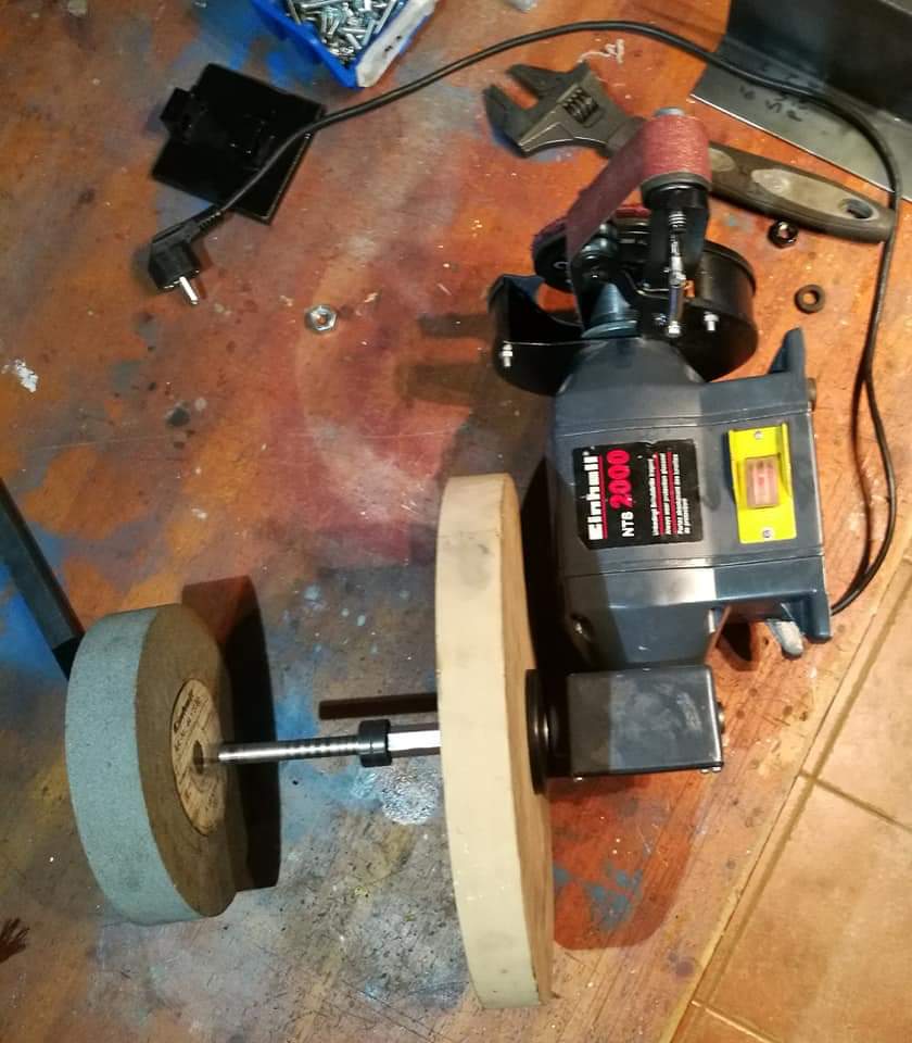

    Here is couple pictures about "wip"
    Tilted the head. I had to relocate two mounting holes, it wasn't made symmetrical as i hoped. But that wasn't a problem.
    Easy "bench grinder to belt sander" no welds, or lathe..-fb_img_1560531678503.jpg
    Easy "bench grinder to belt sander" no welds, or lathe..-fb_img_1560531688095.jpg
    Because new stone is heavier than original one.
    I decided to add extra bearings to support it, to the left side.
    Idea seems to work, now i just need to finish the stand and workpiece rests.
