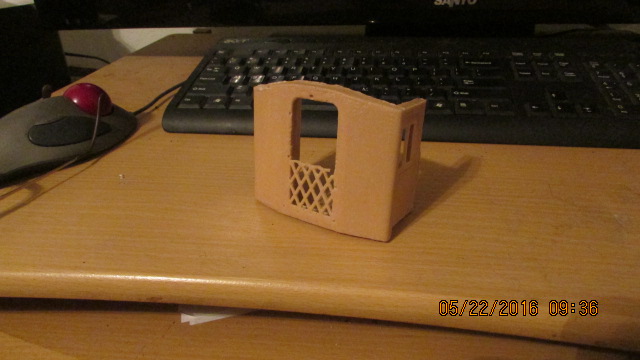

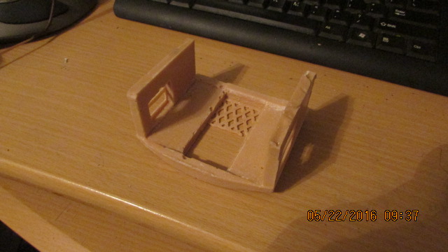

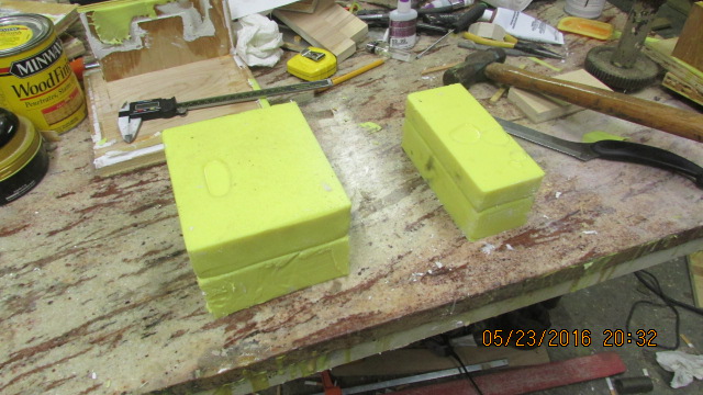

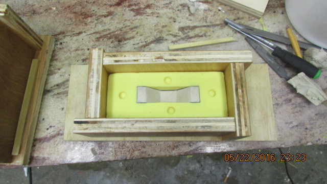

    Here is a part that I made to establish the body or thickness of the part and then I will make the second part of the mold. Bob.1/32 model train car mold procedure-img_0467.jpg1/32 model train car mold procedure-img_0466.jpg

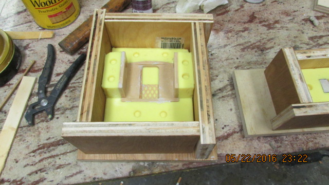

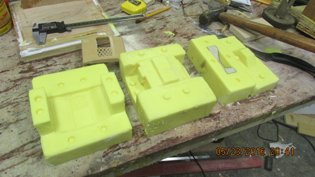

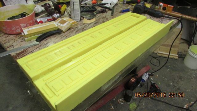

    These are pictures of the mold ready for the second part for the steps and ends, and also the finished two part mold for the sides, Bob.1/32 model train car mold procedure-img_0465.jpg1/32 model train car mold procedure-img_0464.jpg1/32 model train car mold procedure-img_0468.jpg1/32 model train car mold procedure-img_0469.jpg

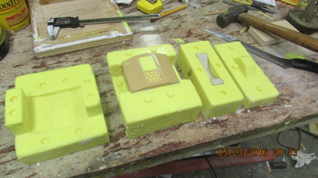

    Some more molds
    Here is the second part of the molds poured and ready to make a part. Today I will get back to the trucks and program the spring arms for the truck, and am looking for bearing for the trucks, any ideas? Bob.1/32 model train car mold procedure-img_0470.jpg1/32 model train car mold procedure-img_0471.jpg1/32 model train car mold procedure-img_0473.jpg

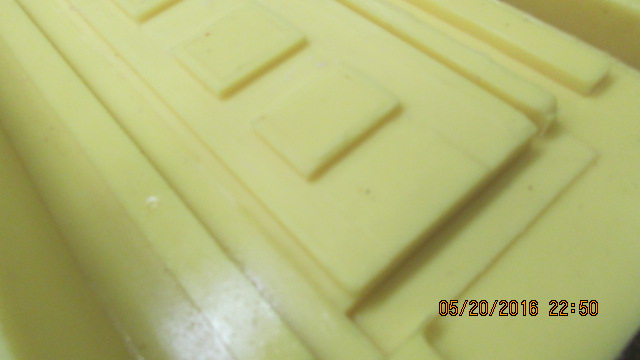

  11. #17
    Supporting Member machiningfool's Avatar
    Jul 2015
    Seffner Florida
    275
    Thanked 295 Times in 151 Posts
    machiningfool's Tools

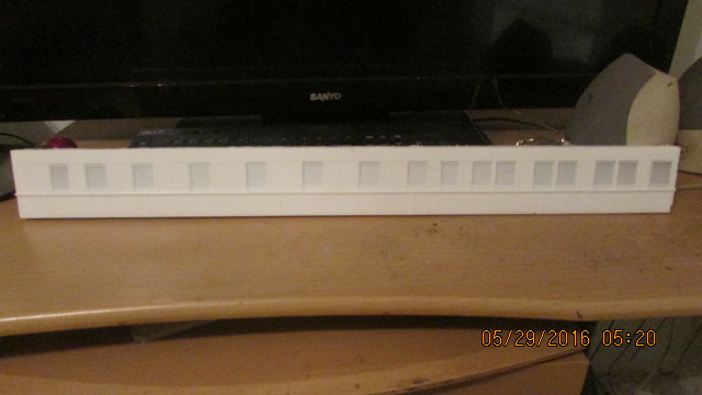

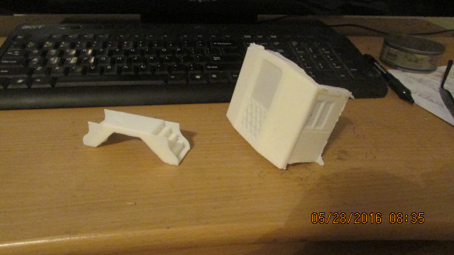

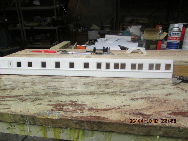

    I poured some parts and they came out good, here are some pictures. Bob.1/32 model train car mold procedure-img_0476.jpg1/32 model train car mold procedure-img_0475.jpg

  13. #18
    May 2014
    Del Mar, California
    1,232
    5,820
    Paul Jones's Tools
    Bob,
    Thanks for the tip about using a spring loaded pen for doing your part QC. The cast sides, ends and steps look crisp and well made. How do you open-up and clean-up the car window openings? What do you use for paints now that the fine scale Testors “Floquil” line of paints has been discontinued?
    Thank you for your progress report.
    Paul
  14. #19
    Jul 2015
    Seffner Florida
    275
    Hi Paul. I cut the flashing out with a knife, cuts easily. I get the paint wherever I can find it, mainly on Ebay. I am using a hard plastic from Bity mold supplies and it seems to be very strong and as strong as the epoxy that I was using. This plastic flows better and fewer bubbles, so I really like it. Thanks, Bob.

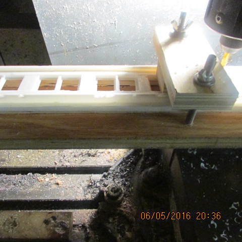

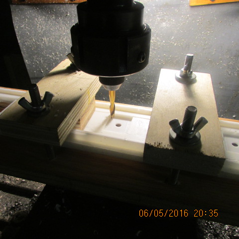

    Jul 2015
    Seffner Florida
    275
    Well Paul, it wasn't as easy as I thought to cut the flashing out of the windows.
