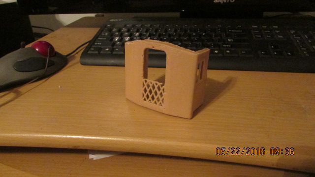

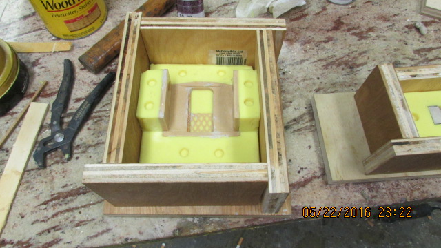

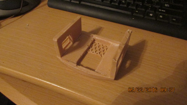

2 Attachment(s)
Here is a part that I made to establish the body or thickness of the part and then I will make the second part of the mold. Bob.Attachment 10803Attachment 10804

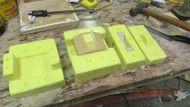

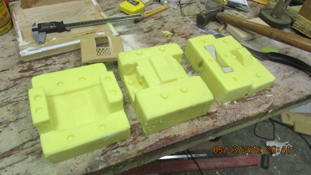

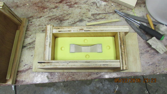

4 Attachment(s)
These are pictures of the mold ready for the second part for the steps and ends, and also the finished two part mold for the sides, Bob.Attachment 10820Attachment 10821Attachment 10822Attachment 10823

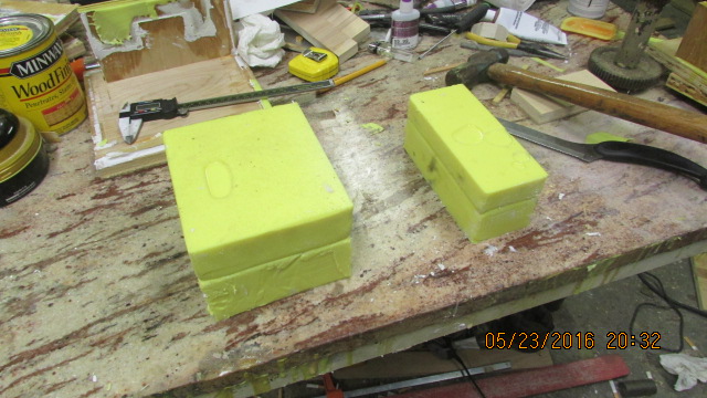

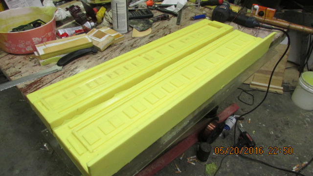

3 Attachment(s)
Some more molds
Here is the second part of the molds poured and ready to make a part. Today I will get back to the trucks and program the spring arms for the truck, and am looking for bearing for the trucks, any ideas? Bob.Attachment 10838Attachment 10839Attachment 10840

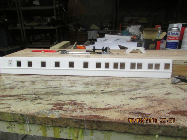

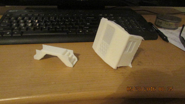

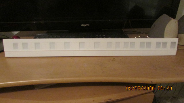

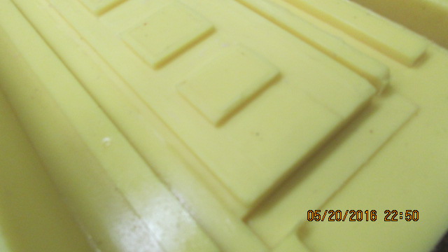

2 Attachment(s)
I poured some parts and they came out good, here are some pictures. Bob.Attachment 10941Attachment 10942

Hi Paul. I cut the flashing out with a knife, cuts easily. I get the paint wherever I can find it, mainly on Ebay. I am using a hard plastic from Bity mold supplies and it seems to be very strong and as strong as the epoxy that I was using. This plastic flows better and fewer bubbles, so I really like it. Thanks, Bob.

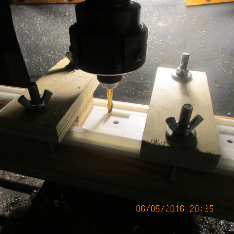

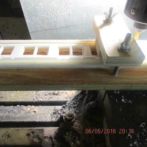

3 Attachment(s)
Well Paul, it wasn't as easy as I thought to cut the flashing out of the windows.
Attachment 11118Attachment 11119Attachment 11120 Here is something that I had to go through to get the correct thickness of the window frames because of the plastic setting up as I was installing the second part of the mold. The stuff was setting so fast that it made the window frames too thick so I had to machine them down on the mill. This probably wouldn't have happened if I had used the epoxy that I am used to, but I am trying new things. Here are some pictures of the setup on the mill, cutting the inside of the frames for consistent thichness. Bob.
