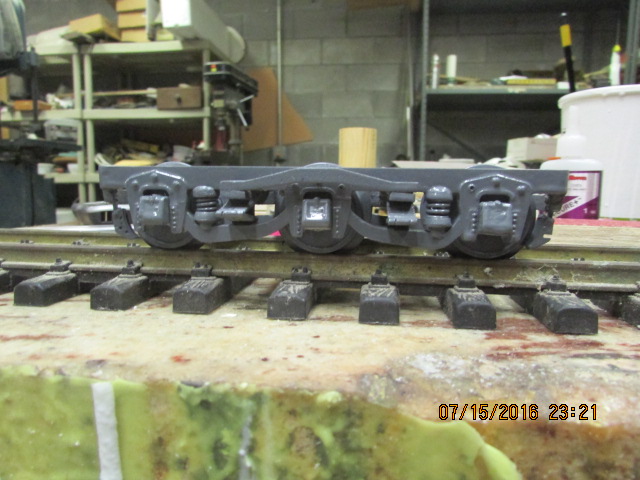

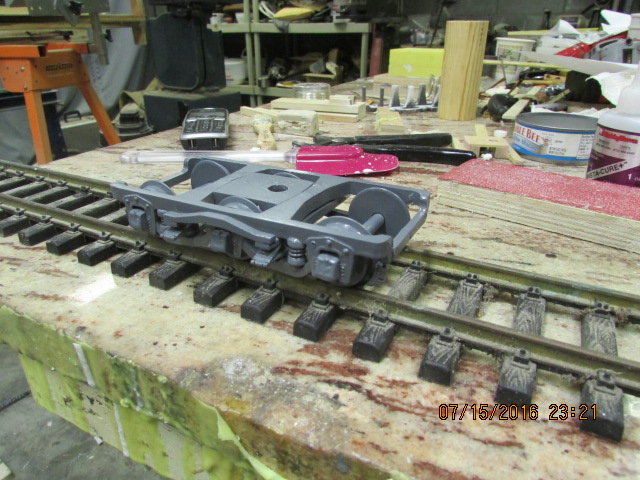

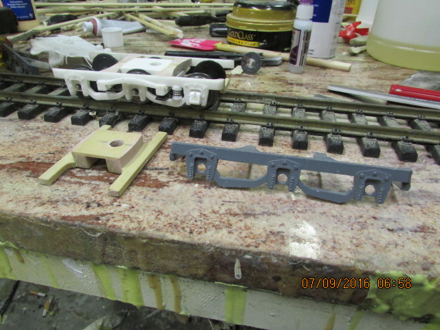

Thanks Paul, I have noticed that procedure helps. Attachment 12241Here are some more parts for the truck, still mocking up. *I combined the spring cross bars with the mounting plate, so it makes it a little easier to assemble. Bob.

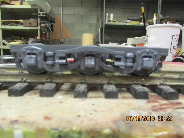

Thanks Paul. The mock up of the truck is finished, here is the truck. BobAttachment 12434Attachment 12435Attachment 12436
Bob,
The trucks look impressive. Looking forward to seeing these on the heavyweight passenger cars.
Paul
Thank you Paul. I am gearing up to make the cars shortly, Bob.

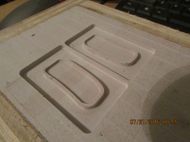

I have been trying to get the perfect shape for the F cab windshield and I made a pattern for a mold. The shape has been scaled from the full size to 1:32 and is made with the seal. I loaded the program on my Anilam controller and had to delete all of my other programs just to get this file on my machine, about 4000 steps.Attachment 12516 Here is the beginning of the operation. Bob.

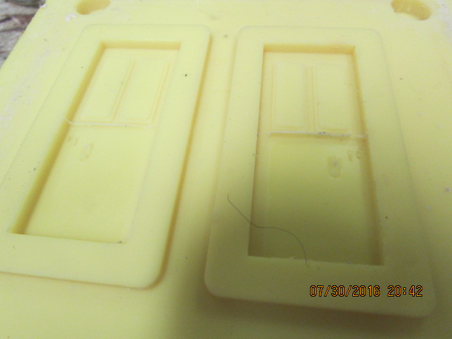

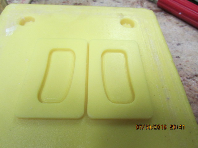

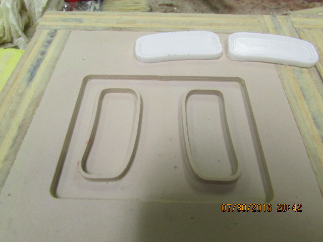

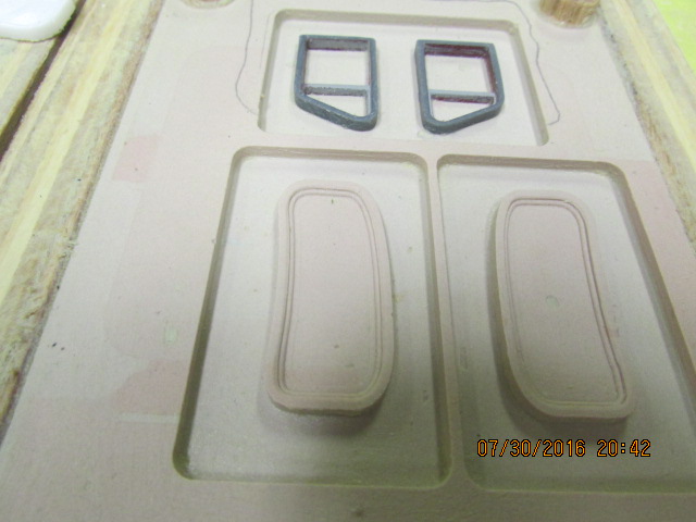

Here is what I have been doing in the last few days. I made a mold of the heavyweight doors so that they will open and be a split door. *I am still trying to make the perfect E and F series windshields. *I am trying to make the windshields, so that I may retro fit them into any one gauge E or F series loco. *I am designing them so that when installed in the loco, there will be no glass to make it easier for painting and then there will be a ring in the shape of the windshield, to be installed from the inside to hold the glass in. *I am using .020 Lexan for the glass, also making the side windows for the loco, and here are some pictures of the patterns and molds. Bob.Attachment 12766Attachment 12767Attachment 12768Attachment 12769

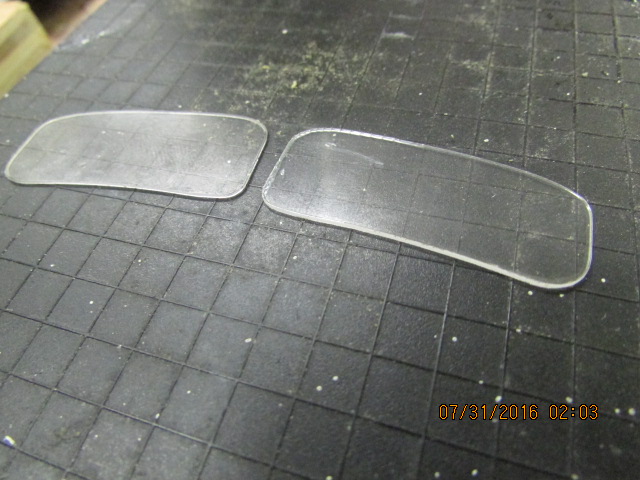

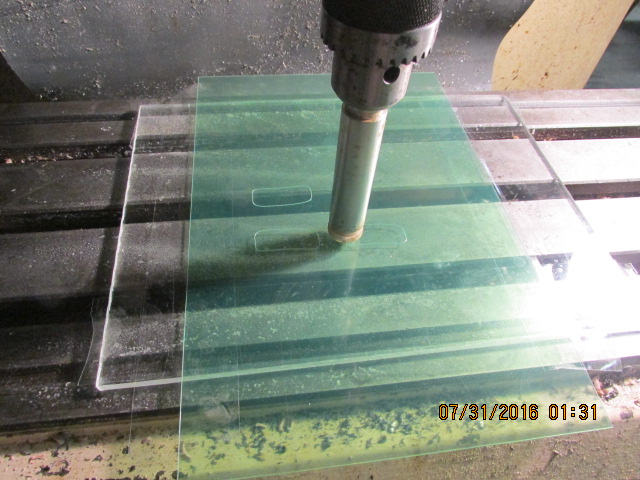

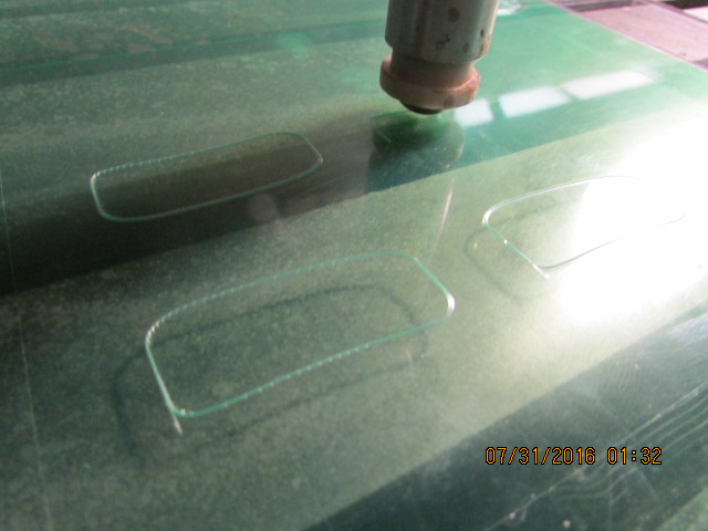

Attachment 12770Attachment 12771Attachment 12772 *Well here are the glass panels. *I cut them with a tool that I made, a vinyl cutter. *This tool was made to cut just .005 material, but I ran it through twice and it scored the .020 Lexan enough so that it broke away clean. They came out just like I wanted them to. *I have to draw just one more part to complete the assy. then I will attempt to install them in an MTH cab and the other cab that I made the mold for. Here are some pictures. Bob.
Bob,
I like your clever use of the "scoring" method with the CNC inscribing technique. This would be very precise for any type of model making.
Thanks Paul
I should have described the cutting tool a little better. The blade in the cutter rotates 360 degrees and protrudes about .005 in. The blade is mounted with a spring loaded pad and moves about .250 in. for uneven surfaces. The blade was purchased at a vinyl cutting supply store and adapted to my tool. Thanks Paul. Bob.
