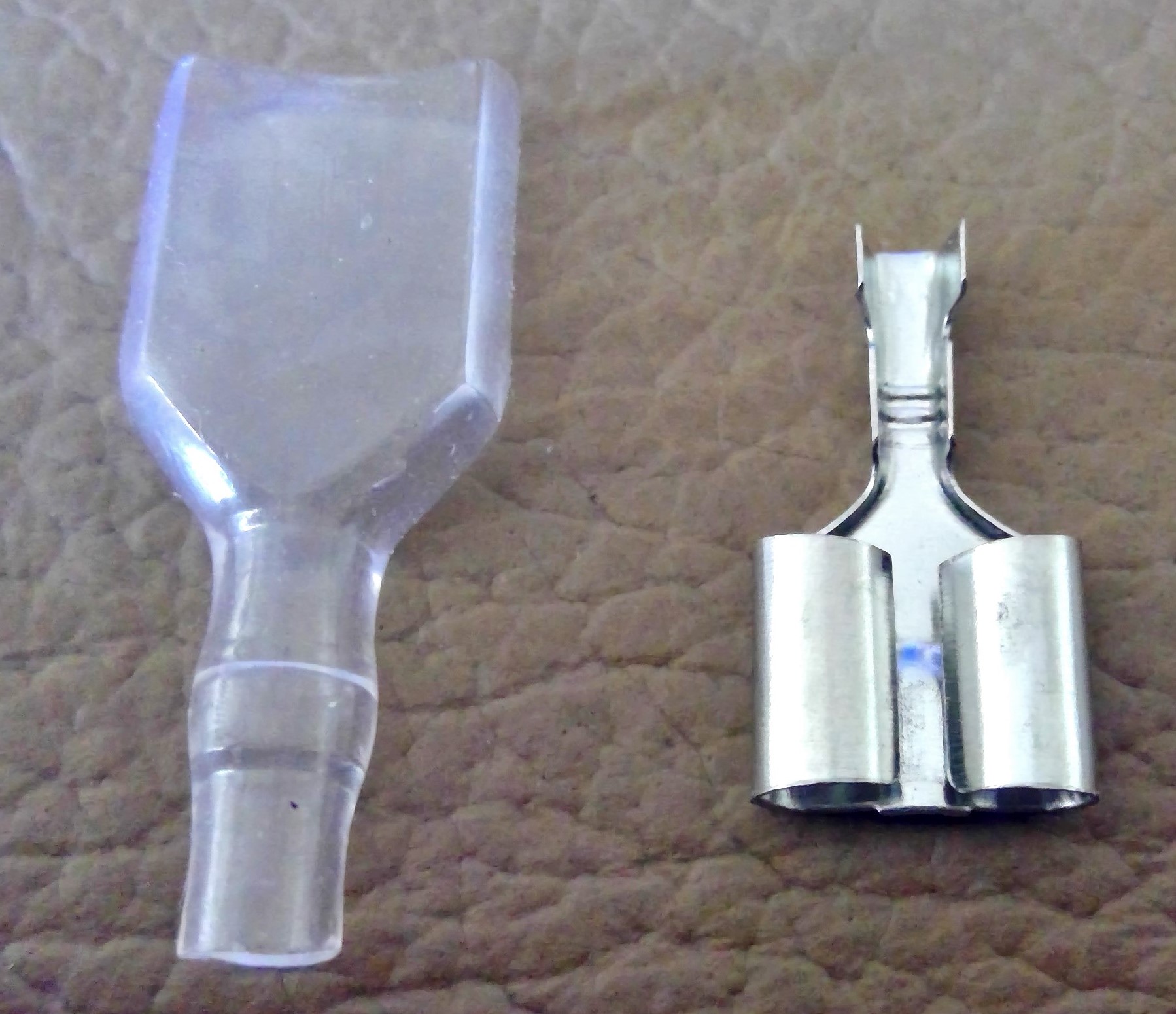

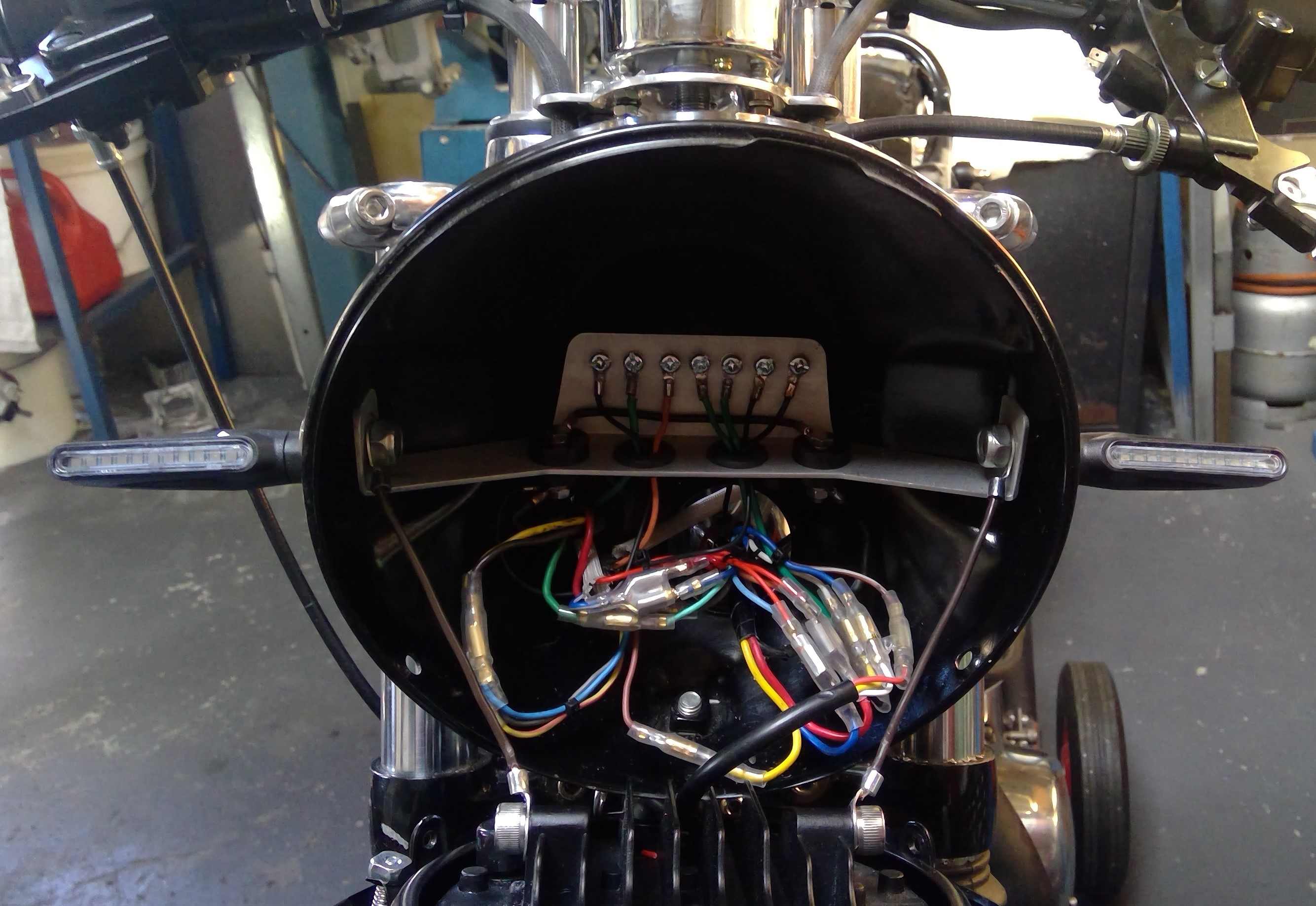

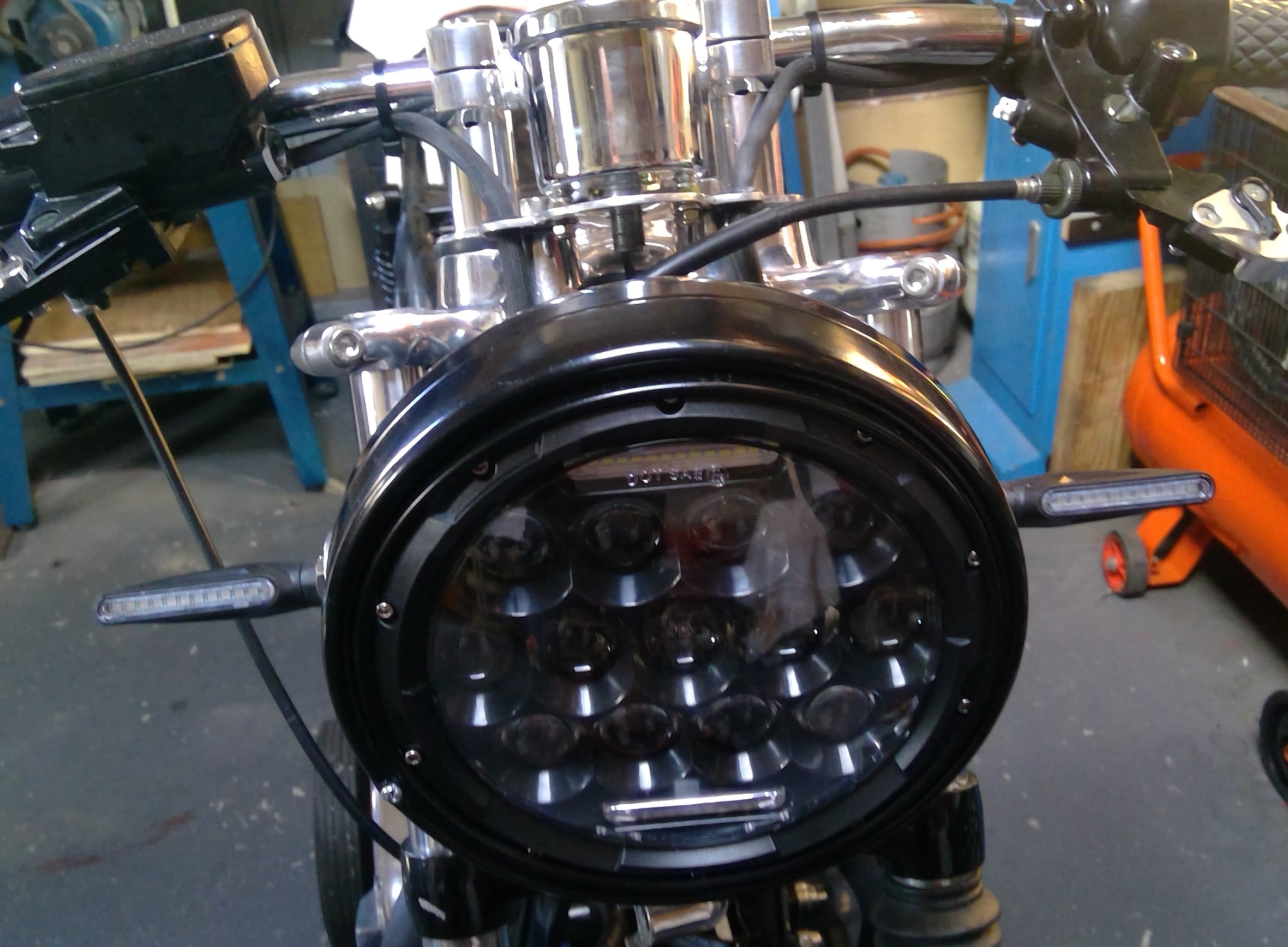

    Finished off the front wiring and spaghetti bucket. Still looks a little untidy, but neater than most I think. I even mounted the lens on a couple of wire safety straps to stop it pulling on the harness. I had, to buy these double female bullet connectors from China, couldn't find anyone in OZ who stocks them. Trying to find sub 6mm eye terminals was a job, same with 3mm blade terminals, they stock female blades but not males. And they complain that everyone is turning to online shopping - no bloody wonder.
    Got to attack the back end now, mount the indicators and plug them and the tail light into the lighting harness.

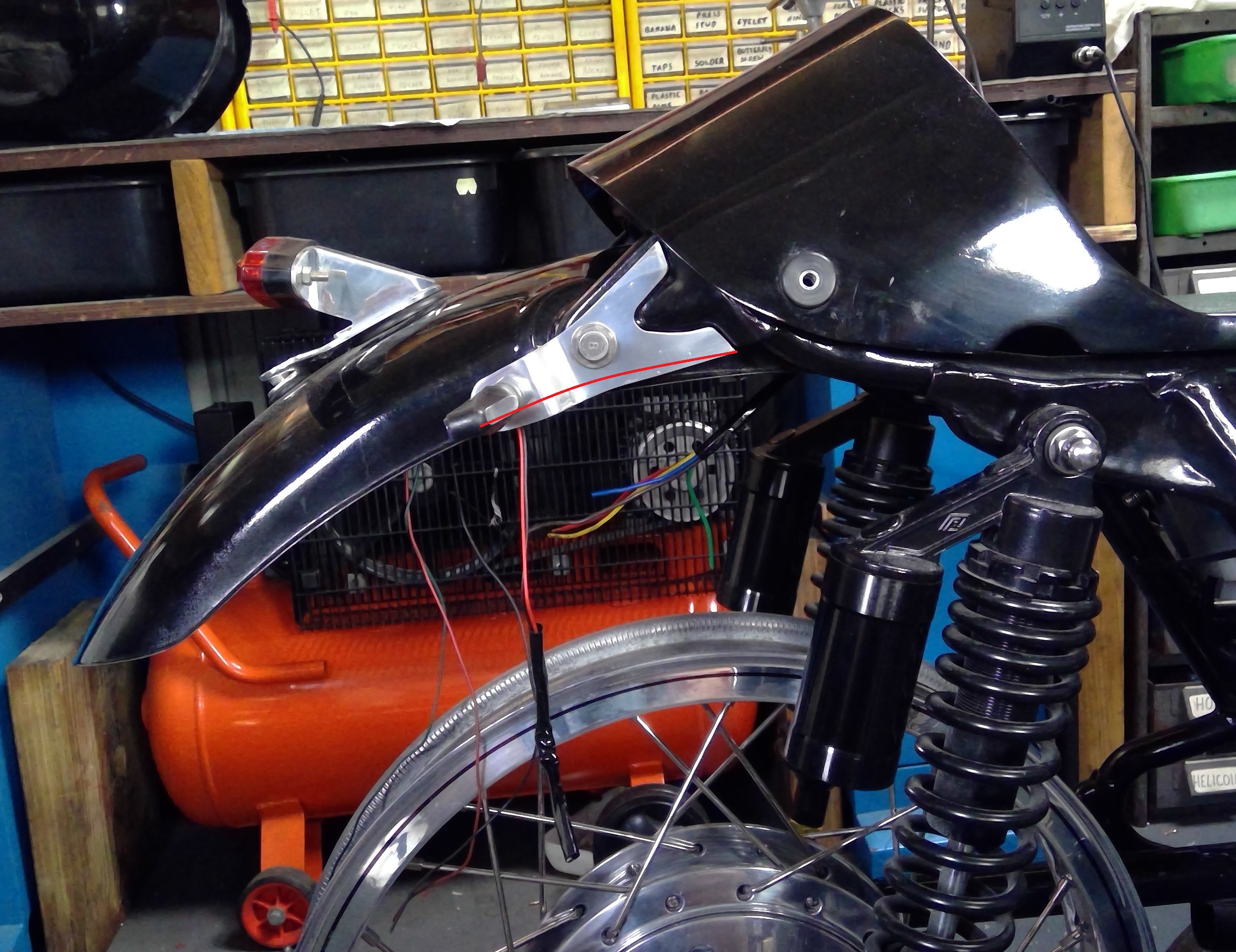

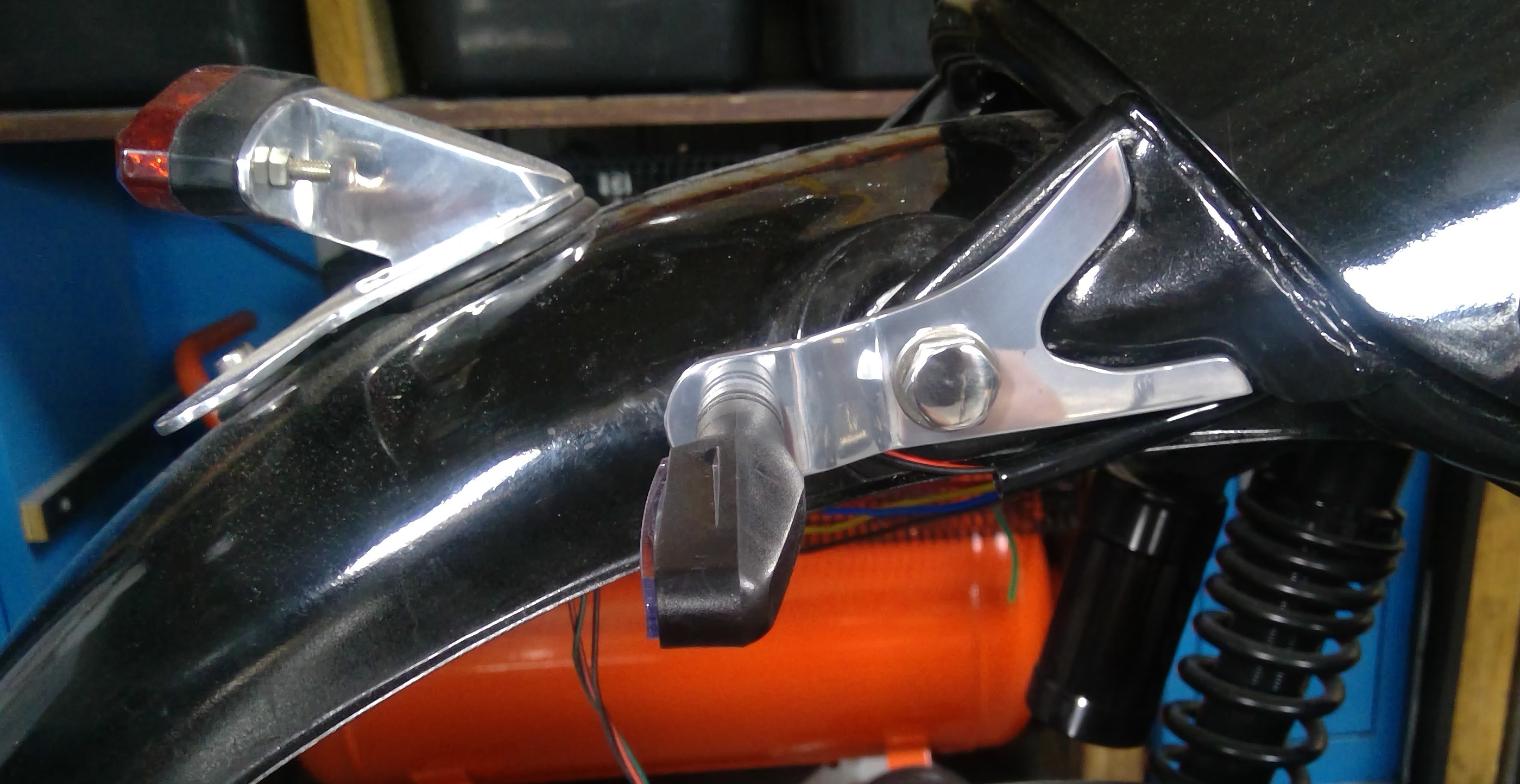

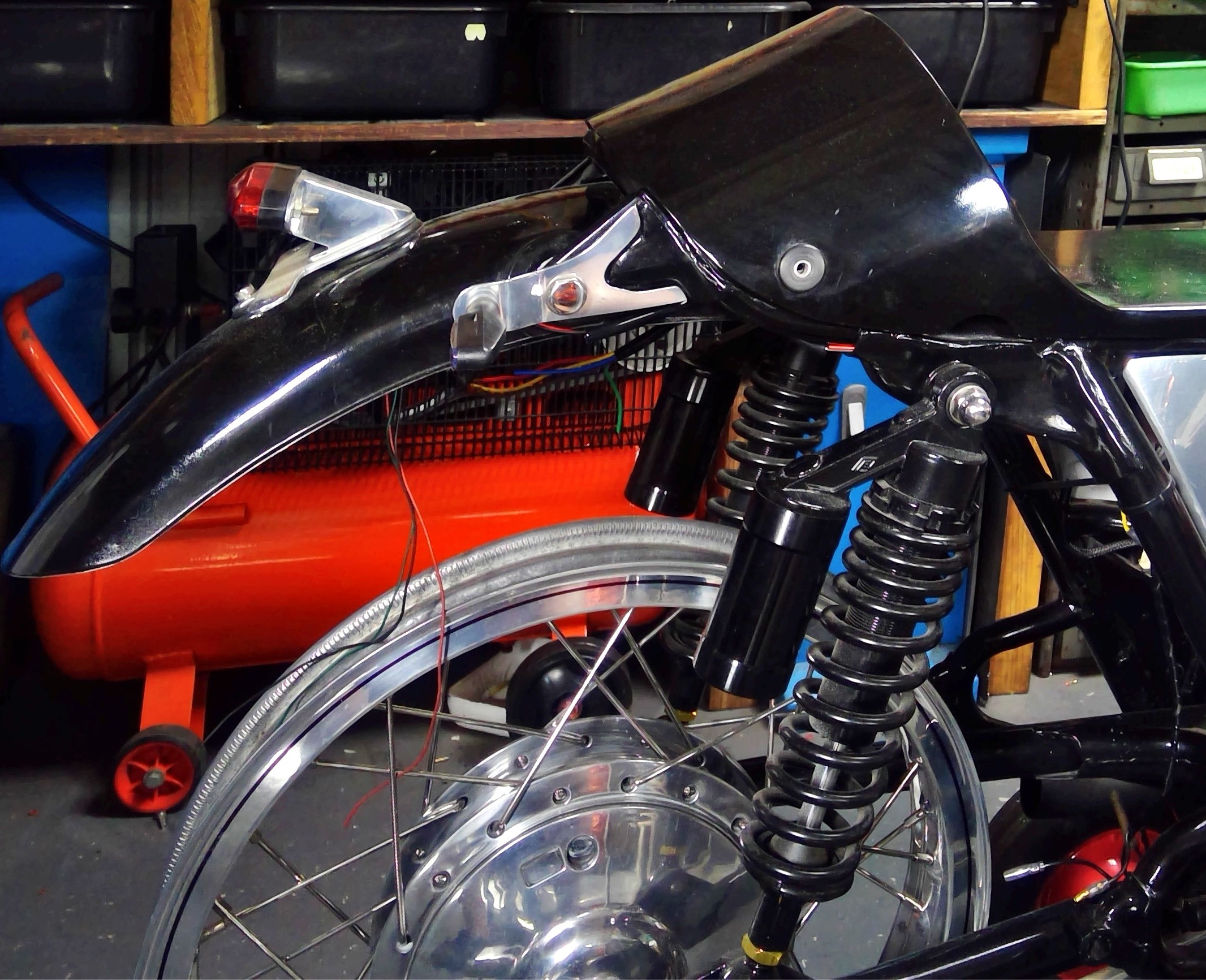

    The indicators I bought don't have a long enough threaded section to go through the guard bracket, so I made these extension brackets to mount the indicators on. The V shaped cut out at the rear of the brackets fits around the frame tab protrusion, thus stopping the brackets from moving.

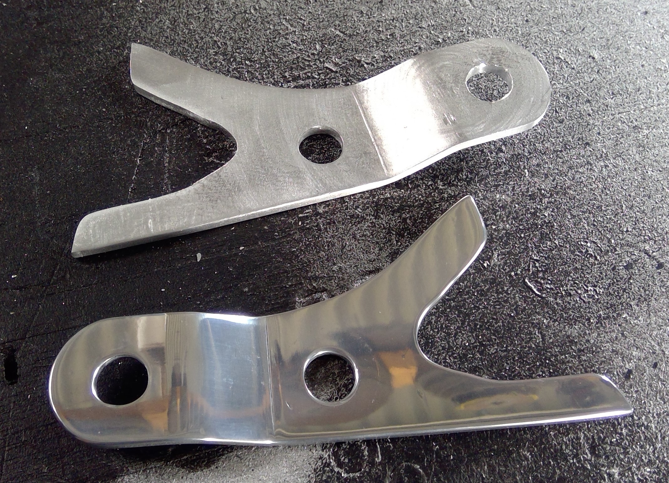

    Nup, binned them. Looking at the picture I noticed the line on the top the aluminium bracket doesn't follow the line on the top of the frame tab. So I made a new pair. Not a lot I could do with the bottom line as the tab angle is different to the guard angle, so I followed the tab angle down to the bottom of the guard then followed the arch of the guard. I might have to thin it down a bit though, looks a bit too big???

    The thinner bottom part of the first bracket look better. The pointed end of the upper part looks akward. Perhaps a rounded end ?

    What if you added a radius to the bottom edge of the bracket similar to the radius of the fender lip. Not that anyone would notice it unless they looked directly at it from the side, but it keeps the lines smooth and consistent.

    Nope, if I did that then the lower fork would be horrendously thick. That's why I followed the line on the bottom of the tab down to the guard then followed the line of the guard.
