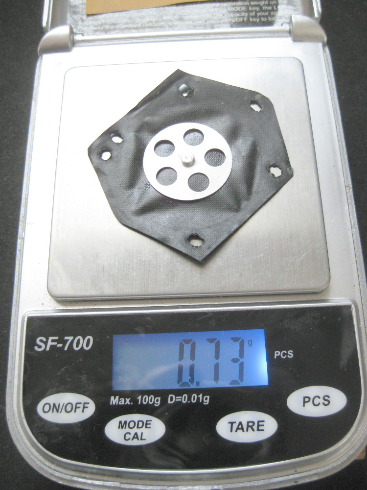

    Using this detector, I tried to see how the weight of metering plate means to the movement of it in operation. I thought some comparison could mean something about them.
    This is one of the original diaphragm with a perfect round metering plate on it. Some holes are cut out there. It seems that these holes help to decease its weight a little, but it also seems to me that opening holes is not the least thing to do for this part. Later I got to know how it concerns to the movement.
    Carburetor Diaphragm Movement Detector and its system-0.2t_with_standard_plates.jpg
    This weighs 0.73gs, thickness is 0.2mm.

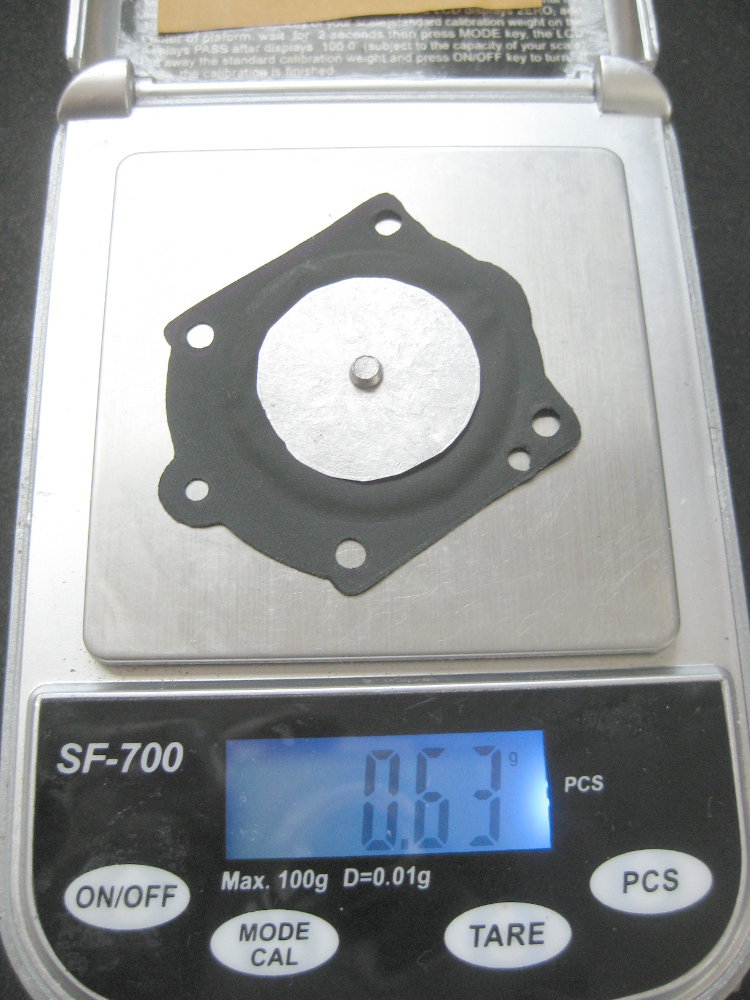

    First I had and assumption that the weight of metering plate means more for higher spin speed, since they have to repeat ups and downs so many times in a second, lol. This thought of mine lead me to try out another homemade metering plate that weighs lighter than the original.
    Carburetor Diaphragm Movement Detector and its system-0.15t_with_mod_plates.jpg
    This weights 0.63gs, 0.10gs lighter than the original.

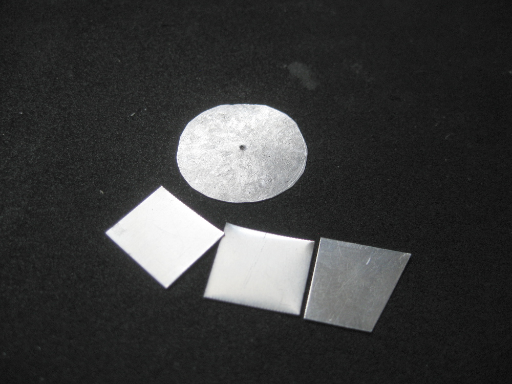

    This homemade one was made from a piece of alu plate. Thickness decreased to 0.15mm by mallet work, was 0.3mm originally. Why mallet work? Yes I wanted to give this plate some hardening cause it vibrates with some pressure.

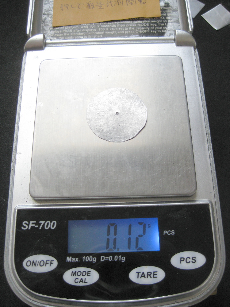

    The weight of this plate itself was only 0.12gs.
    Carburetor Diaphragm Movement Detector and its system-aluminum_plate_weigh.jpg
