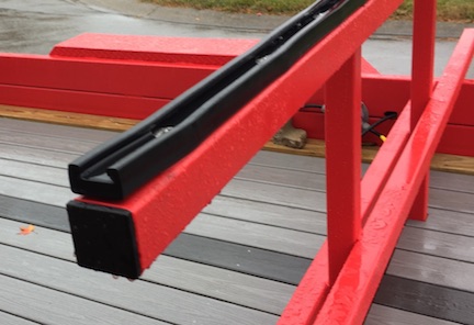

    My son is refurbishing a rowing shell trailer for a team he used to row with.
    When loaded the shells rest on 2” square steel tube. It is amazing how
    many critters use those tubes to build nests. Plastic tube plugs slow them
    down, but the critters easily chew through them. Sun degrades them leaving
    the tube open for rodents to inhabit.

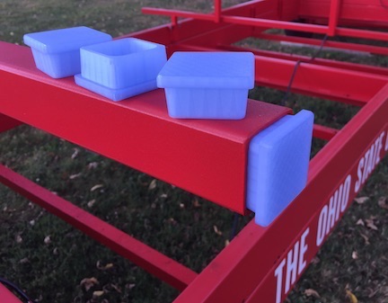

    Friends helped me up with 3D printed patterns for making some cast aluminum plugs
    (Thanks to Carl and Steve)
Name:	01 3D printed patterns.jpg

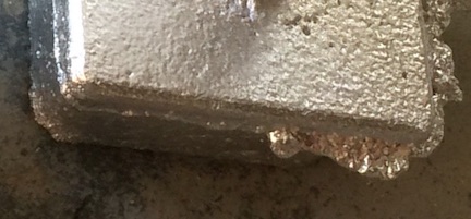

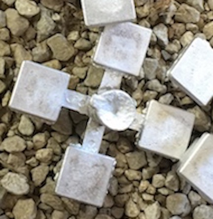

    After casting, the parts were separated from the sprue.
    Parting line defects were removed with a belt sander
    Link Lathe Belt Sander Attachment
Name:	03 Casting flash.jpg

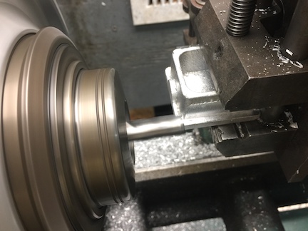

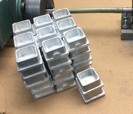

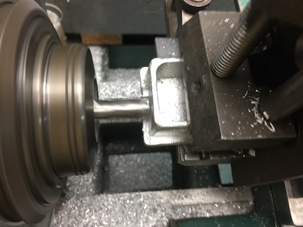

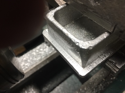

    The parts then required some milling to remove the runner
    remnant and some of the casting draft angle.
    This was done using a lathe milling adapter.
    Link Simple lathe milling adapter
Name:	05 Milling runner.JPG
Name:	06 milling runner.JPG
Name:	07 cutting runner.JPG

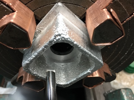

    All 4 sides are milled for good fit in the tubes
Name:	08 milled edge.jpg

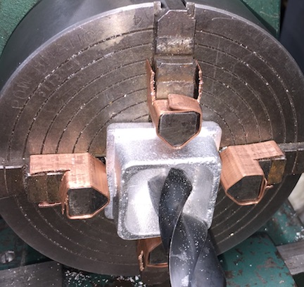

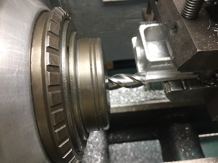

    Six of the plugs are drilled to for clearance lights.
    This operation required soft jaws for my chuck.
    LINK Lathe Soft Jaws
Name:	10 drill.jpg
    The backs bored to reduce thickness for the light grommet.

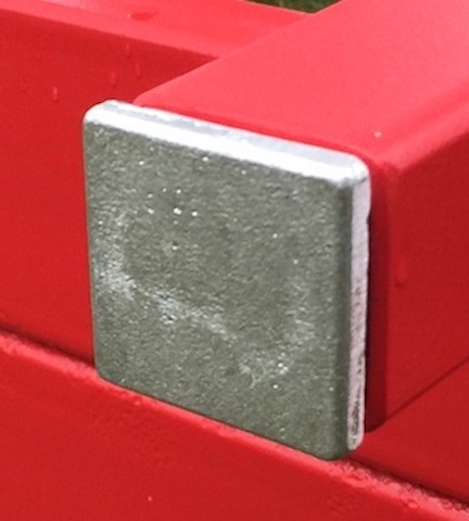

    The plugs were sprayed with etching printer and painted
Name:	14 Soid plug.jpg

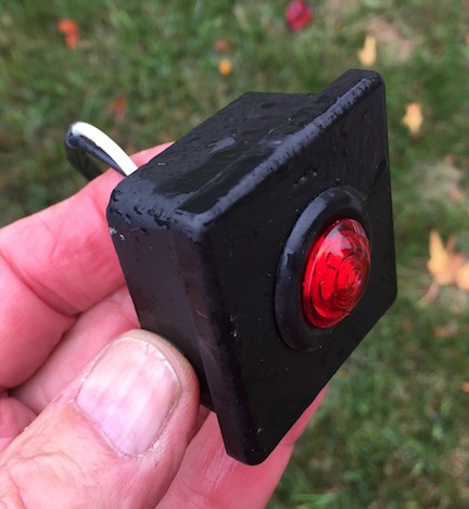

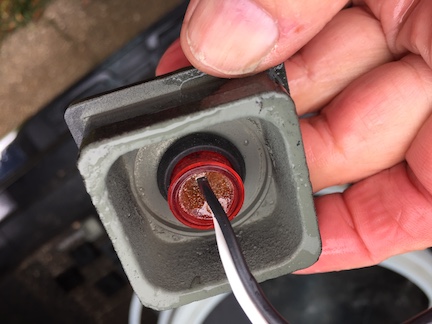

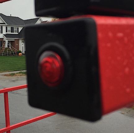

    LED clearance lights press into a rubber grommet
Name:	17 Clearance light.jpg
ID:	49958 Click image for larger version.
Name:	16 light back.JPG
ID:	49957 Click image for larger version.
Name:	15 Light front.jpg
