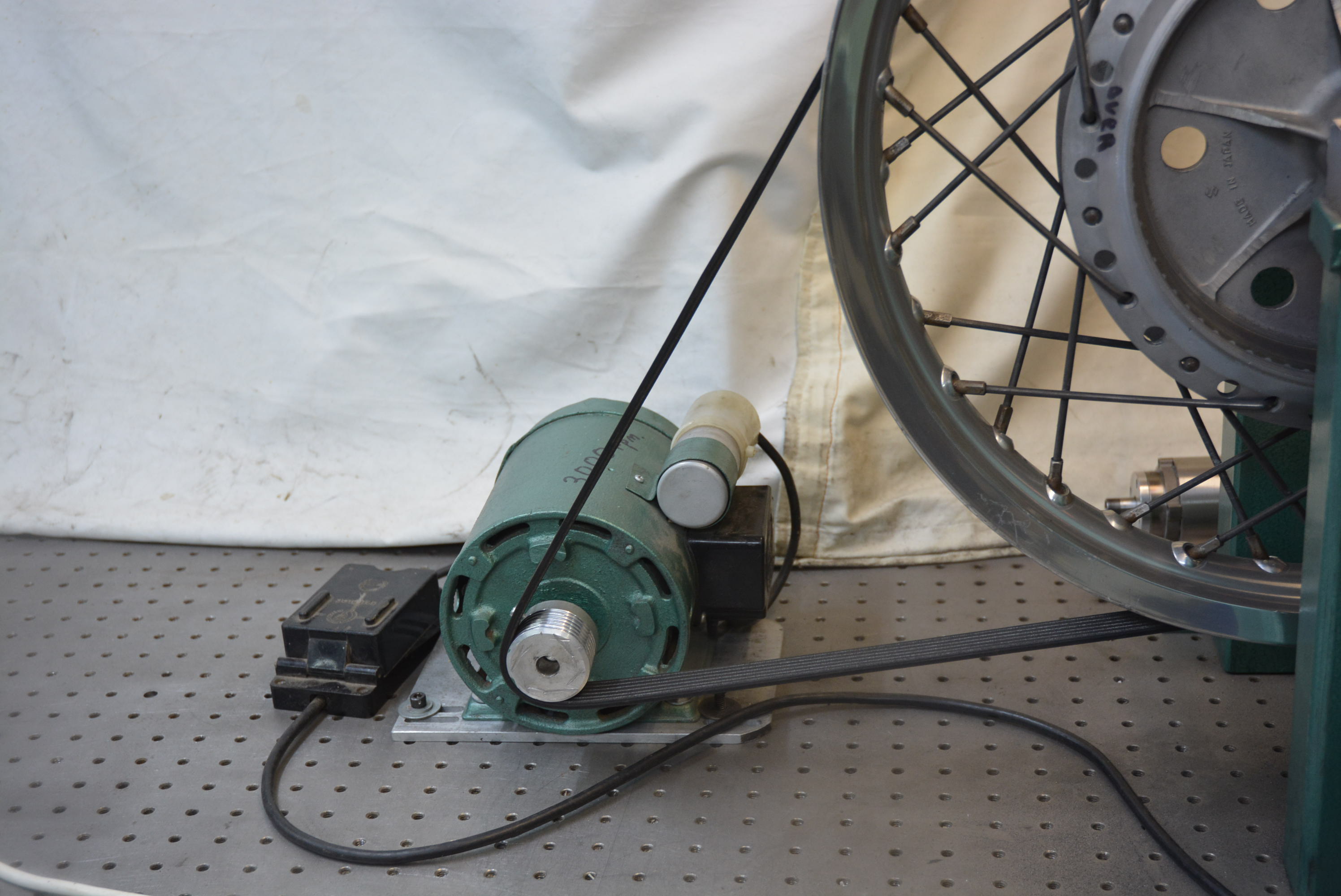

Here is a recent picture showing the drum grinder in use with a rim fitted. The initial pictures only showed the hub itself but I never grind a drum like that because they can distort when the spokes are pulled up tight. So I always grind a complete wheel.
