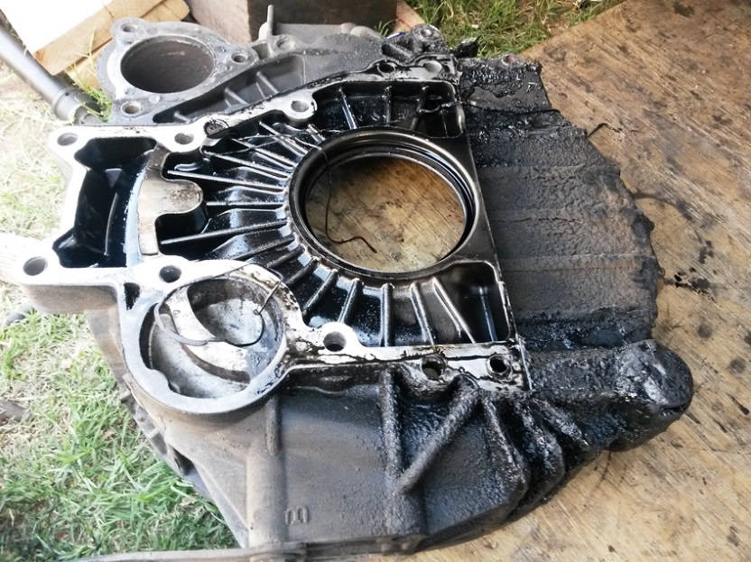

    The whole reason I made my transmission jack was to change a rear main seal on a friends Mack truck
    I had been telling him for a year or more that he had an iol leack between the flywheel housing and the engine block.
    Every Mack service center in country that he has had some repairs done on his truck while out on the road has said the rear main seal was leaking.
    Finally he took it to a shop to get another related issue taken care of on the transmission they kept the truck for 2 weeks then claimed the only thing wrong was the throw out bearing was dry and greased it. The issue was the clutch arm bushings were worn They were supposed to pull the transmission and replace them but they didn't Saying OH they are not bad enough to need replacing at this time
    Anyway I told him that if I was to drop the tranny I wanted to replace the clutch since he had 400,000 miles on it already. and I was not going to do a job twice.
    He said he wanted the rear main seal replaced anyway OF COARSE YOU DO I thought. And I'm going to have the flywheel ground as well and pull the housing off to FIX the leak
    In all the years that truck manufactures have been in business they still haven't learned that when they assemble the flywheel housing to the engine the only thing that keeps the oil from leaking is a microscopically thin layer of RTV sealant. and when the housing is tightened to the block most of that is squeezed out and over time what little that is still there will deteriorate Either the bolts will become loosened slightly from the constant pounding form the torque of the engine or heat and cooling what ever, eventually it is going to leak. because the main sealing is not between the mated surfaces but the tiny little bead of sealant that forms along the edges
    The solution that I have done to every housing I have installed for the past 45 or 50 years I learned from my dad long before that. Back when the housings were made of cast iron before RTV was ever invented

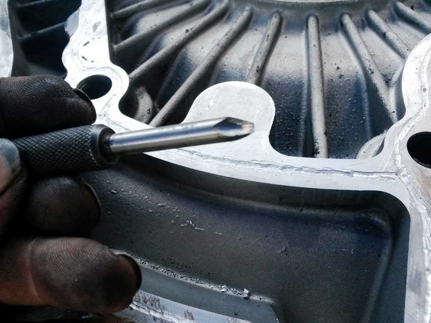

    You cut a very small grove all the way around the housing on the mating surface.
    Note the evidence of oil leaking to the outside of the housing
    First I cut a small grove using a ball file with a baby hobby tool
    then I made the grooving tool to deepen the cut
    This is a poor quality video since my friend nor I am are video graphics engineers
    but is explains the process

    One f the reasons why I grove the flywheel housings on heavy duty diesels boils down to this. Here you have an engine capable of close to or more than 2000 ft lb torque output or around 2800 Nm take your choice, and a transmission weighing over 800 lbs literally hanging on the back of this with a low reduction of 14 or 19 to 1 multiplying the torque from the engine to the driveline all of this is held together by 8 tiny little 15 mm bolts and 2 16 mm dowels.
    When all you have is 2 flat machined surfaces mated together with a thin almost non existent thickness of sealant to keep oil from leaking all these forces are working against a long term proper seal even when no actual oil pressure is involved there is the fact that 2 dissimilar metals cast iron engine block and the aluminum flywheel housing react differently to stresses and most of all heat factor in a million miles or more of hard work that microscopic film of sealant is going to be eradicated so in a sense the only real seal you ever had was the squeezed out bead adhering to both parts. By adding a small grove to 1 of these parts I have created a cavity for the bead to be held between the parts instead of on the edges. I have effectively made an "O"ring out of the sealant. Will it ever leak? of course given the right conditions but so can "O" rings once they get old and brittle if there is ever any movement. But this engine has 925,000 miles on it and judging from the past 4 years of oil sampling I figure it to only have another 8 to 900,000 miles of life left in it or about 5 years I'm trying to talk my friend into buying an engine for me to rebuild and have sitting on the shelf so to speak just in case his engine dies. or I might wind up and install it in 1 of his other trucks.
