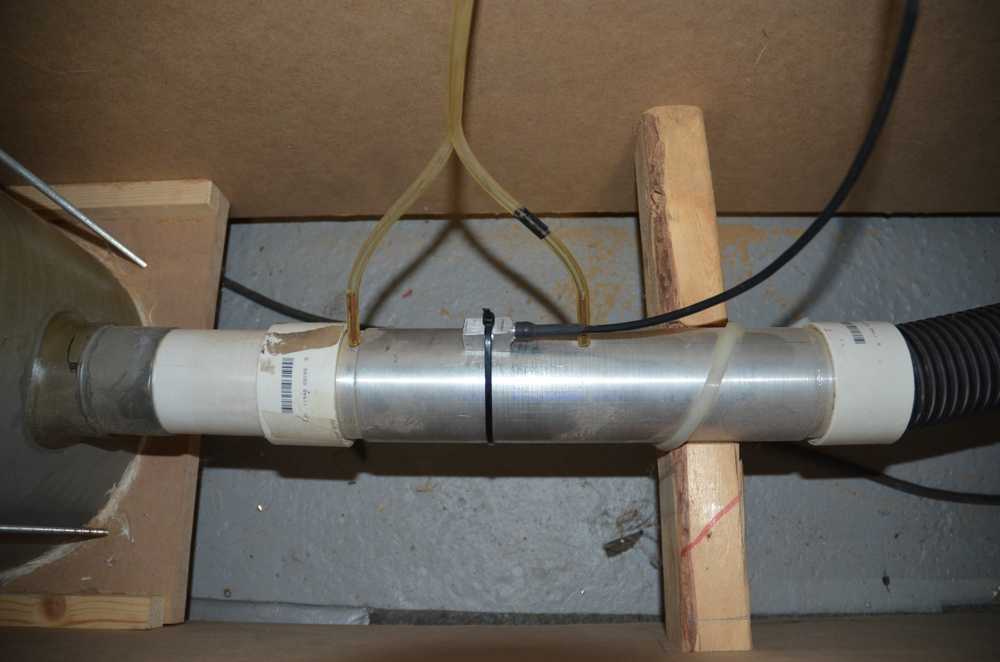

    Don't know if you've looked into it at all but could one of the cheap weather anemometers be used to measure airflow in flow bench? It would work along the lines of Vizard's 'floating point' bench with a ~5hp vacuum cleaner/shop vac
    I looked into many ways to measure air flow for the bench. Most benches use an orifice plate but the flow coefficients are low, 50 to 60%. I used a venturi in place of an orifice plate, coeff around 96 to 98%, so I only need a vacumn source of roughly 1/2 that I would with the orifice. Combined with electronic differential pressure transducers it is very accurate and highly repeatable. Most/all orifice machines have to change out plates at different flow rates, even when doing a single test over a range of valve openings on the same port. With my venturi I have to change out nothing. Testing is very quick. My software averages 100 readings over a set period (usually 5 secs). All I have to do is set the valve lift, push a button, wait 5 secs and repeat for as many steps as I want. My software does the rest.
    I don't see any price or functional reason to use a weather anemometer over what I have.
    Home made horizontal milling machine.-tempsensor01.jpg Click for full size images.
    Ventururi with temp sensor attached. See my old post on ruggedized temp sensors.

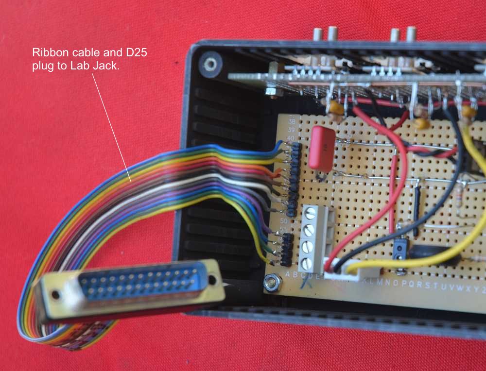

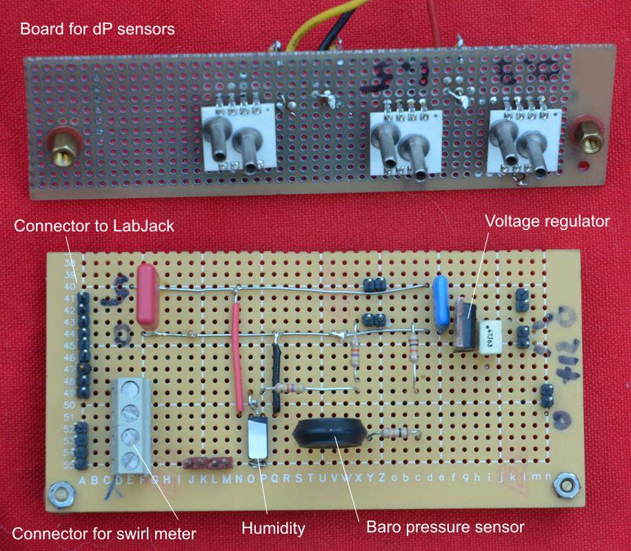

    Home made horizontal milling machine.-board_03.jpg Home made horizontal milling machine.-board_06.jpg Home made horizontal milling machine.-board_08.jpg
    Some pix of the black box and DP sensors. There are humidity, baro and temp on the board as well as a temp sensor on the venturi and port. These parameters allow the results to be compensated for different atmospheric conditions. I obtain indistinguishable results from testing at 0 deg when I lived in NH, USA and testing at 30 deg here in Spain. My workshop is always 30 deg in summer.

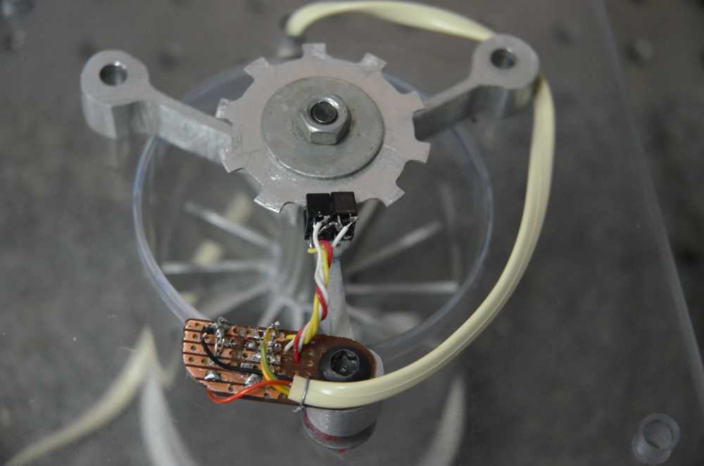

    Home made horizontal milling machine.-flowbench_03.jpg Home made horizontal milling machine.-swirl01.jpg Home made horizontal milling machine.-swirly_01.jpg Click for full size images.
    For the time being here are some pix of the bench and some of my swirl meter.

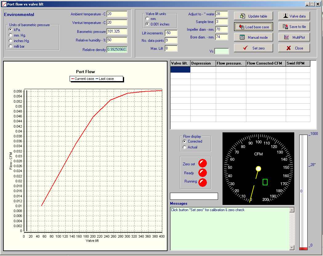

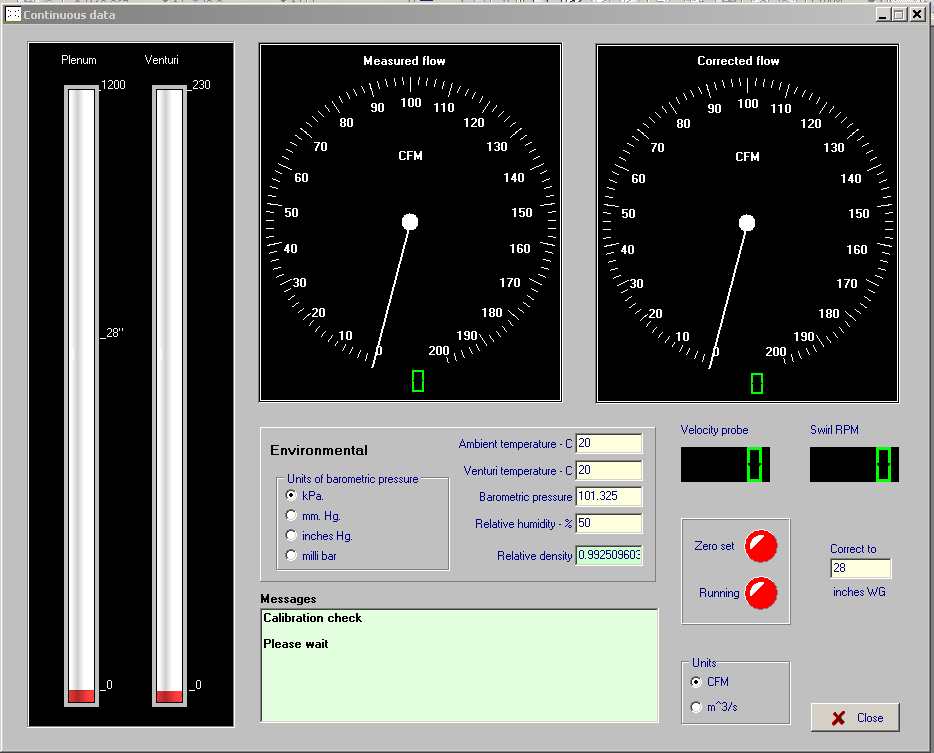

    Home made horizontal milling machine.-s1.jpg Home made horizontal milling machine.-s2.jpg Home made horizontal milling machine.-s3.jpg
    Here are some shots of the software.
