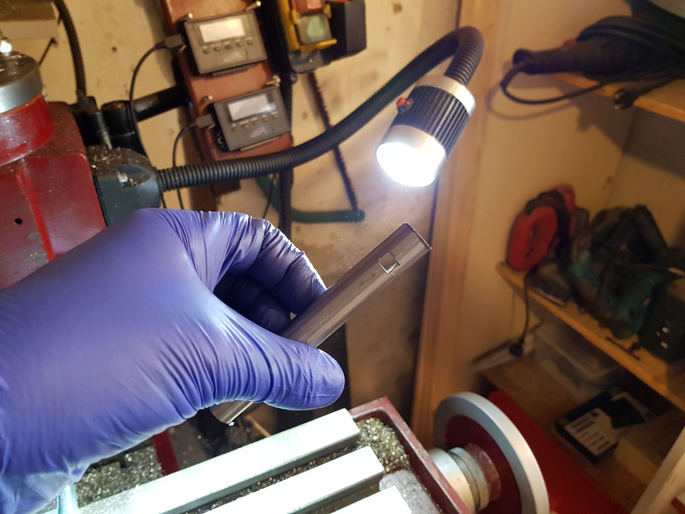

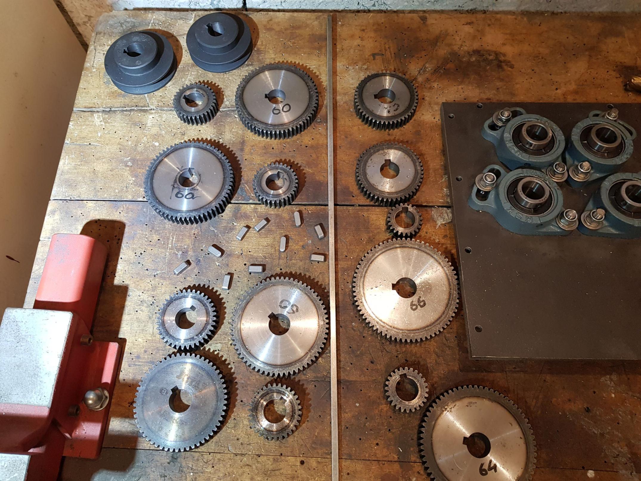

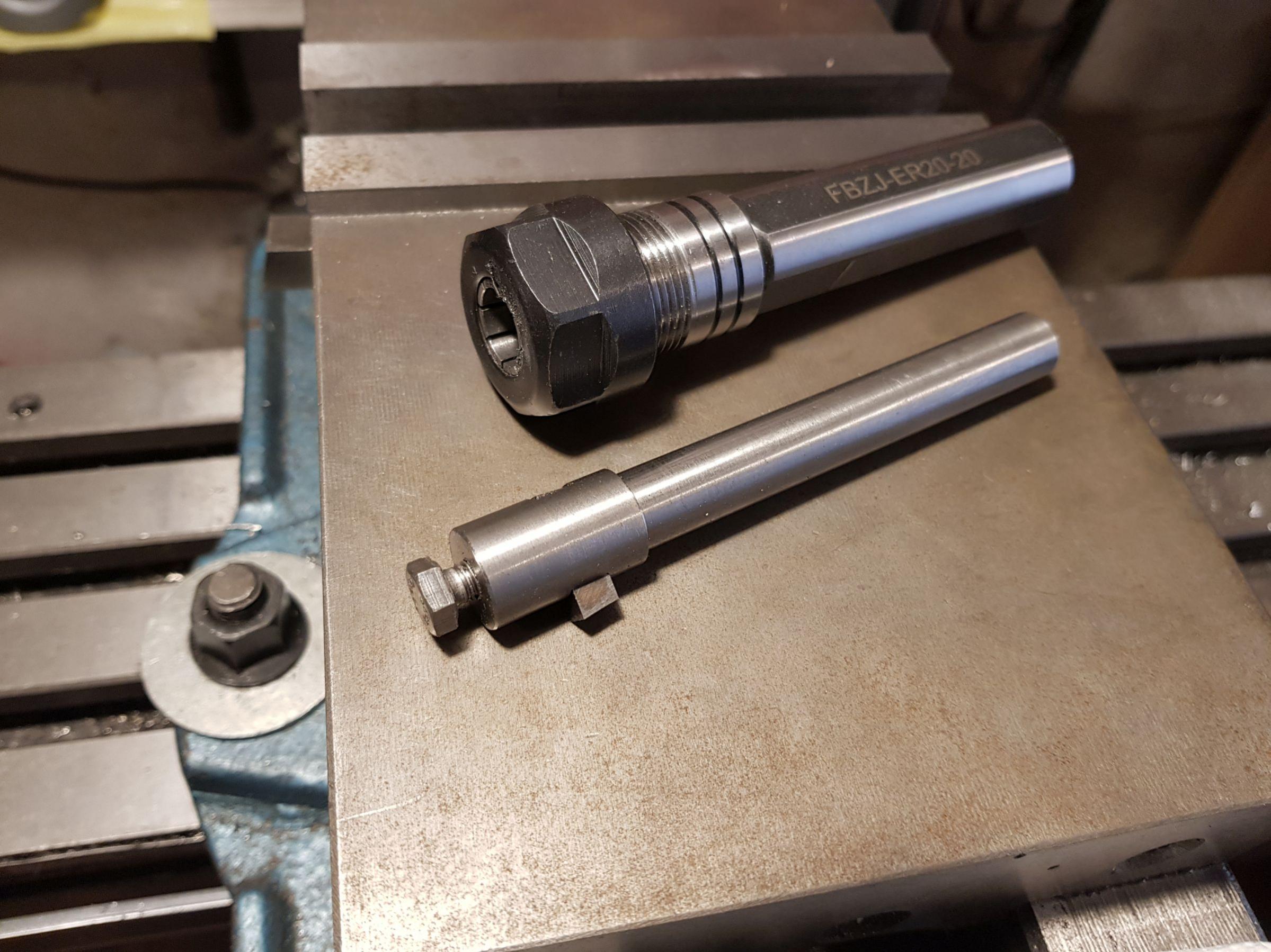

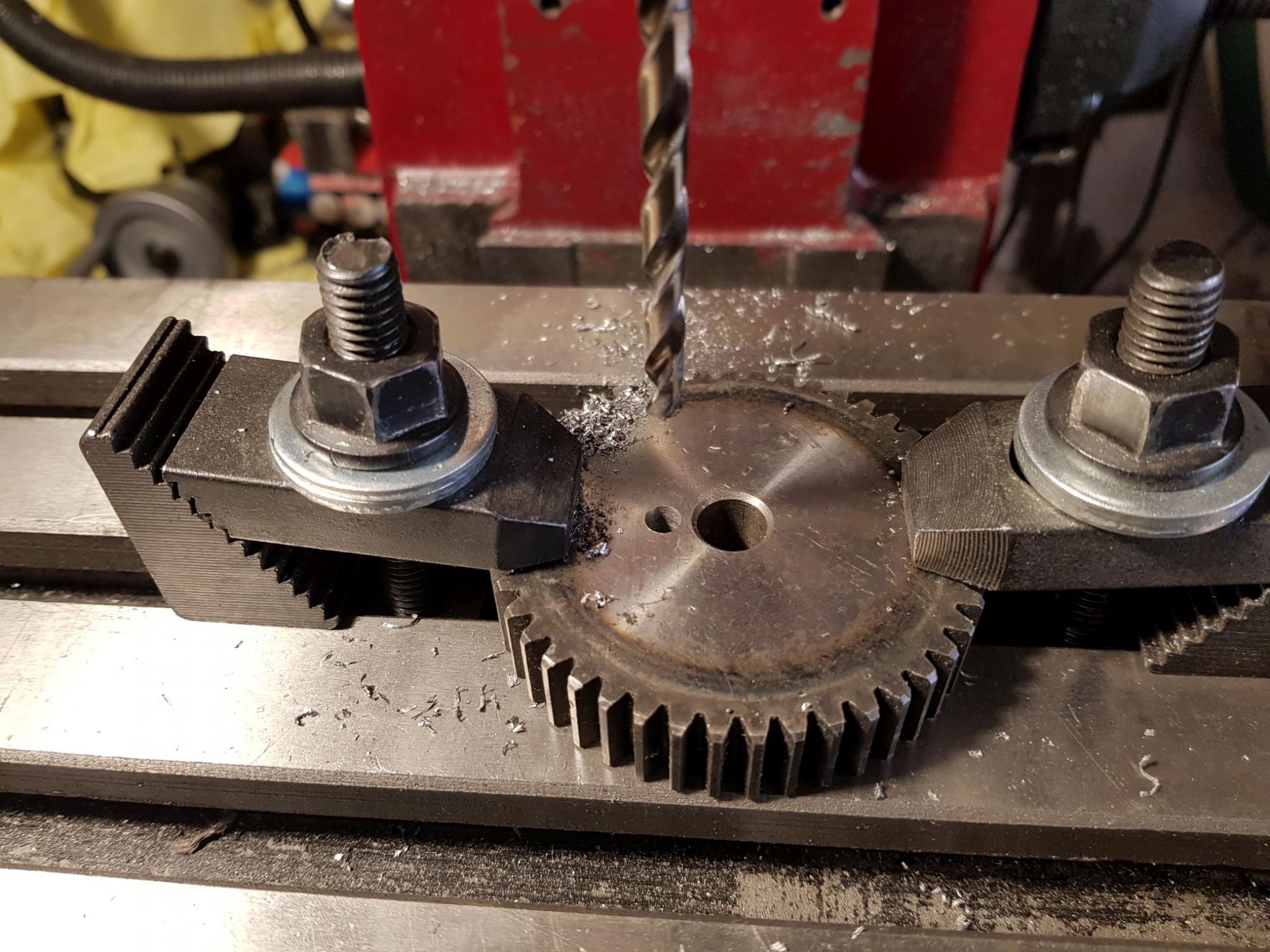

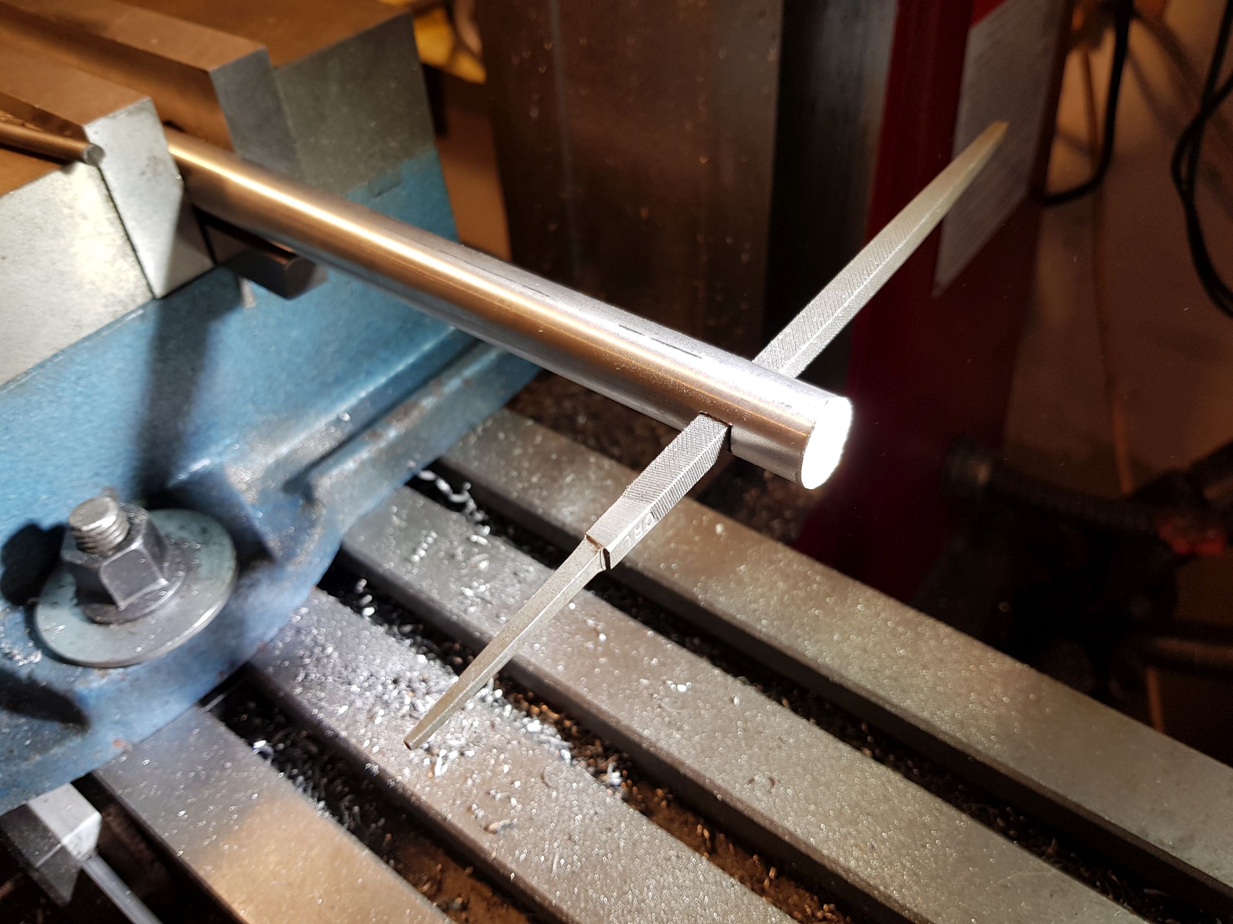

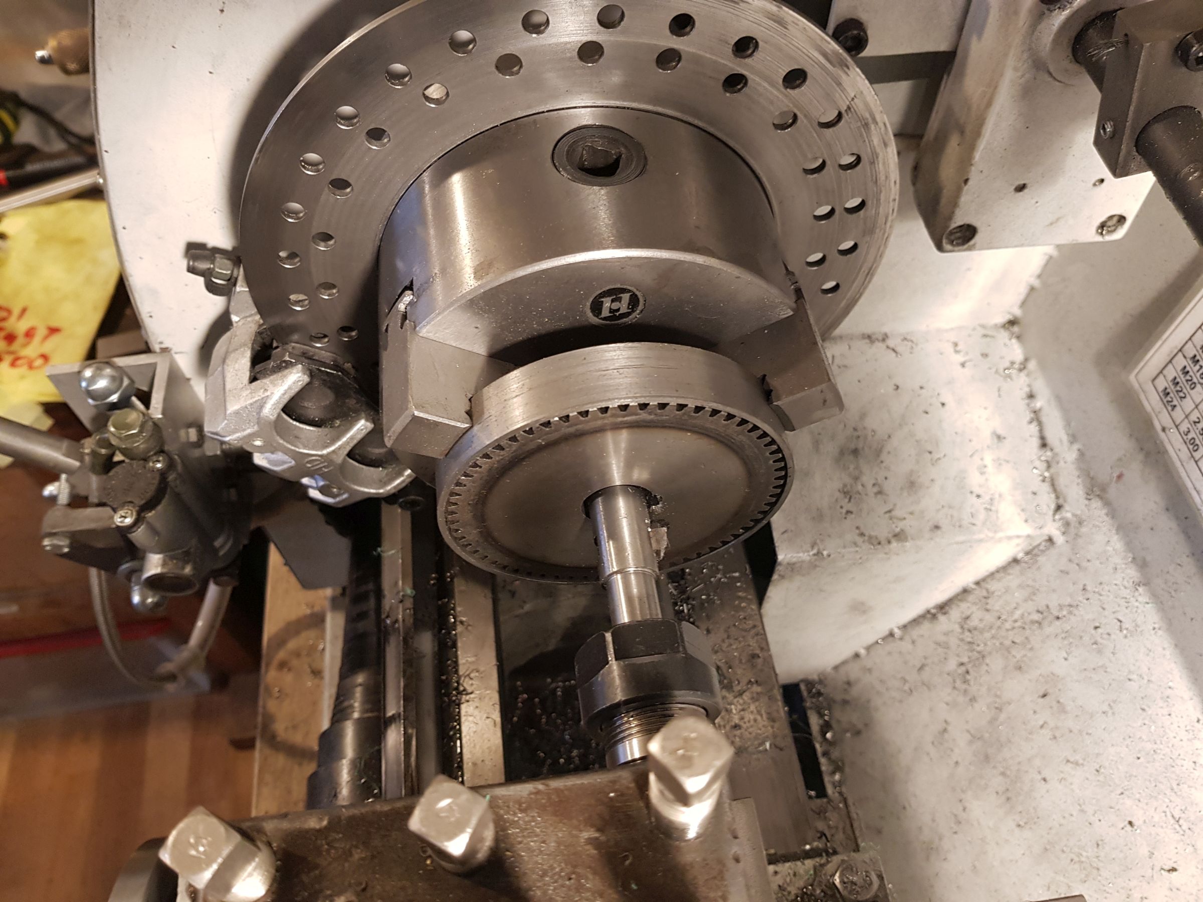

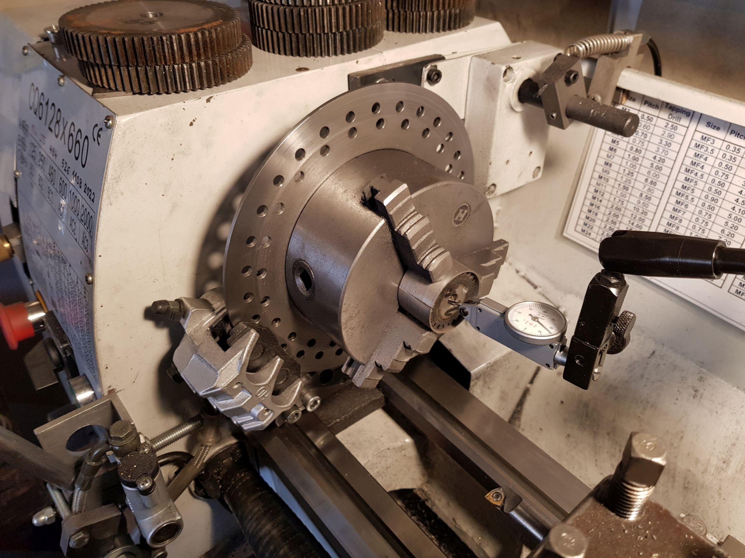

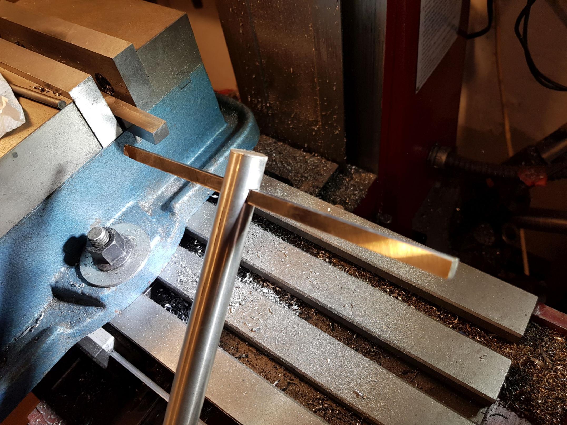

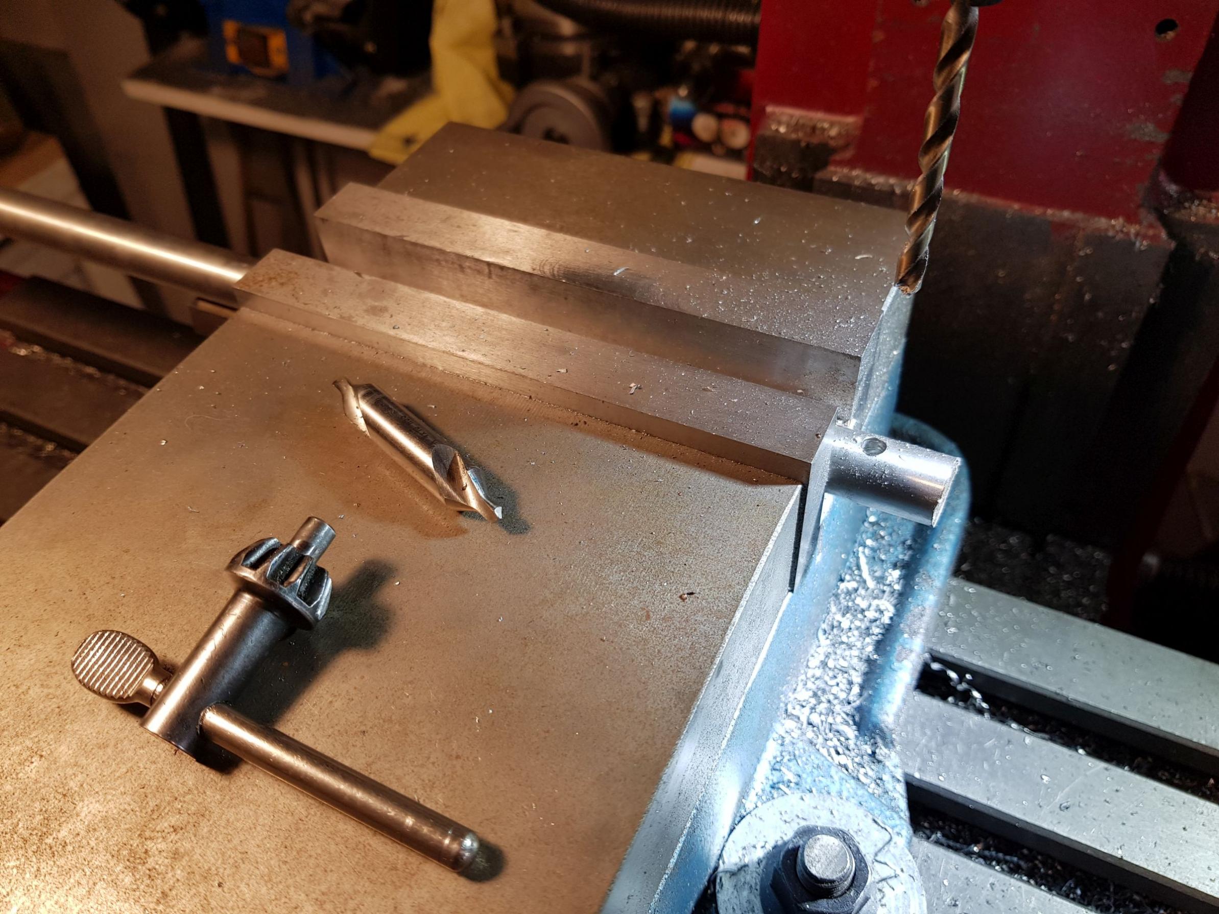

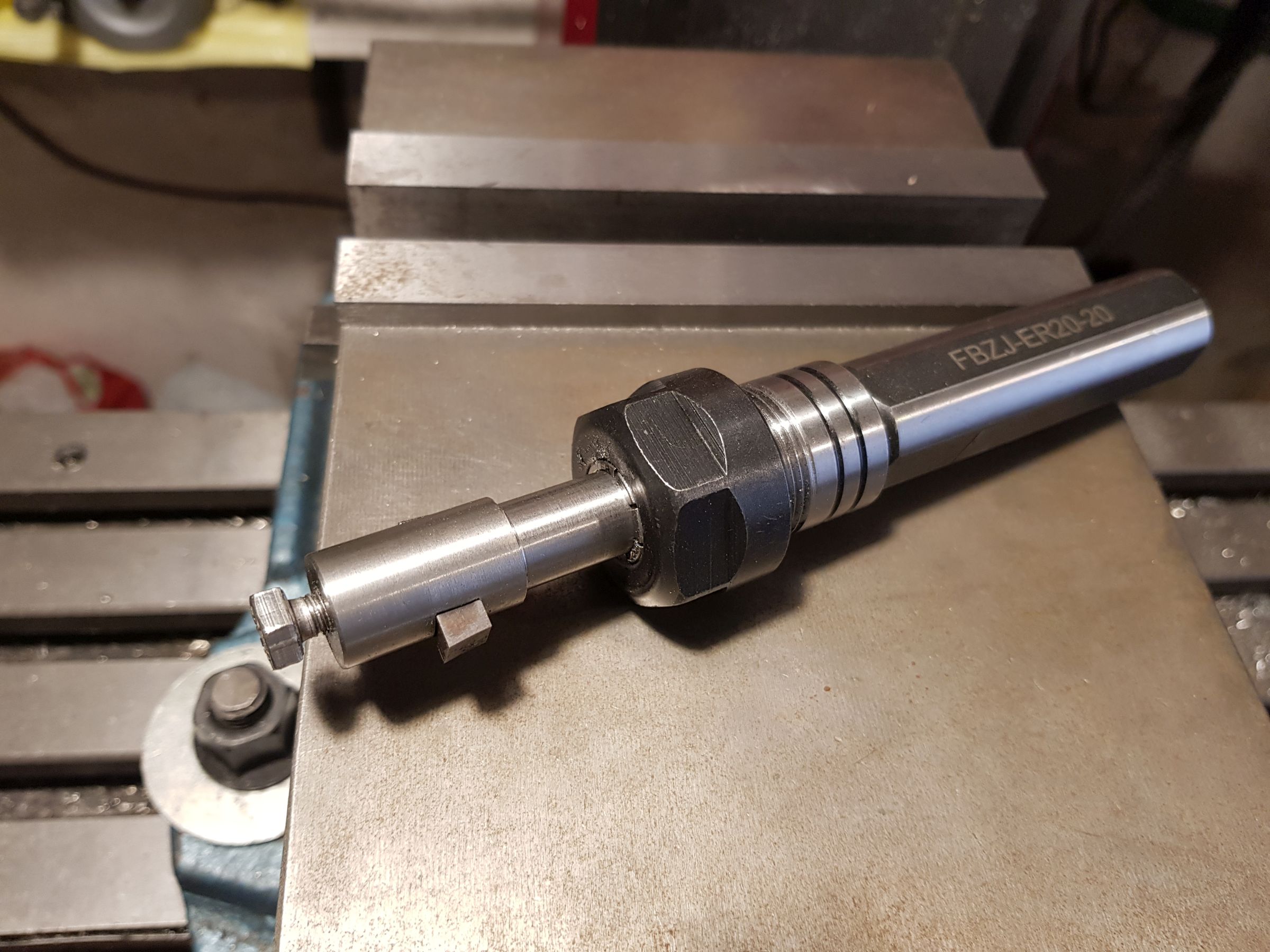

    Made keyway cutter which I needed to cut keyways in 14 gears and 2 pulleys for my present project (external lathe headstock gearbox - still in progress, but I can see the end).
    Made from 16 mm dia stainless steel round bar. Very simple to make but some elbow grease was used when filling the square hole for 6 x 6 mm square HSS bit. It can be used in lathe and drill.
    Cheers
    LMMasterMariner
