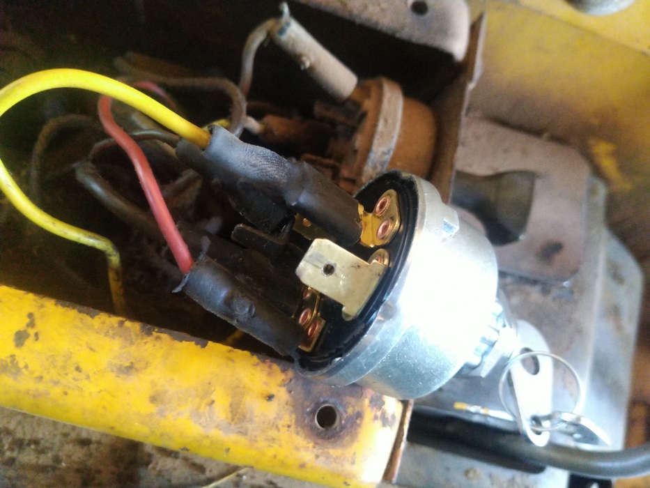

    I have not fewer than 5 electrical connector kits and not one of them had the connector I needed.

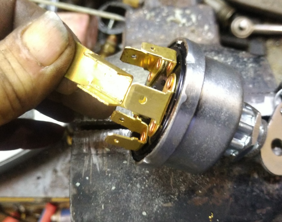

    I finally was going to get around and change the key switch on my Backhoe since the key broke off in it 6 months ago I have been using pliers to turn the switch. Only the new switch has 3/8" blade connectors the old switch had 1 of the large connectors but for the new one I needed a second large connector.

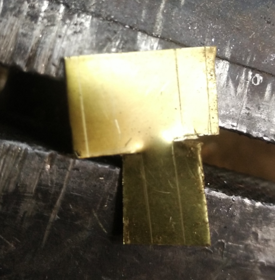

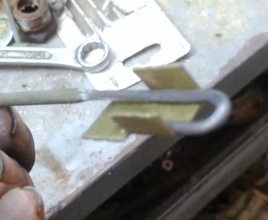

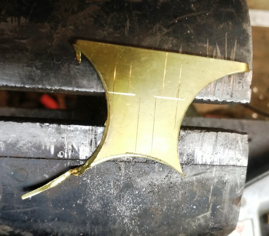

    I solved this problem with a piece of .030" brass drop from the shim washers I made a while back
    her is how I made the connector I scribed a rough layout on the brass then cut with snips, no concern with getting too critical with size I just needed it to carry current not be pretty for sale.

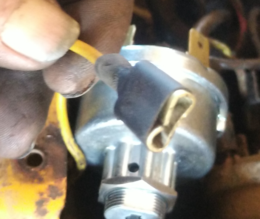

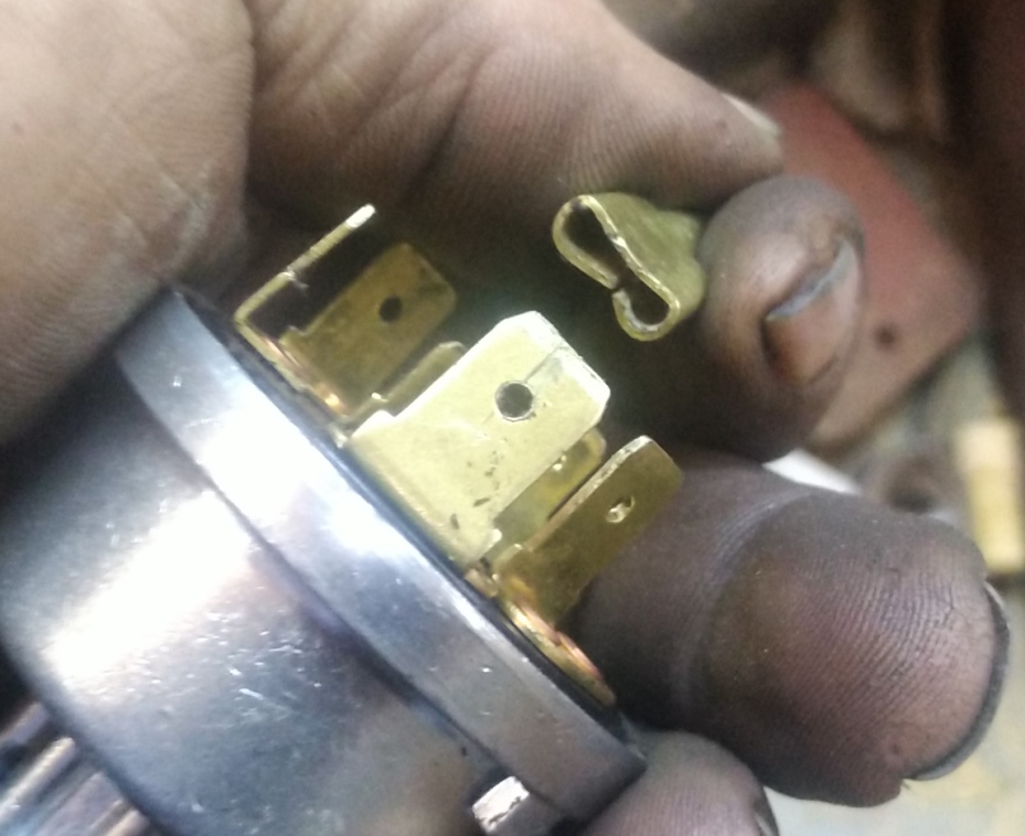

    After the initial forming over a piece of 3/8 HSS I checked for size against the spade on the switch

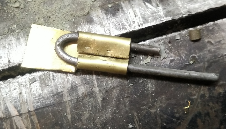

    I then made a forming jig out of a 3/32 welding rod to roll the sides of the connector over this would make the spring type holding clamp of the connector
    making a 3/8" female electrical spade connector-img_20220619_151925fw.jpg
    The shape of the connector after forming over the rod
    making a 3/8" female electrical spade connector-img_20220619_152548fw.jpg
    It will now lock onto the blade the next step will be to form the crimp tube end

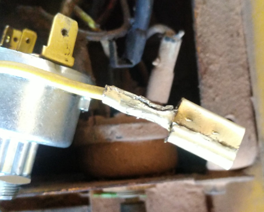

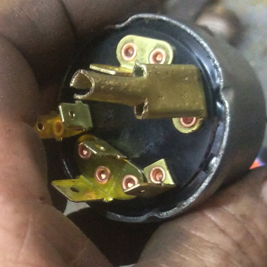

    the wire now crimped in place
    making a 3/8" female electrical spade connector-img_20220619_153841sc.jpg
    the completed connector attached to the switch with shrink tube insulator

    Looks good to me and it works. Sometimes you can get away with using a file to shorten the width of the blade to use a smaller terminal but only if you know the current flow through that wire. If its 30 amp plus it needs the correct terminal. Most likely your new switch had the second wide terminal because of terminal failures. Years later they fixed that with the use of relays to handle high current. Thanks for the idea. Mr Mikey.

    There have been many times when I have filed the 1/4" blade down to fit an existing 3/16" female connector and never gave it a second thought since the corresponding wires were usually 16ga or smaller, or stretched a ring connector from a #10 hole to fit a 1/4" stud.
    I also suspect the reason for the new switch having both the main battery blade and the start blade being made to the 3/8" size is as was stated to correct an issue the switch MFG. had learned or possibly to make it a universal replacement for another piece of equipment.
    I also know that my homemade terminal should be far superior to any 1/4" connector I could have used by filing the blade down. The original connector on the harness needed replacing anyway as it was loose on the old switch when I removed it.SO it made no sense to me to file the switch down and cut off the old connector only to crimp on one which would not be any better in the long term.
