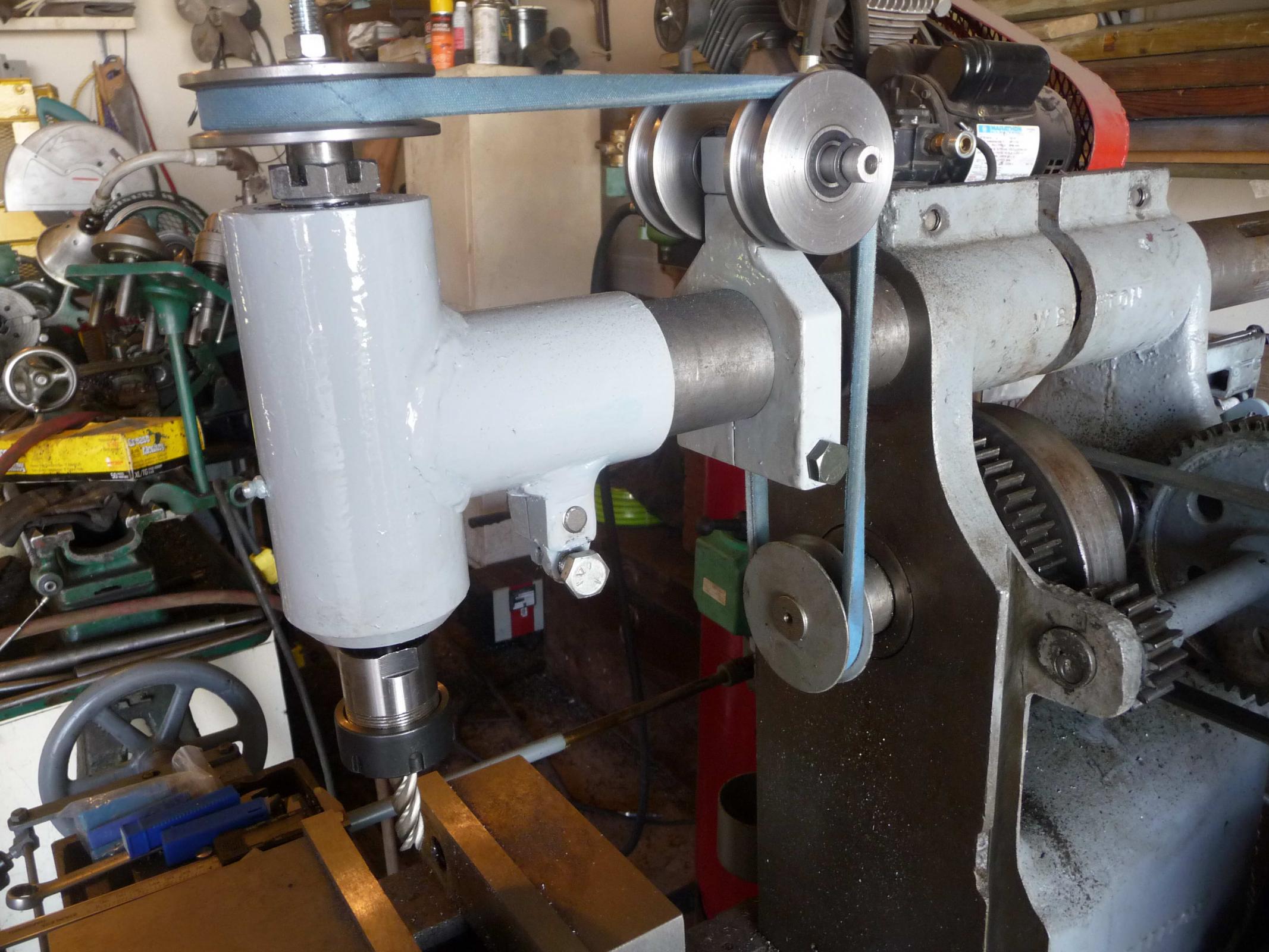

    Nice solid conversion in keeping with the original machine, well done.

    Quote Originally Posted by glens5 View Post
    I haven't checked for run out yet but if there is any I'm sure it'll be from the Banggood collets and holder.
    Really nice build! Thanks for sharing!
    Personally, I've been down on my luck on BG MT2 & MT3 ER32 collet holders (4 of them, all in all).
    2 years between placed orders hoping the harsh buyer feedback would've shaped up their quality issues. Guess not...
    Link: https://www.youtube.com/results?sear...Collet+sets%22
    The Collet holders: +/- 5 hundreds of a mm in runout (sic!) and non-coaxial to boot in all 4 cases...
    Worse than the worn-down 3-jaw in the 50 years old lathe at work...
    My only REAL LEMONS in a 70-ish item order history - too bad that would happen to "precision pieces"...
    No biggie for me to regrind the ER32 tapers down to below +/- 2 thousands of a mm, tho -
    about half of the ER32 collets in the (M & Imp) sets were in as bad a shape as the holders, too:
    both non-coaxial and non-concentric when tried in the new-ground holder.
    Finish was excellent, throughout - no rough edges, finely ground and clean
    (others have reported bad cuts, rough edges and shavings within).
    Even being cheap-to-the bone and given my 20-20 hindsight, I shouldn't have ordered them in the first place.
    Guess I now have to shim their compressible saw cuts up, fit them in holder and regrind 'til "good enuff"?
    -Yeah, right! Sub-6 mm collets just a piece of cake to regrind! "Happy machining!"
    As per their original state - the bad ones are perfectly useless for my intended purpose.
    -Why even pay for runout and non-coaxiality, when you could get that for free in a dirty, old 3-jaw?
    Just my 2 cents & YMMV
    Johan
    PS: Perhaps the small collets could be honed? Another upcoming project/ waste of time?
