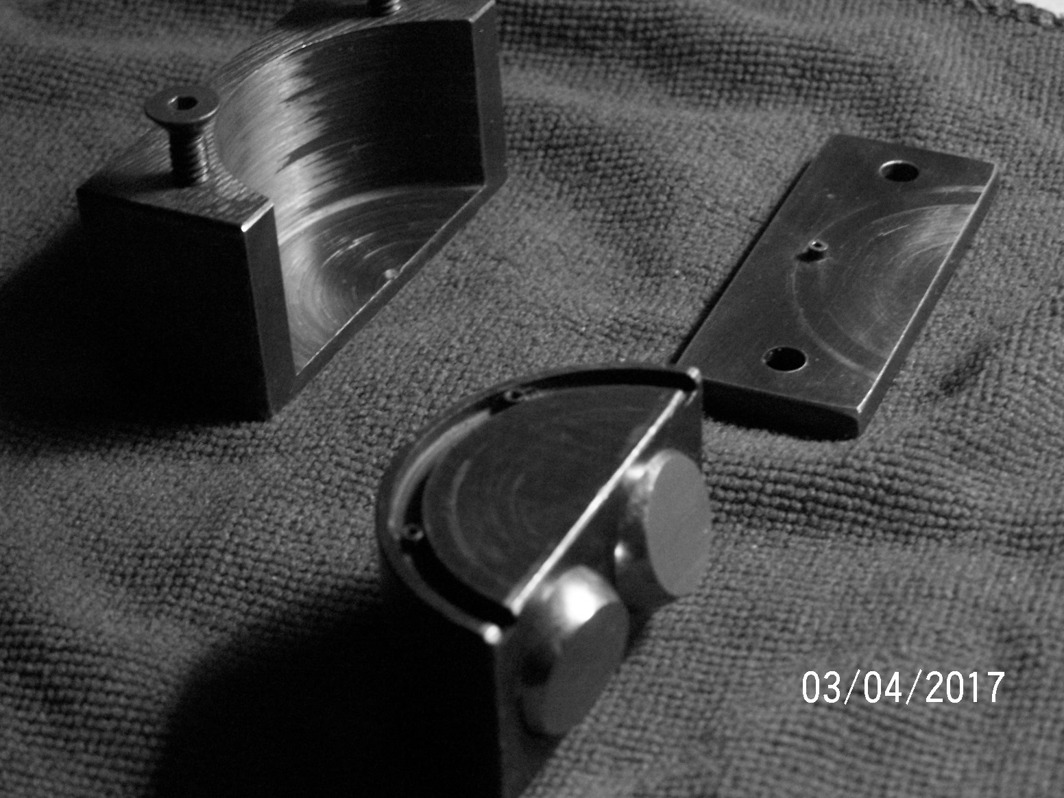

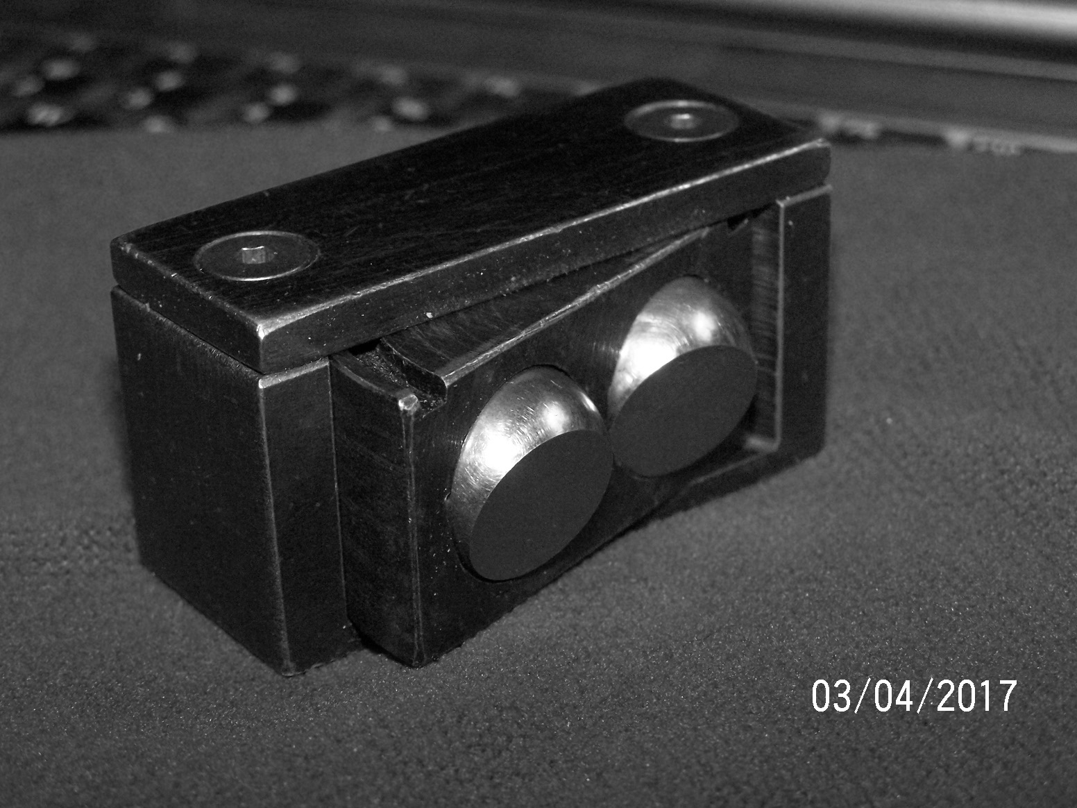

    Here's another using a swivel action, for tapers, curves and compound surfaces, as in cast or forged parts. Self adjusting, it uses less space, advantageous when a vise is used.
Name:	Clamp Pad (2).JPG
    This is a lathe or mill project, or combination of the two. A little planning will allow making two at a time. Test fits while work proceeds. Heat treating is not needed, or recommended.
    The physical size isn't critical, use steel an adjust to suit material available. Procure two bearing balls, example uses .75/ 19mm. This block is about 2 1/2" long, 1 5/16" high, and 1" deep. The radius inside block [not through] and chord is 1". Allow .002-.004 clearance on one side. The chord has two pockets bored to slip fit the bearing balls. Ball end milling can be used, but isn't required. If pocket is ball-milled, pilot drill around 1/4 ball diameter and somewhat beyond 1/2 ball diameter. Seat depth is .020-.030 deeper than 1/2 the ball diameter. Before assembly, grind flats with any manner at your disposal. Lightly stake the balls in place to be retained, not locked. Top edge of chord is grooved for a roll pin pressed into the top plate. In the groove are 2 roll pins at 45* to keep the chord from swiveling out of the block. Click image for larger version.
Name:	Clamp Pad (3).JPG
    Top plate is countersunk for 2 #10 flat head screws, tapped in block.
    jjr2001's post has a similar aspect, and some good building techniques. http://www.homemadetools.net/forum/w...se-balls-50698
    This works in vises, hold-downs and a variety of fixturing.
    If any amplification is needed, feel free to post or email questions.

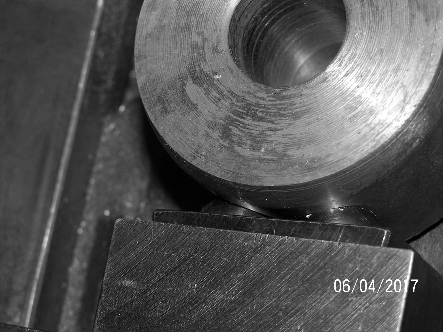

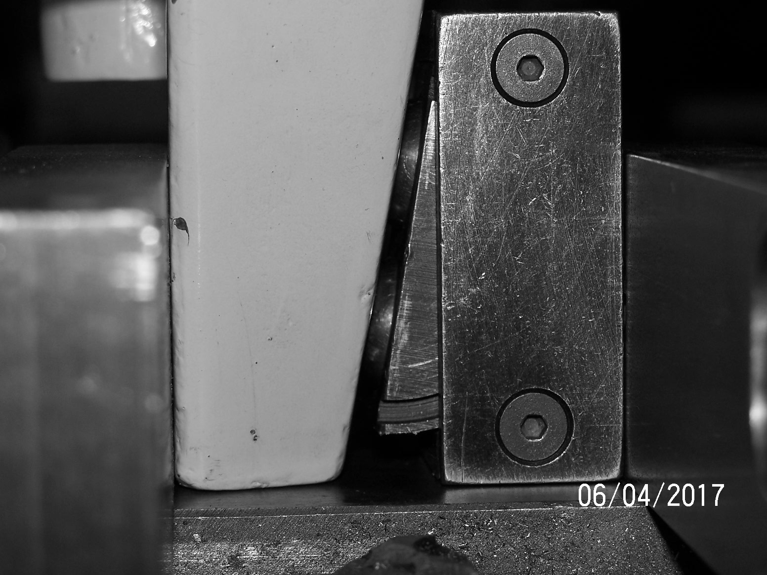

    And for Ralphxyz here are 2 shots, to represent use. Only have one suitable casting at the moment, Click image for larger version.
ID:	17362 and about a 5" stub of round stock. Casting's the 'apron' from a manual form bender being modified. Round is just a drop from our saw. Click image for larger version.
