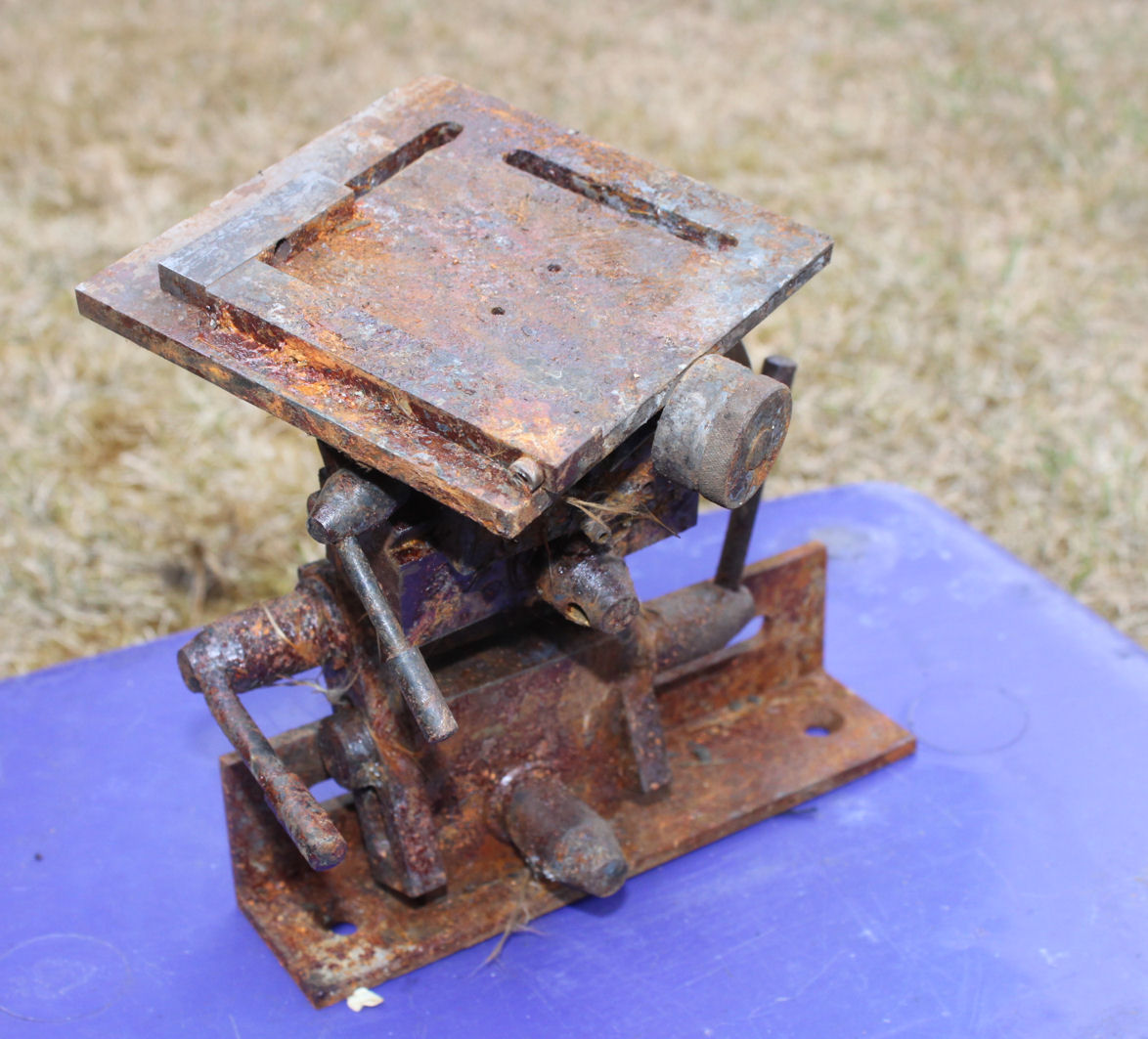

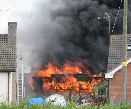

    Hi Al8236,
    Those were not supposed to be links, the pictures were supposed to be embedded into the posting but I see that they aren't showing.
    I followed the instructions in the video on how to attach photographs and they showed up in the preview window but obviously something has gone wrong. Here is another attempt
    Garage fire
    as viewed from neighbours garden
    Grinding rest test assembled
    before final finishing and polishing
    Sharpening metalworking workshop cutters, Videos-grinding-rest-after-recovery-garage.jpg
    Rest as rescued after a couple of weeks
    in the English summer rain!
    Here goes, The preview shows all 3 photographs correctly positioned, fingers crossed.

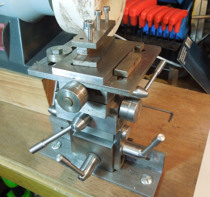

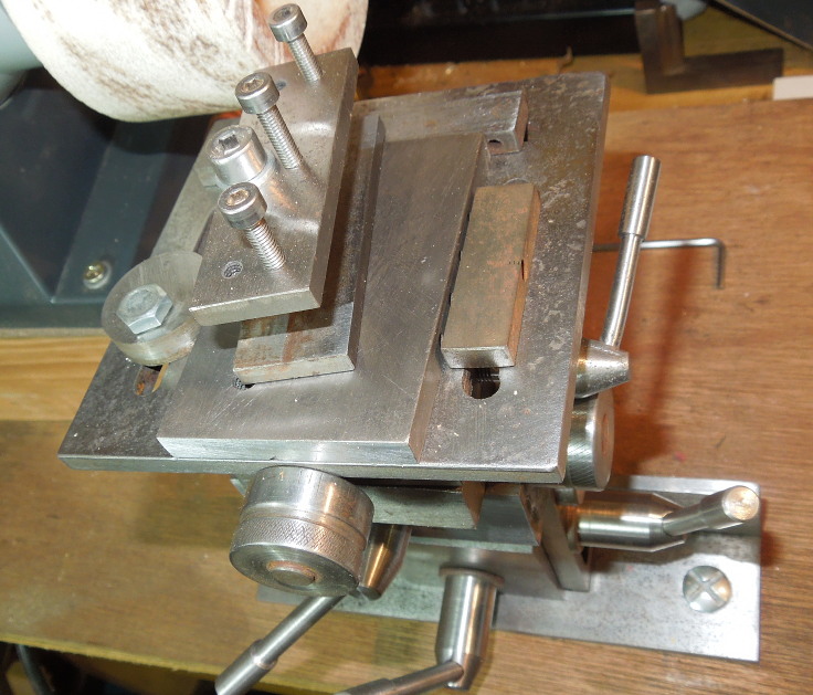

    If anyone is interested, I found my pictures of my grinding rest which I renovated following the fire and weather damage shown earlier. I post them to show what is possible with an apparently hopeless case. I disassembled the rest and removed the worst of the loose rust with wire brushes and emery cloth. The deep rust was removed from the parts with hydrochloric acid and then polished with fine emery. and protected with camelia oil The latter is good enough for Japanese sword makers so it's ok for me).
    I had to make some new handles as the originals were lost when the Loctite I used to secure them failed in the fire and they were lost in the debris, only one survived the ordeal. I will have to make some new adjusting knobs as the fire and rust did for the knurling but the graduations just about survived.

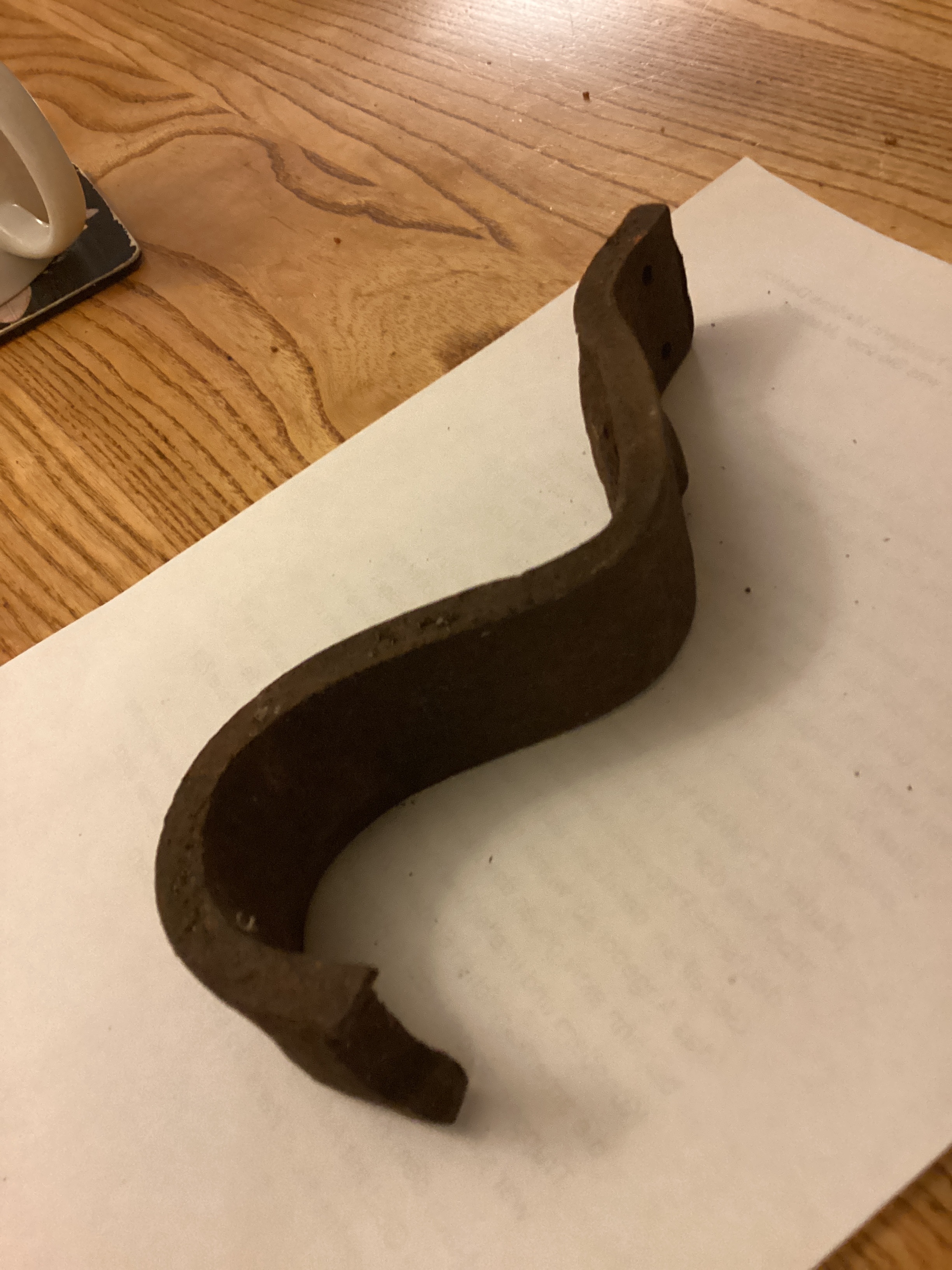

    That’s a really comprehensive accessory and I can appreciate how much thought has gone into the design and cannot comprehend the number of operations to accomplish it. But “simple”? I have cheap bench grinders and the rests are very limited, and when the stone goes down to 6” diameter, they’re no good. So, with respect, Sharpening metalworking workshop cutters, Videos-image.jpg this has been my simple remedy (made from a bit of garden gate) I hope you find this amusing. I was very surprised, talking to the homeengineer how long his wheels last and concluded that cheap bench grinders have very friable wheels, but don’t know.
