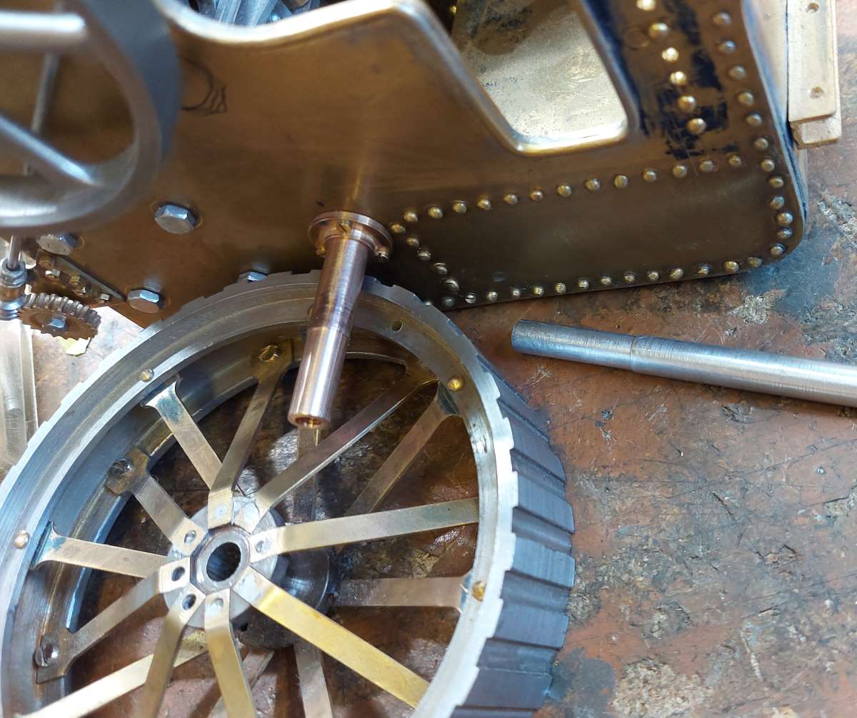

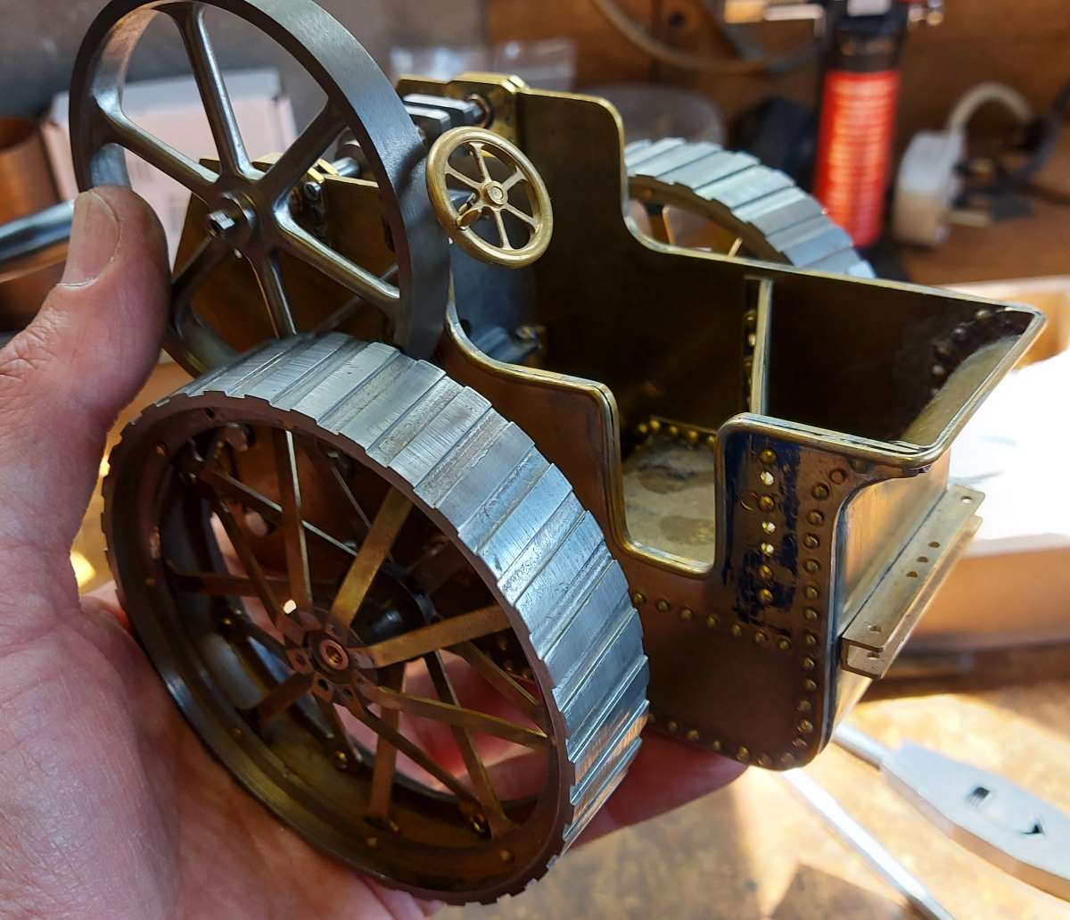

2 Attachment(s)
Just machined a solid phosphor bronze rear axle for the Burrell. OK, this isn’t a solid rear axle like a 1960’s muscle car. This is an actual solid round phosphor bronze bar that supports both rear wheels to rotate independently and then the differential sits on a separate layshaft.
Attachment 42990
and then just so that you get an idea of the scale
Attachment 42991

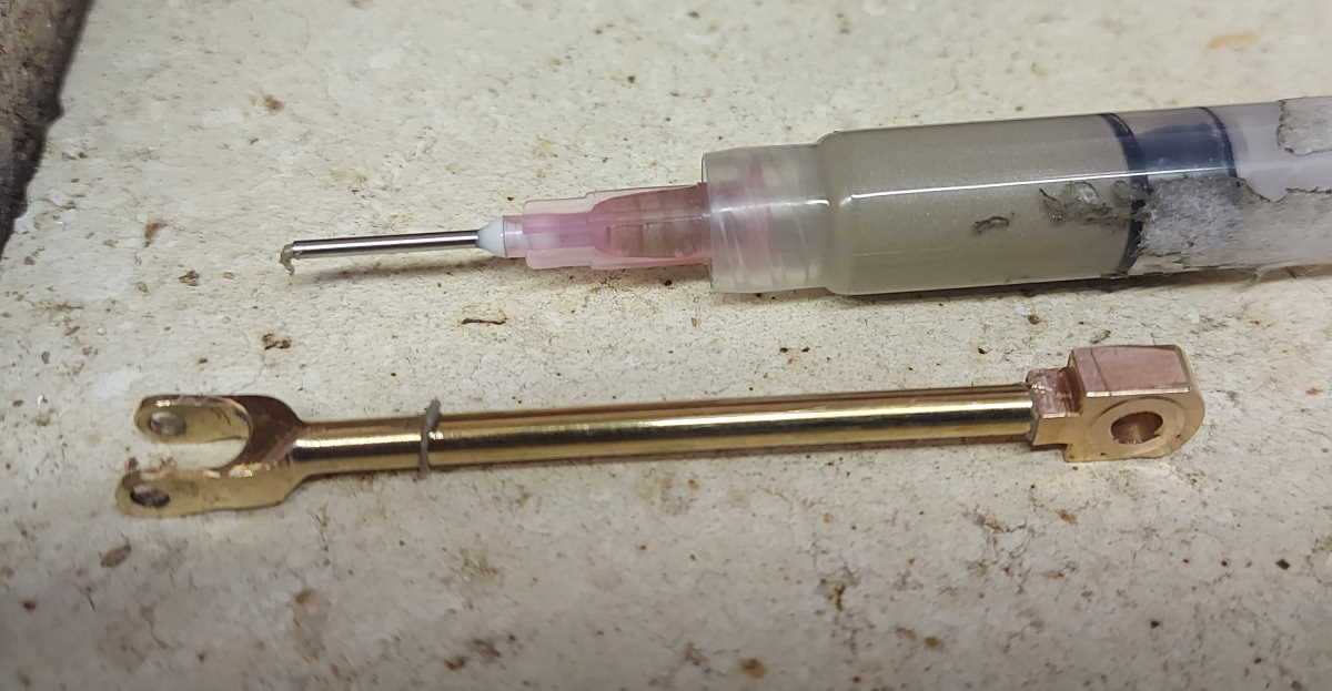

Just been silver soldering the parts for the rear hub caps and thought I would share the process of using easy flo paste, very easy to get great results on small parts
https://youtu.be/KoZwr0B4y54
I've had a bit of a break from building this, however, in the last few days I've sorted the rear axle and the rear hub caps. Now I think it is taking shape. On my latest status page of the Burrell Traction Engine there are even more images.

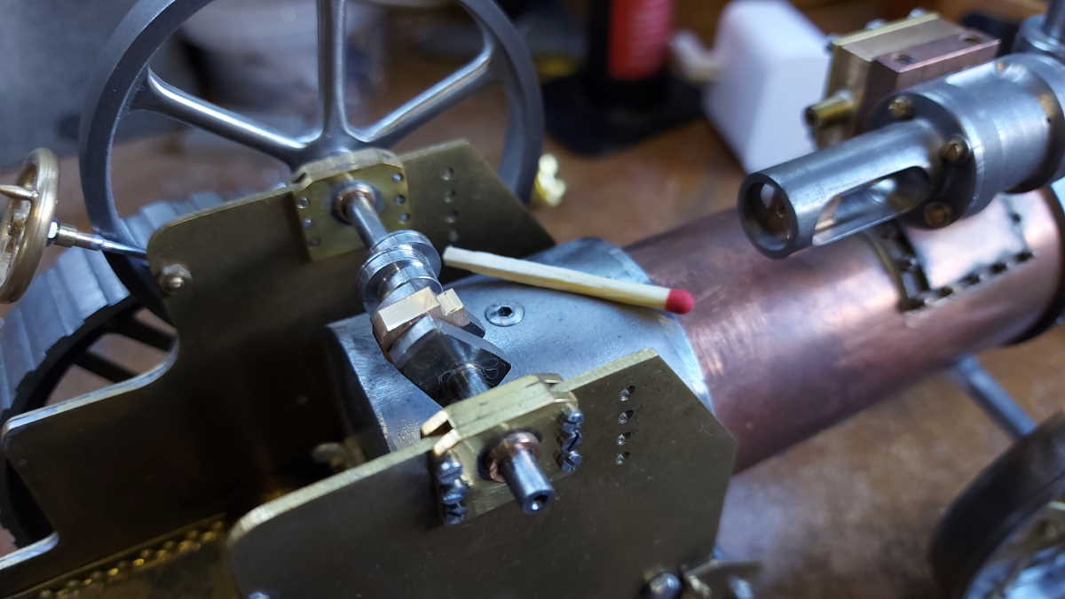

Finally the Burrell is back on the workbench and I've made the connecting rod from 3 parts
Here with the phosphor bronze big end in place. Hopefully the matchstick gives you an idea of scale.
Attachment 44117
The conrod was assembled from 3 parts
Attachment 44118

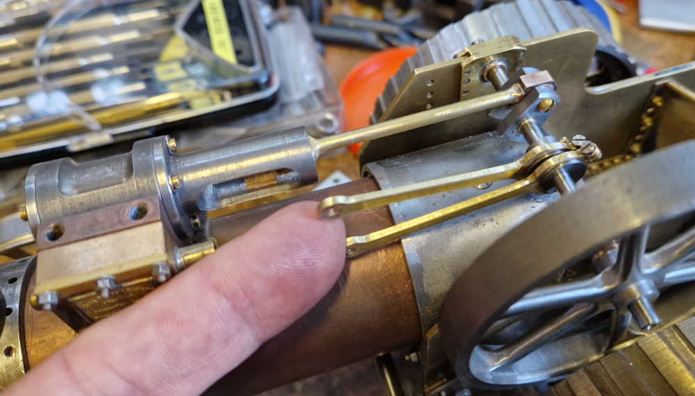

1 Attachment(s)
Spent a few hours making the eccentric pushrods and then testing them on a drill:
Attachment 44146
The two eccentrics gives the ability to run the steam engine in forward and reverse. I need to make up the slider, crank and handle etc
https://youtu.be/PeUzvlVP3us
They need a bit more fettling and finishing of the eccentric pushrods, but I'm happy for now.

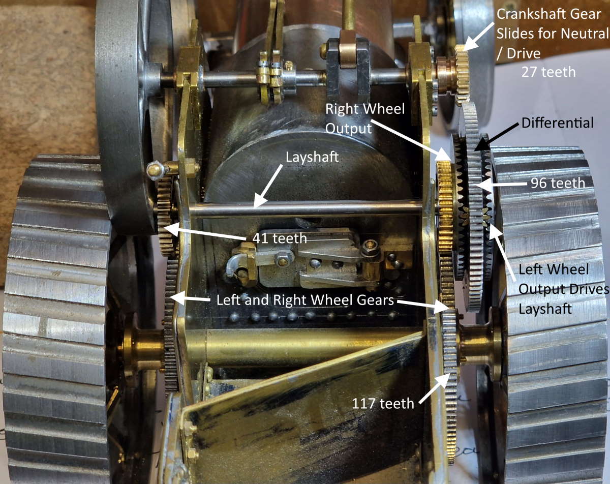

1 Attachment(s)
The differential sits on the layshaft and this takes a bit of thinking about. Hopefully the following image helps.
Attachment 44281
The drive and neutral is achieved by sliding the crankshaft gear out of mesh.
https://youtu.be/2C4Lin8xcp4
Lots more to do, but gradually getting closer to completion.
