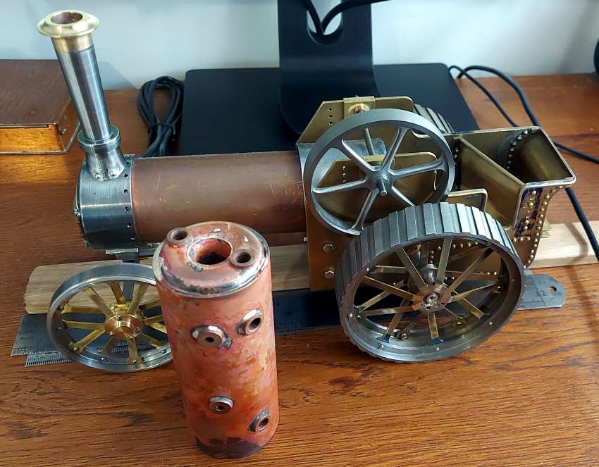

Finally I'm making that small boiler, this is the first boiler I've made. Although it's very small and below the size that requires independent testing (less than 3 bar litre) my plan is to hydraulically test it and do all of the normal sign-off testing that is required.
Attachment 38883
Would be good to hear from people who have experience making boilers and testing them.
This boiler is just 117mm high and you can see it here alongside the traction engine:
Attachment 38888

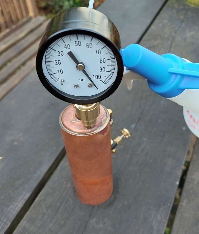

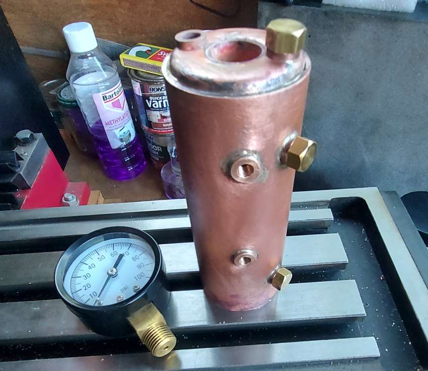

I have now hydraulically tested this to 2x working pressure
Attachment 38889

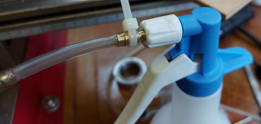

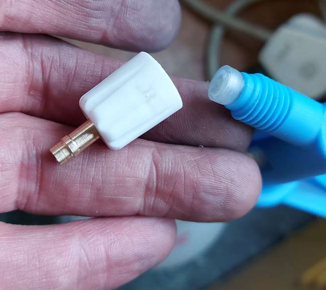

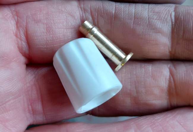

I used a simple garden sprayer - a small modification to the nozzle to fit a pipe. This easily gets to 100psi and I think it would get to 200psi - need a gauge.
I've written a brief article on making the boiler.
I will share more on testing as I need to ensure no issues under steam.
A simple modification to the sprayer nozzle and you have a pump that can pressurize a water volume at over 100psi - perfect for hydraulic testing
Attachment 38926
Attachment 38927
the fixed nozzle of the sprayer seals against the rear flange of the new brass fitting
Attachment 38928
I had to use cable ties to keep the pipe secure on the nozzle with the pressure

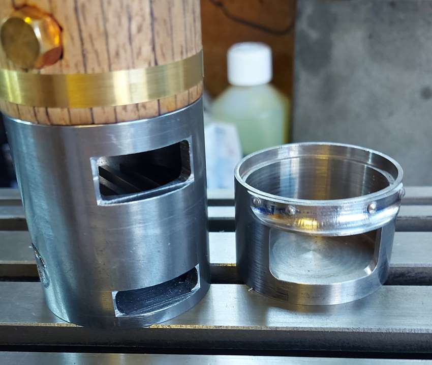

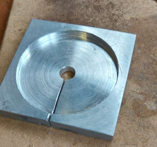

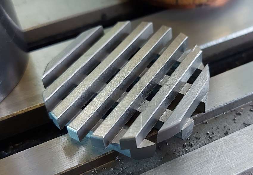

I needed a grate for the fire, but cannot cast iron and so made one from solid. This meant I needed a jig to hold the disc:
Attachment 39002
The jig was made from aluminium and it meant I could flip the part over and so machine both sides without damaging it. There were a few steps to making a cast iron grate, but it was very enjoyable. I think the finished part looks good even though you will only ever get a glimpse of this in reality.
Attachment 39003
Interesting, I would have done it using square bars and welded or bolted from the back depending on need.
Surely looks solid!
I do like the look of things that are carved from a block with holes where people might not expect them.

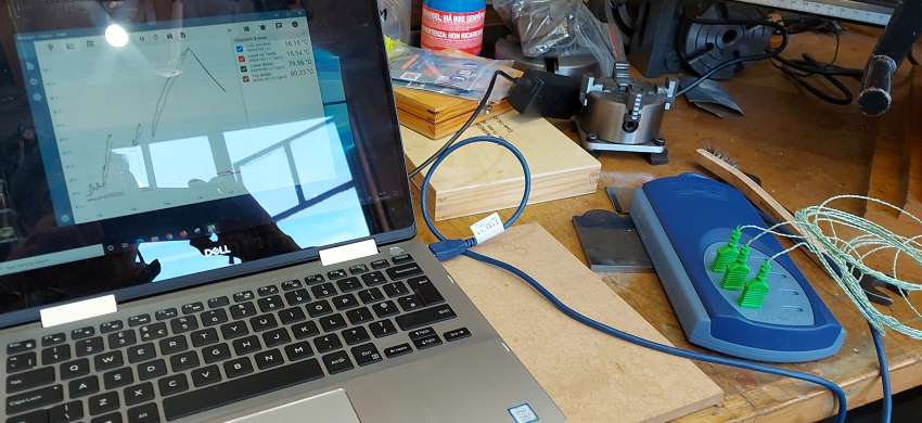

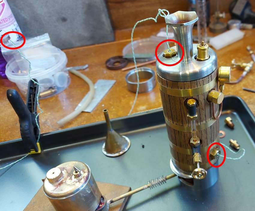

This small boiler is driving me a bit mad, I'm struggling to get the heat into it. It gets to temperature and pressure, but it takes ages considering the meths burner I'm using.
So I decided to instrument the boiler with thermocouples and to then do some measurements.
Attachment 39110
I'm using a Pico Technology measurement board and software, very easy to use. I will share the data and my analysis.
Attachment 39111
