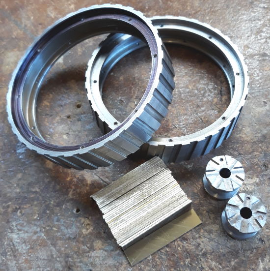

this has allowed me to cutout the brass blanks quite accurately
Attachment 33876

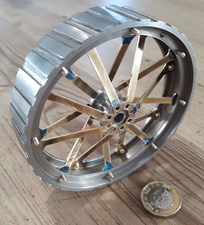

I then bolted them together in sets of 8 and machined them, they were then bent at each end 20 degrees and bolted into the rim - more details on glue-it.com
Attachment 33877
The pound coin gives a rough size.... to those in the UK. For everyone else these are 97mm diameter (just under 4 inches)

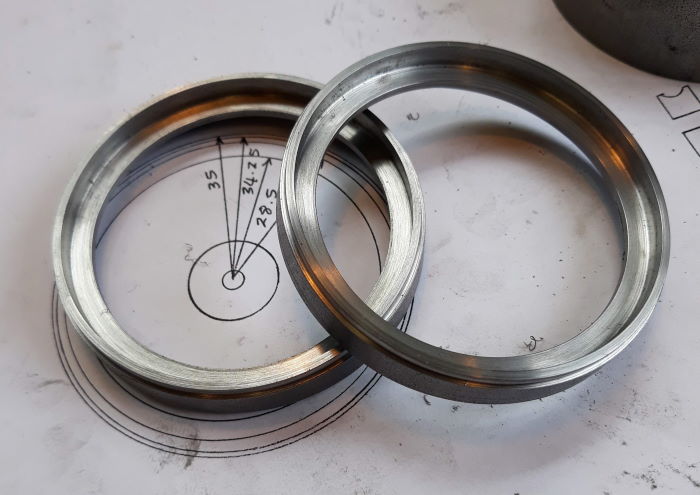

3 Attachment(s)

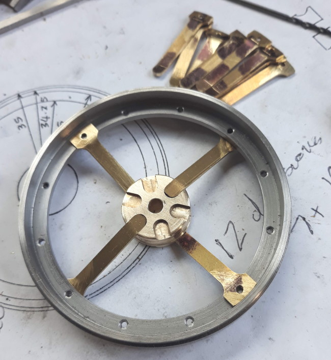

Just machined the front rims, roughed out and laying on the plan
Attachment 34866
and then machined in detail
Attachment 34867
gradually getting there with this project, a piece at a time

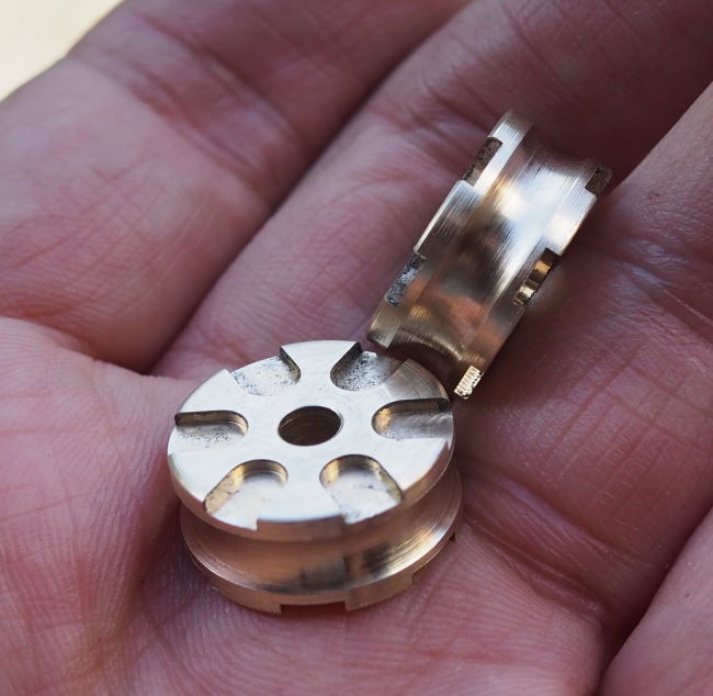

3 Attachment(s)

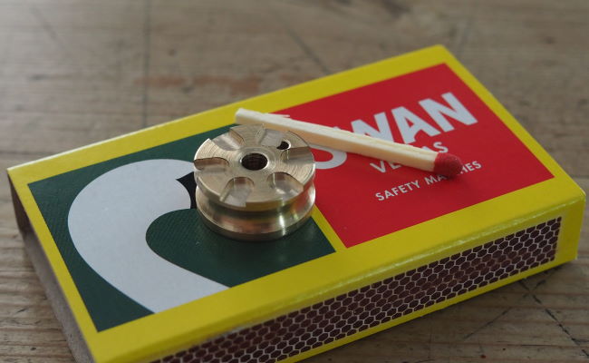

Finally got round to making the front wheel hubs, this time I made them from brass. I had a few mishaps along the way, the first of which was cutting 5 slots rather than 6, a complete nightmare of a saturday afternoon:
Attachment 35243
Just to put them into perspective the following photo shows a hub on a matchbox:
Attachment 35244
In the end I managed to align, jig and make a pair of hubs
Attachment 35245
a few more picture of the making process are available.
Looks really good. Thank you for sharing.

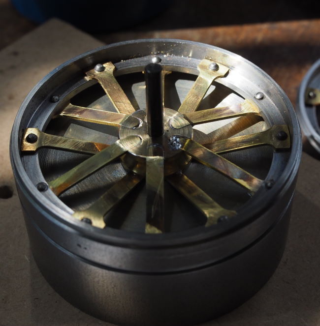

4 Attachment(s)

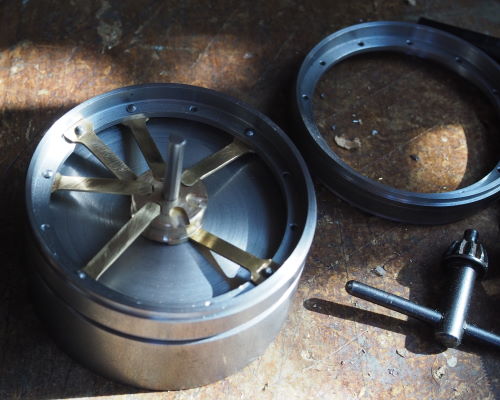

Just had to share some images of the wheel assembly process, after hours of making parts this is the best part
Attachment 35259
Just offering up parts to check it all fits. I made a simple jig to align the centres.
Attachment 35260
I riveted the spokes to the rim with 1/16th inch steel rivets. I then soldered the spokes to the hub whilst on the jig

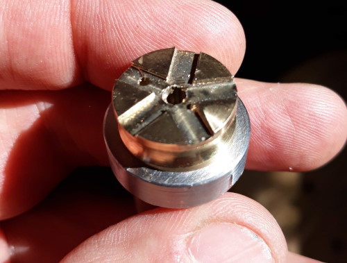

Attachment 35261
The final machining of the hub was done on the lathe, but I hand-cranked the hobbymat to take extra care.

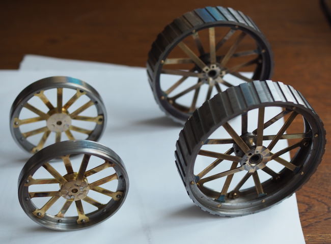

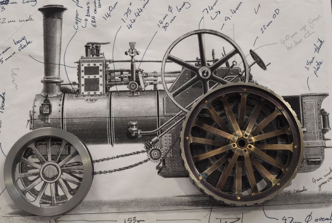

Finally an image of all 4 wheels:
Attachment 35262
A lot of hours have gone into the wheels, a process of research, drawing, machining, re-machining and finally assembly.
