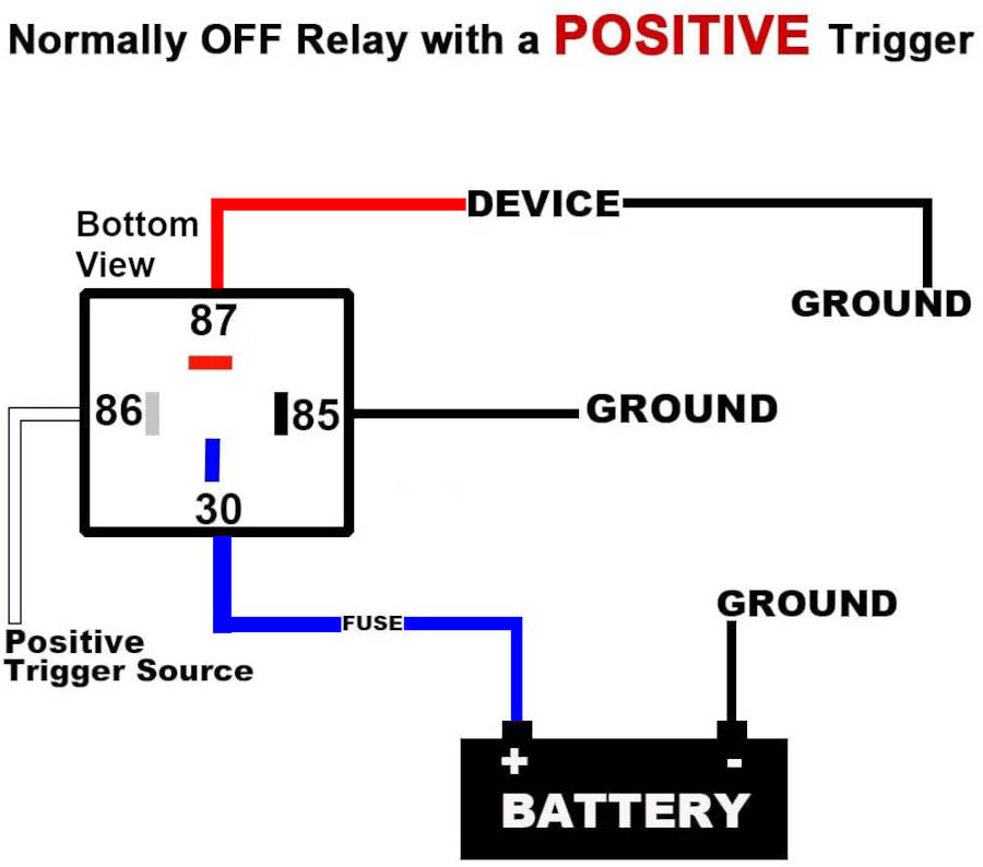

    So what to do? Bypass the key switch so that the key switch doesn't need to supply the current to the starter solenoid. Obviously, my test of the direct connection of the input to the battery showed that. A relay was needed. The key switch would close the relay and the relay would energize the starter solenoid. The relay I found was rated at 30a - well more than what the solenoid needed, and it had a 30a fuse and a socket with wires. The relay control was to be the solenoid energize voltage from the key and the power to engage the solenoid would come from the battery, which was connected to the starter with a nice big cable.

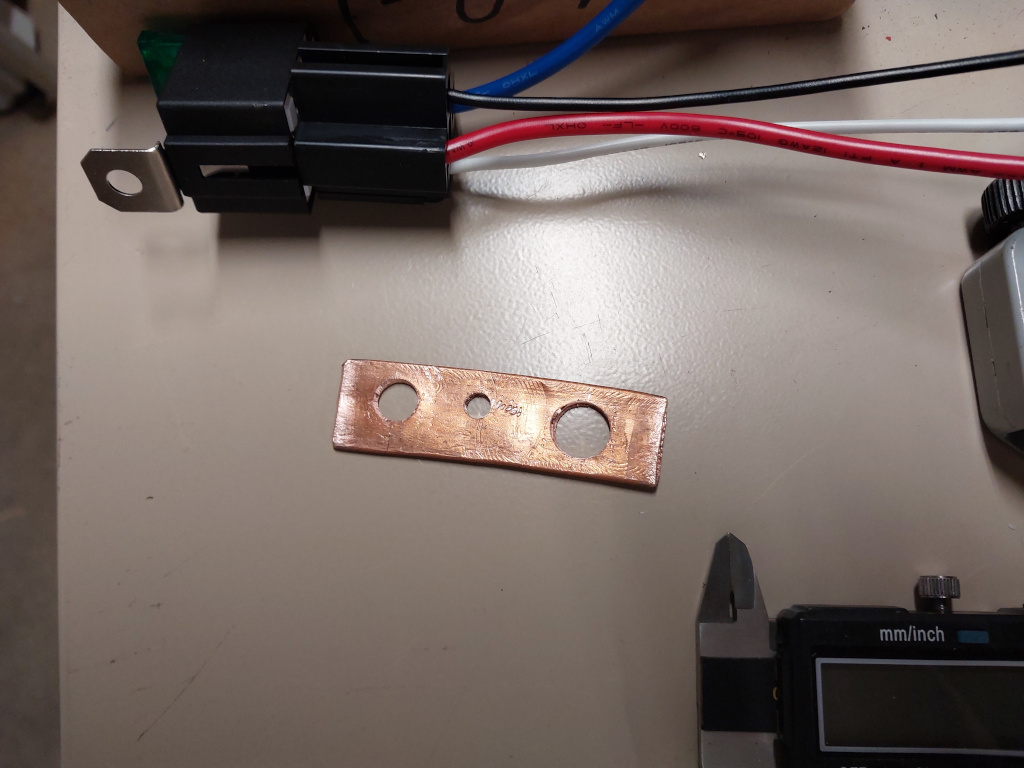

    First to make a buss bar to hold/connect everything. This was from a 2.5" piece of 1/2" copper tube. A hammer to flatten (both sides to make it flat) and then drilled for three holes (use step drills after the ppilot hole because copper is soft and grabby) - M10 for the starter battery stud, #10 for the power supply to the relay, and an M6 for the tab of the relay to hold it in place.
    Here is the relay schematic - corrected for the color coded wires of the relay socket:

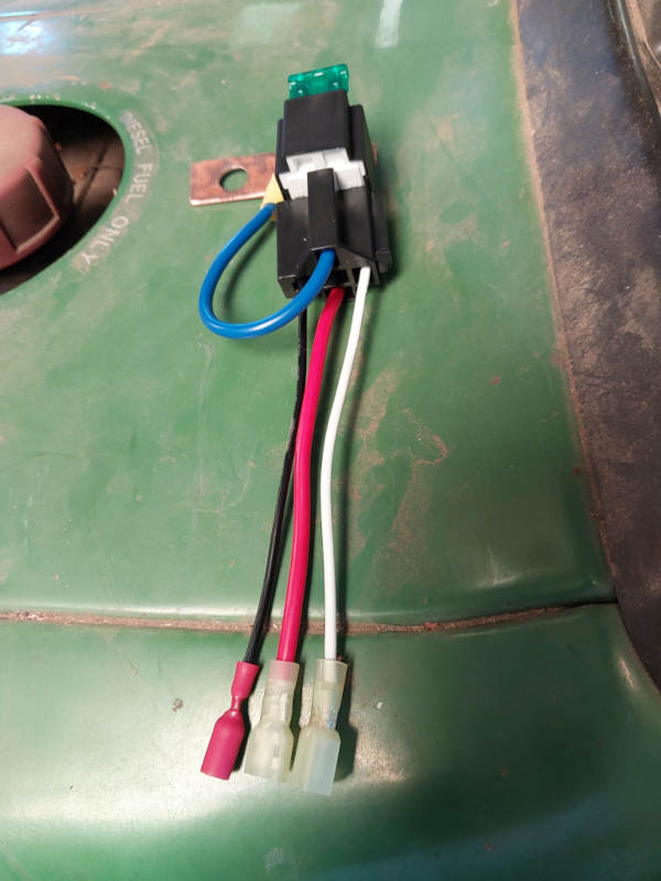

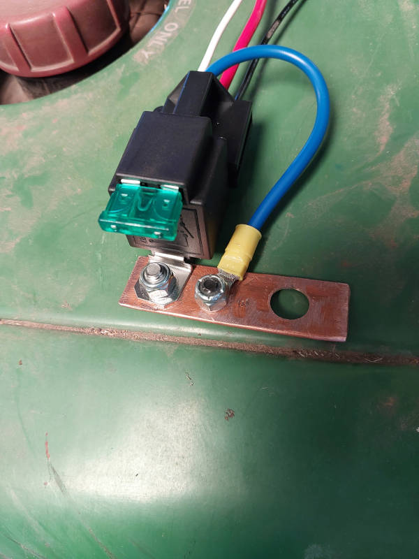

    The assembled device looks like this:

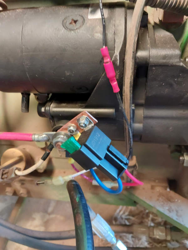

    And this is what it looks like installed:
