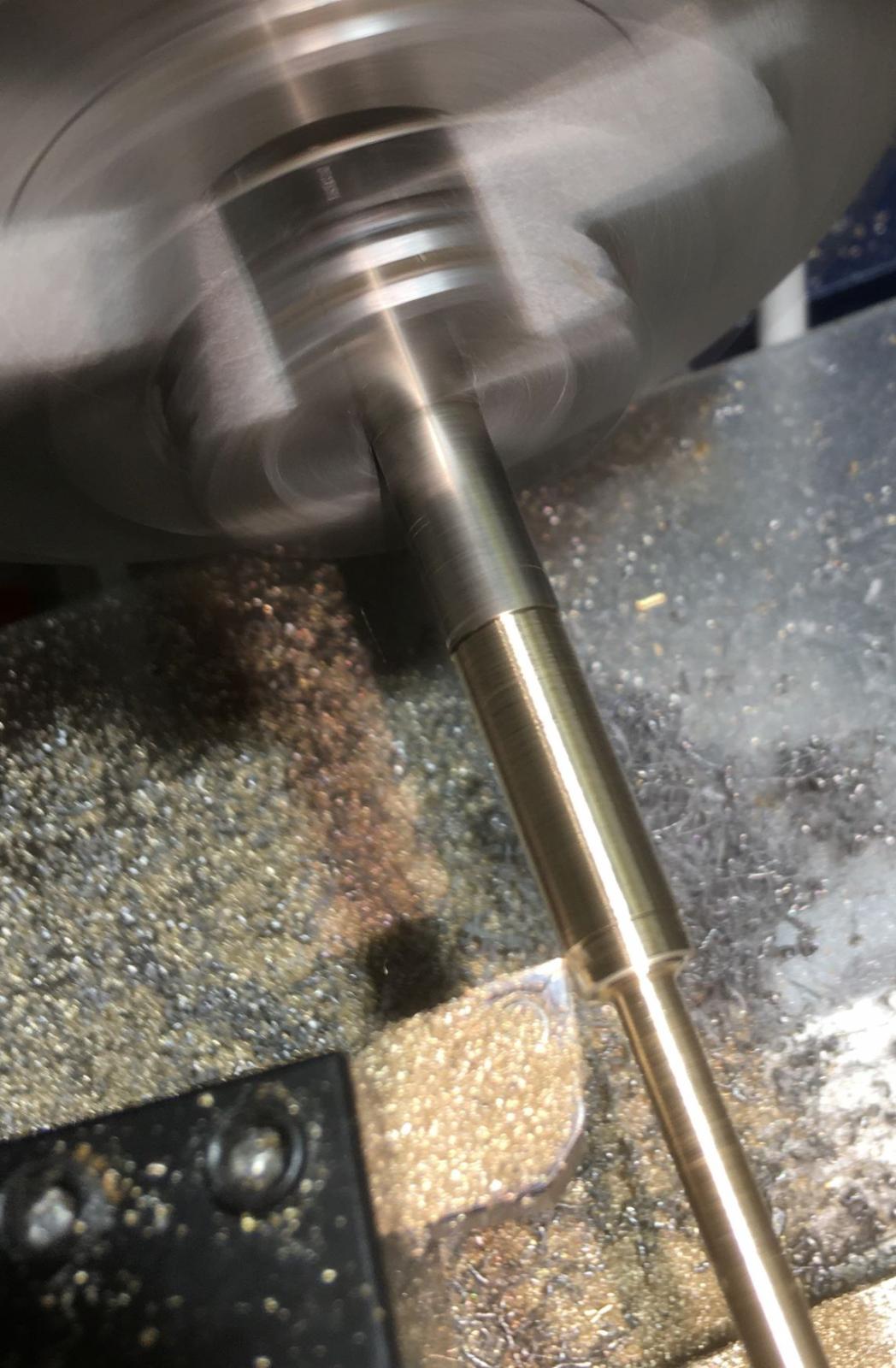

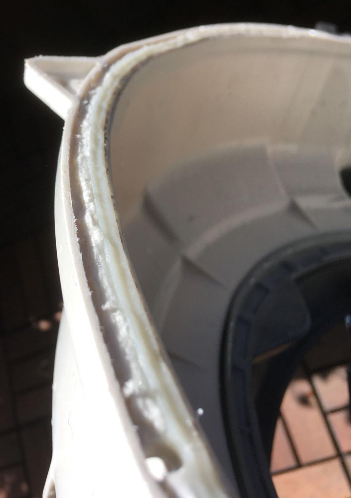

3) As per some readers' excellent suggestions, I've decided to carve out an "O-ring groove" around the tub's perimeter,
to have something for the RTV seal to stick into when the drum whirrs along at 1600 rpm.

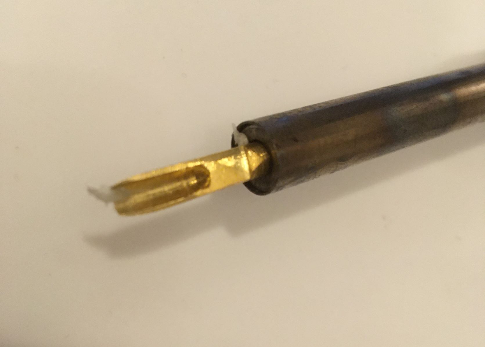

Hence I figured a DIY tip for my soldering iron would do as a DIY "curved hot chisel".
Chucking up a piece of 6 mm brass (former electrical plug pin) taking it down to 4,2 mm:
Attachment 35156
then drilling a 2,5 mm hole, 1/2" deep, taper the end, file half of it off: a 10 min job, and voila:
Attachment 35157
Plugged in, waited for a 2 minute warm-up, and off I went (sorry: no pics).
Worked like a charm, "the swarf" curled up nicely and out of the chisel groove.
After about 1/4 of the perimeter (and 5 minutes) the soldering iron finally died,
a quickie resistance check proved that the (sealed) heating element's nichrome wire now is "permanently open".

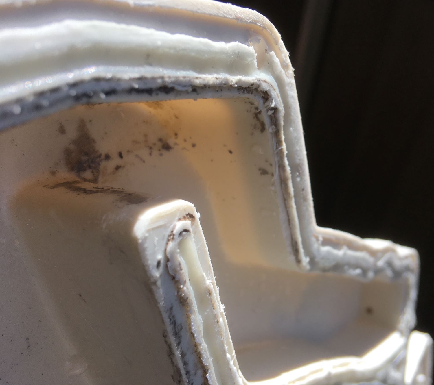

Short followup on the (relative) progress of the DIYed "RTV O-ring/ seal tub perimeter groove":
Ditched the promising "sodding iron" due to lack of contemporary devices available with a replaceable tip.
"Modern" ones comes as a complete "sodding station" at a pretty steep price (for a Cheapo like me) -
not the temp controlled all-in-one iron I bought for 20 bucks 30 years ago.
Tip & heating element is today "a unit" instead... -Now, where did I hear that word recently?
I'm also NOT needing a whole & heavy "station" in my portable tool portfolio for those night calls :)

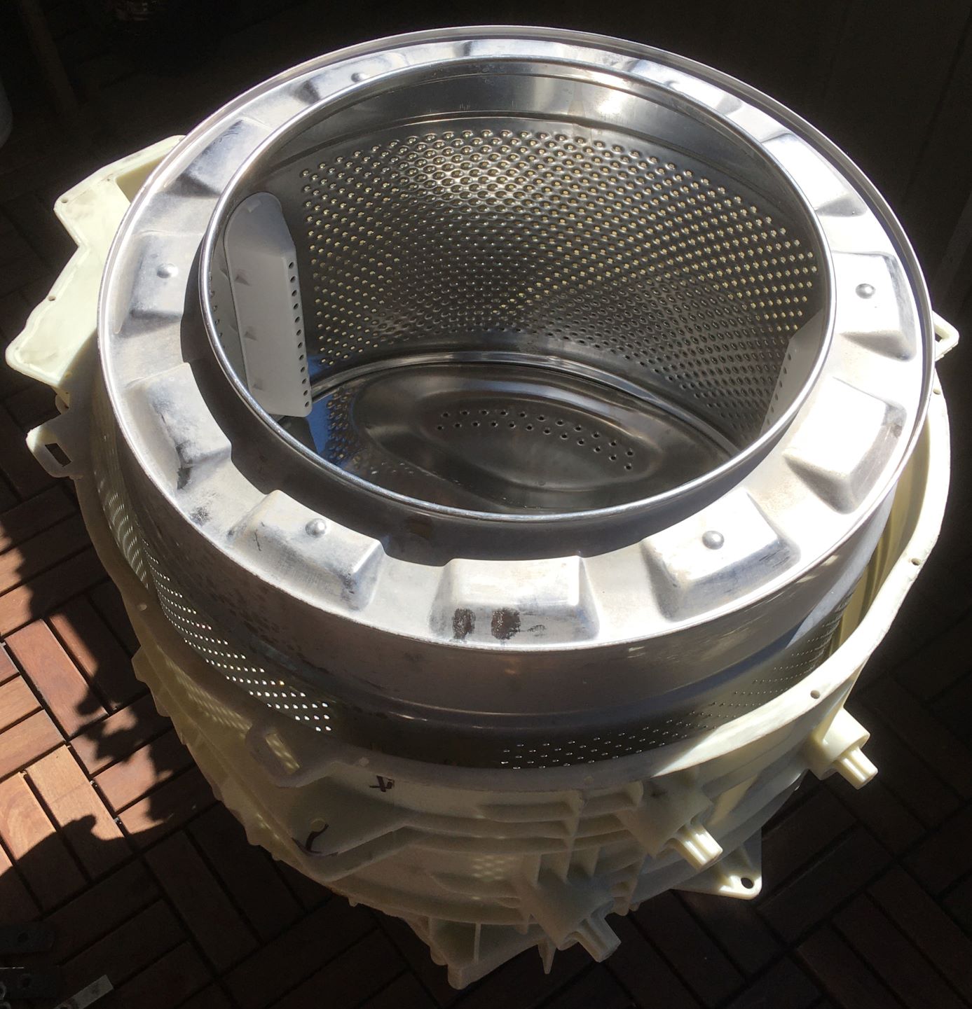

Instead: Armed with my Ferm (Dremel) and its flexible shaft (discount find)
and an appropriate 3 mm rotary burr i give the following report of Proper Dremel Handling:
(Provide yourself with patience and humility - this isn't something personal against you,
any other idiot taking on this job will suffer just like you.) :
1) Hang the Dremel high (but not in the cable, Stupid!), let the shaft hang freely downwards.
2) Grease the inner flexible shaft thoroughly before starting. Then every hour of service.
3) Run only 'til you can feel the warmth off the flexible shaft, let it take a cool-off break.
My guesstimate is a 50% duty cycle at 10 minutes on/ off.
4) Don't run it wide open - minimum speed is plenty enuff.
5) Use goggles, hearing protection, gloves and a non-synthetic coverall. Be "positively elsewhere" - i. e. outside, far away.
Yup - those tiny statically charged plastic shards from the burr will stick to anything synthetic,
and though the tool & shaft is happily just whirring along, the resonant sound from the burr working the tub is "impressive",
and NOT something your next of kin or neighbor will take for the approximate hour it takes to finish off.
6) Use a small planer to rid the edge of the unintended ridges the burr inevitably will create, sand the edge.

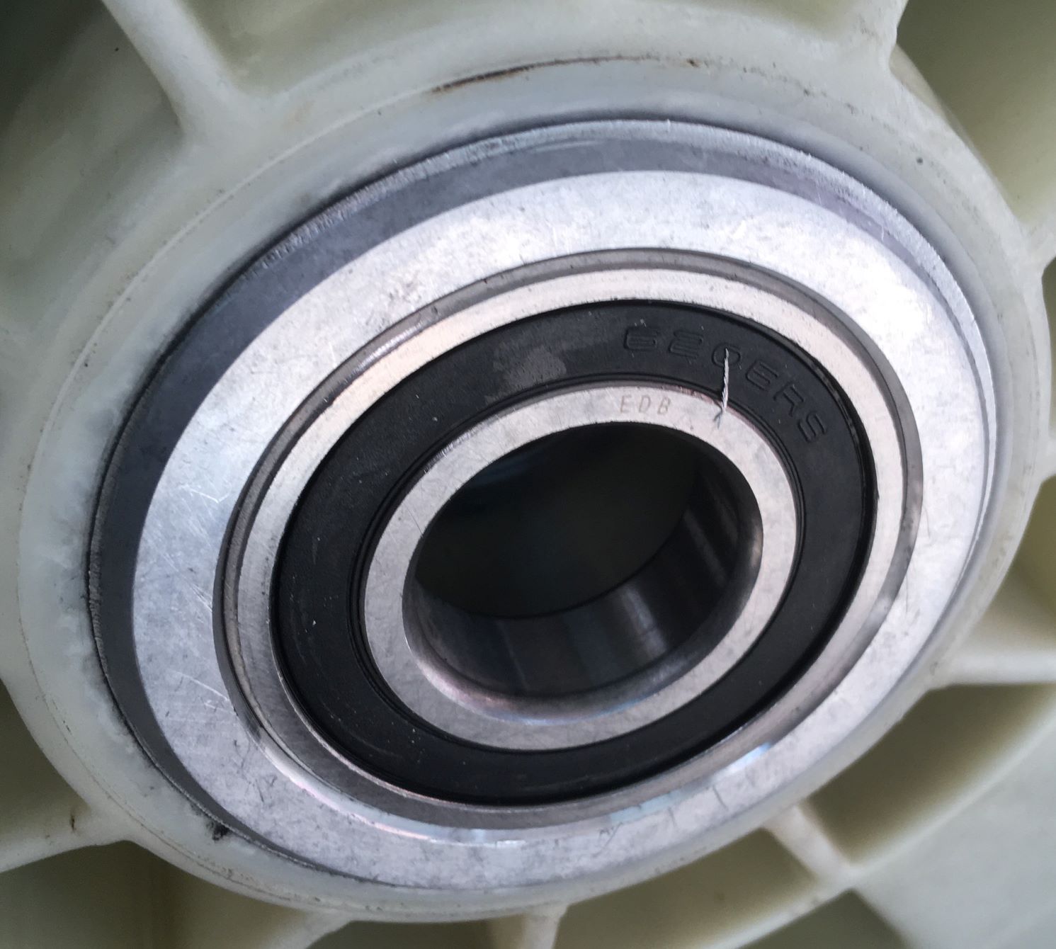

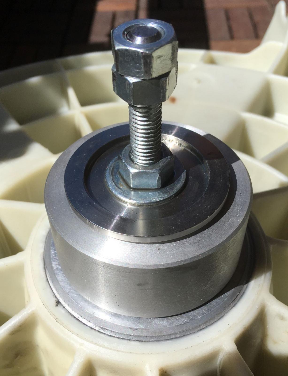

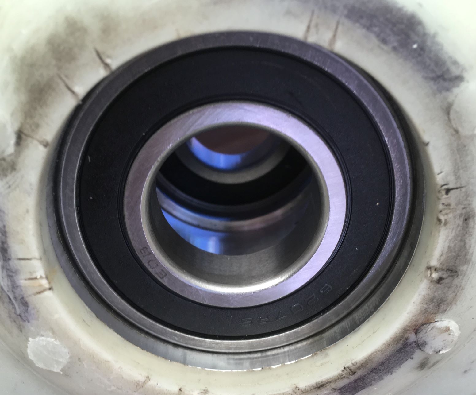

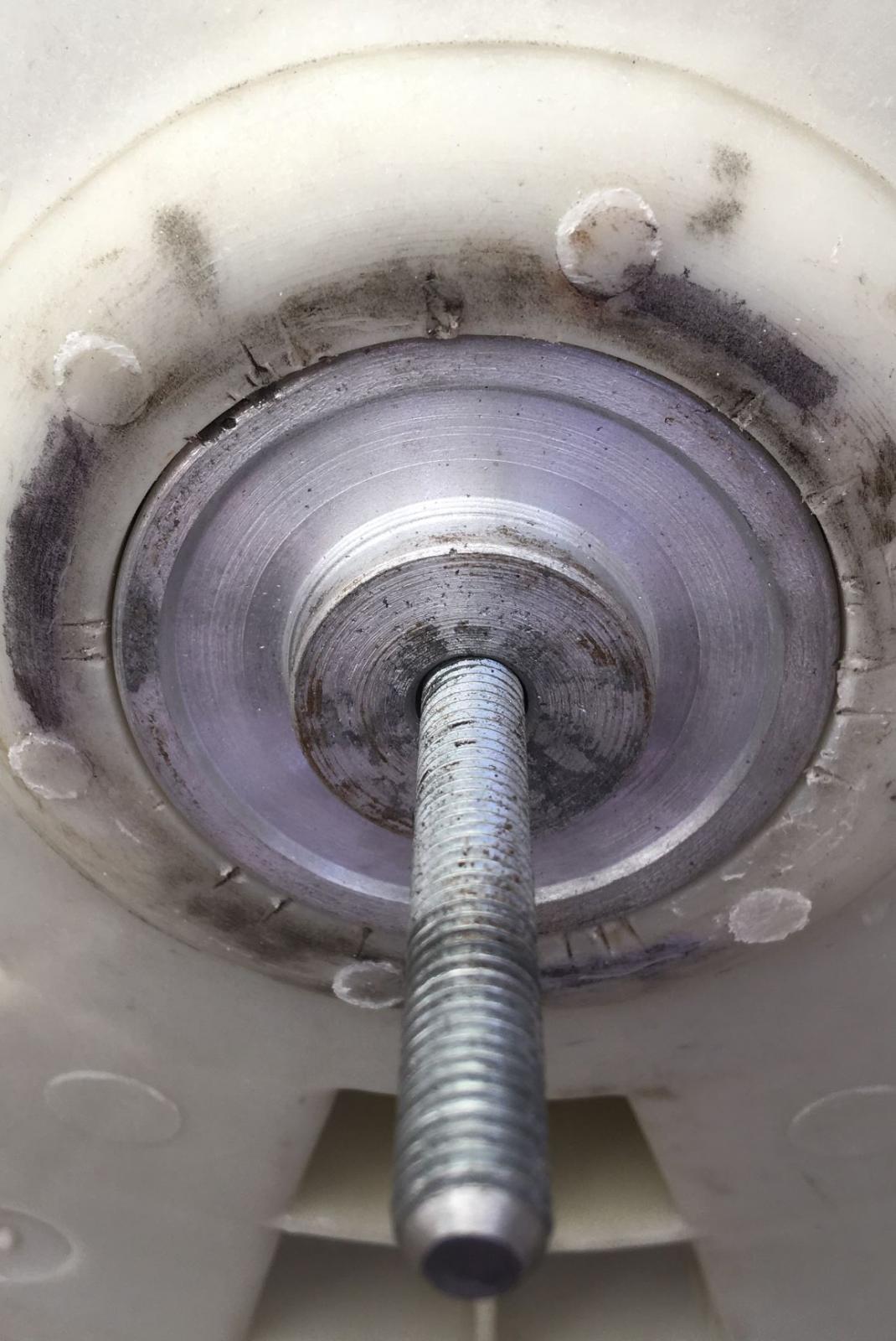

Some of you happy few readers still bearing (no pun) with me, might remember the CO2 extinguisher ball bearing freezer idea.
Well - the test on the previous night left me with a pretty good conclusion from the old bearing freezing test:
Starting with a 100 C heated Aluminum bearing seat, moving in with a frozen ("-70-ish" C, as my IR thermo bottoms out at -50)
bearing almost instantly pulls the heat from the very heat conductive Al, making it "Insta-Shrink" on the bearing,
as Al thermal expansion also is bigger than steel's. So neither heat nor cold will be applied to the new bearings - mere force.
(Example: I make Al round stock by pouring the melt into steel tubes - stock only get a loose fit within when it's cold again)
Starting out with the bearings and their ass'y hardware:
Attachment 35184 Attachment 35185 Attachment 35186 Attachment 35187
The whole affair went so smooth and quick I forgot to take any pics of the oil seal being fitted, sealed and greased,
then suddenly the previously meticulously cleaned drum merely jumped in. -No sweat.

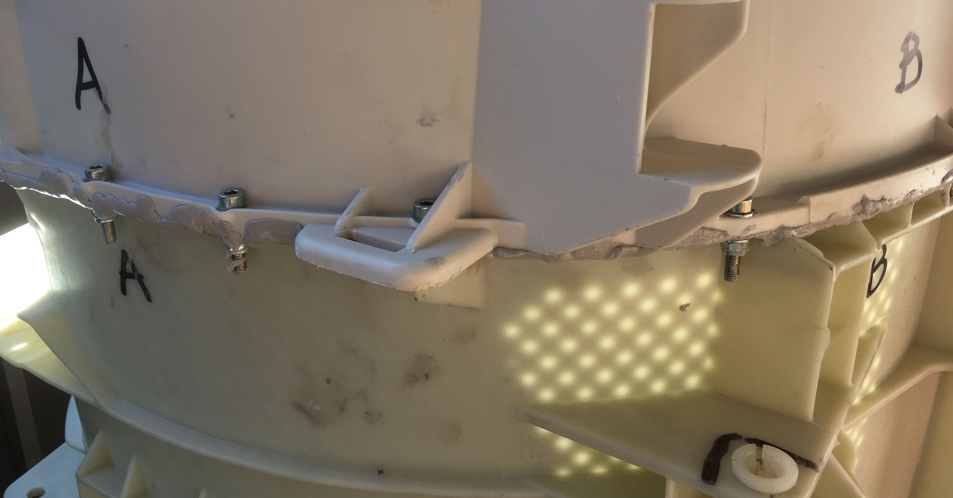

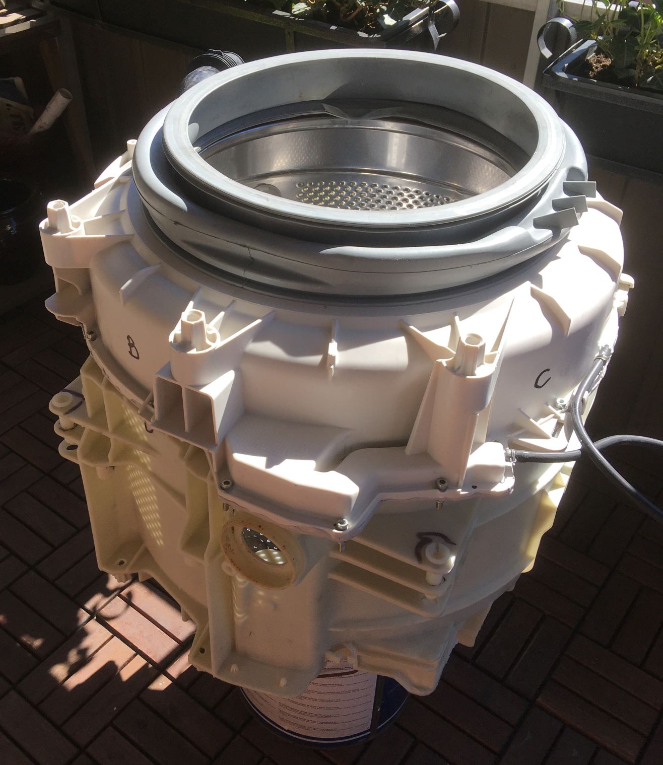

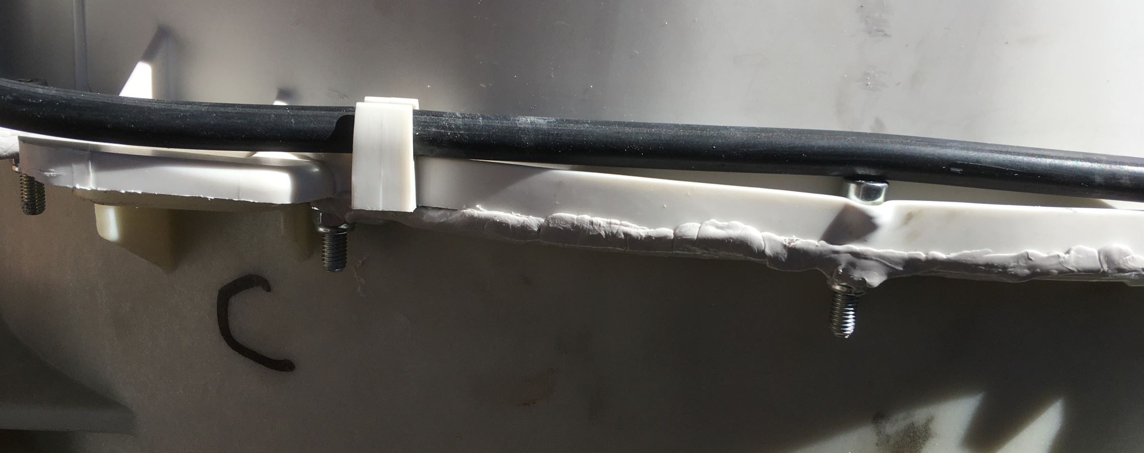

Hardest was catching up with the flow: gathering the bolts, washers, nuts, tools and a 2 year old leftover tube of RTV:
Attachment 35188 Attachment 35189 Attachment 35190
Having drilled app 20 holes around the tub perimeter, fitting the washers and M5 locknuts was the biggest challenge,
desperately trying not to get the grey silicone (nicely matching our kitchen tiles) on my hands, tools or clothes.
Lemme say that part of today's operations went "So-So".
Attachment 35191 Attachment 35192 Attachment 35193
Left sunbathing on our balcony in the afternoon sun - three hours after startup today -
With a pretty big WAF (Wife Acceptance Factor), and an amazed teen-age (usually dad-sceptical) daughter.
It really doesn't take much more to keep this Swedish Cheapskate happy,
and "being at it" thru some years now, I coincidentally seem to have acquired a certain portion of luck?
Tomorrow, when the tub is semi-cured, refitting the motor, belt, concrete weights and drop the thing into the chassis,
hook-up of springs, dampers, wires, hoses and bellows - refitting all stays, electronics, panels etc,
giving ithe RTV a coupla days of extra curing before the final test:
-Will it be water-tight? -Will it even run? "The mystery deepens as the plot thickens."
