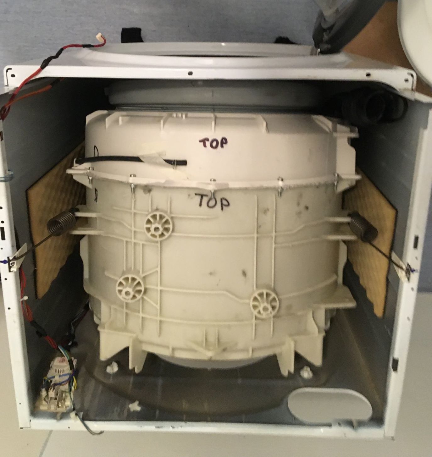

By exploiting "the Next-of-kin", we managed to levitate the drum unit upwards and down into the chassis:
Attachment 35211 Attachment 35212

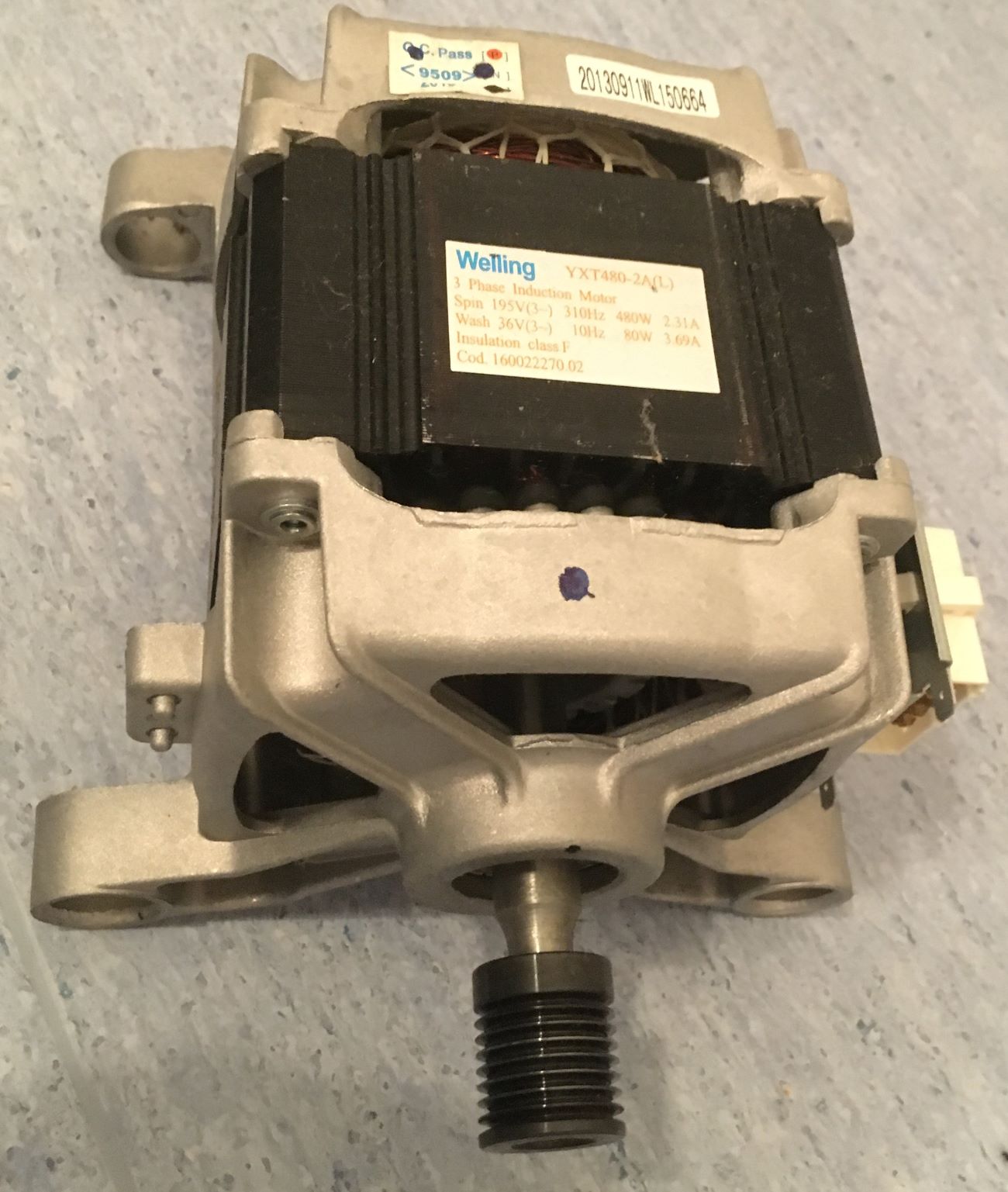

Motor looks brand new, no wear detectable, it just slipped in - fitted the Poly-V belt,.

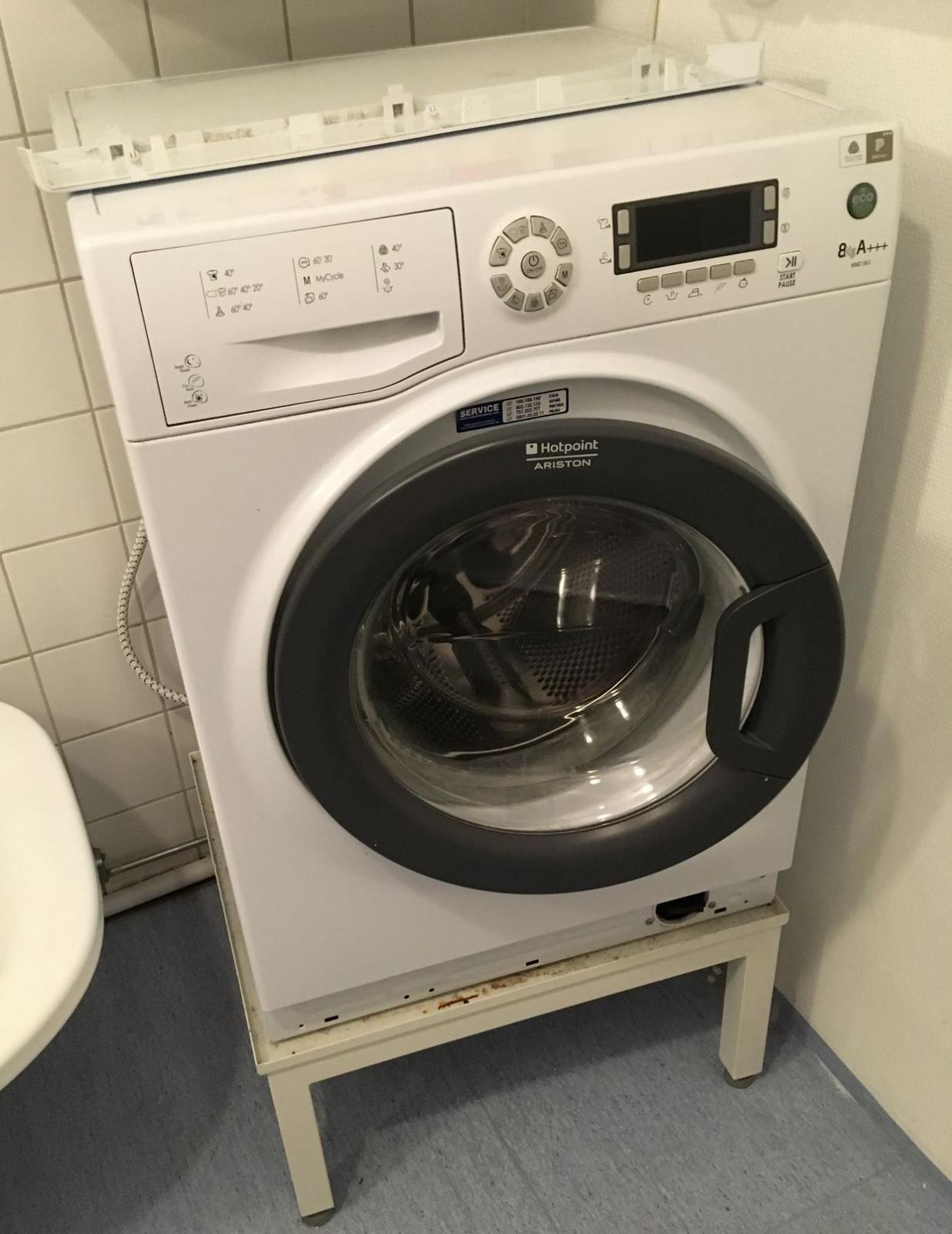

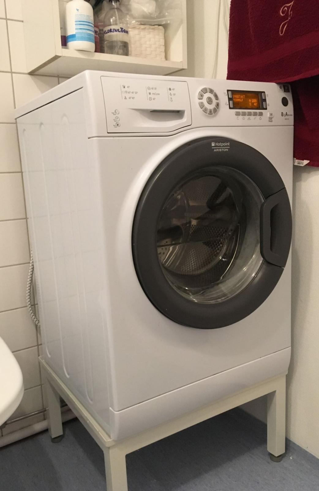

Not much have changed, though: "Before" and "After" shots:
Attachment 35214 Attachment 35213
-Does anybody have any questions?

And absolutely consequential to this, I broke my self-imposed RTV cure time limit (another 24 h) and just ran the darned thing.
No leaks whatsoever, works great, spin cycle hardly heard even @ 1600 rpm.
Providence seemingly watched over this fool today.
Now this washer is up for "the long term test"...:)
