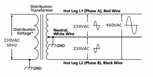

    Why would anyone want to go from 3-phase to 2-phase?

    You don't need a 3-phase transformer. Single phase boost transformer ANSI schematic below:
    Rotary Phase Converter (Create 3-phase power from a single phase source)-lcmagnetics230vacboosttransformer.jpg Sorry, I've not yet been able to finger out those ISO symbols.
    The output section is configured so that there is a 180° phase shift from one output to the other. That will give you two 230V outputs a half phase apart. That is what we have for residential high voltage here in the USA (except it's 240-250V). With that you can use that at the input to my design and create (kind of) a 230V 3-phase suitable to run your 230V, 3-phase motors with reduced horsepower output (83.3% of the nameplate rating)
