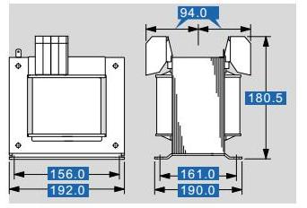

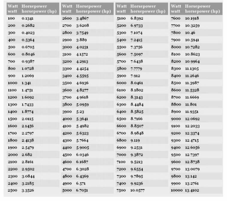

    Quote Originally Posted by nhengineer View Post
    Mr. Kodger,
    After sleeping on it for a bit, I believe an isolation transformer transformer may (or may not) be your wisest choice. Immediately below is a watts to HP chart which should be useful in sourcing a proper transformer.
    Attachment 16180
    Next is finding a transformer with the proper KVA rating. For 3HP you'd need about 2400Watts so I quickly looked at the Newark catalog.
    http://www.farnell.com/datasheets/18...440.1484843408
    Attachment 16179
    The cost is around $450 US plus shipping. The transformer above is NOT the exact one but it is representative of the device you'd need for 3.0HP. If you'd like for me to try and find the exact one let me know. It is not totally unlikely that you may need two transformers to do what you need to do.

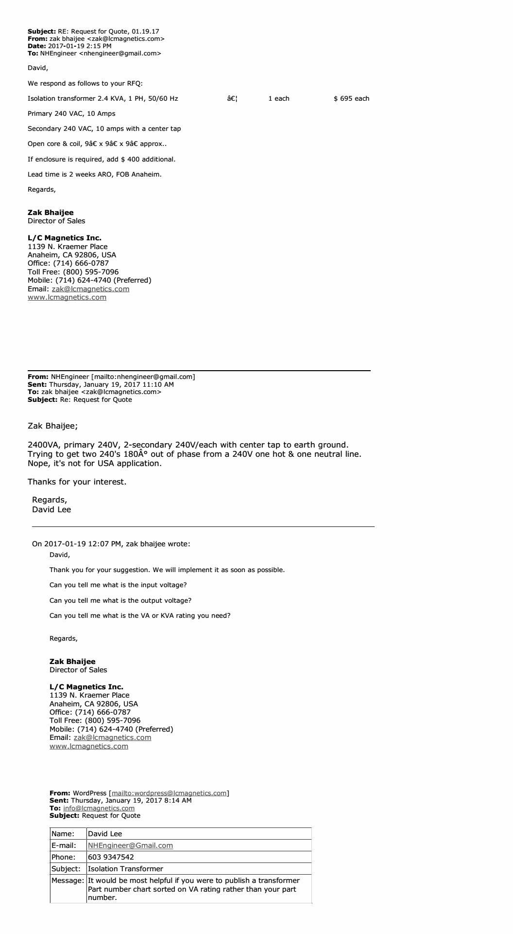

    $700 US FOB Anaheim, CA, USA and you'd need to fabricate your own enclosure.
    Rotary Phase Converter (Create 3-phase power from a single phase source)-lcmagneticstransformerquotation.jpg

    I thank you for your effort, but now you see what I mean when I say, in Australia most of the options to date are totally uneconomic, for instance, I need to power a 3 phase mig welder which is name-plated at 10 amps per phase which is about 7.1kw at 230 volts. If a 3hp transformer is likely to cost $450 US that's around $600 AU, and I might need two...$1200 plus freight, and as I mentioned before freight from the US to AU needs the surrender of ones first born, I would not be surprised to find that the freight exceeded the initial cost of the transformers. Also 3hp would woefully inadequate, I need at least 10 amps per phase, for a overload margin, maybe more.
    So at a potential cost in excess of $2400, a second hand 3 phase generator is starting to look a lot more realistic.
    I thank you for all your effort, and indeed to all the other contributors to this thread, but unless I can find a way to control a synchronous motor acting as a generator, I have two options:- buy a generator or attempt to rewire the welder to run on single phase. Incidentally, I'm informed by the manufacturers of the welder, that the configuration internally is actually three separate transformers feeding a bank of full wave bridges, so it could be possible.
