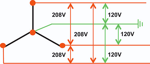

    Quote Originally Posted by Junker2 View Post
    If we can rotate an unloaded 3 phase motor with single phase power in the US why can't they rotate an unloaded one in Australia with single phase power? Is anyone following my reasoning here?
    Just wondering
    Junker2
    AKA Terry
    A three phase motor will NOT rotate on single phase. At least no three phase motor I've ever used would. None would even rotate on two phases without a pony motor to start it up. Where are you getting that from Terry?
    By the way, 208 is a product of a 3-phase "Y" generator.
    Rotary Phase Converter (Create 3-phase power from a single phase source)-208v-yschematic.jpg
    If you have 208V, it is unlikely that you have 240V too and the converse it also true. It has nothing to do with the location being home, office or shop. It is what your local electric company is producing.
