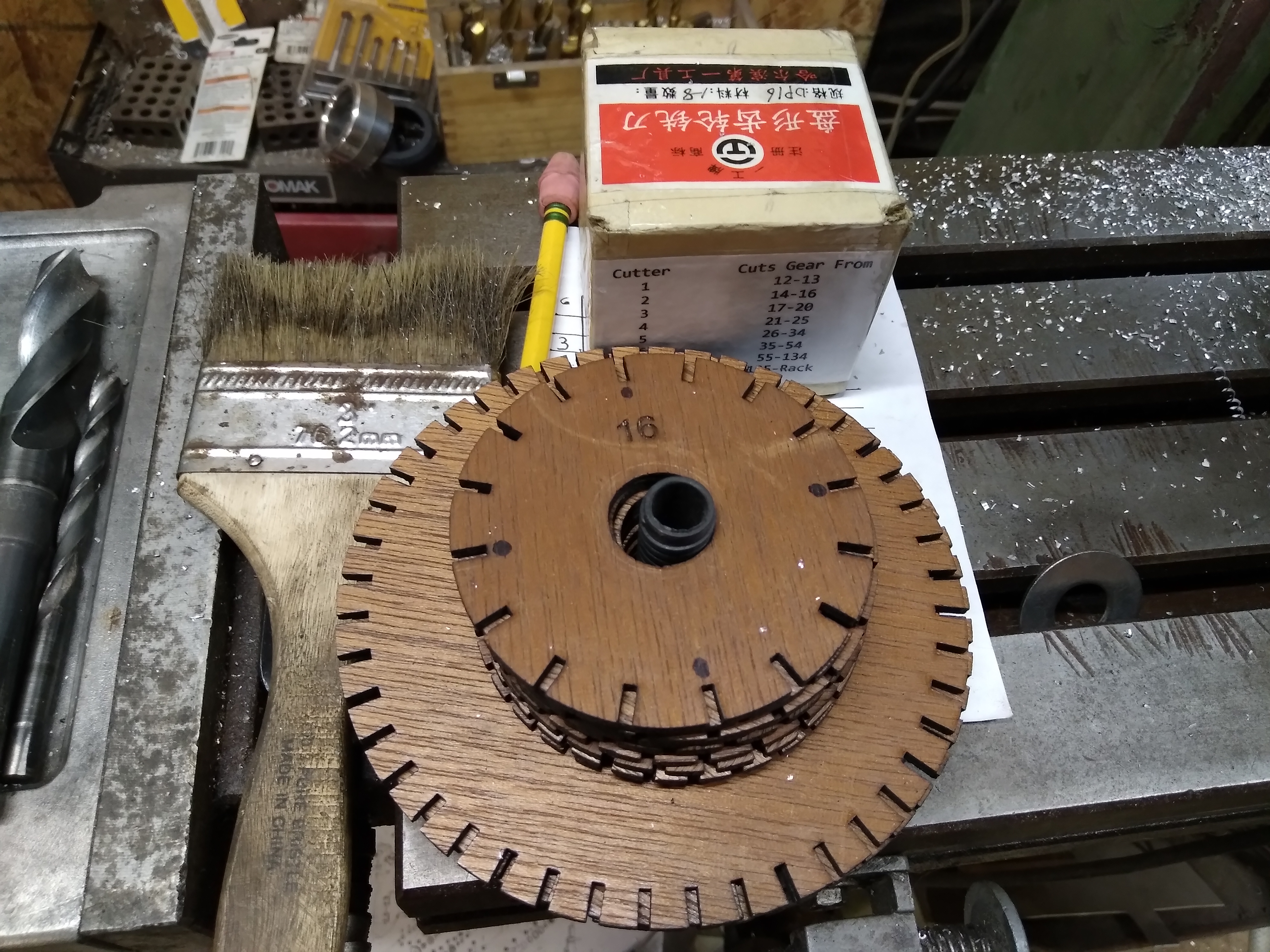

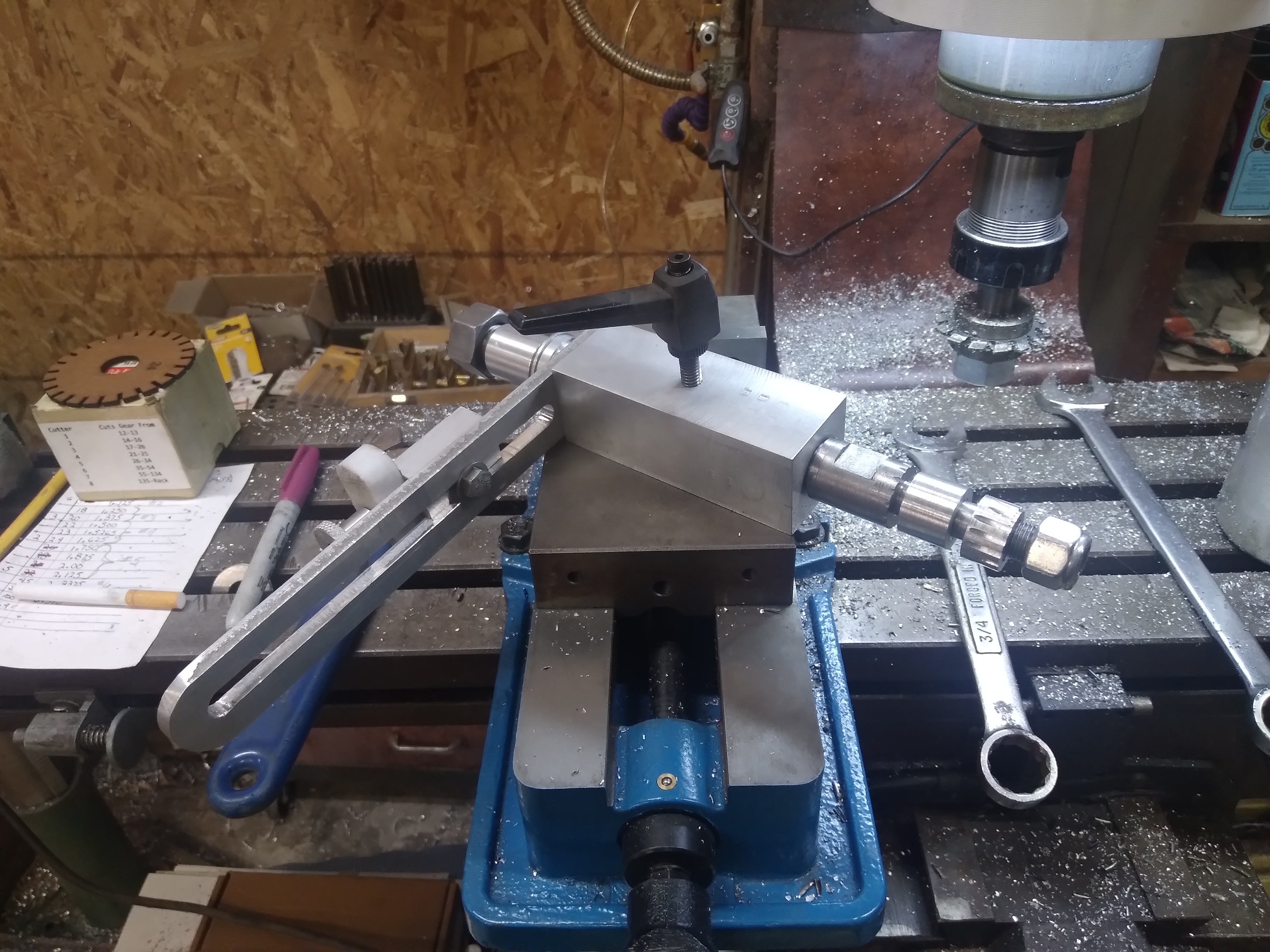

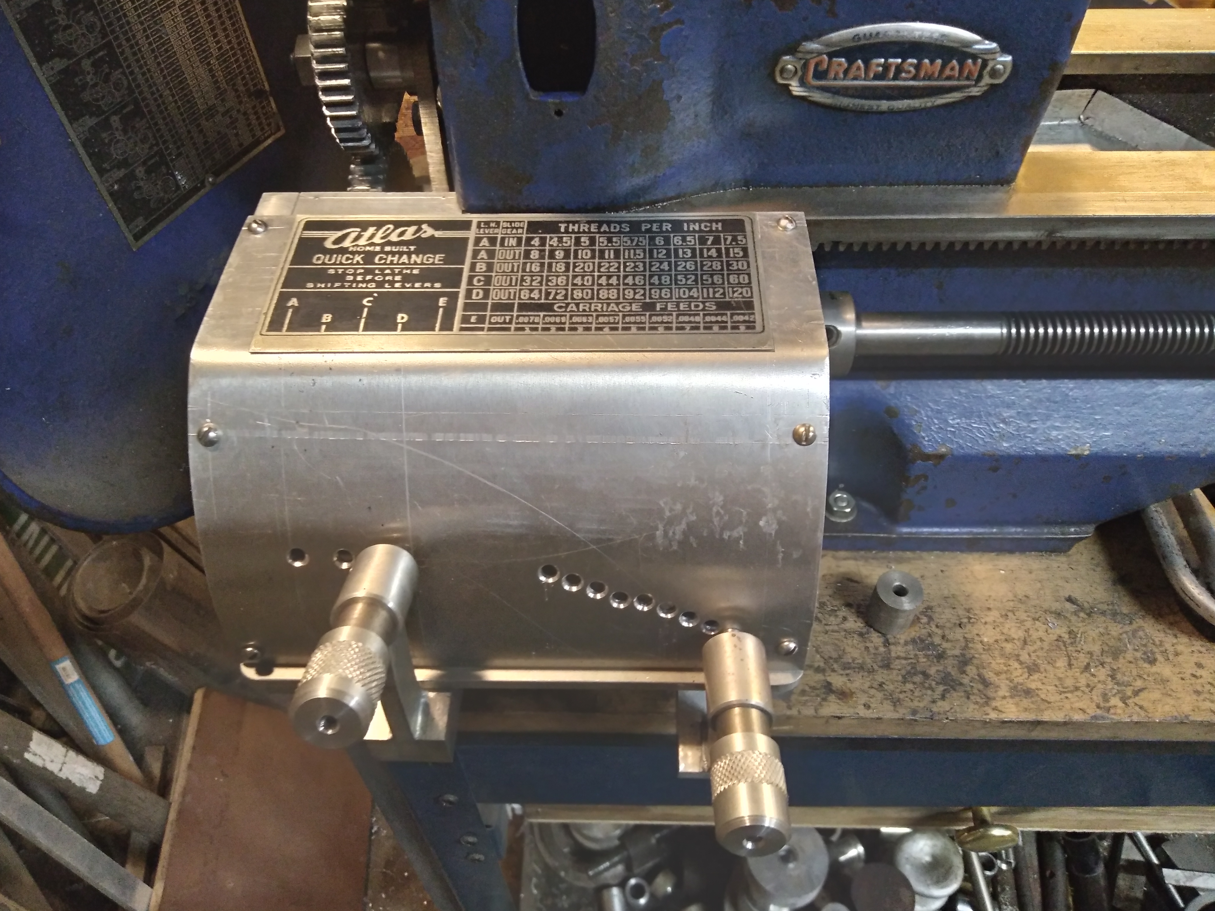

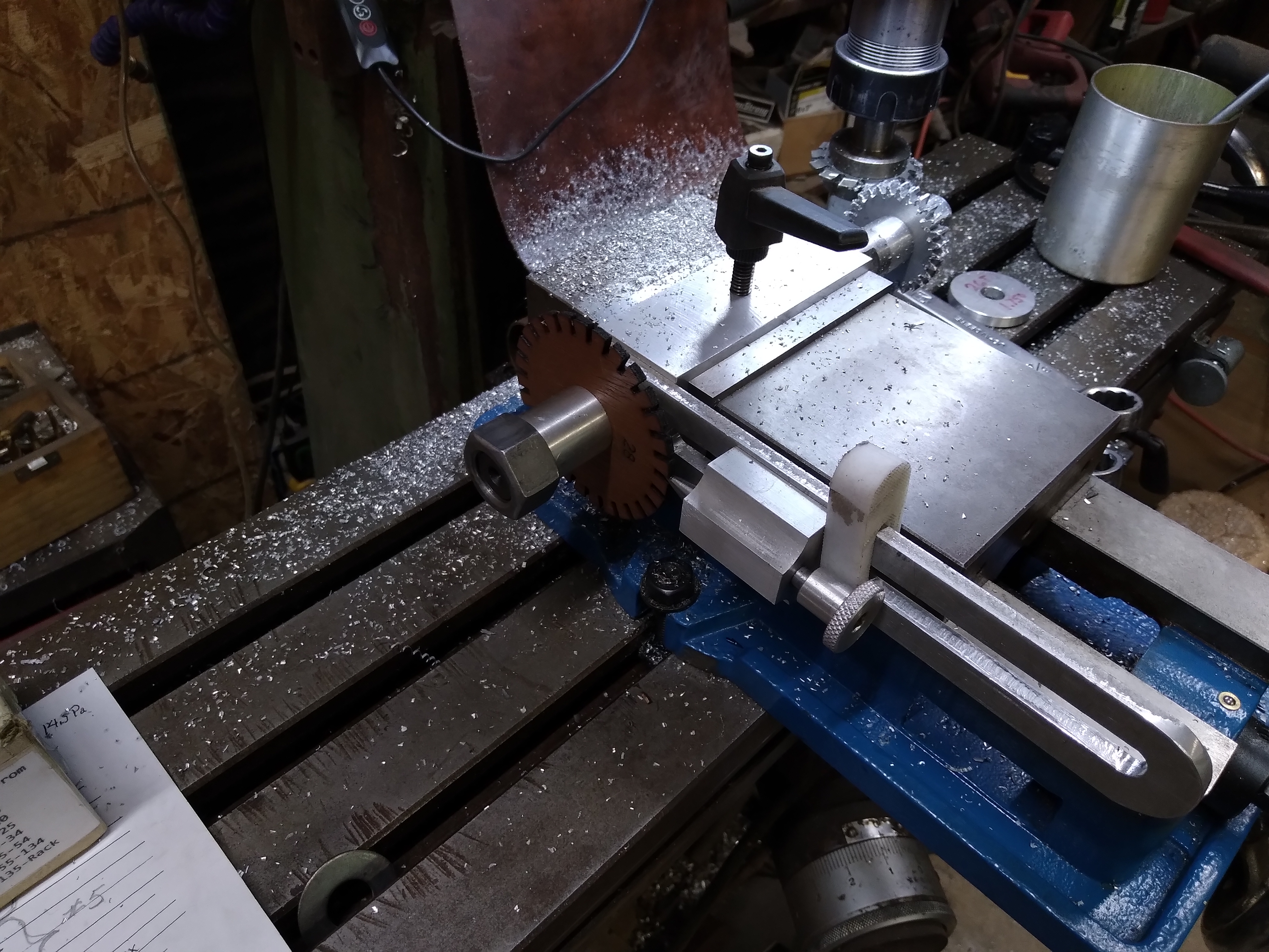

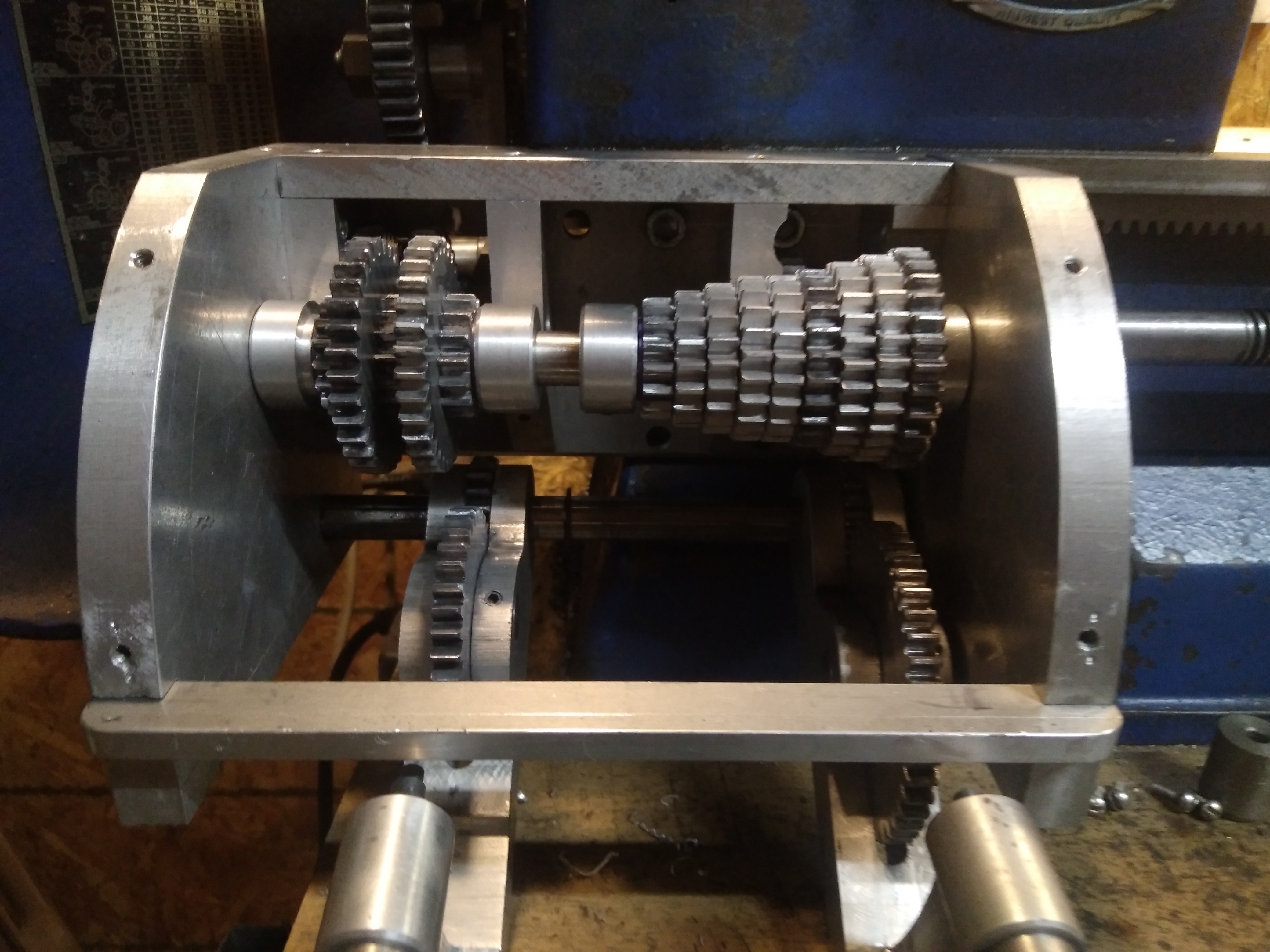

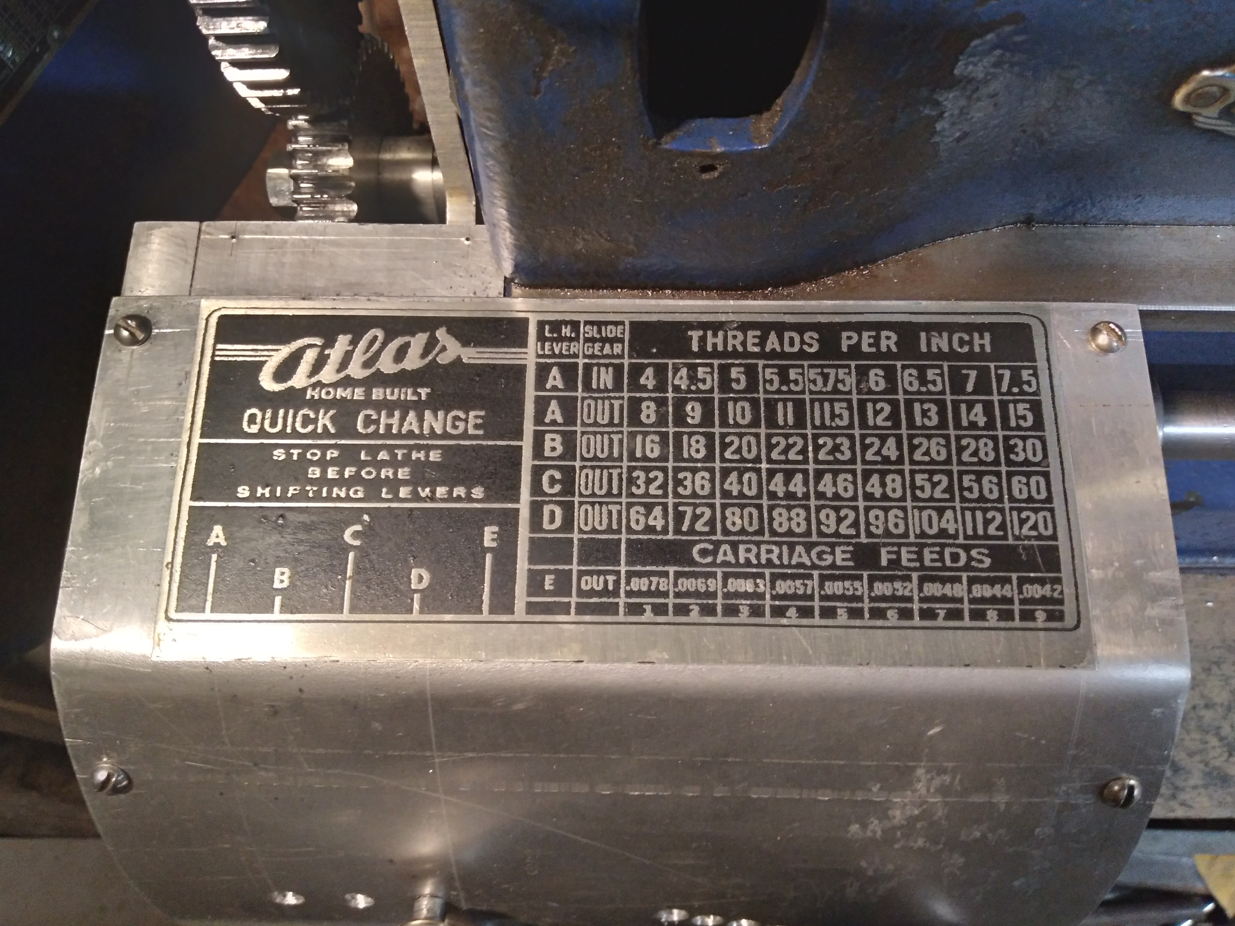

    A set of plans, a week or so and I can say it was worth it!
    Of course I had to make a direct indexer to make the gears before I could get started and laser cut some index wheels. Then I had to modify the plans to use on a 12" lathe, but once I got started it was smooth going!
    It's so nice not having to mess with the change gears and fast too!
    Wish I had done this years ago!Attachment 46150Atlas/Craftsman lathe quick change-20230831_150602.jpgAtlas/Craftsman lathe quick change-20230831_150622.jpgAttachment 46153Atlas/Craftsman lathe quick change-20230831_150946.jpgAtlas/Craftsman lathe quick change-20230730_102519.jpgAtlas/Craftsman lathe quick change-20230730_093017.jpgAtlas/Craftsman lathe quick change-20230730_092904.jpg
