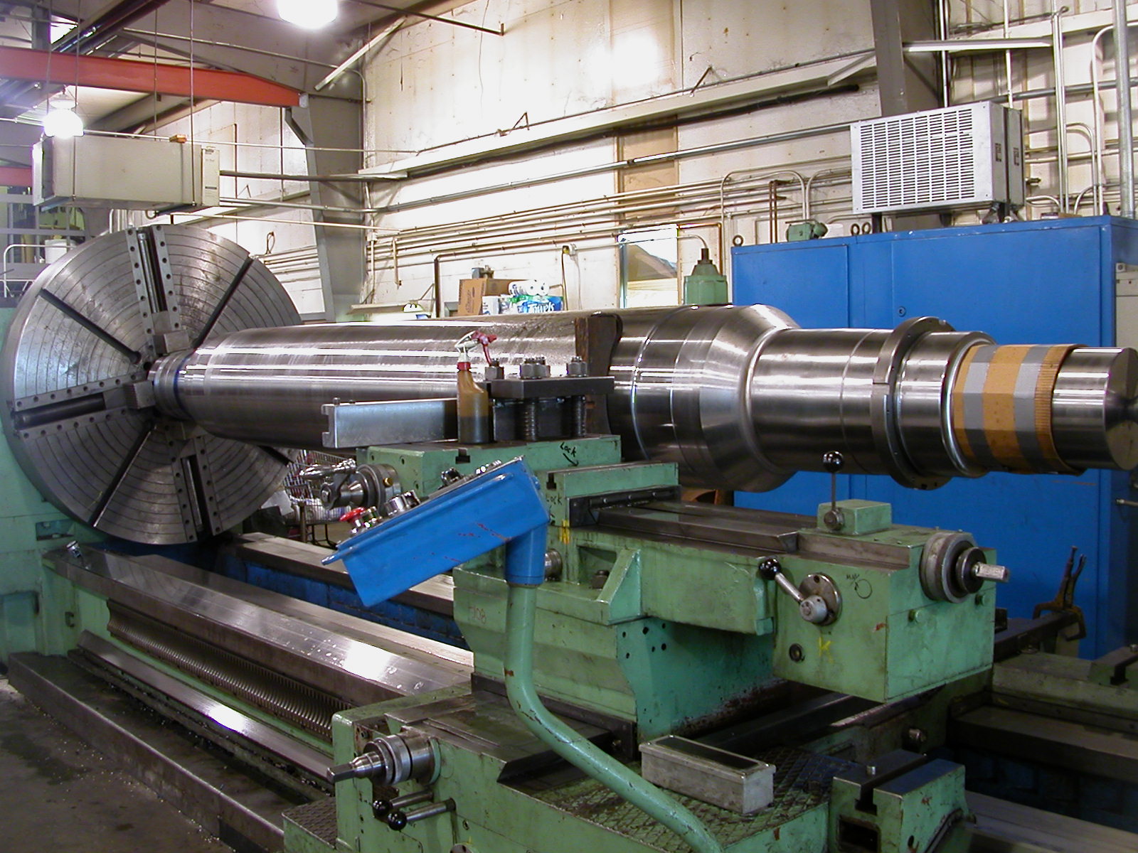

    That big lathe looks a lot like the Poreba I used to run once in awhile. Ours wasn't a tracer, but it had a 60 inch chuck and was 40 feet between centers, with 2 saddles. High-quality black-and-white photographs of large old machines and tools-dscn4465.jpg
