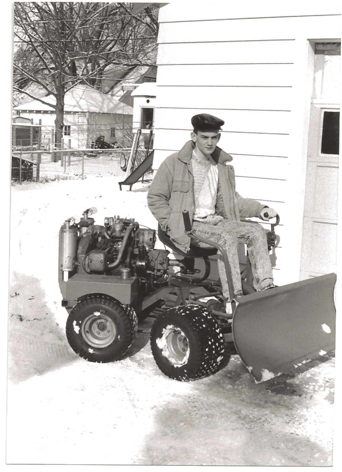

    I built this 4x4 articulated tractor about 30 years ago using 2 narrowed Cushman Truckster axles, a Cushman 2-cyl engine with a modified Sundstrand hydro mounted to it. Used a power steering cylinder from a '69 Mustang to steer it. Right hand control was via a "joystick" for variable FWD/REV & steer left/right. It had a twist throttle on it and as a safety feature; there was a button on top that one needed to push down to allow going into reverse.
    Left hand was a similar arrangement for the blade control; up/down, left/right. Blade had a stiff spring-biased link that allowed the blade to fold under should it hit a solid object, then it snapped back when backed off.
    Unfortunately, I don't have any videos of it. But it sure worked great for clearing our driveway which was quite long.
    In the "off season" I remember giving our young daughter rides around our rather small front yard. She really liked it.
    This is our eldest son on it.....

    Great looking build!!! Do you still have the tractor?

    Quote Originally Posted by wayneb View Post
    no, I “sold” it to a friend with the stipulation that if he in turn sold it, I was to get half.
    Never heard from the (ex) friend after.
    kinda regret it now, but nothing can be done about it, he's incommunicado.

    This looks like a useful and beautiful old tractor, especially with the Cushman Truckster axles and the '69 Mustang steering cylinder.
