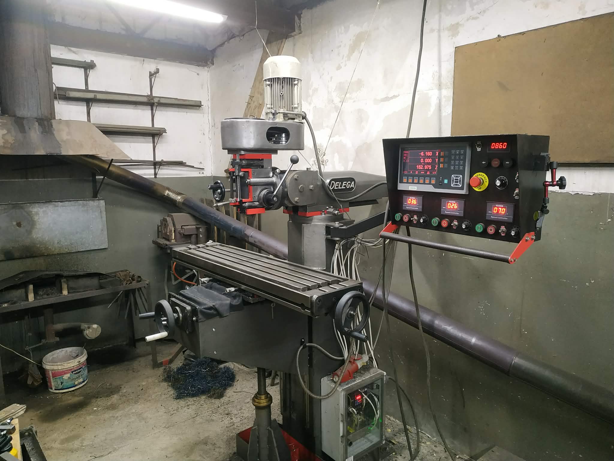

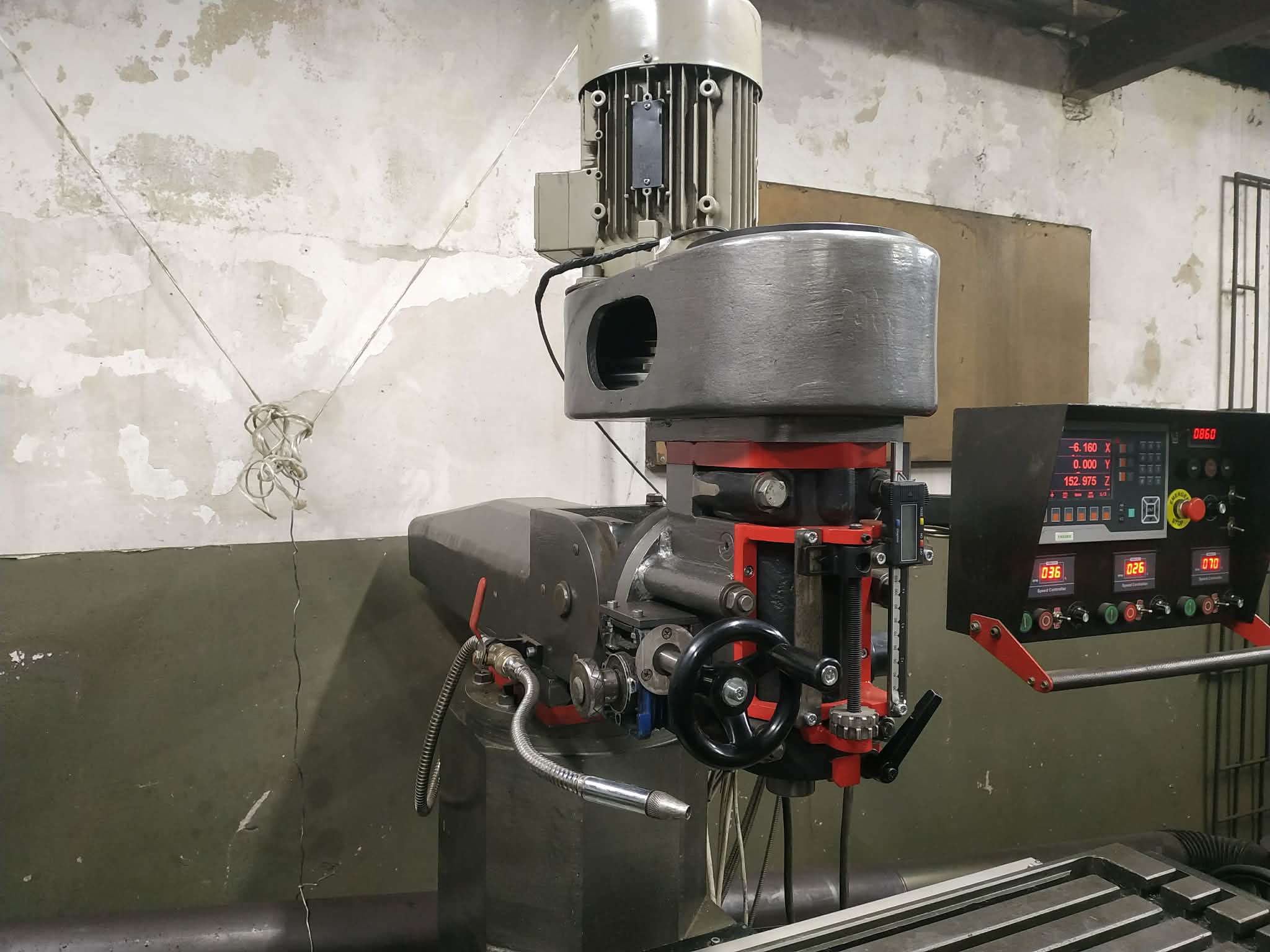

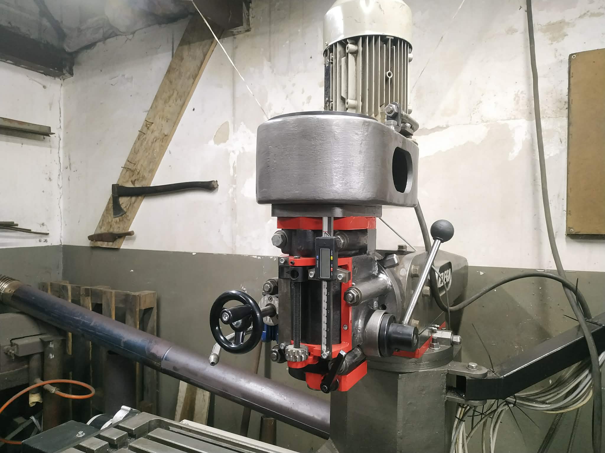

    Hello!
    I finally managed to finish build of new improved head for my milling machine. Let's say it's third version but second one existed only as 3d model.
    Quill, motor, pulleys, fine feed worm gearbox are from old head. Still needs some tweaks before recording test and publishing built video.
    Hopefully I will change current mt3 spindle shaft to custom made iso30 taper spindle shaft and then install power drawbar.

    Quote Originally Posted by SteelCraft View Post
    Hello!
    The spindle change is a good move. I always wondered why you didn't pick R8 or iso30 instead of MT3.
    There is a contributor on this forum "ThreadExpress" who did a very interesting comparison of R8 and iso30. He may have included a MT3 but I do not remember exactly.
    MT3 spindle was dirt cheap on aliexpress, literally 50 USD. Back then I didn't know if whole machine will even work as mill and plan B was fancy drill press - that's all.
