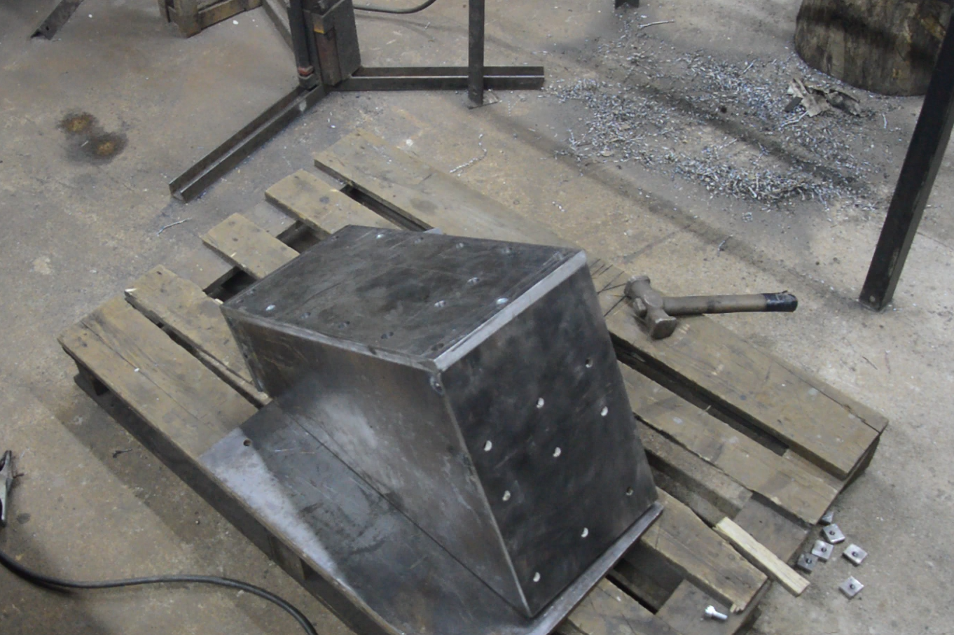

    Next part, almost without welding
    This time I did some actual milling with my milling head.

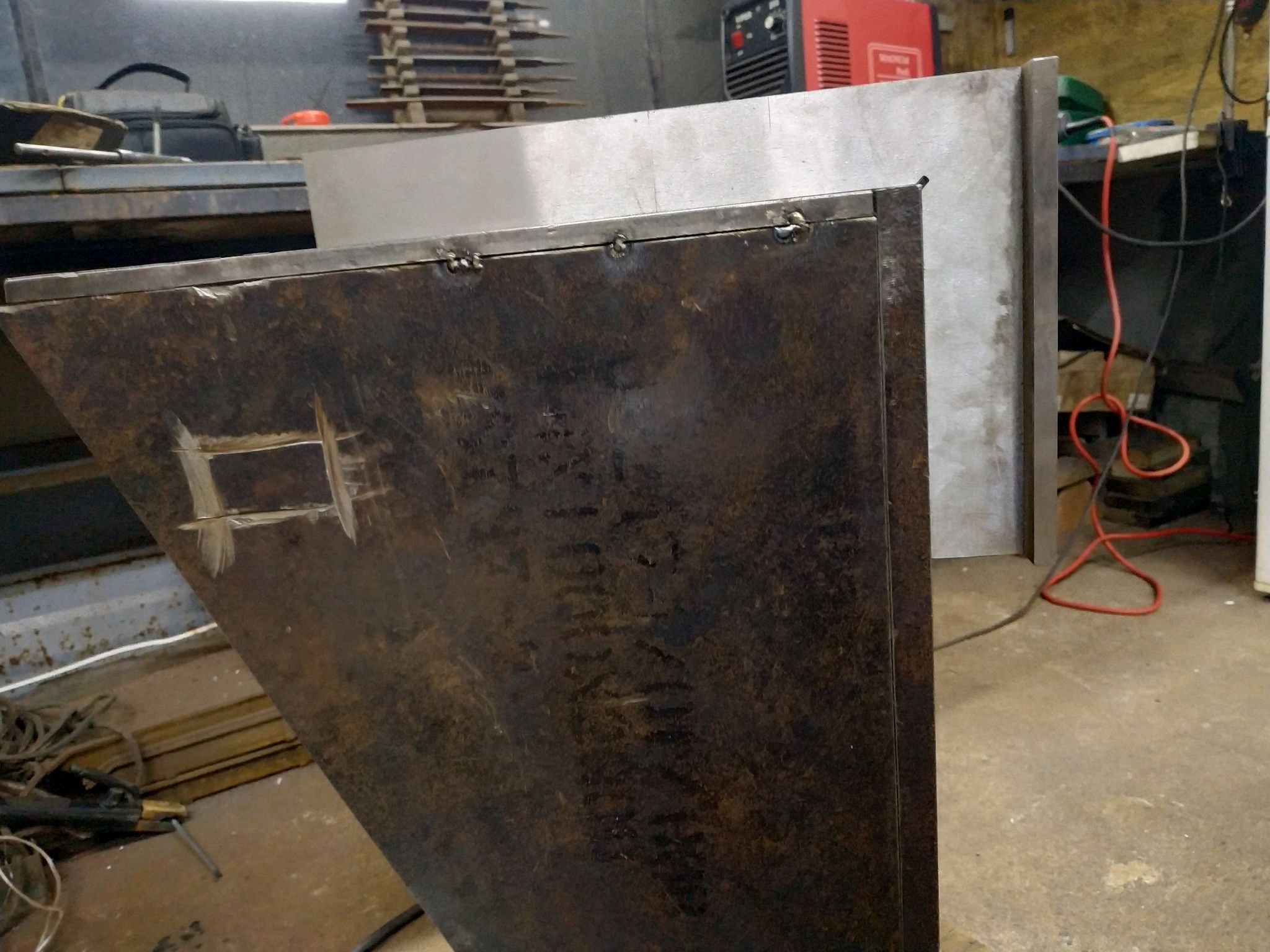

    UPDATE
    I found nice both side milled 20mm steel plate on junk yard (probably part of some woodworking machine). It was perfect part for the knee of my machine because I had very good reference surface to check squarness.

    Well this will get you moving toward a functioning milling machine. The steel can be expensive, even at scrap prices. It's expensive here in Canada.

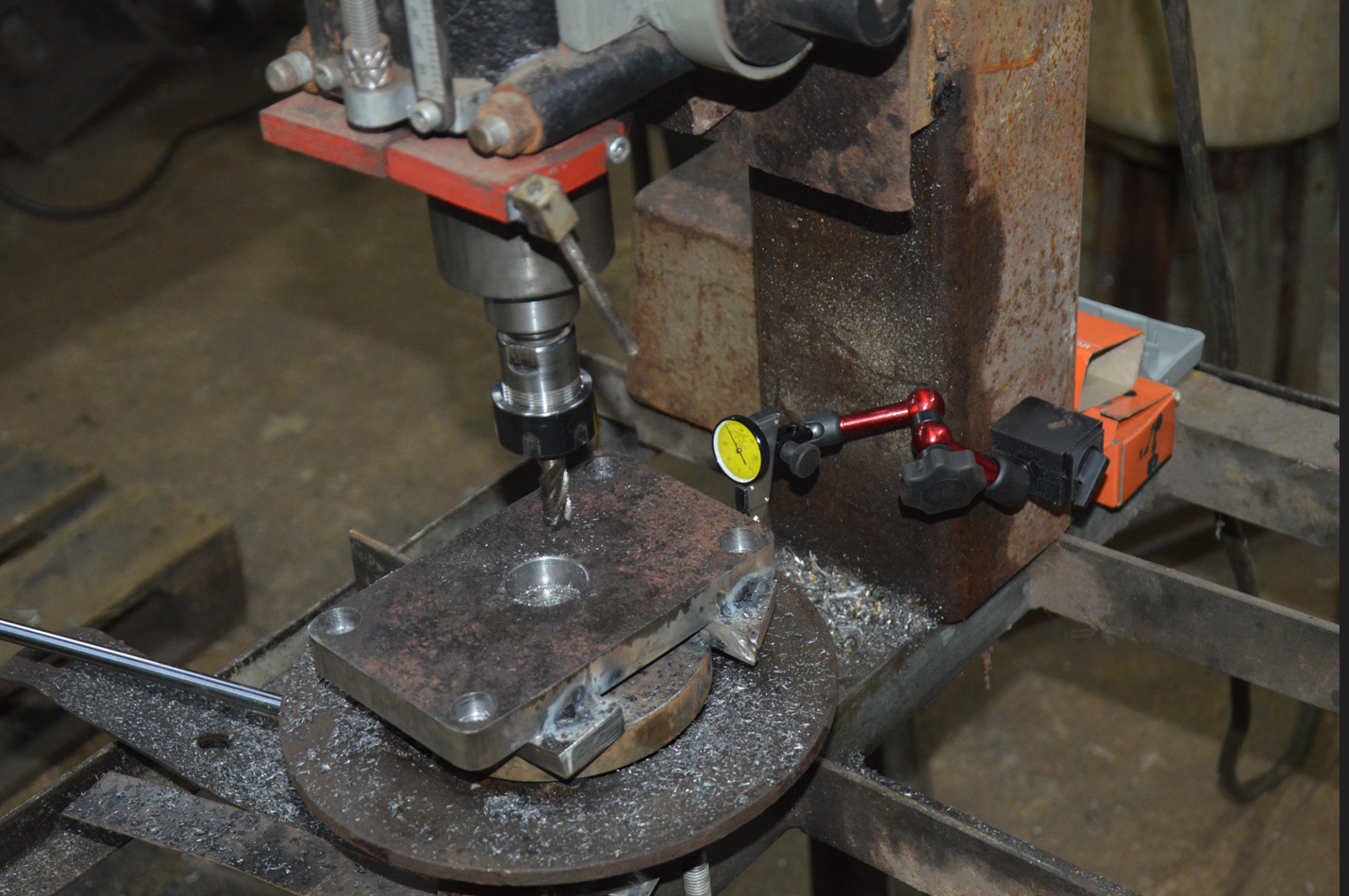

    Today I made bearing block for Y axis leadscrew. This set up is not very rigid but I'm impressed with surface finish I achieved.

    That hole looks very good !
