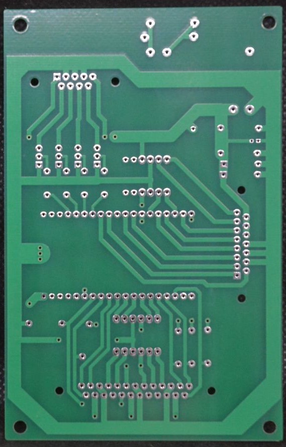

    You do not actually need any electronics knowledge to build this. Just some manual soldering skills is enough. I did have some boards made. Before getting any made I did say that I would add on to the order any that were ordered before the order went. I had only a few takers. Since then I have had quite a few others who have indicated a desire to make a similar conversion so I may get some more done. First I need to produce a document explaining things so that I can say "here are the instructions, here is the BOM and here is a PCB, you are on your own now. Maybe you should all start a self support forum" Finding the time to do that is proving difficult. I have no secrets and I am happy to share anything that I do with others, but I just do not seem to have any spare time to prepare stuff to a stage suitable for others to follow. Only this past week I realised that I need a dynamic balancing machine, not a large project but that is on top of a dozen others. I generally work without drawings for mechanical stuff and without schematics for electronic stuff. In the case of the lathe conversion the PCB is the schematic in effect.
    More on my lathe conversion-pcbfront.jpg More on my lathe conversion-realthingrear.jpg Click for full size
    Front and back of the PCB. Constructing it requires no electronics knowledge, just place components and solder. These are the only boards that I have had made professionally. Although I have made my own since the early 1980s. It was all manual wiring from the 50s to the 80s but now things have got much simpler with the advent of micro based circuits. Far less electronics knowledge is needed today in order to make very capable devices.

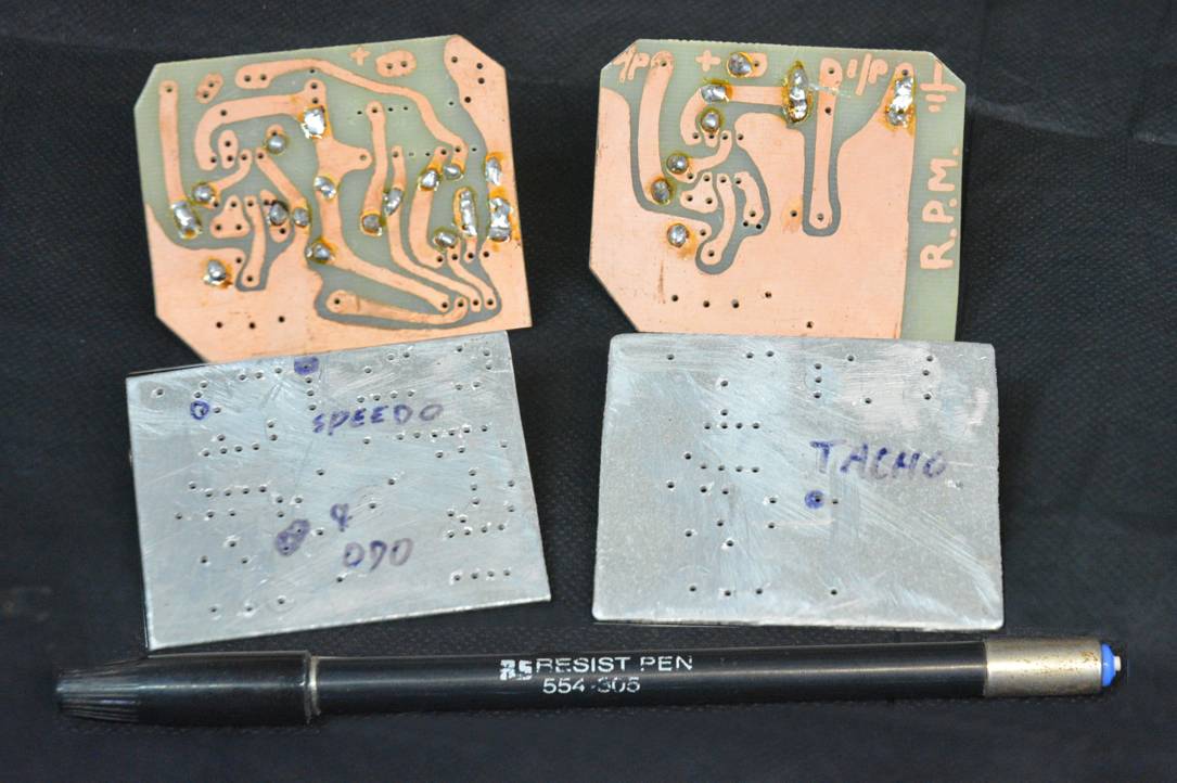

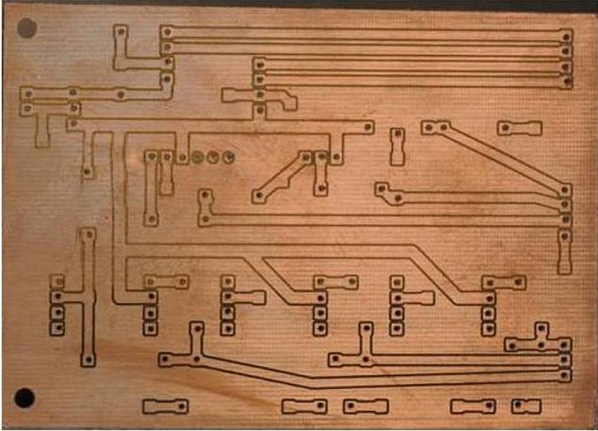

    More on my lathe conversion-80s_pcbs.jpg More on my lathe conversion-blankboard2.jpg Evolution.
    Left: 1980s, manually drawn with ink resist pen. The aluminium pieces are drill jigs. Right: 21st century, CNC isolation milling.

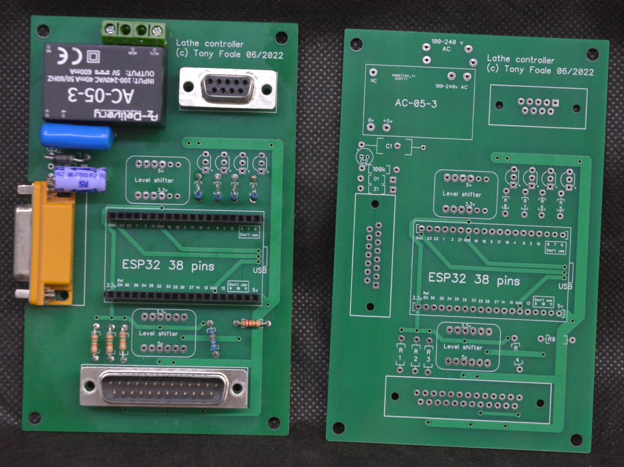

    2025 UPDATE.
    The PCB described above worked flawlessly but about two years after fitting it I made some more modifications to the lathe to be able to use it as a cam grinder. I saw that with some small changes to the PCB design it could be used for both normal lathe work and the cam grinding. I only had to run different firmware on the ESP32. So it was back to JLCPCB to get some more boards made, but this time I was not in a rush and selected the slow shipping option which was much cheaper. The PCBs are very cheap but shipping is not.
    As I needed a new PCB design I took the opportunity to use opto-couplers to isolate all the external inputs, these replaced the level shifter that I previously used and give more flexibility over the type of inputs that can be used.
    To make the change over easy I have two ESP32 breakout boards, one programmed for the lathe and the other for the grinder. So it is quick and easy to swap the controller logic between different tasks. The first PCB design was purely a lathe control only, I designed the replacement as a general purpose two axes controller and I have a new very different project coming along and the latest PCB design will be suitable for that also, with different firmware loaded.
    Following are pix of the original PCB (left) and the latest (right).
    More on my lathe conversion-pcb-stuff.jpg More on my lathe conversion-newboard.jpg
