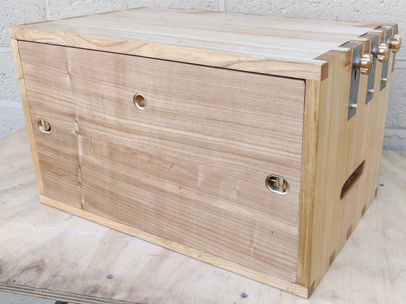

    Travel Tool Chest & Workbench with Integrated Vice
    This is a combined tool chest and workbench. It is made out of Sweet Chestnut and American Black Walnut (along with a lot of brass and stainless steel). All of the woodwork was done with hand tools (except for a few instances of resawing with a bandsaw). All the metalwork was done with power tools (because hand tool metalworking is just silly!).
    I did this project mainly as a means of practising hand tool woodwork. However, it's also intended as a means to take my hobby on holiday. My other half has M.E. and often needs time to rest. I'd go spare if I just sat around reading a book while she rested, so being able to take a basic (ish) woodworking kit with me keeps me amused and sane!

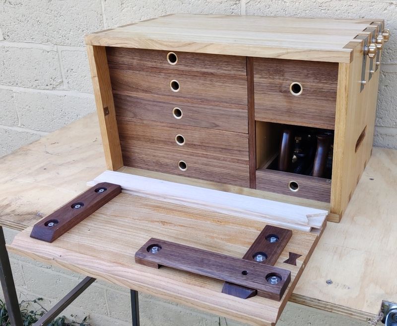

    This is what it looks like with the front opened. The drawers hold the various tools I would need for making simple wooden boxes and suchlike. The front of the box doubles as a shooting board for shooting square edges or mitres.

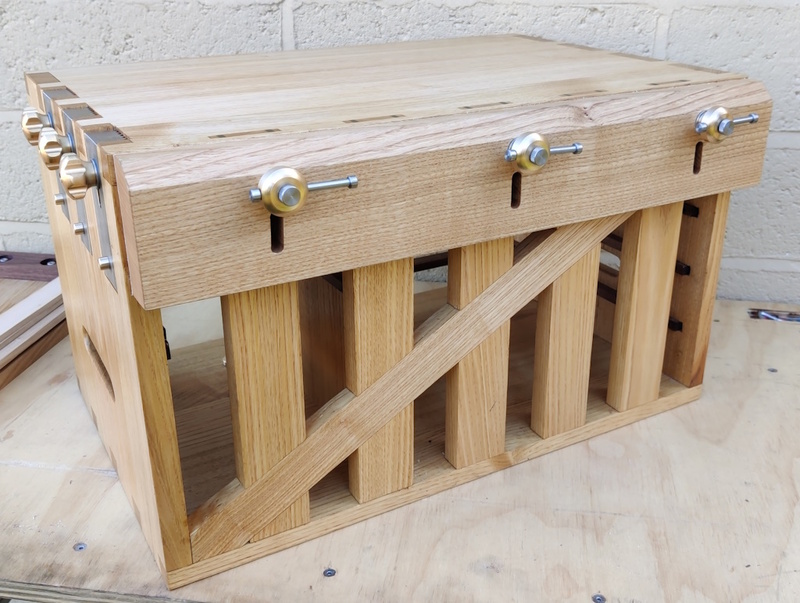

    Travel Tool Chest & Workbench with Integrated Vice-rear_view_showing_vice_800.jpg
    This photo shows the back of the chest and the vice (which has a leather jaw). The uprights give a firm surface to clamp against while (hopefully) allowing for wood movement by having narrow slats rather than a solid back. The diagonal piece is there to stop racking when planing on the top surface of the chest.

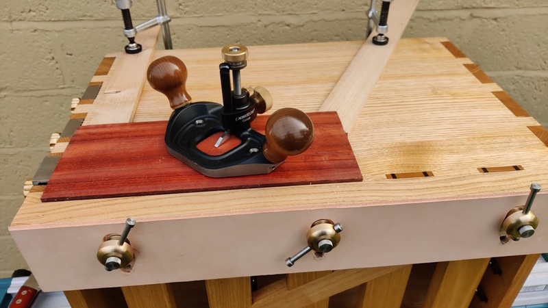

    Travel Tool Chest & Workbench with Integrated Vice-planing_with_does_foot_800.jpg
    This photo shows the planing stops in use for planing the top surface of a board.

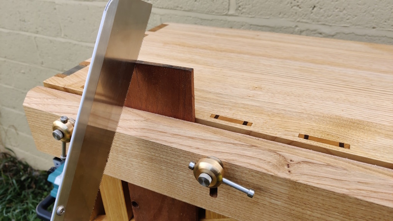

    Travel Tool Chest & Workbench with Integrated Vice-sawing_vertically_800.jpg
    The vice holds boards rigidly for sawing (or planing on the edges or ends).

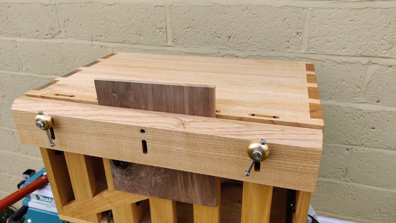

    Travel Tool Chest & Workbench with Integrated Vice-access_to_whole_top_surface_800.jpg
    The vice can also be flipped round so the leather jaw is facing outwards and the vice screws go into slotted holes. It can then be raised, providing a stop, so boards can be fully constrained while giving access to the complete top surface.

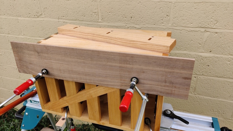

    The vice jaw can also be completely removed and big boards clamped to the back (they can also be clamped to the top, obviously).

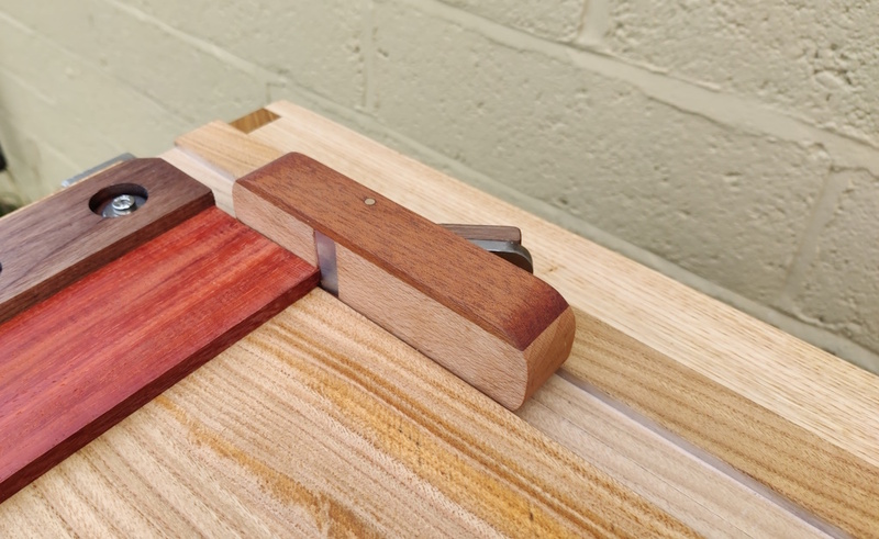

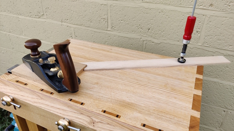

    This photo shows the shooting board in use for shooting an end square (with home-made block plane).

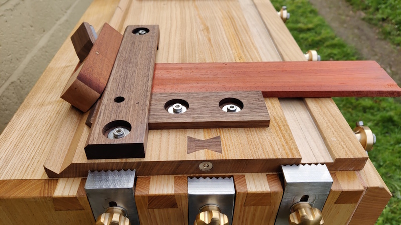

    The shooting board gets turned round for shooting mitres.
