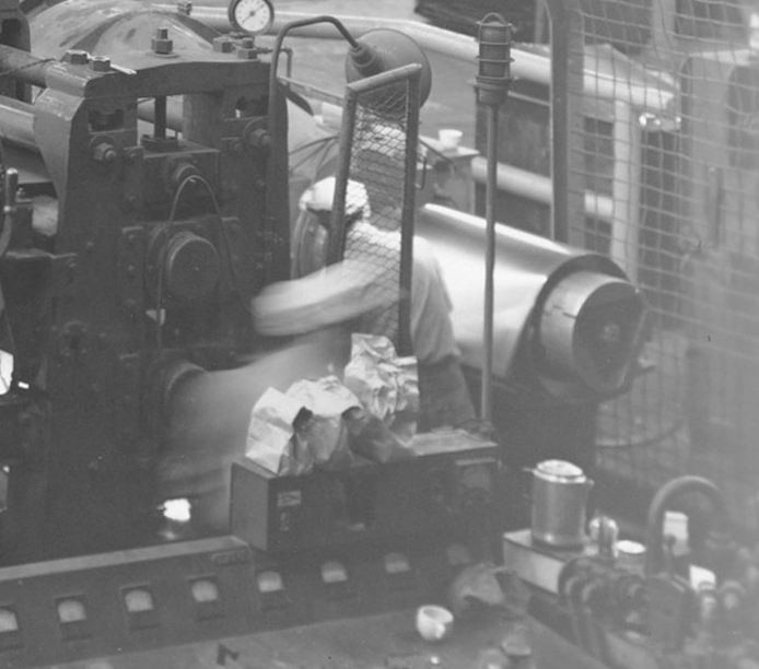

    I am curious what this guy is doing. He was moving during the shot, but there appears to be a guard in the way.
    It also looks like he is close to the "break station" with a hot plate, coffee pot, a cup and some paper bags for ... donuts?

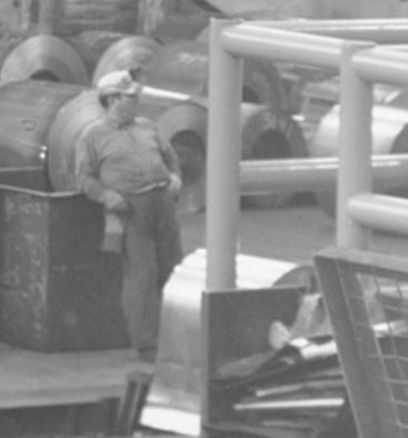

    Coil preparation line
    This fellow does not seem to have much interest in anything.
