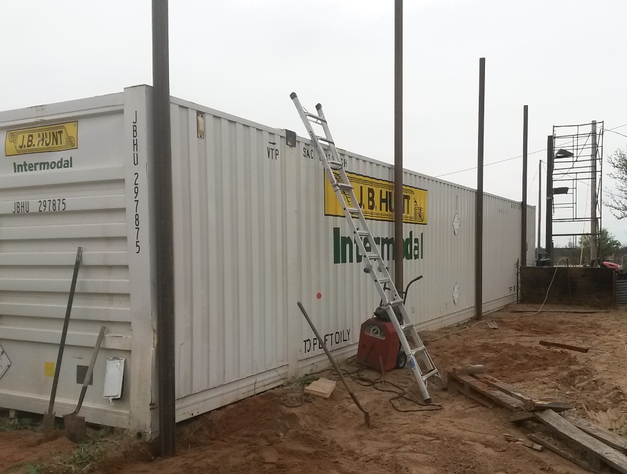

    For the past several years life has always got in the way of my starting my shop so today I decided to at least take the first step.
    So since life on a farm always has more things that need doing than can get done I finally decided that if I just get 1 column standing I will be able to say that I am starting on my shop. So today this happened
    Of course first I had to pull some stumps that had been nagging me for a long time then remove a tree from a fence and remove the fence but those were not going to stop me from my goal. I removed a tire from an old 24.5" truck rim then welded it to the bottom of a 7" sch 80 pipe. the pipe was not long enough to suit me since it was only 12 ft long I welded a 10 ft section to it then dug the hole with my backhoe . I went down 6 feet deep before I struck hard pan. now my column is not long enough again I wanted 18 ft walls. I added another 4 ft to the pipe. then hefted it into the ground with my backhoe

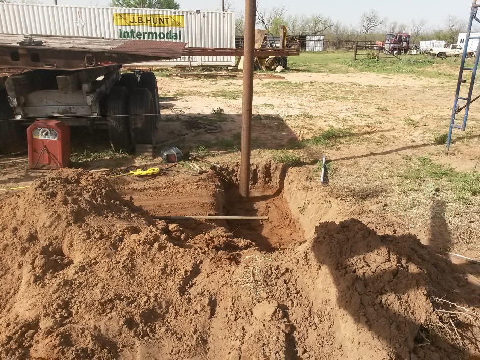

    I am not cementing these columns in the ground I prefer to have a large base on them then back fill with dirt & clay tossing in a bag of portland every few layers adding water and tamping
    Tomorrow I will try to get my whacker packer running It should run just fine since it only has about 30 minutes of run time since brand new. but I've had it for several years I hope I drained the gas out.

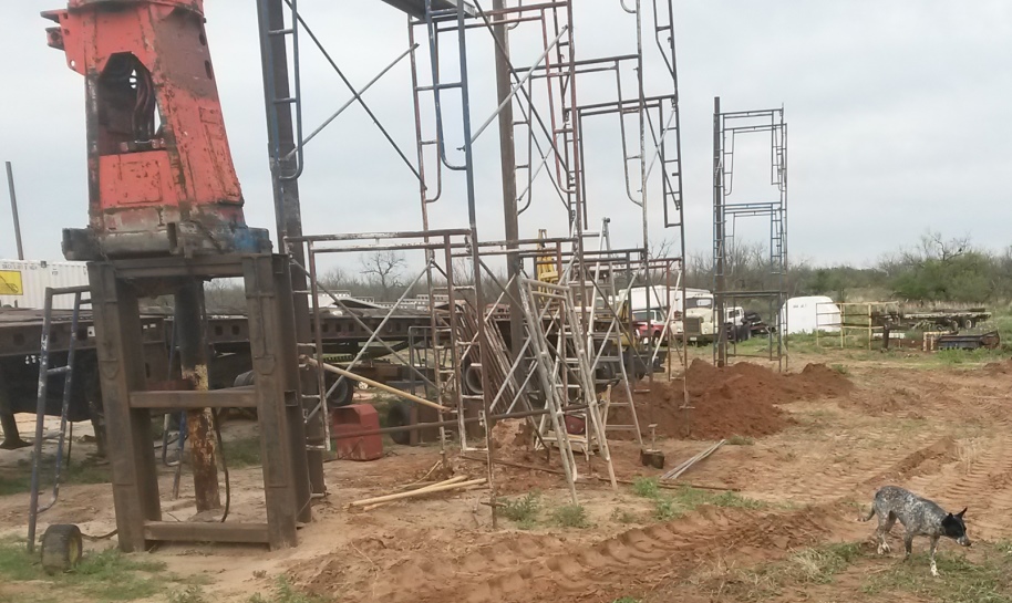

    Once I set up my scaffolding (I have enough to set up an 18 ft high run about 60 feet long so working from a ladder is never in my job description) I will fill each column with sand dirt gravel and used motor oil I have a concrete vibrator that I will strap to the columns to pack the dirt and oil inside of the columns.
    There are a couple reasons for my doing this 1 is it makes them infinitely stiffer 2 it prevents them from ever rusting out from the inside and 3 it deadens any sound transmittal should I decide to add things to them like a thick plate for hammering on or mounting a bench grinder on. also by being stiffer if I weld a pull ring to them they won't have a tendency to bow, they wouldn't anyway since so much else will be welded to them in the form of building materials and bracing.

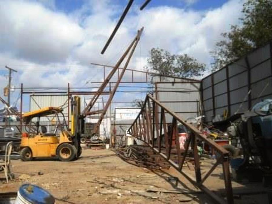

    I have all 5 trusses completed the 3 center trusses are doubled for the possible later addition of a light weight bridge crane the West end truss will be stiffened by x bracing Tabernacle style to truss #2 and will have a I beams welded to the bottom of it for a tri fold rolling door set to allow access to the whole west end of the building depending on which way the doors are rolled, Haven't decided about the East end yet I may opt to only have a 30ft single rolling door or a pair of 15 foot doors to give a 30 ft opening. I may add an 8ft wide 53 ft long mezzanine attached to the top of the container then build a 12 by 40 ft office on top. Or just place my school bus on top and make my office out of it but still add the mezzanine.

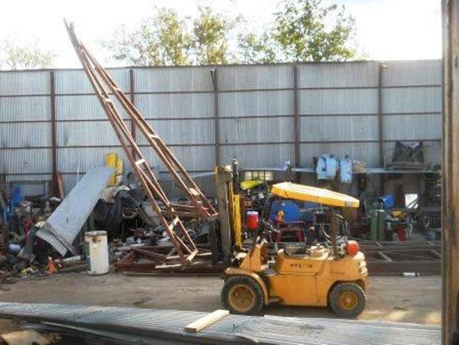

    3 days of climbing scaffolding dozens of times, hanging off the rungs of the scaffolding while welding is just about to get old for this old man. However I can see the light in the tunnel growing nearer with each passing day I think it may the a search light on a UFO or a train but the shop is coming along.
    now have 4 of the 5 trusses in place and some temporary x bracing welded in place just encase things have to go into slow motion for a while I don't want the wind to wreck what I've already done.

    In case anyone is wondering all columns have at a minimum a 24" diameter base welded to them and are from 6 to 8 feet in the ground the holes were dug to penetrate into the blue gray white hard layer below a red clay layer. Since I could not afford to put down concrete footers below each column this became the next best alternative and past experiences show this is often as good if not better than concrete with a few exceptions such as the columns having direct contact with the soil instead of being bolted or welded to a plate secured in the concrete. However these columns are not plain pipe they are oilfield grade tubing designed to be buried 1000's of feet into the earth to last for decades in all types of soil strata I have used the same grades of pipe in construction of both fresh and salt water piers they may eventually rot or rust through but not in my children's and possibly my grand children's life times.AT 64 and half years old if it lasts for 30 years I'll be happy.
