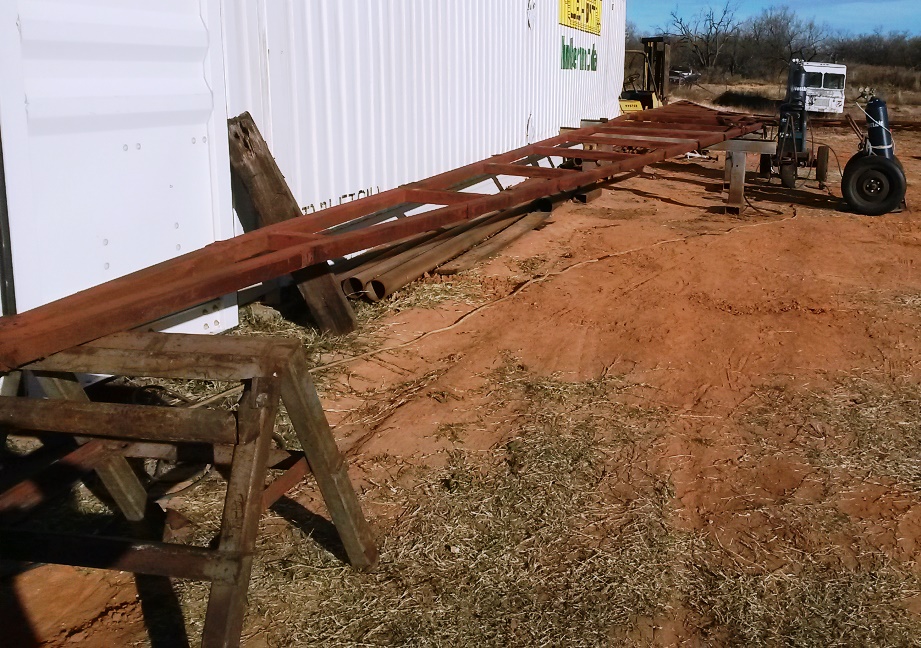

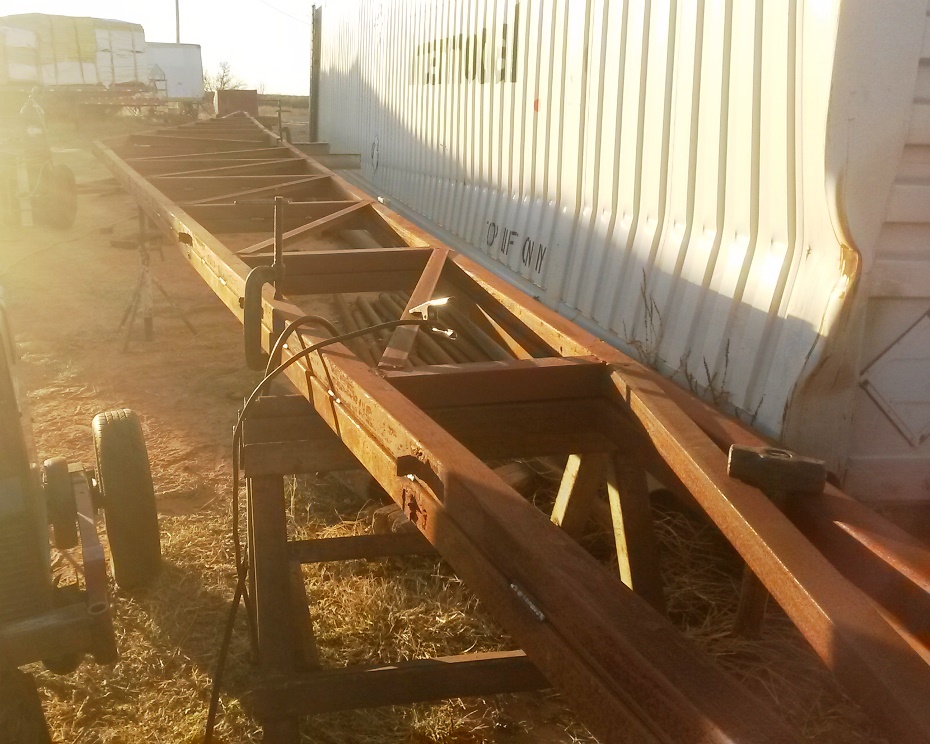

    Got started making my trusses out of the salvaged trusses I have had for 5 years
    Piecing them back together and doubling them while I am at it. since the old building was 120 ft and mine will only be 60 ft I have enough to make the amount of trusses I need
    Doubling them will make them almost 3 times stronger than they were before since I am adding more bracing and once installed there will be horizontal and diagonal bracing from truss to truss. plus I won't have a 70 ft span my span will be more like 60 ft much less by the time I add in corner bracing from the columns to the trusses the span will be reduced another 6 to 8 feet.
    About half completed
    Probably no work tomorrow , Life it going to get in the way have to go look for a new cook stove.

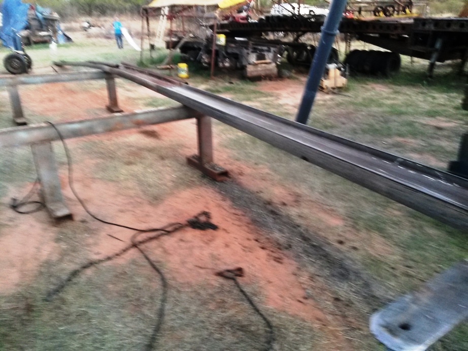

    Two trusses ready 3rd almost half 2 more to go after the one I'm working on now.
    I only hope I'm going to have enough salvaged materials to complete all 5 without having to buy any new stock

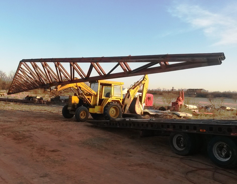

    At the rate I'm going by the time I'm 90 I'll have my shop finished
    I now have most of the trusses made no 2 are exactly the same for reasons which will not be apparent until the building is complete
    this one will be 1 of the center trusses A full double truss that later I will be able to hang a beam on to become 1 rail of a bridge crane
    It is 68 feet long 6 feet high and stiff enough to be carried while laying flat

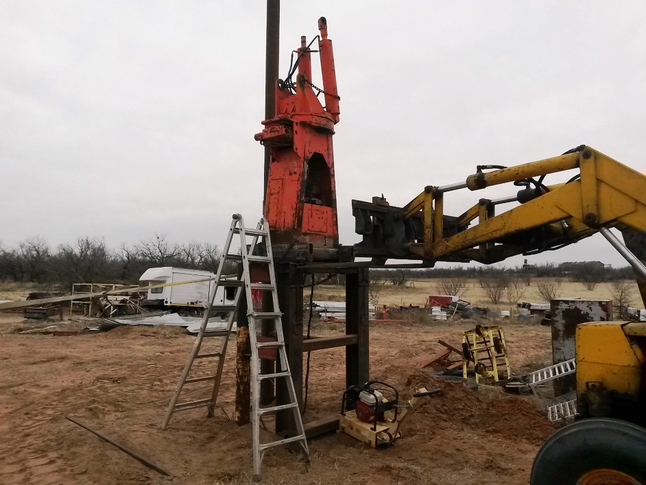

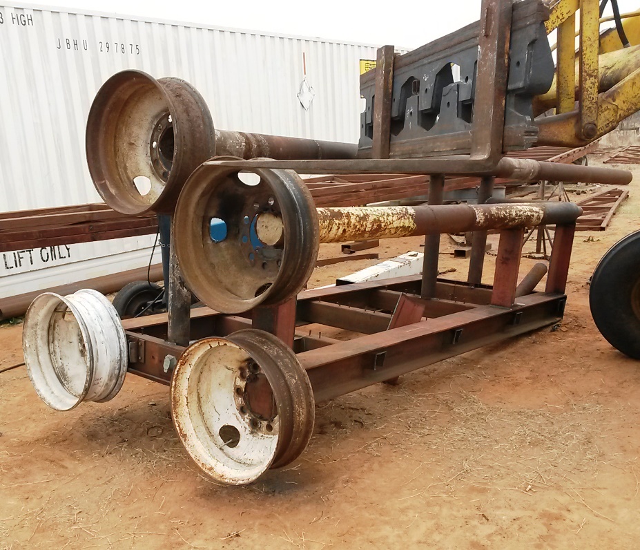

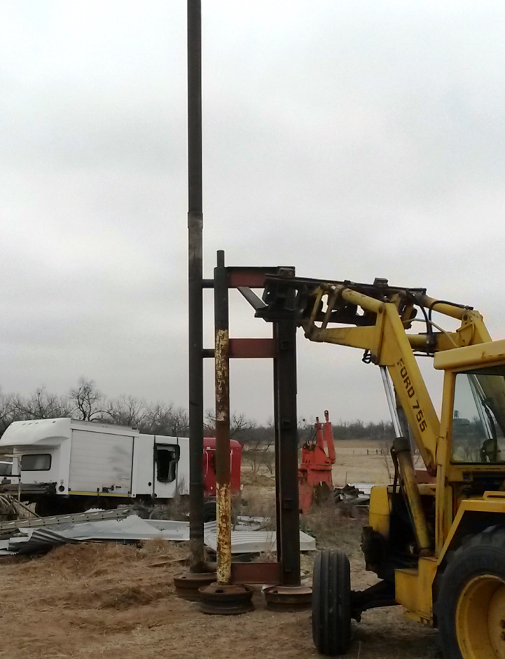

    This is the master corner column I will be mounting a crane on it which will be able to swing from outside to inside the building.
    the crane is an old brick crane removed from 1 of the trailers I rebuilt Instead of sending the crane to scrap I figured I'd use it some day

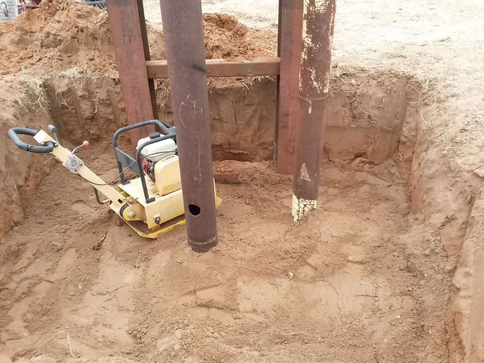

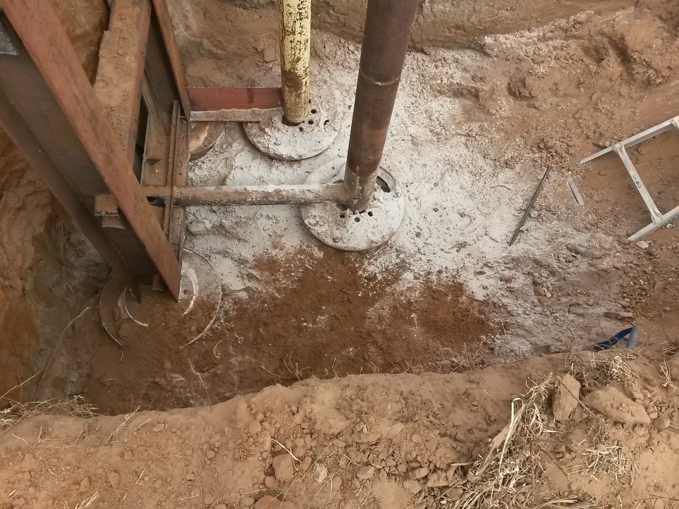

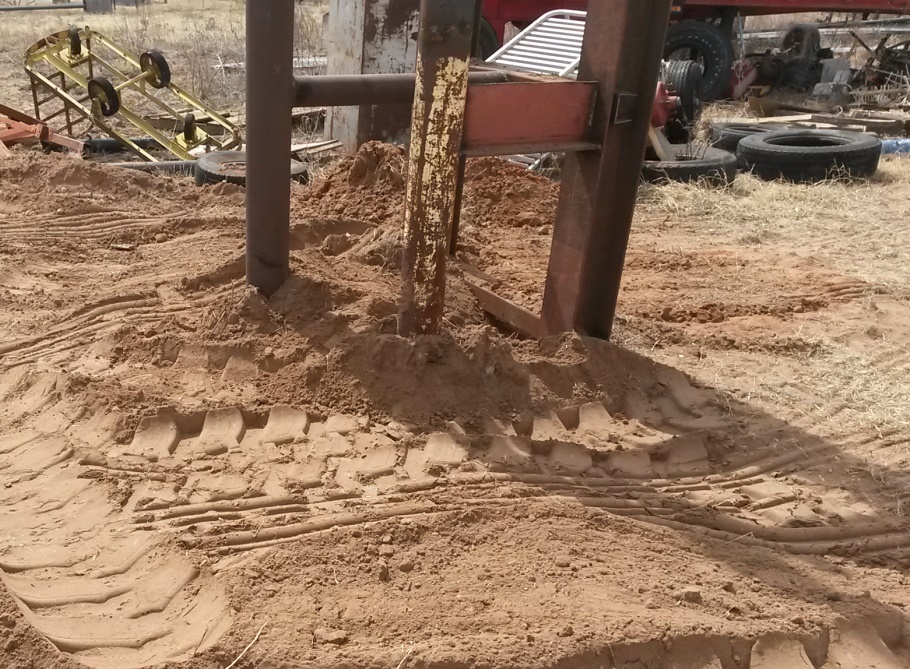

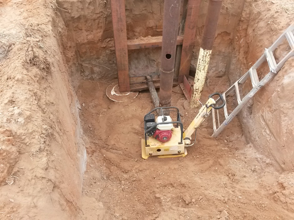

    The hole is almost 8 feet deep here I am filling the cavities in the wheels with a mixture of dry cement and clay the clay is moist so once I have them tamped full the cement will absorb the moisture
    Now begins the filling and tamping clay rock and some cement is used in each 6 inch layer then packed down to 3 or 4 inches
    The final layer is just clay and dirt since eventually when I get ready to pour a concrete floor I may have to remove some of the fill
    Now for the crane pedestal
    Took the first step towards building my shop-20190308_144436.jpgas.jpg.
    The next step will be to establish the 2 remaining corners see you in another 4 months LOL

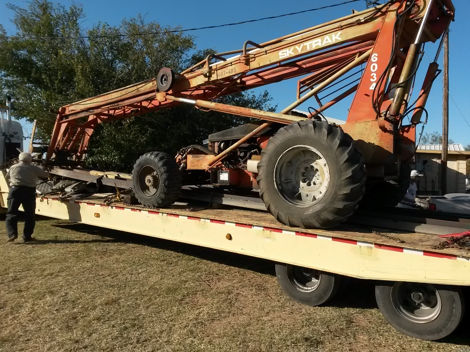

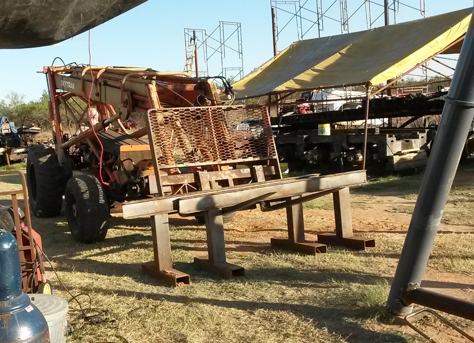

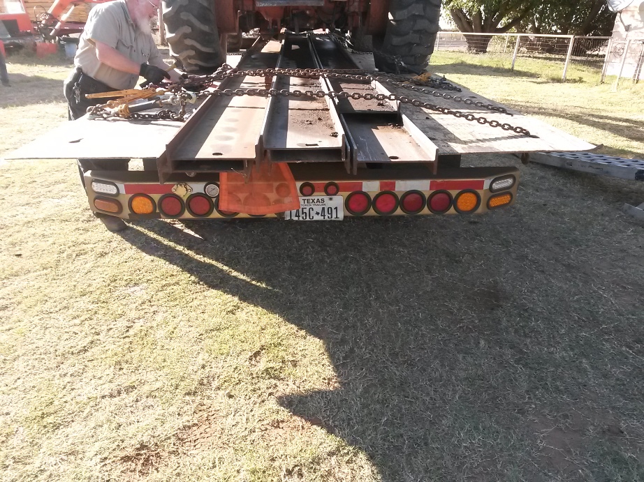

    Today 6 12" I beams 45ft long showed up to be used as the top perimeter of my shop along with a skytrack we call the monster mash when you look at the picture you will understand the name
    welded 2 together then later cut to length
