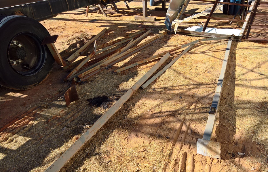

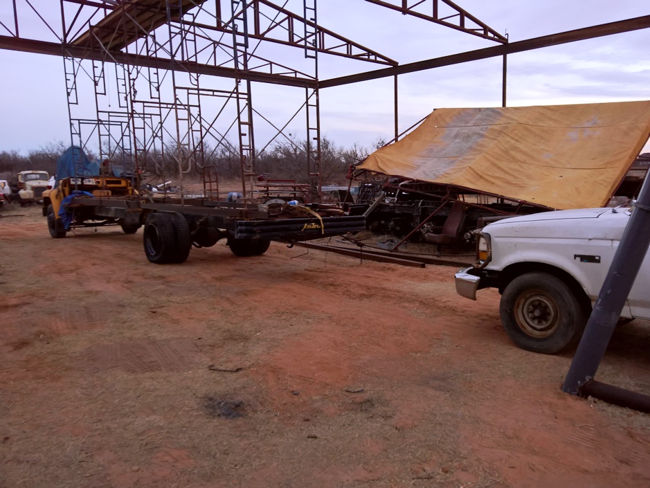

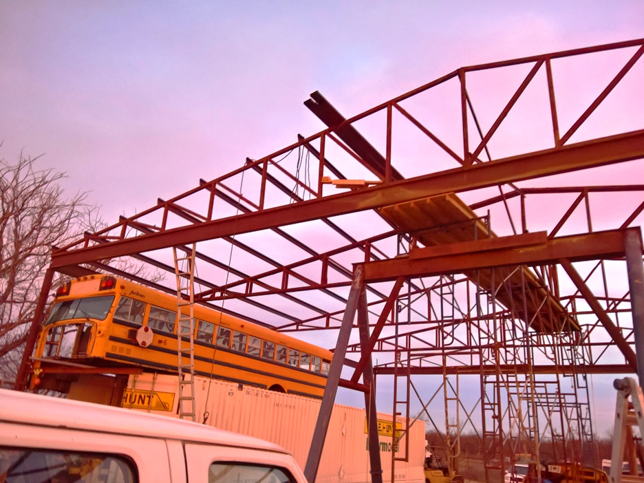

    Even after having to take time to change a tire then go to town get fuel have the tire fixed and a few other go to town things that had to be done.
    I managed to get 4 purlin installed today these area at the highest part of the trusses so my scaffold was more of a its there as a fall stop than anything else since the center of the trusses are over 6 feet from the bottom of them it meant climbing on them and working while standing on the braces or sitting on top of the truss to weld them in place.
    Took the first step towards building my shop-wp_20191226_17_07_00_richcv.jpg
    This puts the to the point of either doing the back half of the same side or moving a lot of stuff to do the other side. Or going ahead and sheeting what I have to give me a 30 ft by 36 ft roof over head. On the one hand having a partial roof would be better than no roof but that means having to change up what I am doing. IT would mean I would have a completed area to put the project that is currently under the tent though and the tent has to come down soon anyway. Heck I have almost knocked it down already.
    But I think I will carry on and install the other 10 purlin on the second half of the side I am working on then sheet the whole half then move everything from the other side and not have to take a step forward while taking 2 backwards.
    The stuff that needs moved is the 3 axle set currently under the tent and the 50 ft trailer that I have on dollies and can only be moved sideways

    Once I finish with the roof these bar joists will be used to make a 30 by 40 lean to on the south side of the building
    Took the first step towards building my shop-wp_20191226_17_14_05_richcv.jpg
    these white standing seam panels will be the roof of the lean to.
    originally the bar joists and the panels were used as a cover for a large RV
    I have almost enough panels to make a 30 ft wide lean to the full length of the building

    Could chassis be moved better from front; a heavy [2 5/16"] trailer ball on forklift or frontloader, lifting front end so wheels aren't contacting ground? Maybe pull tires and weld up a landing gear?
  5. #5
    12,615
    2,677
    Thanked 11,105 Times in 5,388 Posts
    it could providing there was room between where the shop is and where I have my vehicle detention center that I call the dog pound because there are more Mack bull dogs than other critters Also that pencil sharpener is sitting smack in the way of things
    Right now it would be difficult to use the receiver on the fork carriage of the front end loader due to having the gin pole and hoist on it. My duel wheeled fork lift spends more time buried in the ground than rolling it is barely maneuverable around as long as I can remain on the area where I have hardened it up with the select fill clay drive of the edge of where that is and it sinks to the frame. hence the pushing and pulling from the rear
    one helper who could either drive the pickup or could steer the bus while it was moving would have been a big help.
    Jane won't drive the pickup because the size of it and having to push or pull the bus chassis scares her and she surely is not strong enough to steer the bus.

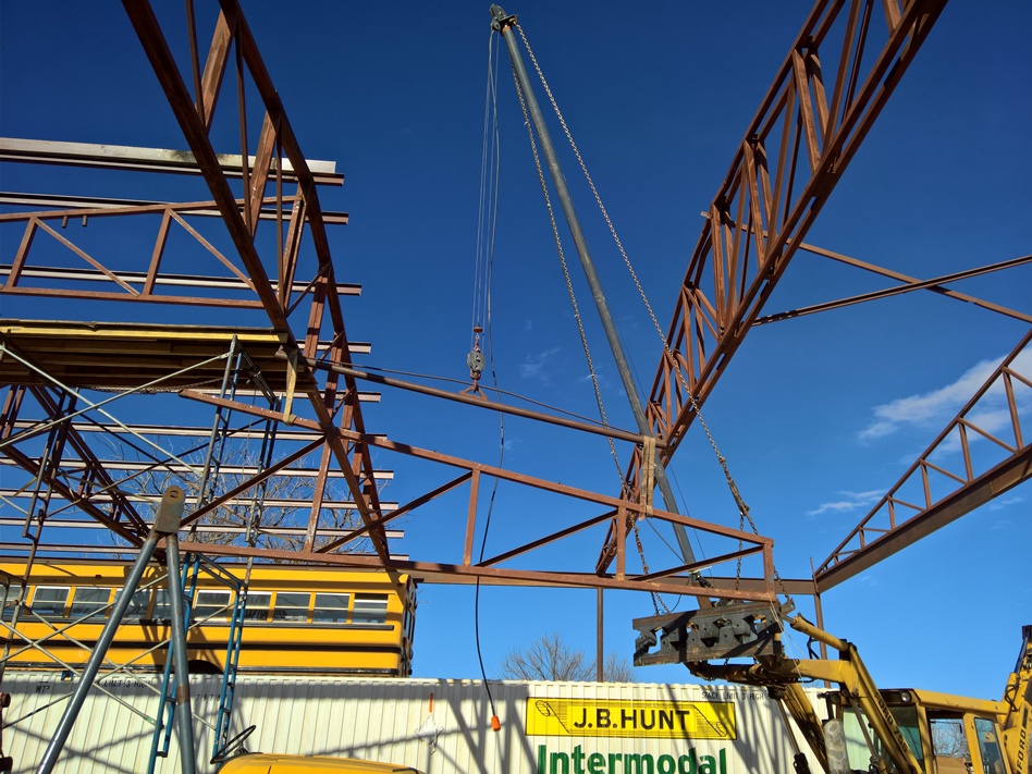

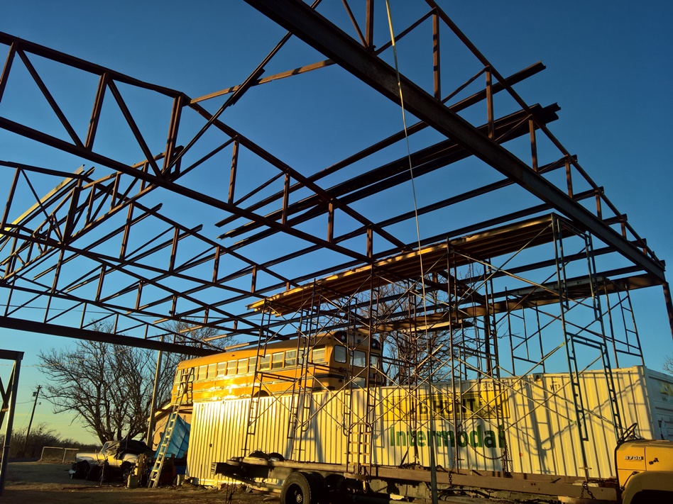

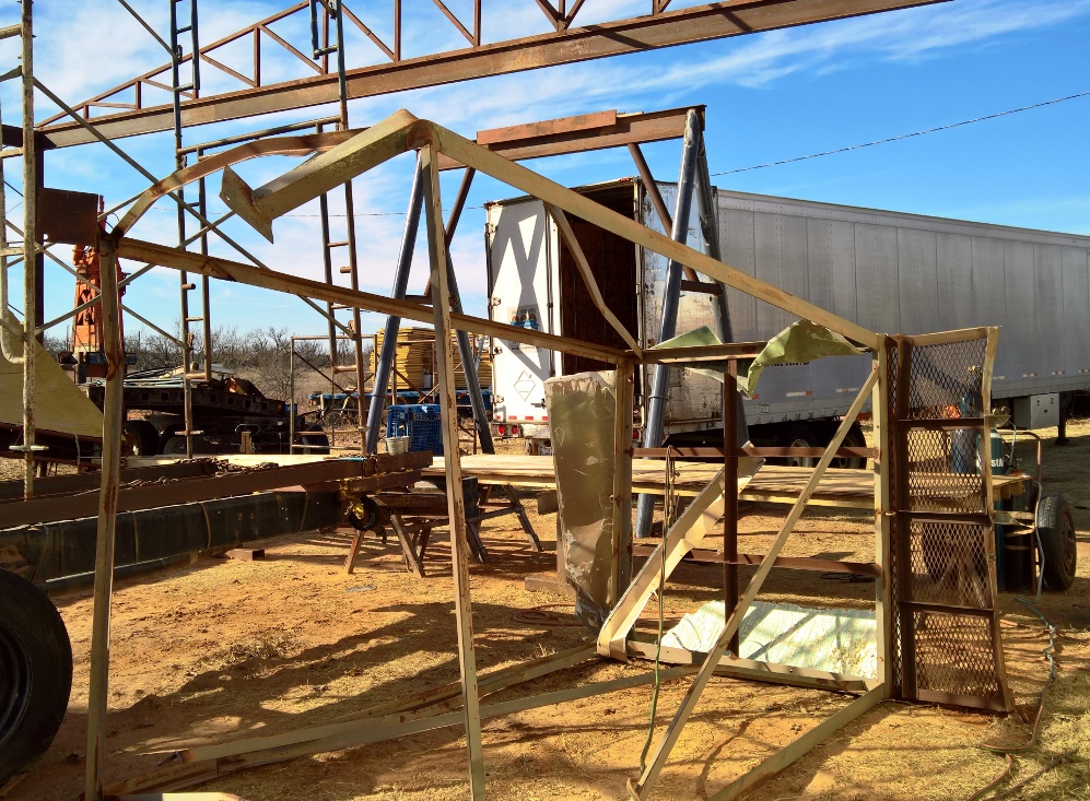

    yesterday and today the wind was almost dead calm Lost yesterday due to having to do the wife wants to go to get groceries thing which could have waited another month or 2 by my estimation of the pantry, freezer and fridge but the boss is the boss.
    so this morning started trying to get the back hoe started at around 9 am in 20's something temps. it wasn't having it. the old battery just didn't have enough reserve to get a good crank over speed. Out comes the 30/60/300 Schumacher. Charge a while then spin over a few seconds then charge a while again. repeat and repeat get frustrated go round up a couple electric heaters place one at injector pump the other on the opposite side of the block. Sun's out nice and bright the hours tick by the temps climbing but back hoe parked north side of building shaded from the sun. I refuse to use a starting aid on the old engine last thing I need is to turn it into a drug Addick. It either starts or it don't and I go do something else. So one final attempt flip charger up on the 300 amp setting give it a spin it starts and blows black smoke for several minutes while warming up. By now it is noon half the day gone wasted the rare calm wind.
    Fly 4 purlin up weld them in place fly the remaining 6 up weld 2 more in place by now it is getting on past 4 PM all and all a productive day best so far on the roof project but now need to move the mobile scaffold. get everything moved out of the way and say the heck with it I'm supposed to have a new battery come tomorrow or Thursday and Bob may be able to stick around for a couple hours to help steer and move the scaffold Going to be too windy to risk welding tomorrow sparks started a couple of small grass fires today even in the almost calm wind but the Fire marshal wife took care of them with her shovel
    4 more purlin, 4 more purlin I keep saying then I can sheet the whole north roof.

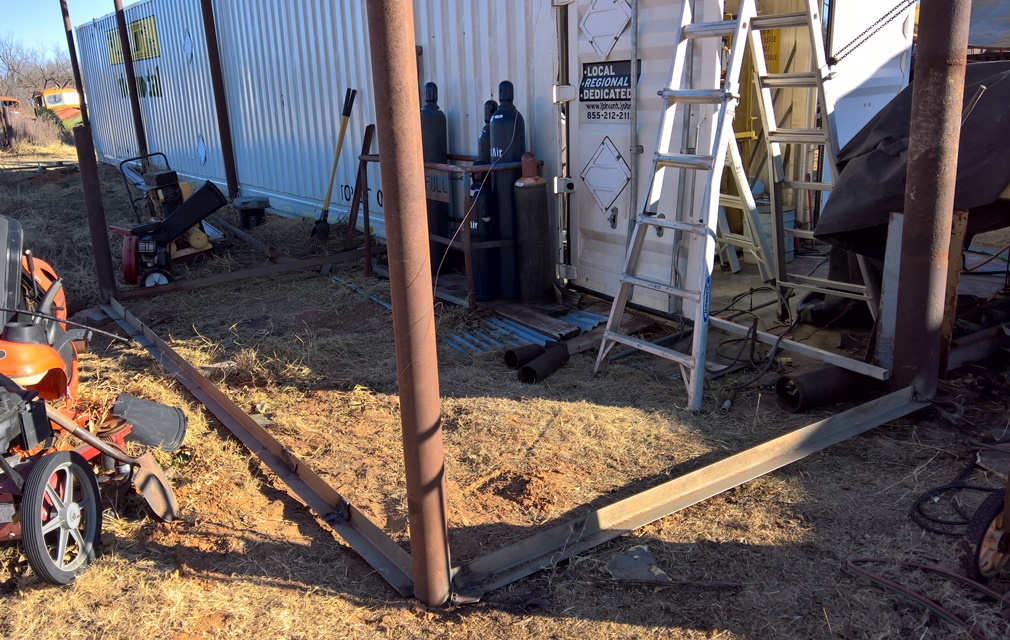

    Took the first step towards building my shop-wp_20191231_17_16_40_richkl.jpg

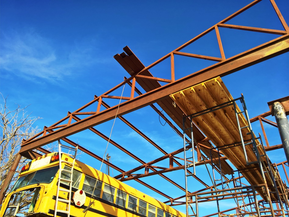

    Did I say I only have 4 more purlin to put up on that side?
    Oh yeah part of yesterday was used in welding in the last crapy brace between the trusses.
    This officially uses up every last piece of the old trusses from the building I took down
    Took the first step towards building my shop-wp_20191228_14_03_12_richkl.jpg
