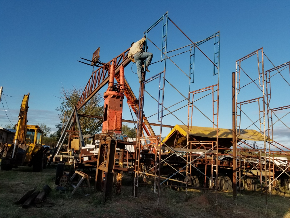

Attachment 31743
Attachment 31744
Attachment 31745

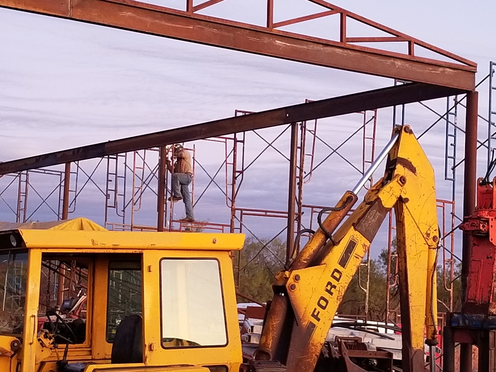

3 days of climbing scaffolding dozens of times, hanging off the rungs of the scaffolding while welding is just about to get old for this old man. However I can see the light in the tunnel growing nearer with each passing day I think it may the a search light on a UFO or a train but the shop is coming along.

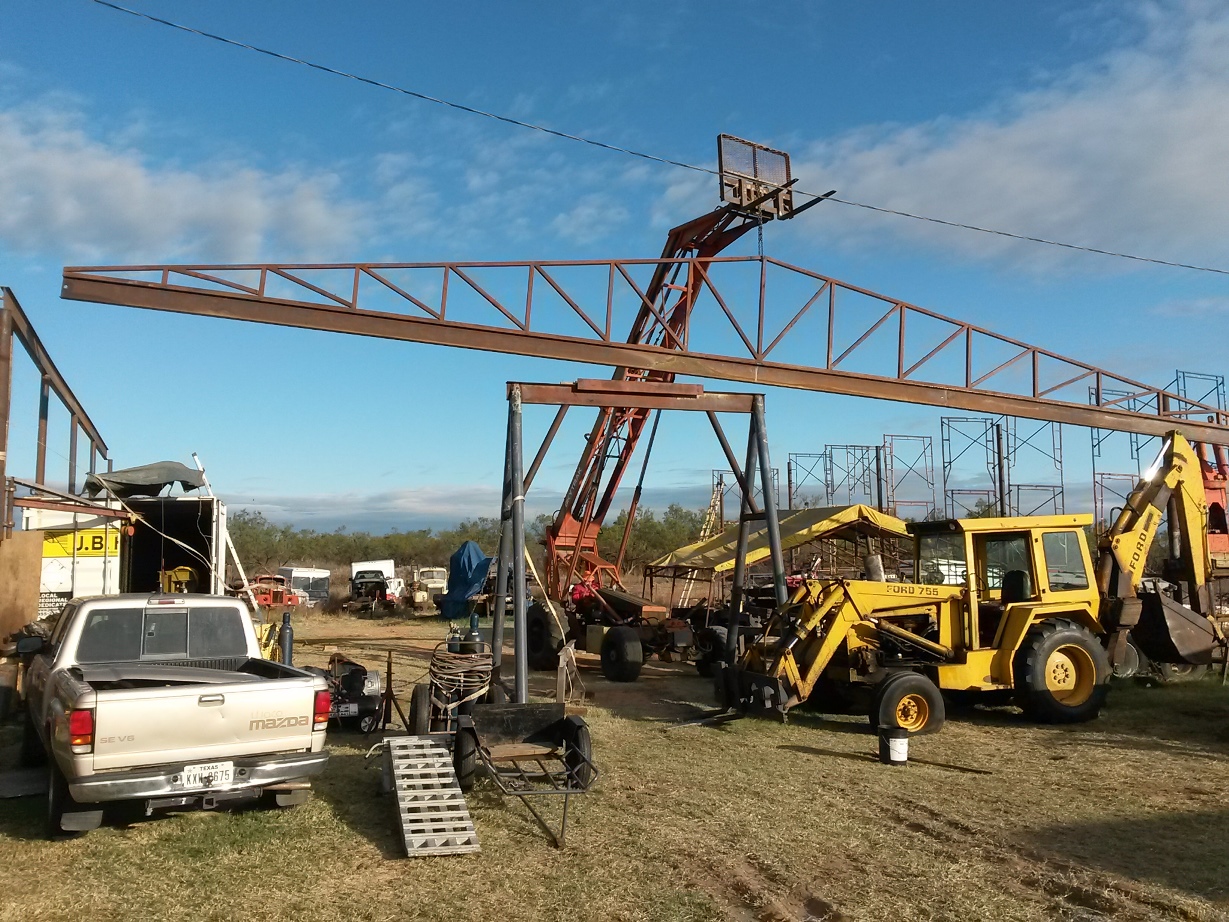

now have 4 of the 5 trusses in place and some temporary x bracing welded in place just encase things have to go into slow motion for a while I don't want the wind to wreck what I've already done.

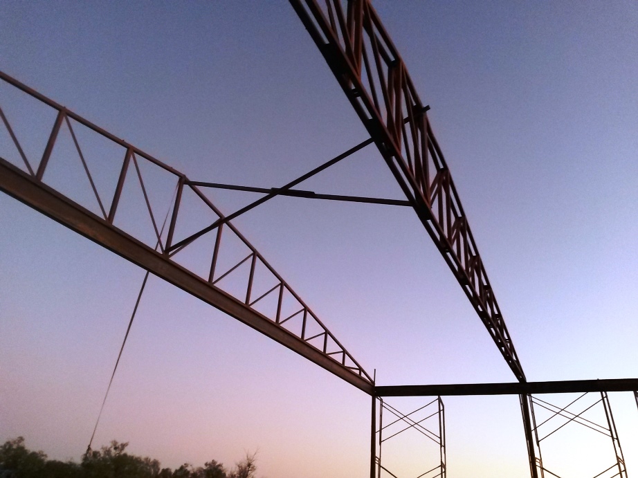

Attachment 31752
Attachment 31753
that's me playing monkey while welding

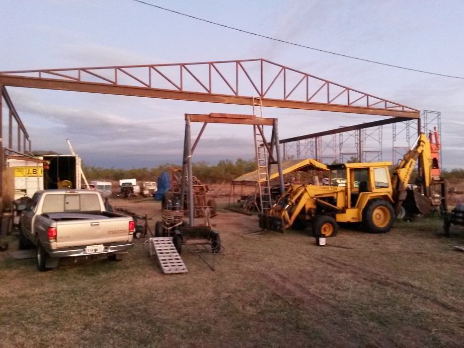

Attachment 31754
Attachment 31755
Just after sundown yesterday

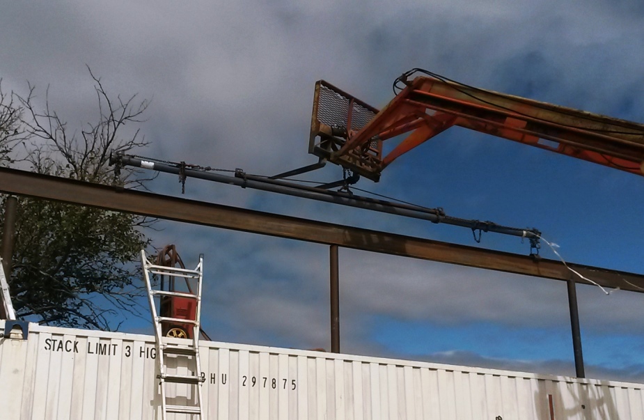

Attachment 31756
To be honest I should start a thread called how not to build a shop building.

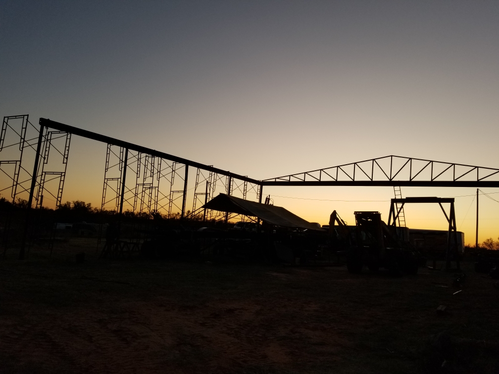

Attachment 31757
If I do then I can construct a 15 by 68 ft. office space between them and still maintain the clear span opening for a 3 top hung sliding door opening allowing me to have a 44 ft wide opening from either side or just open a 22 ft. wide single section
this will also mean I will have a place to construct an elevator to lift materials to the mezzanine where the school buss will probably be placed and then on up to the office floor.
But it will also mean that the building will wind up being 28 ft tall in front instead of the 24 ft height at the center of the trusses now
But it will give me a lot more sq footage. Actually by the time the 45 ft machine shop van is attached to the South side and the 26 ft tool and bolt storage van attached outside of the East or the rear of the building I will have close to 6000 sq ft of useable floor space while still only having to pour a 4000 sq ft slab

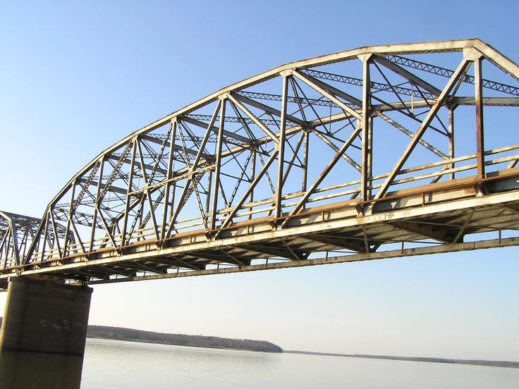

My Idea of acquiring a pair of old steel bridge trusses got shot down the County road department decided to leave the old bridge where it is as a hysterical monument
Not the one I showed in the picture but similar in design, about 8 miles from the house is an old bridge that has a span of 70 ft and is 17ft 4 inches outside to outside.
Last spring they were talking about giving it to anyone who would haul it way We checked with the county this morning only to learn they had changed their minds.

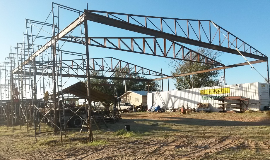

Skip to the current building 5 trusses on 15 ft centers 2 single thickness trusses with 12' beams 2 trusses that are doubled with 2 1/2" spacer tubes between them additionally held together with 10ga by 6" by 12'' long strips of metal welded on top and under the trusses tying the 2 sections together making a truss that is 4 times stronger than a single width truss the 5th truss currently is 2 trusses sandwiched together but I damaged it slightly in moving it around previously so I will re build it and possibly use my remaining materials laying around to make it a triple width truss
What I call Tabernacle bracing is essentially a lattice type brace that would resemble a bar joist down the center of the building the full height of the center of the trusses there will also be a grid work of horizontal bracing run diagonally between the trusses.
By the time the building is complete it should be capable of withstanding the errant 100 year snow or ice storm
