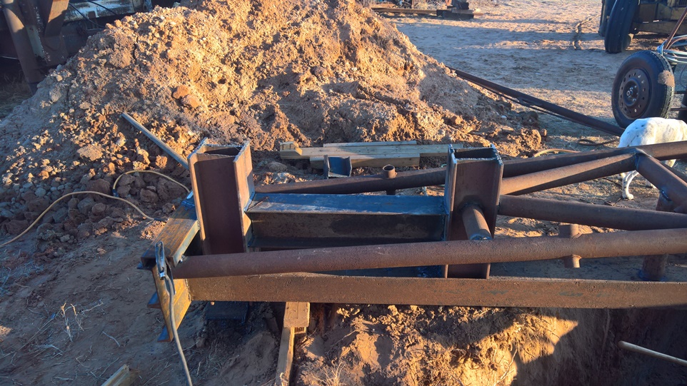

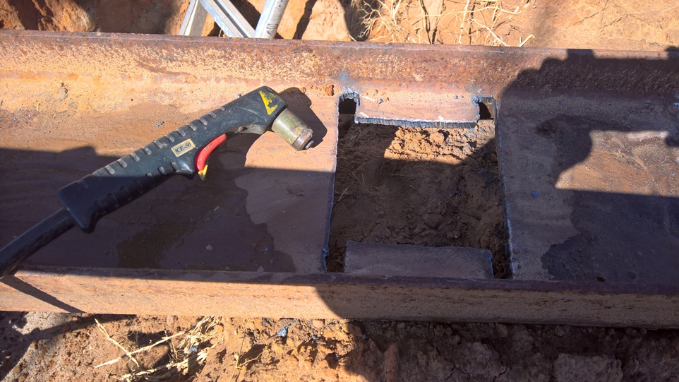

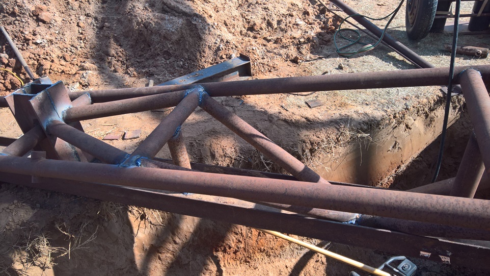

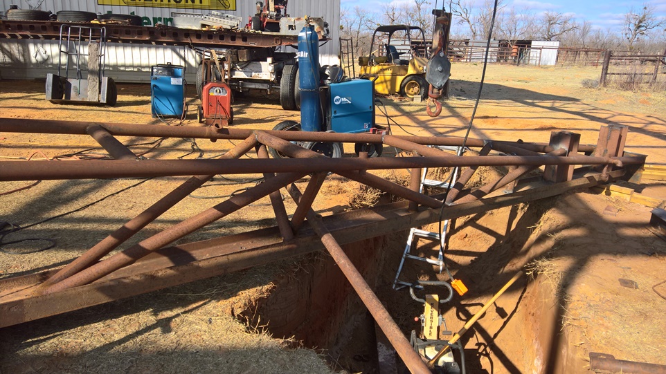

So now I am going to construct a device in 1 end of my shop to be able to lift one end of a trailer and will use my big A frame gantry to handle the other end.
But first this all boils down to constructing the column to handle 10 to 15 tons of weight without bringing down the building in the process.
