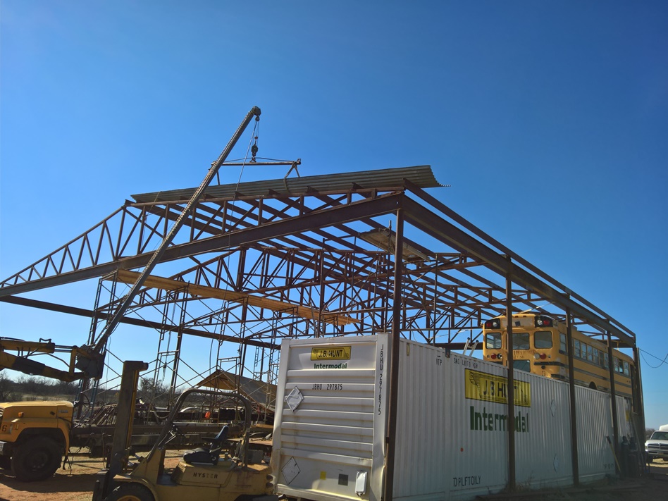

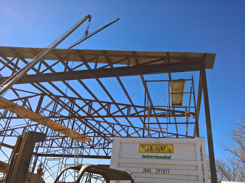

Well there is now 1 sheet of metal on the roof giving me 108 sq feet of covered area not that a 3 ft wide strip 36 feet long 20 plus feet up in the air would do much to protect from the elements

It's progress forward tho!
You must have nicer weather than we have right now... it was a balmy -15F this morning, with a breeze... It has warmed up to 1F so far.
Hopefully the next sheets go on smoothly, and you'll soon have some roof coverage that helps.
Was planning on getting more sheets up today but as soon as I started to move the backhoe crane to grab some more the wind got up. it was supposed to blow all day after switching from the South to the North West I caught it during the lull during the change of direction. 5 to 10 MPH breezes don't seem like much until you think about wrestling a sheet of metal that is half as large as a the canopy of a parachute in area and you currently only have a single sheet to stand on things can go south in a hurry. once I have 3 or 4 sheets down the risk management factor drops by a huge factor For 2 or 3 guys it would be a moot deal just fly them up and shift them one at a time in place with a guy on either end and a guy starting somewhere near the middle to get the first couple of screws in. In the past I've been on roofs with a stack of sheets in winds so bad the crane operator refused to bring us another bundle.

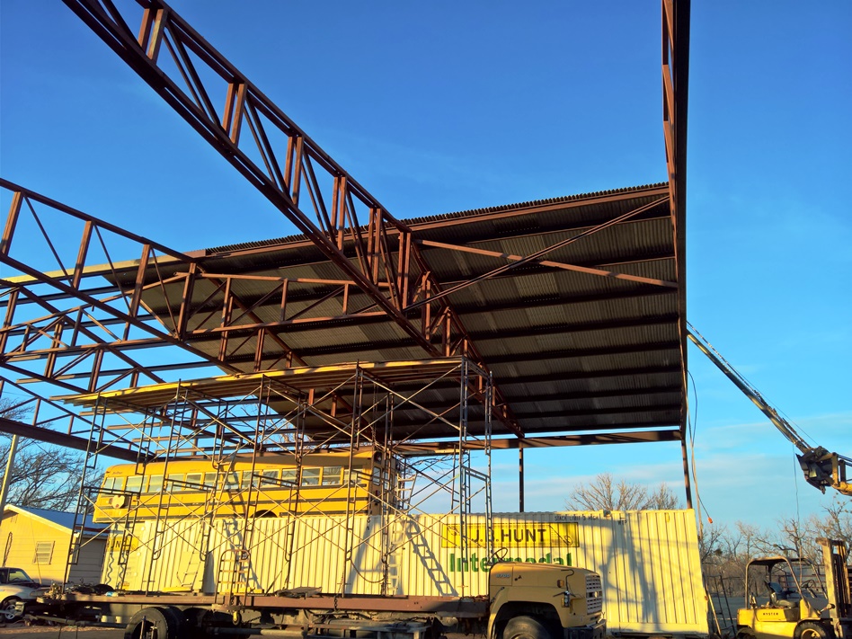

Any way I now have 40 feet of the 61 feet of the north roof completed
Attachment 33196
Attachment 33220

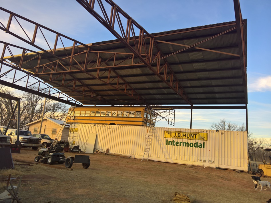

The North Slope is done.
the photo taken around 3:30 this afternoon while leaning against the South East corner column.

Making good progress Frank! Can't wait to see it finished. :thumbsup:
I do have some concerns enough so that I have some more bracing made up to weld in place and some cables installed for wind stabilization currently my biggest concern is the fact that the ends do not have any columns just the corner columns the North West and South West columns are hero columns the one on the south has the structure for the brick crane tied to it half way up so very little concern there. On the North side the Container stabilizes those but I can still detect more than movement than I felt there should have been when I was dragging the sheets across Probably just imagination and a combination of natural flex due to there being no walls in place. If the building were only 10 or 12 feet to the eves and it had that much movement I would have been really worried.
Today the winds are gusting close to 30 MPH and from the ground feeling the columns I don't detect any movement at all, That's not to say there is not any I just don't detect any.
