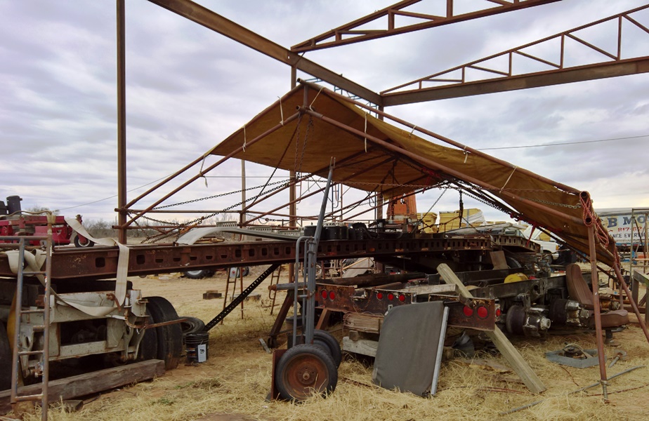

it could providing there was room between where the shop is and where I have my vehicle detention center that I call the dog pound because there are more Mack bull dogs than other critters Also that pencil sharpener is sitting smack in the way of things
Right now it would be difficult to use the receiver on the fork carriage of the front end loader due to having the gin pole and hoist on it. My duel wheeled fork lift spends more time buried in the ground than rolling it is barely maneuverable around as long as I can remain on the area where I have hardened it up with the select fill clay drive of the edge of where that is and it sinks to the frame. hence the pushing and pulling from the rear
one helper who could either drive the pickup or could steer the bus while it was moving would have been a big help.
Jane won't drive the pickup because the size of it and having to push or pull the bus chassis scares her and she surely is not strong enough to steer the bus.
Even after having to take time to change a tire then go to town get fuel have the tire fixed and a few other go to town things that had to be done.

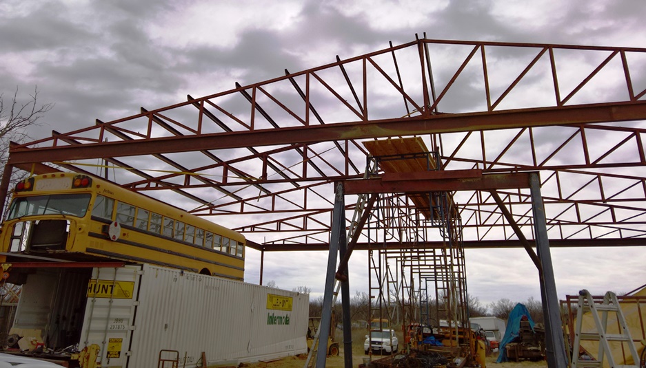

I managed to get 4 purlin installed today these area at the highest part of the trusses so my scaffold was more of a its there as a fall stop than anything else since the center of the trusses are over 6 feet from the bottom of them it meant climbing on them and working while standing on the braces or sitting on top of the truss to weld them in place.
Attachment 32783

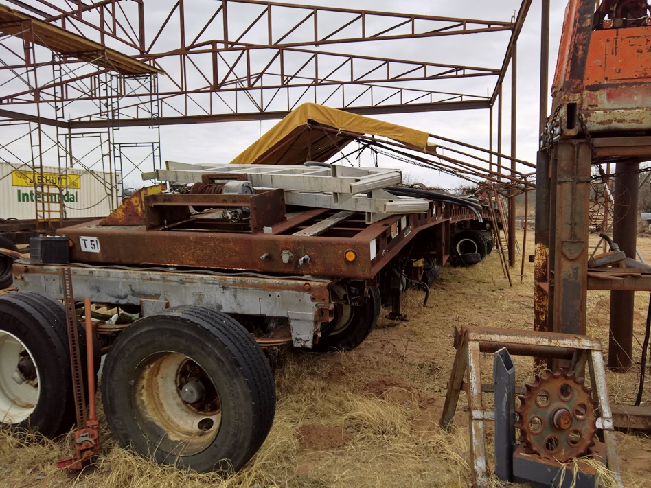

This puts the to the point of either doing the back half of the same side or moving a lot of stuff to do the other side. Or going ahead and sheeting what I have to give me a 30 ft by 36 ft roof over head. On the one hand having a partial roof would be better than no roof but that means having to change up what I am doing. IT would mean I would have a completed area to put the project that is currently under the tent though and the tent has to come down soon anyway. Heck I have almost knocked it down already.
But I think I will carry on and install the other 10 purlin on the second half of the side I am working on then sheet the whole half then move everything from the other side and not have to take a step forward while taking 2 backwards.
The stuff that needs moved is the 3 axle set currently under the tent and the 50 ft trailer that I have on dollies and can only be moved sideways

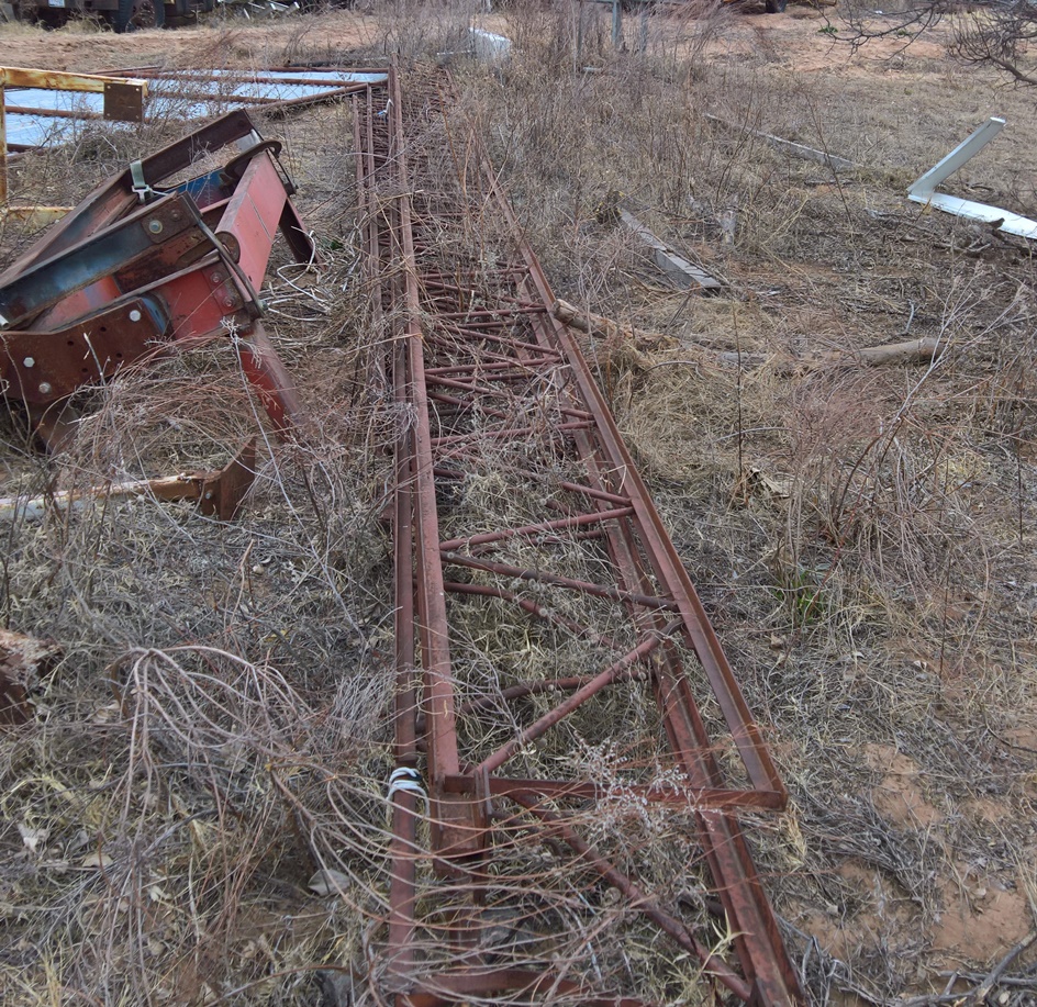

Once I finish with the roof these bar joists will be used to make a 30 by 40 lean to on the south side of the building

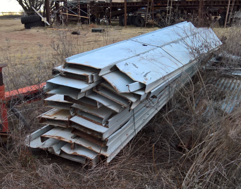

these white standing seam panels will be the roof of the lean to.
originally the bar joists and the panels were used as a cover for a large RV
I have almost enough panels to make a 30 ft wide lean to the full length of the building

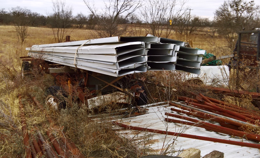

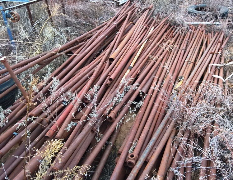

This pile of pipes is what I will be using to run my air system throughout the shop I have close to 2000 feet of 1 " 1 1/4" and 1 1/2" pipe in that pile with a smattering of a couple hundred feet of 2 " & 2 1/2" pipe more than enough to plumb an air system with.
Attachment 32789
A lot of pipe! Run a branch to St. Joseph? I'm not a big consumer of compressed air . . .
Maybe I can find an unfracked reservoir in OK or southwest KS. Never mind, you are busy enough.
Actually, I have a 3ph dual voltage 80 gallon upright and 60 gallon reservoir, in opposite corners. One for quiet, one where the action is. PLENTY!

When it comes to pneumatic tools, I am a firm believer that they are like having fire arms behind every door stashed in every corner hanging on every wall under every place one can be hidden because the walk in closet gun safe will no longer hold any more,you will only have too many air tools when there is not a square foot of work area left unoccupied with one. I plan to have drops water traps and filters with the possibility of also regulators through out the shop many areas will have manifolds of quick disconnects and shut off valves before every manifold. Many of the locations will have the 3/8" and 3/4' inch quick connects
This will hold true for electrical outlets as well. I haven't decided what to do about center bay work stations should the need arise, I might decide to embed recessed conduits for future use. I hate having cords or hoses strung out all over the floor that have to be moved to roll a tool box or drive a forklift or vehicle through an area.
