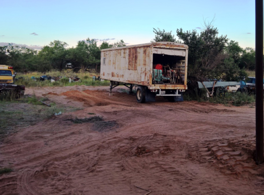

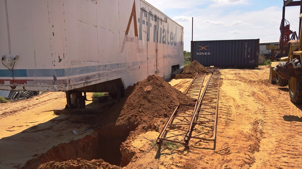

So this brings me to how I came up with the idea I have some storage van trailers that are parked just inside my fence out next to the highway in front of the shop. I will need to relocate them eventually any way, so why not pre plan on how to make best use of their storage capabilities. Right now they are full of stuff that most of it will be place in the shop once it is closer to completion. but where the trailers are located it is most difficult to transport materials or equipment from them.
So I decided to spend some time now and save even more time latter by relocating the trailers or at least prepare an area where I will be relocating them. To not do this might mean I would not be able to place them where I want them due to the amount of fill I still need to add, plus once I park and ground the tool room trailer it may be completely impossible to place one of them anyway.
So I began the day moving a load of bar joists which will be used for the rood between the shop and the machine shop trailer. then I moved my forklift that has been parked at the end of the container on the North side of the shop ever since the container had been placed there.
Then I moved my steel rack and a lot of other materials which was in my way
then pushed off about a foot of the soft dirt and refilled with the rejected fill material I have been mining for the shop floor. Since the area will not be brought up to grade any time soon the reject fill would serve to harden up the soil enough to place the first trailer there Plus by leaving the area about 2 feet below the finished floor level once I remove the wheels and tires entry to the trailers will only be about a foot above the eventual slab Also I plan to put the trailers with about a 25 ft bay between them which may eventually be roofed over

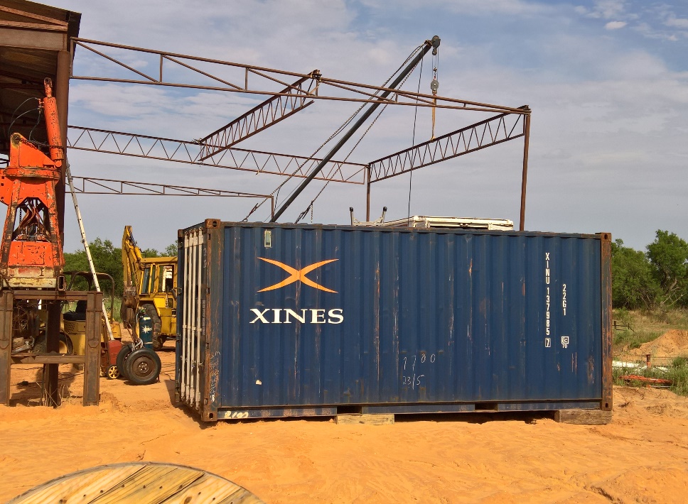

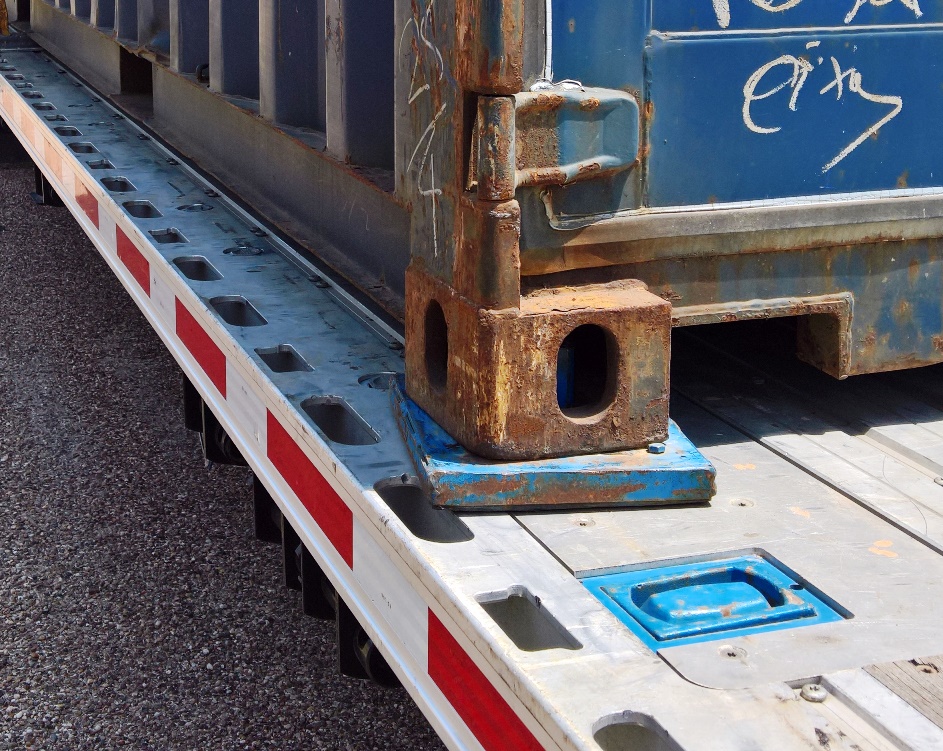

A 20 ft container arrived Monday morning One good thing was Bob's day contract had been called due to mud so he got here about 9:30 then the driver showed up around 10 Am. We took him to town to take advantage of the wide flat area un chained the little tractor on the back of his trailer and backed it away from the container then undid the locks holding the container down I used my toe jack to lift the container and place our slide shoes under each corner then Bobe backed his trailer up tot eh side and T boned the drivers trailer with a block of wood between them we winched the container side ways as Bob moved his traler a few inches away from the drivers trailer then I had the driver slowly back up while Bob winched as soon as the container was off of the drivers trailer bob pulled away we moved the little tractor to the front of the trailer chained it down signed paper work and we were ready to take the container to put it on the ground we letf the driver there to finish out his 30 minute break. The driver said he has had containers loaded and unloaded 1000s of times with cranes and large forklifts but never had he seen it done the way we did it and almost never as fast as we unloaded him said once he delivered to a job site and had to wait 3 days for a crane to unload him and there was a rig similar to Bob's sitting there had he known it was that easy he would have hired that driver to unload him.
I told him it only looked easy because we had those slide shoes and the toe jack to put them under the container otherwise we might have damaged his aluminum trailer. He said he hadn't thought about that.
By 10:45 the container was on the ground located in its final resting place

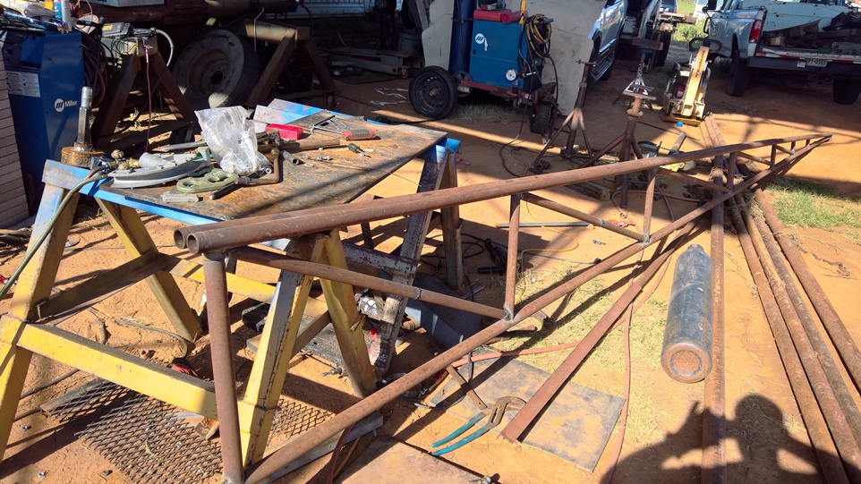

Now that that is done and I have made the end trusses for the lean-to it is time to get some work done

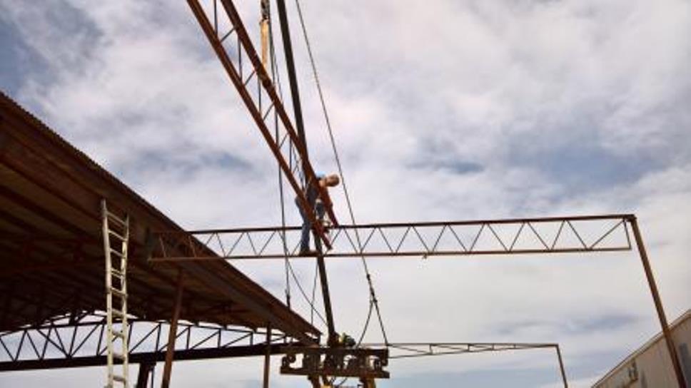

I figured that today I might get 2 of the end trusses up but was going to have to move the bus scaffold and lower its height some how.
But then this morning I had barely finished breakfast and my 4th cup of coffee dreading the prospect of what was ahead for the day, About this time some guy who is not chopped liver.
By the end of the day in near 100° heat this is what we had done. When there is a second pair of hands around to help hold things and move things quite a bit can get done even with taking more breaks than working. Crawling out to the middle of a bar joist that is only chained off on one end and resting on top of the pole on the other to release the lifting strap several times is so much fun I recommend it to everyone Just don't tell Jane what I did.
